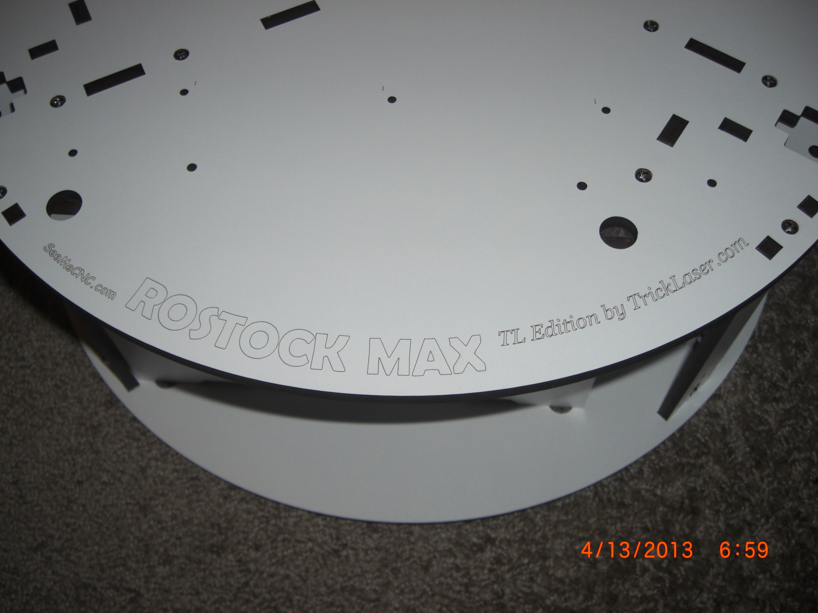

my new frame kit arrived from tricklaser.com also.. check out my custom made belt tensioner mount.
original left, new on the right http://forum.seemecnc.com/viewtopic.php ... &start=220
tricklaser TL-1 frame looks well cut and pre-removed from laser cutting sheet. packed nicely. will be assembling this and posting another report.
after some unpacking and visual inspection the kit is well cut, and very well aligned. top plate is perfectly symmetrical to the bottom plates. I can rotate the top plate to all three positions and the slots line up.
rambo mount is inside like the new rostockmax kits but it has more holes for mounting and running wires. also a fan mount.

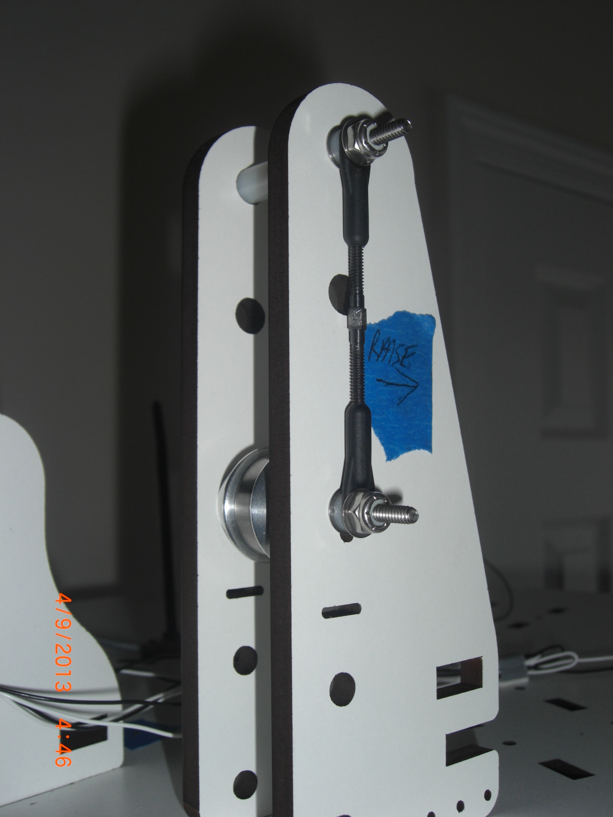

Belt tensioner take two.
Posted: Mon Apr 08, 2013 6:15 pm
by cambo3d
some preliminary test fit photos. looks promising and I think its going to work. Now I know the exact sizes i need for turnbuckles. i'm gonna start looking for better parts. maybe get turnbuckles that are more heavy duty.

Cambo, I think that kit looks much better. But on the tension system, I think I would remake that.
If I recall you do a bit of machine work also. Wonder if you could use that tension mount but create a wishbone shaped bearing holder to replace the spacers on each side of the bearing. Then machine a point at the top for a single adjustment screw with a solid adjustment plate at the top.
I can cad out what I am talking about if that would help explain better.
Re: Another rostock max build
Posted: Tue Apr 09, 2013 1:48 am
by cambo3d
I didn't want to machine any parts, goal was to make out of what was already available. I would rather prefer one single point of adjustment though.

That TL-1 frame that you purchased, does it come with the top?
I am thinking about purchasing one to get rid of this acrylic, It looks sharp but it cracks if you get things too tight and it is not straight on the top.
I also bought the new arms trick laser has, that should eliminate the Delta Arm Blues permanently.

it comes with all the wood pieces, only. yes it has the top.

TL-1 from trick laser with some help
Posted: Fri Apr 12, 2013 8:44 pm
by cambo3d
started prepping the frame with my little helper, The tl-1 frame went together without a hitch. I didn't have to sand or struggle assembling it. It was flat and level on first assembley. I was pleased. :mrgreen: I will be assembling this machine as parts roll in. along with my planned upgrades.

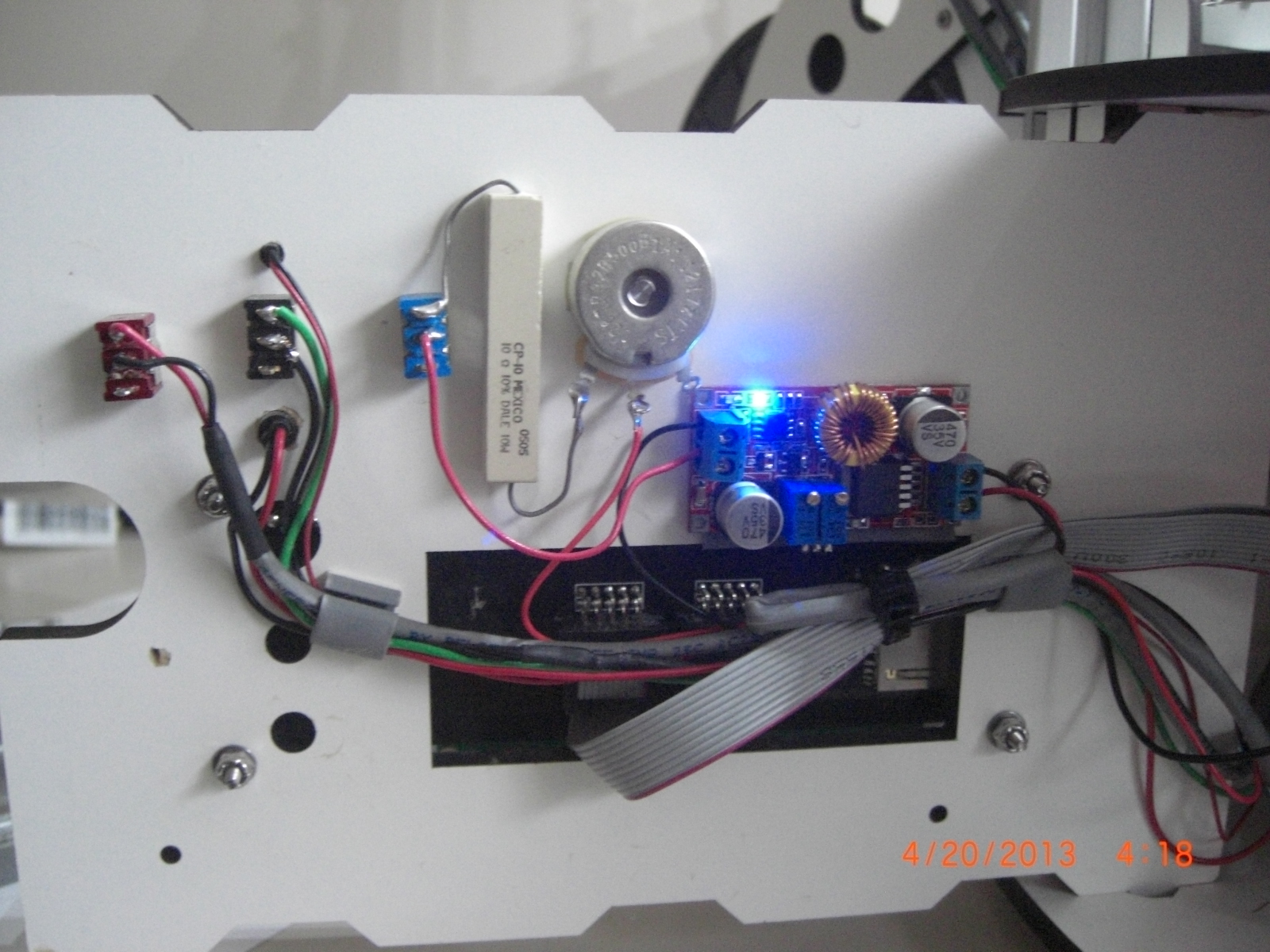

led platform lighting finished
Posted: Tue Apr 16, 2013 11:35 am
by cambo3d
leds mounted using thermal adhesive epoxy, on my custom cut aluminum heat sink http://forum.seemecnc.com/viewtopic.php ... =260#p9718
50ohm pot wired along with 10ohm fixed resister, and on/off switch
how it looks on the platform all wired up. If I make another, it will be made of pcb material so the wiring and led will be integral part of mount.
powered up turned all the way down dim
powered up turned all the way up bright
IF ANYONE WANTS AN LED MOUNT LIKE THE ONE I MADE JUST SEND ME A PM, I DONT HAVE ANY STOCK TO MAKE THEM AT THE MOMENT BUT I'LL BE MORE THEN HAPPY TO GET SOME.
EDIT: I'M NOTICING A LOT OF FLICKERING WHEN THE RAMBO IS DOING ITS PID ROUTINE, SO I ORDERED A BETTER VOLTAGE AND CURRENT REGULATOR TO ELIMINATE THIS PROBLEM.
problem fixed, using this regulator below. no more flickering.
current and voltage regulator from ebay. http://www.ebay.com/itm/221200620645?ss ... 1497.l2649
simple setup, install and turn your led pot all the way bright, then adjust the voltage pot on the regulator till the flickering goes away. There's also a current adjustment if you need it.
