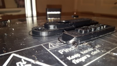

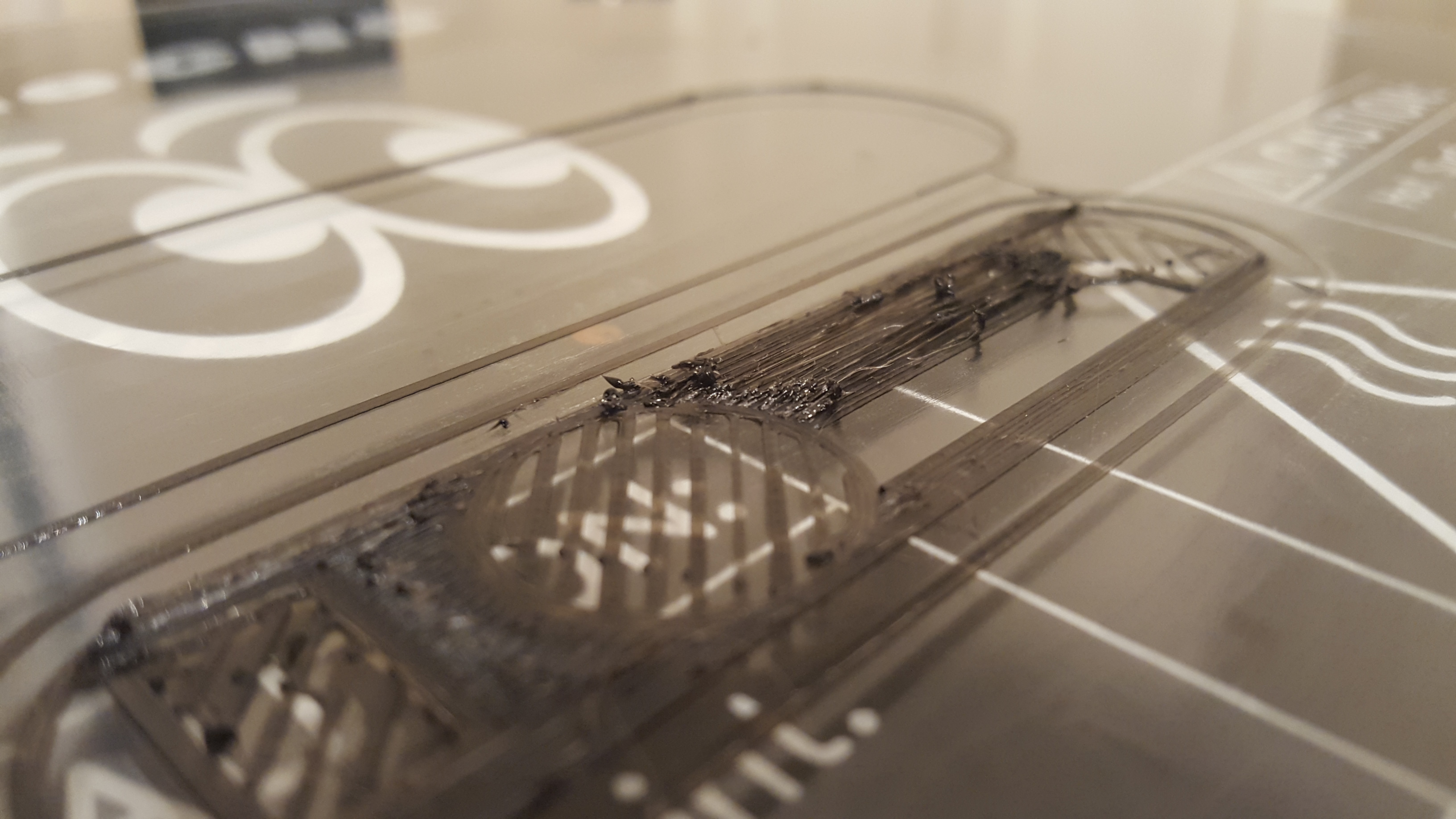

Well I spent yet another day tweeking around without success.  I just don't know what the heck I am doing wrong.
First off, I spent a while making sure the machine was properly set up - it was perfect.
So, tried the PETG again. The inital problems I have are it seems to ooze all over the place.
If you started with default PLA settings, I was ending up with large clumps of melted crap dropped randomly over the print, which the head then crashes into later on.
I did a bit of research, and this appears to possibly be due to the head dragging and building up on the hotend.
So I tried small increases in the Z print height, but it doesn't seem to fix it (in fact, it gets worse).
The first layer is particularly bad and a very rough print. I makes piles of filament at the direction change points. I have tried lower hotend temps (245 is the recommended, 230 and it stops extruding properly).

It seems that on the far side of the picture you are pressing too deeply in to the bed. I.e. the Z height is too low over there. Because of this, the molten filament does not exit the nozzle and the filament in the bowden tube acts like a spring. WHen the pressure is released (gap between nozzle and bed increases again) the spring discharges CRAPPING molten filament.
Atleast that is how i interpret it.

If that is the case your calibration is wayy off. That 1st layer is no way near 0.4mm.
Your Z=0 is too deep in to the bed. So it goes to where it thinks is 0.4 mm above the bed, and starts extruding but it is actually 0.1mm or less above the bed.
I would say, use the lcd and set Z=0 0.2mm above what it is now. BUT it also seems that the height is not uniform. So some fiddling with the individual towers will also be necessary.

Would you mind posting more pictures?
What i am looking for is to how high the extrusion is, i.e. Is it really 0.4mm. And is it uniform accross your whole first layer.

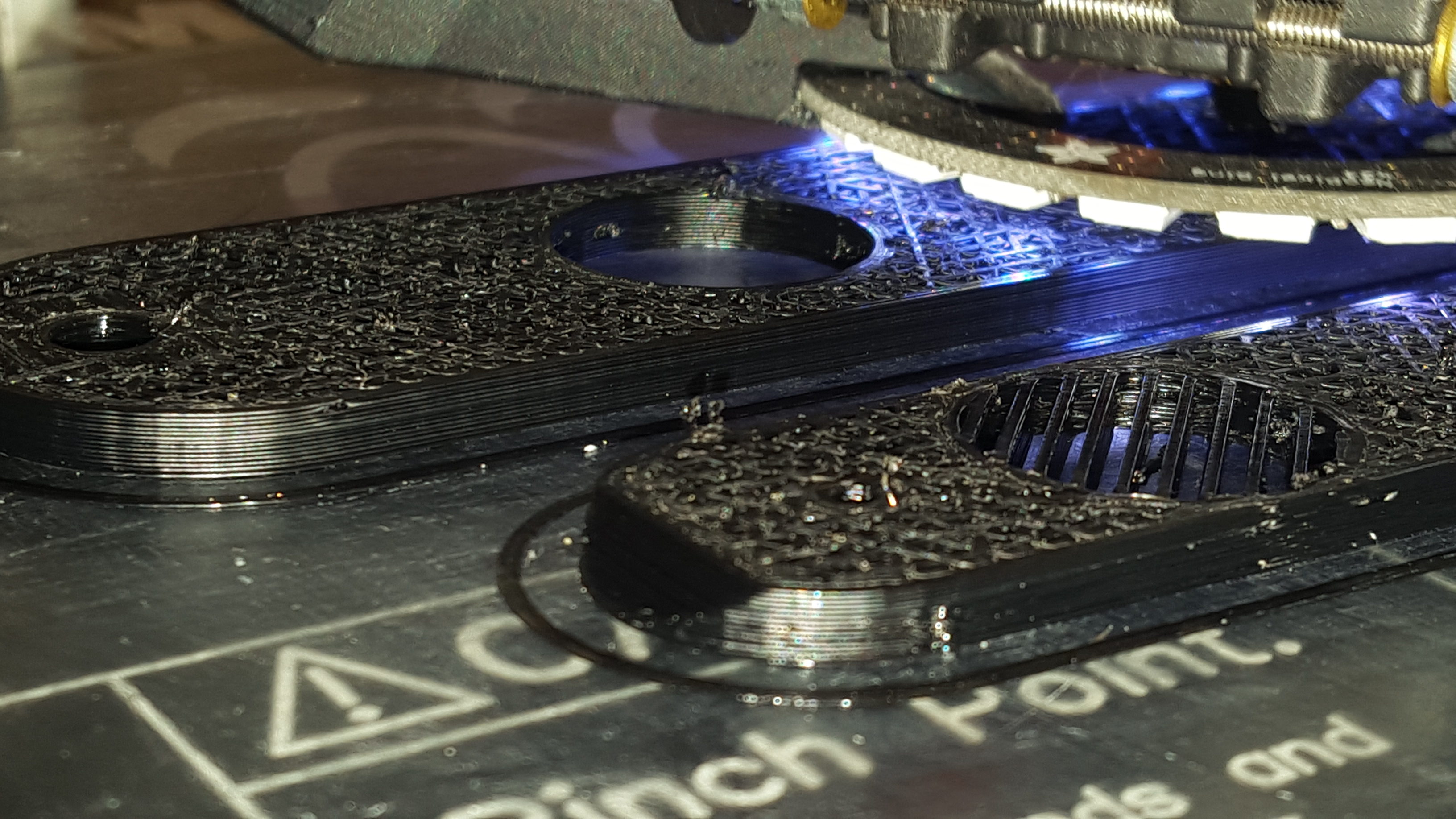

Based on this you're starting around 200c? Try 240-260c. PETG always has laid down nicely for me right on PVA glue(50%glue-all, 50% water) at 75CStevolution wrote:Well I spent yet another day tweeking around without success. I just don't know what the heck I am doing wrong.

.2-.3mm layer with .4 nozzle doing .44-.45mm extrusion width.

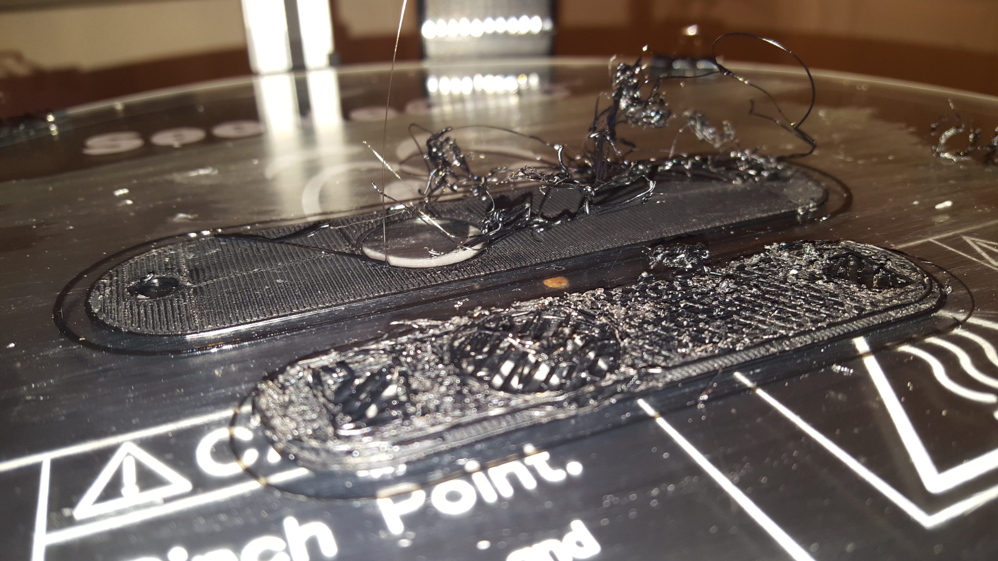

Well re-calibrated again.  Must have messed that up, as the hotend slammed into the glass bed
So... checked 'Z' height AGAIN and re-tried the print.
I reset all the settings to standard again but put 0.35 as the first layer and 0.25 for the rest.
Retraction is 3mm at 100mm/s
Its splooging filament worse than ever now - so I stopped the print. Not in the mood for this tonight, so best I walk away for now.

100mm/sec is WAY too fast.  Try 30 or less.
Re: Diary of a RoStock Max V2 print
Yeah, 20-30mm/sec is good for the first layer max speed. I would also use that for the outer loop speed. Infill can be faster, but not too fast or it'll encourage oozing. I usually do inside loops and infill at less than 50mm/sec. Less exciting, but the result looks way better.

I think OP is talking about the retraction speed. Although 100mm/s for the retraction is also way too fast. Printing at faster speeds is possible, but it brings in even more variables that have to be controlled for a successful print. I use similar speeds 20-30 1st layer, and 40-50 for the rest on critical prints. Depending on the design and other circumstances I often use 80-100 mm/s for prints.626Pilot wrote:Yeah, 20-30mm/sec is good for the first layer max speed. I would also use that for the outer loop speed...
On a separate note, after putting together the printer, it is easy to think that this is it, but in reality, without a robust calibration it's a hit and miss game. 3-point calibration and eyeballing or using paper may work, but not for everyone. It would be nice is we had a more detailed instructions for advanced calibration in one place. Equipping Rostock with a Smoothieware and using your Heuristic auto-calibration should also work:) I have used OpenDACT with some success, which have helped to a degree, but I have also wasted a lot of time with it.

Counter intuitively,  e3d hotends tend to ooze less when the retract os slower (to a point) because then the filament will actually pull the molten material,  rather than friction and gravity sticking it in place.
Slowed the retraction to 30mm
Still laying down too much and leaving lumps that it later crashes into... then it failed anyway

						- Stevolution
- Posts: 195
- Joined: Tue Jan 13, 2015 5:11 pm
I am still using Matterslice (which I find fine).
Extrusion multiplier is left at 1. If I lower that, I tend to get gaps in the print.
I also tend to slow the first layer to 0.77 which has helped the current print lay down a reasonably flat layer (for a change)
This current print is going 'better', but it is still crashing into lumps of crap every so often.
I read that the lumps might be filament being scraped off the print as the head is moved around. I have layers set at 0.28.
The lumps of filament make a horrible cracking sound as the printer head is moving around.
- Stevolution
- Posts: 195
OK.  Stopped that print half way through.
Its messy, but a slight improvement.
However, the nozzle is bashing off clumps of melted filament all over the place (see the photo of the bed).
So, still not correct by a long way. The finish is pretty poor as well. Almost seems to be over-extruding? Calibrated the extruder, so that should be OK.
