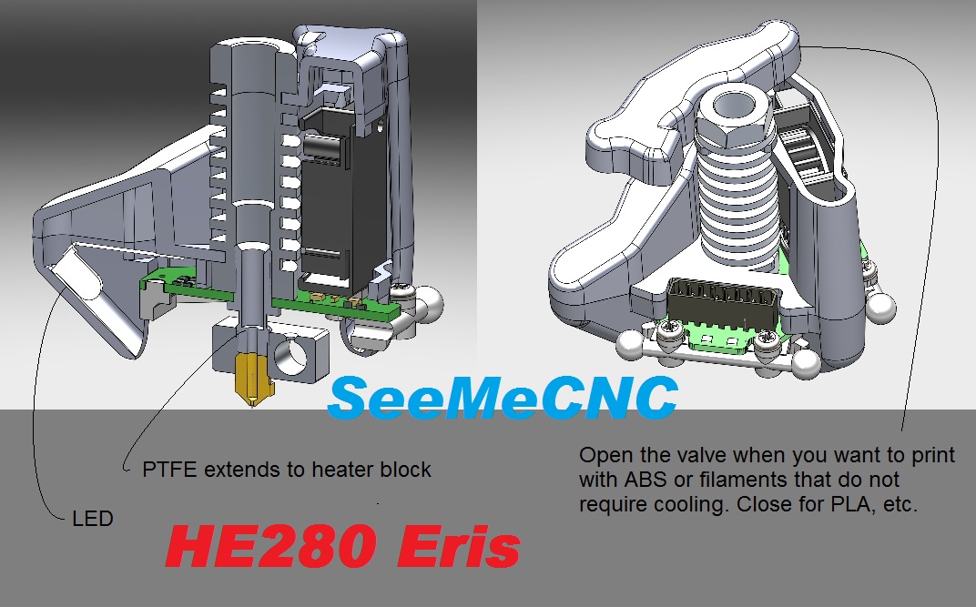

Our HE280 is a new design using a single 30mm blower and single heating resistor. The accelerometer is under the blower. The blower blows up. The valve can be turned to control air flow part either on or off. The intake of the blower pulls air across the heat sink to cool the hot end.

Is it possible to mount the new hot end assembly below the effector plate?
The main reason I have my current hot ends below the plate is to make the nozzle more visible to a time lapse camera. It also generally makes it easier to remove stray filaments wit forceps, without having the effector, ball ends and arms so close to the nozzle.
The gains of having a sensor may very well outweigh these other advantages.

you'd have to make an adapter, we haven't done that

I added a few notes to my previous post.
I would be happy to make an adapter, if you don't see any reason that one would not work.

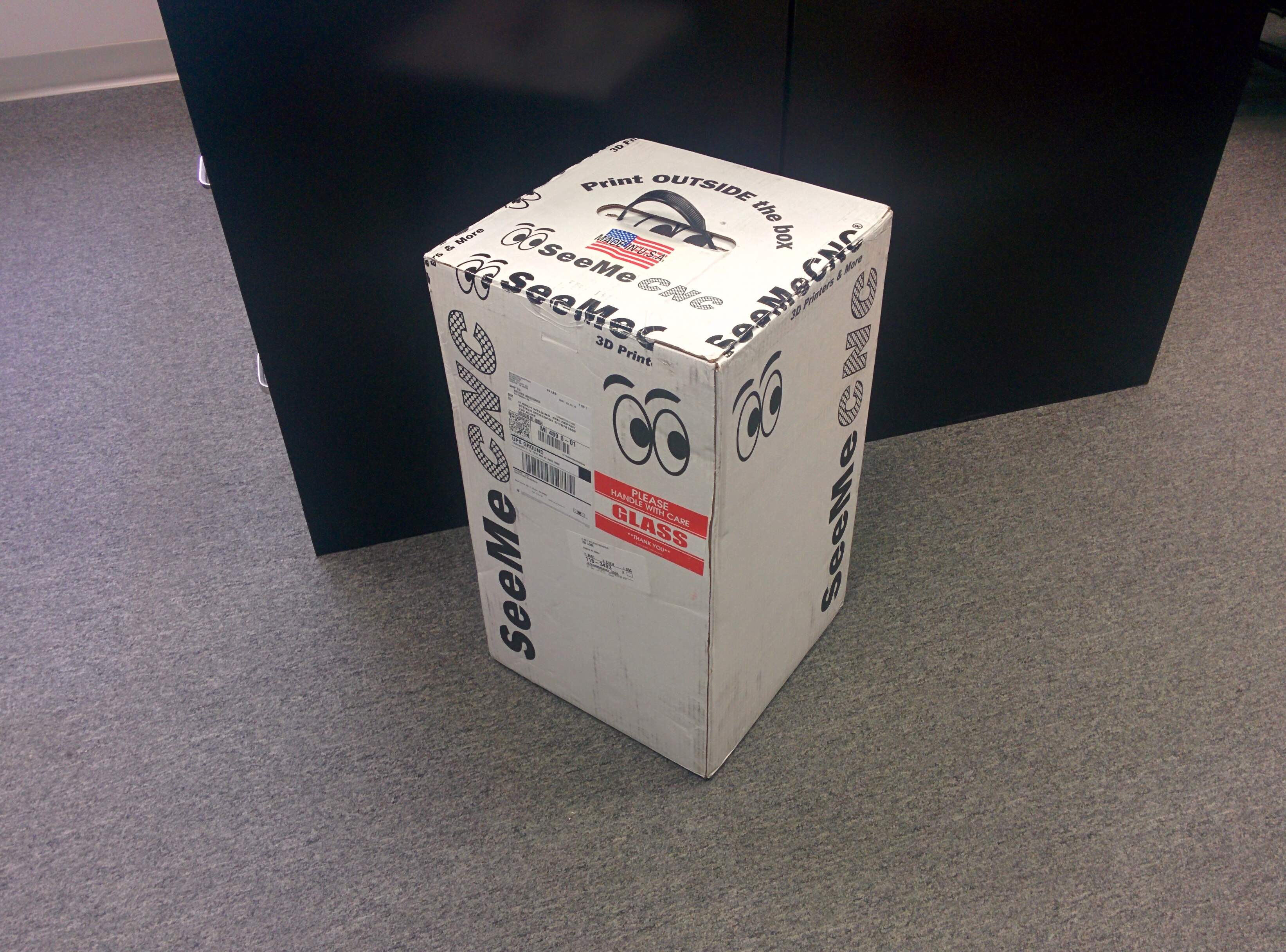

"Out for Delivery" WOOT!!!!

Ooooh, a box with a handle... now that's good design!
Mine won't get here until later this week, it's still in transit.
