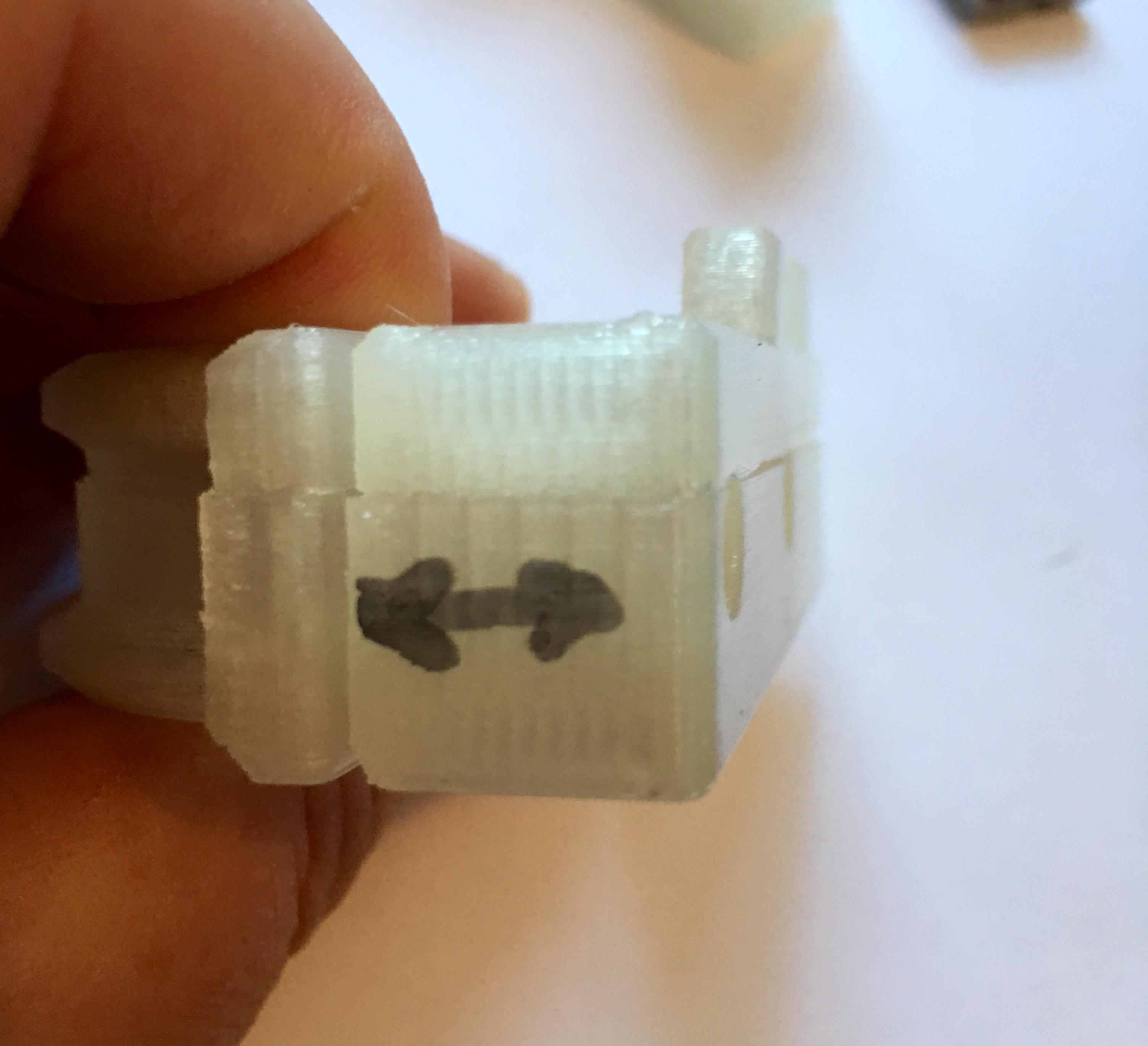

It is a new part - actually a mount for a QR extruder from Bondtech.
Nothing out of the ordinary on the part. I printed one on my Kossel 250 at the same speed and it was fine. At 1/2 speed on the Max it was fine. I know what you are talking about Brian, I run into odd issues like that occasionally too with my milling machines. I have occasionally had issues with printed parts with machine gun fire infill moves but not anything like this. I'm doing a 90° rotation and try again.
Re: Layer Shifting
Ok, the darnedest thing. I rotated the part 90° and ran at the normal speed. This time the shift occurred on the exact same layer BUT it was in the opposite direction on the Y axis and on the X axis, it shifted over and then back to create what looks like a groove along that dimension.
The arrow is the X (cartesian) axis. You can see the groove along the right side pretty clearly. You can also see the Y (cartesian) dislocation clearly on the left side.

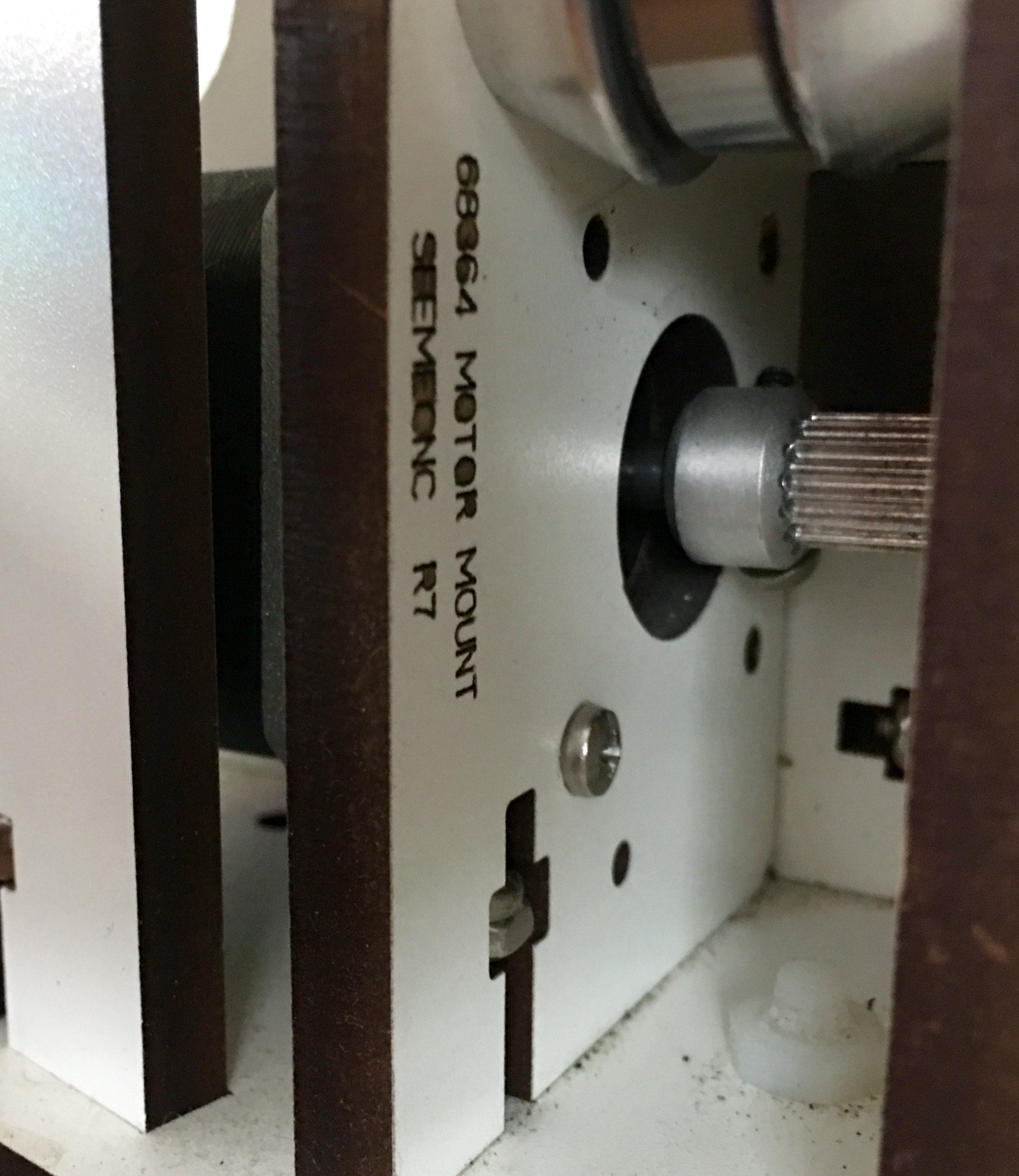

I found the actual problem, not a belt problem at all. I had incrementally replaced the Y and Z belts and the problem seemingly went away. It actually hasn't reappeared. But, today I decided to replace the X belt so they are all new. When I removed the belt and started cleaning around the stepper bay I discovered this:
See the problem? The stepper mount (an AstroSyn) is missing one of the two screws holding it to the Rostock base! The stepper can actually rotate around the existing screw without a lot of force. Very interesting and a good argument for loctite!
