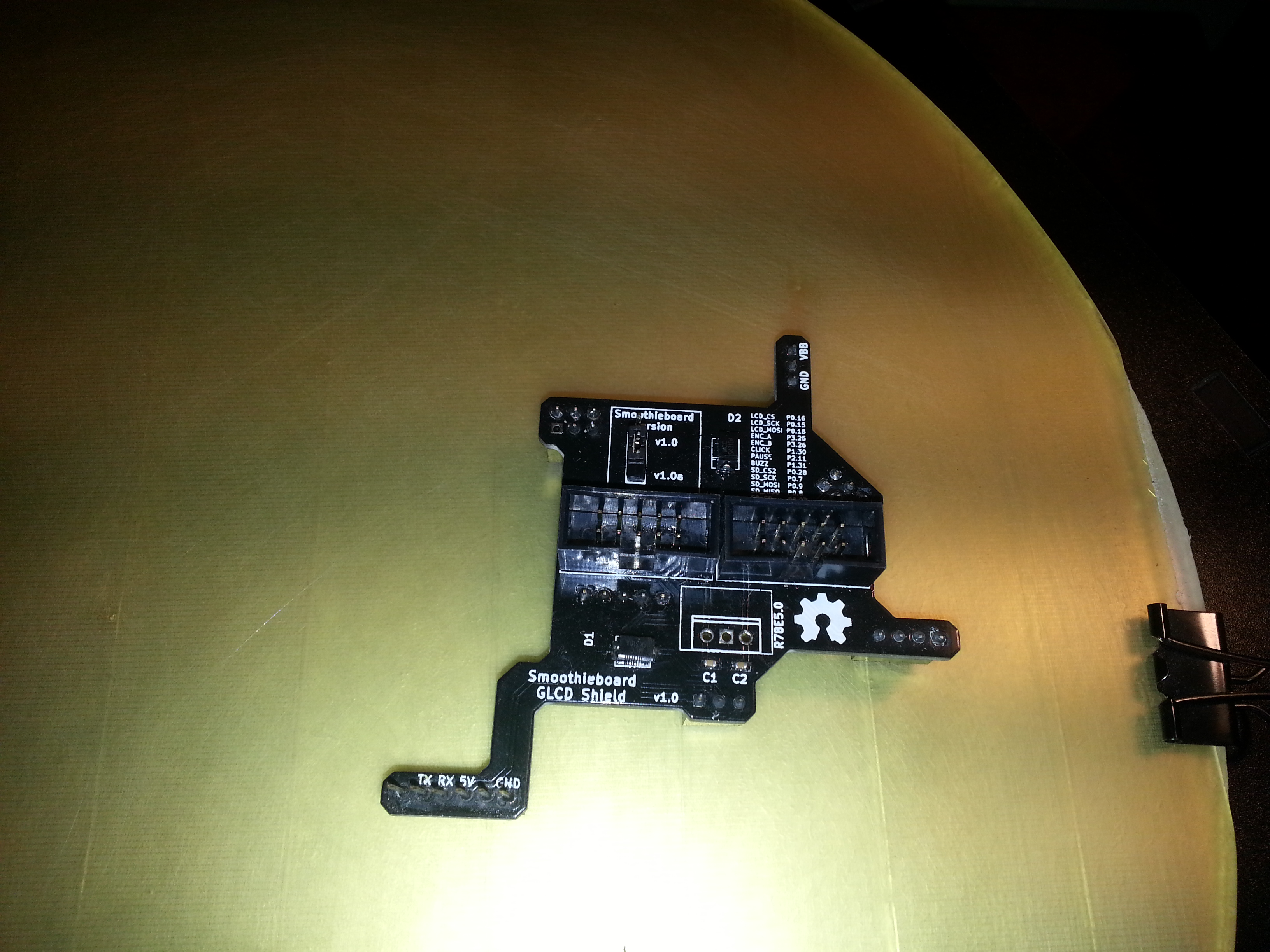

Posted: Tue Aug 11, 2015 4:32 am
by RMLynch
ZakRabbit,
Could you post a couple of photos of your Smoothieboard and GLCD Shield please? Closeups?
I just got my Smoothieboard and GLCD Shield yesterday and from what I can tell, I still have to solder on more pins for the GLCD Shield to connect to the Smoothieboard...? Is that true??
I too got mine from RobotSeed as UberClock was all out. Still haven't heard back from Mark at Uberclock yet and that was weeks ago (three emails in total).
Seems that there is a LOT of flux on my board and there is one spot near the VBB that has a TON of solder there!! The square (copper/gold) is practically completely covered in solder.
I read on here that you only need one 5v 1.0a regulator on the Smoothieboard, but if you put a second one on the GLCD Shield, is that too a 1.0a or the 0.5a?

I'll get pictures when I get home, but yes, I wound up soldering in another 12 pins. Everywhere I saw a "missing" pin, I soldered one in using the pins from the Smoothie kit.
I believe that pad with all the solder on it is a single ground pad with a bunch of holes in it for when/if you add anything later on: remember these boards are used for a bunch of stuff so the needs are different.
I installed 1a voltage regulators on both the Smoothie itself and on the pcb adapter board, from what I understand, it makes it so that the GLCD is powered more directly from the power supply as opposed to from the Smoothieboard. The second one is not needed, but I feel it's just more "robust."
As far as the flux, these are made in very small batches and I think a lot of the components are hand soldered in place, so it may not be "pretty." It reminds me a lot of when I assembled my first Megasquirt ECU.
Edit:http://forum.seemecnc.com/viewtopic.php?f=82&t=8747 have a look here, the actual pins are shown.

Re: Pulled the Pin...
Posted: Tue Aug 11, 2015 9:07 pm
by ZakRabbit
[img]https://lh3.googleusercontent.com/-YMuD ... 174435.jpg[/img]
[img]https://lh3.googleusercontent.com/-Vfm9 ... 174422.jpg[/img]
[img]https://lh3.googleusercontent.com/-8W7D ... 174403.jpg[/img]
Here are the photos I took. I took them from the back side as with the board in place, they're all covered. You can probably tell which ones are my solder joints.
[img]http://chibidibidiwah.wdfiles.com/local ... ard2sd.jpg[/img]
I stole this one from the thread I linked to, it shows in red which ones are actually required, but I put mine in in groups of three as the "extra" pins will add support.
I'm sure there are rules as to which embedded links are allowed and which aren't but I think you should be fine.
Many people have spent the time with me, it's my pleasure to give back. Make sure you keep us updated on your build too!
