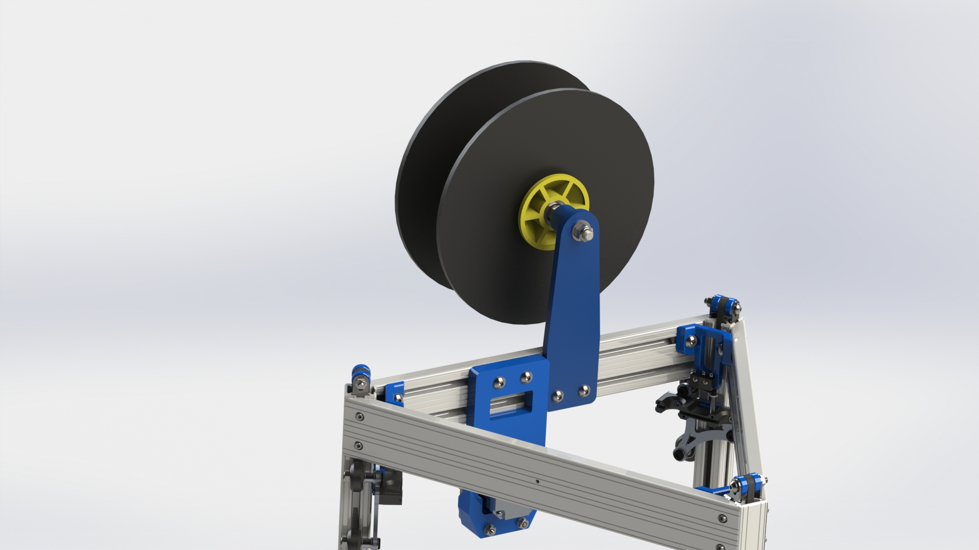

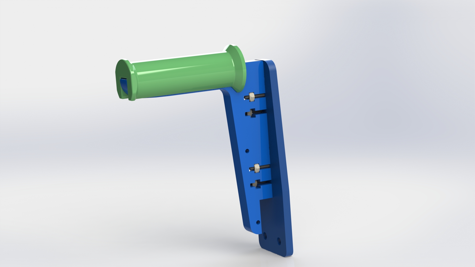

Spool holder complete... ugly, but should work just fine. Designed to laser cut or print. The arm is a lamination of two pieces which is the same approach as the SeeMe CNC arm.
Should also be out of 1/4-20 t-nuts and screws about now.
Non-alcoholic suggestions to un-ugly are welcome...

teoman
Posts: 1770
Post by teoman »
The trend for printing extotic materials is to have them in a sealed box with some dessicant.
If i were designing a spool holder i would keep this in mind from the beginning.
KAS
Posts: 1157
Post by KAS »
Something like this: http://www.instructables.com/id/Techniq ... 4/Dry-Box/
but purpose built like it was intended for this machine.
ccavanaugh
Posts: 297
Location: Indiana
Post by ccavanaugh »
Good point on the moisture control and dry-box. It might be easier to adapt a container like the Instructable and create a bowden adapter for the extruder inlet to keep everything sealed well. I'm a bit concerned about the variation in spool sizes of the specially materials.
Will noodle that one over a bit.

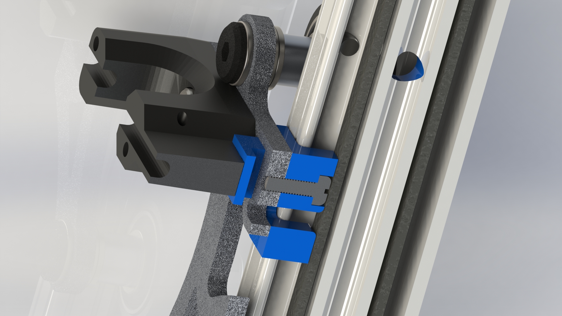

ccavanaugh
Posts: 297
Location: Indiana

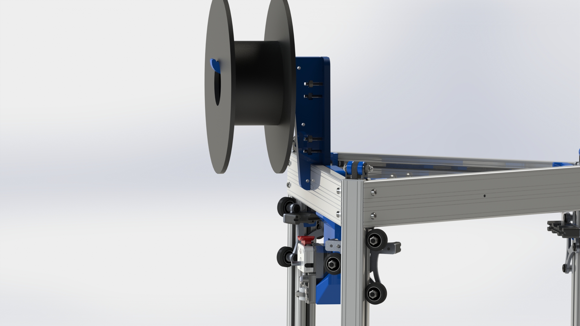

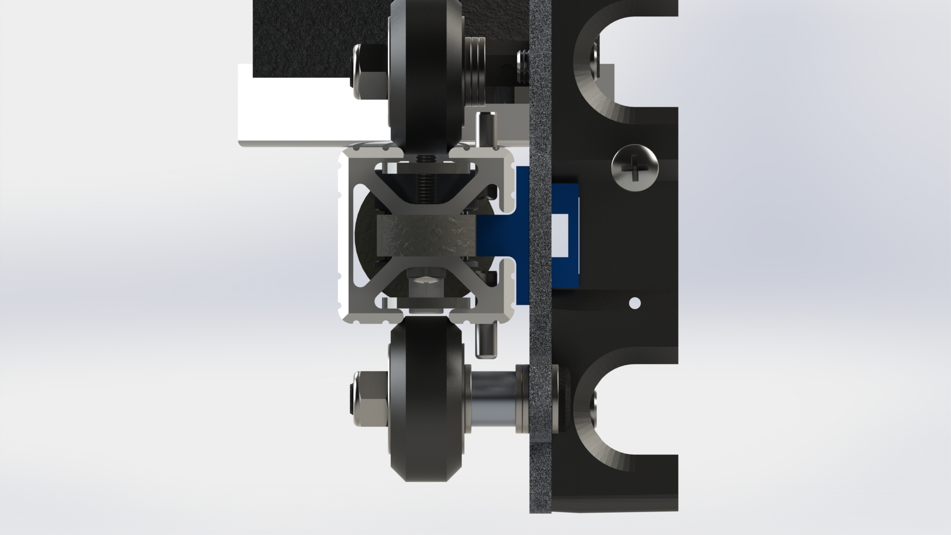

Details worked out for the belt spacer for the Trick Trucks. This keeps the belt parallel to the axis of motion so changes in angularity do not create print artifacts.
I've printed a test piece to verify strength at 1 mm, and everything appears to be good. I'm adding an extra precision washer to the Trick Truck to give an extra 1 mm of clearance which doubles the thickness of the test piece from 1 to 2 mm.
A small pin or screw is used to keep the belt spacer in place. A little super glue may be used also. I've shown a 2.5 mm screw which is a slip fit with the Trick Truck hole, but a 3/32 roll pin will press in place also. The local hardware store stocks the 2.5 mm screws which was a bonus. The spacer woks in conjunction with the clamp that Jim designed.
A side note: The stock SeeMe CNC belt path guides the belts very close to parallel to the trucks and a belt spacer is not needed. The MAX METAL frame simplifies the belt path greatly, but the belt sits much deeper inside the extrusion.

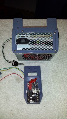

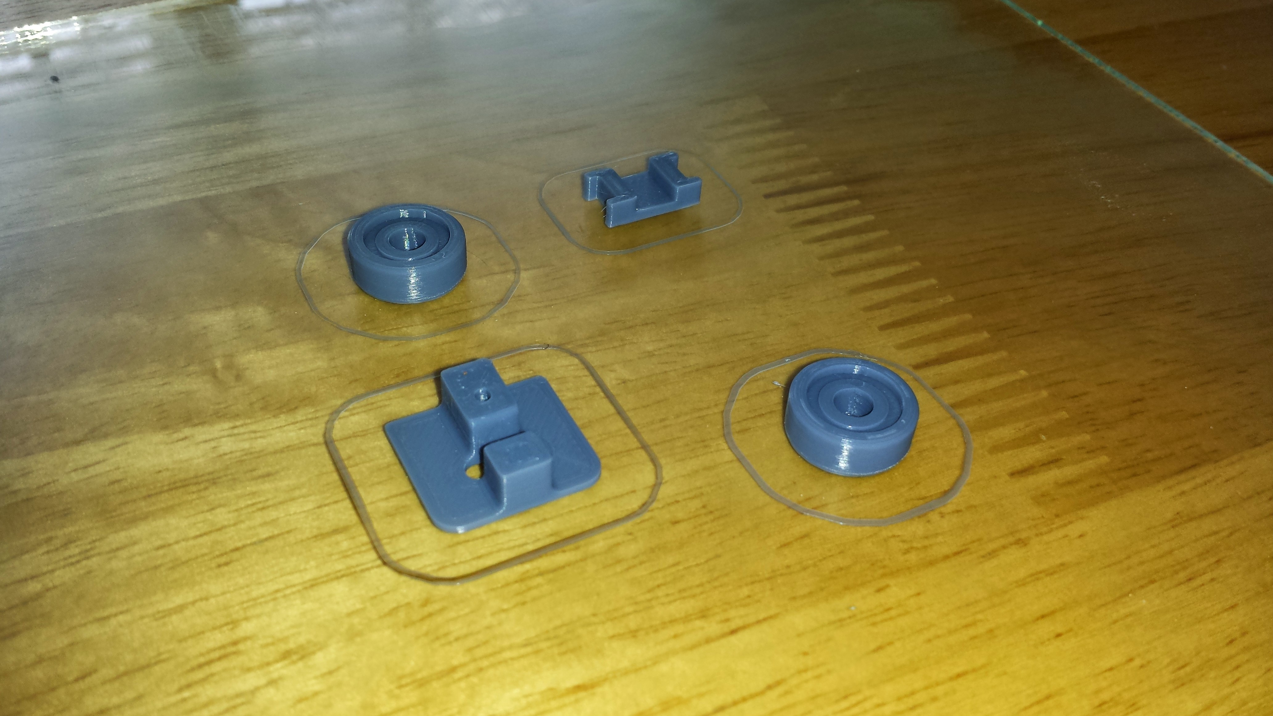

Some completed test prints..
Small Piece check prints
Power Supply and EZStruder bracket

mvansomeren
Posts: 207
Location: Northridge, CA
Post by mvansomeren »
ccavanaugh wrote:Spool holder complete... ugly, but should work just fine. Designed to laser cut or print. The arm is a lamination of two pieces which is the same approach as the SeeMe CNC arm.
Maybe design a round spool holder arm that spins freely? IMO, the SeeMeCNC arm works but just barely. There are many times when the spool will get hung up momentarily to then suddenly release, shaking the entire printer. Over time the spools wear groves into the arm as well exacerbating the problem. Having a freely spinning arm would be a massive improvement that would match the improvement that the metal frame brings.
ccavanaugh
Posts: 297
Location: Indiana
mvansomeren wrote: Maybe design a round spool holder arm that spins freely? IMO, the SeeMeCNC arm works but just barely. There are many times when the spool will get hung up momentarily to then suddenly release, shaking the entire printer. Over time the spools wear groves into the arm as well exacerbating the problem. Having a freely spinning arm would be a massive improvement that would match the improvement that the metal frame brings.
I've added a "wrapper" of sorts that address your concern. I used a very similar part on my v1 will good success. The bonus is different wrappers can be made for different spool sizes.
Spool Holder 2
Spool Holder 2

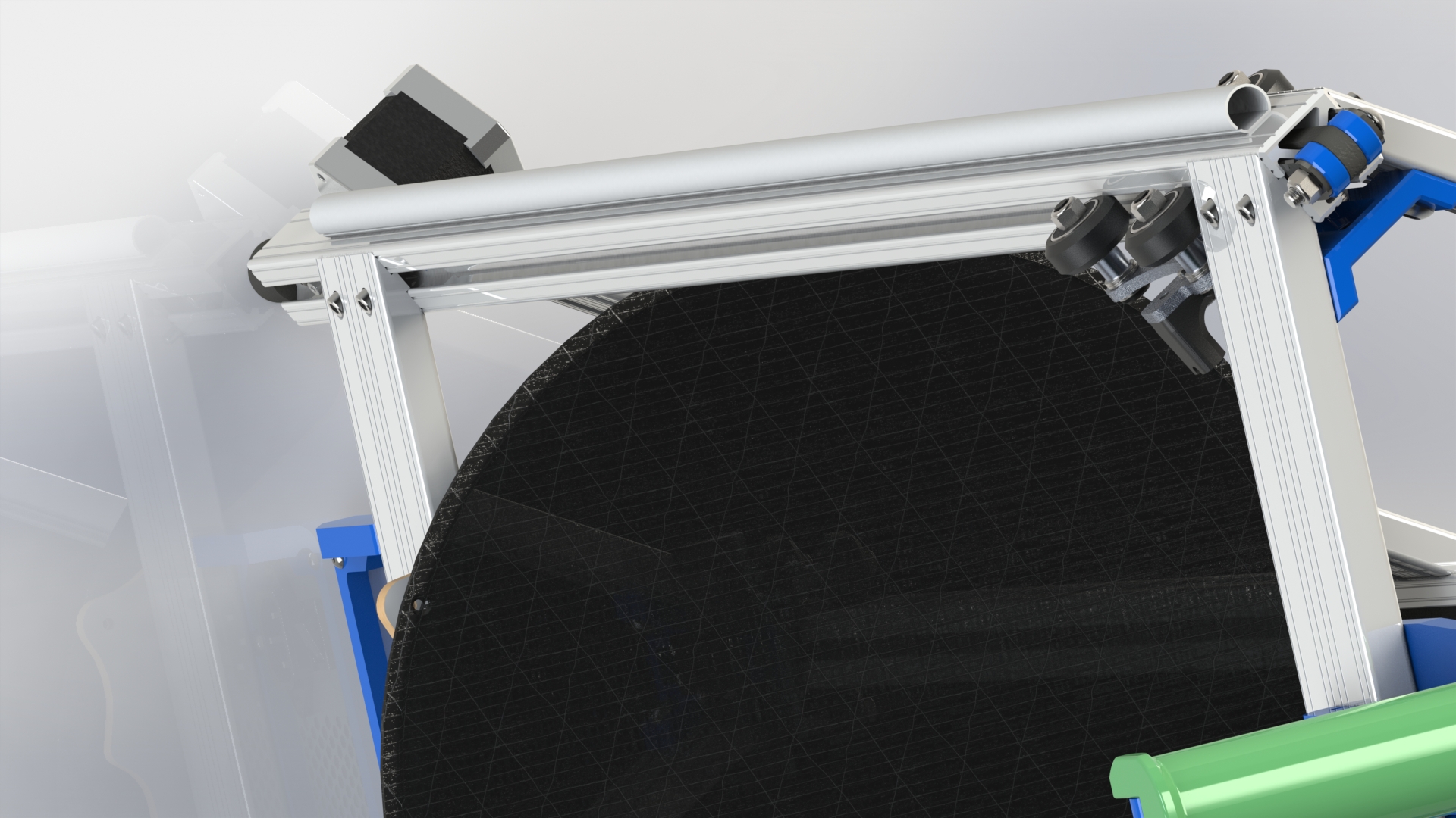

The last significant bits are to sort out wire routing. The easiest approach I've been able to conceive is to use some peel and stick wire track. This will route the extruder wires, hot end power, fans, etc. to the top of the frame. Menard's carries the round version shown and Lowe's has a 3/4" wide by 1/2" deep rectangular version with more room inside.
Option B is to use Geneb's extrusion clip and dowel approach used in the v1 assembly manual.
Wire track
Wire track
End stop wiring can go down the inner diameter of each tower extrusion with a couple of cross holes drilled close to the horizontals to avoid crossing paths with the belts and trucks. The exit holes can be placed on the eccentric side of the truck to allow a full range of motion. I'm considering designing up a drill guide to make hole placement easy and clean.
Other ideas?

bvandiepenbos
Posts: 923
Location: Goshen, IN
Post by bvandiepenbos »
It is a tight fit, but a 22 awg 8 conductor cable will pass through the center hole. On Rostock MAX builds I run one up each tower which gives me 24 wires up top, enough for everything. Make sure the wires you pick for endstops are not in the same tower as stepper motor wires... weird things happen.
Z tower wire = 6 for endstops, 2 for thermistor
Y tower wire = 4 for extruder motor, 2 for barrel fan, 2 for part fan
X tower wire = 2 for hot end +, 2 for hot end -, 2 for light ring, 2 spares
For this MAX METAL frame you will have to drill some cross access holes like ccavanaugh suggested.
His idea using the surface mount wire conduit would be easier.
You can create a wire passage by sliding a thin strip of plastic about 1/2"-9/16" wide in the t-slot, the v-wheels do not ride deep enough in slot to interfere. Someone on this forum had the clever idea of using plastic banding used for packaging, I think he got some at the UPS store.

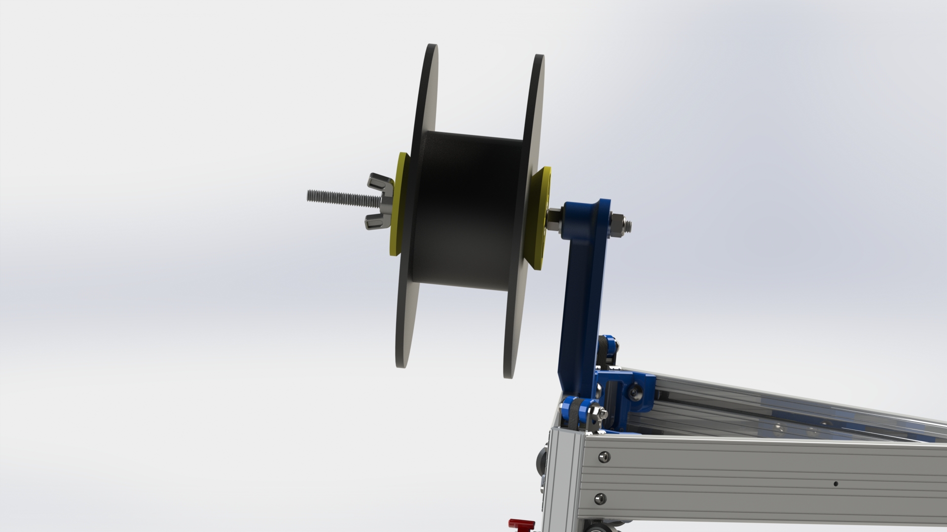

Gen 2 spool holder...
It uses 2 of the 608 Bearings. 5/16" or 8mm threaded rod will work.
