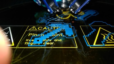

Now it was time to calibrate. I got it calibrated and went to print. the extruder came down about half way went towards the Y tower (the Y tower AGAIN!) and started printing there... *face palms* I tried to print again and the x tower went full speed down without the others! I tried to re-calibrate it, but the Z height kept changing on me!
So I gave up and re-uploaded the firmware and went through the calibration again, and that time it worked.

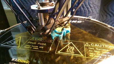

kapton tape is proving to be a little on the difficult side to lay without folds and air bubbles :/

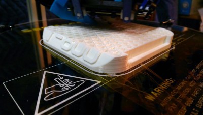

It has begun, my first long/big print (33h 30m)!
