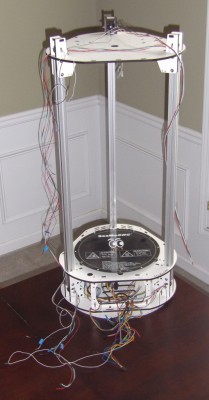

Okay . . . here I go again . . . resuming the process of completing my Rostock MAX™ v2 Desktop 3D Printer Kit
I have received permission to use the dining room table next week (because I have no air conditioning in the garage - thank you Ms. Sand)
The partially assembled printer is now on the dining room table
I'm in the process of finding all the parts (in the garage) and figuring out where I stopped building so I'll know where to resume
Here are the items I have for this build:
  • 1 x 84399, Rostock MAX™ v2 Desktop 3D Printer Kit - White, purchased Feb 21, 2015
  • 1 x 70861, Rostock MAX Ball-Cup Delta Arm Kit (new), purchased October 02, 2015
  • 1 x 70849, Injection Molded Cheapskate Carriage Set, purchased December 18, 2017
I'm mostly posting this for motivation - any encouragement will be most appreciated :)

Posts: 5358
Re: Red Sand's Max V2 Build Thread
Another modification I recommend is the 29A power supply kit - it's a big improvement over the ATX supply.
Good luck!
Posts: 1561
Post by Xenocrates »
Sand, you're pretty darn close. Wiring a V2 relatively stock isn't that bad, and the new parts will only speed up putting the carriages, belts, arms, and hotend together. And so long as you make some progress every time you work on it, you'll eventually get there. I have a friend who had a V3 that sat with just the bed to solder, and the the firmware loading to do for over a year (He did move in the middle, and so earns more than a bit of slack). It didn't take long to get it running, and the first test print came out looking pretty slick.
In other words, there's not too much left to do, and the pay-off is nice.

geneb wrote:Another modification I recommend is the 29A power supply kit - it's a big improvement over the ATX supply.
Good luck!
Thank you geneb & Xenocrates
Is this the power supply you recommend --> https://www.seemecnc.com/products/12-vo ... supply-kit
If so, I'll order it - anything else like spares or upgrades?
Thank you!
Posts: 5358
Yep, that's the beastie. :)
