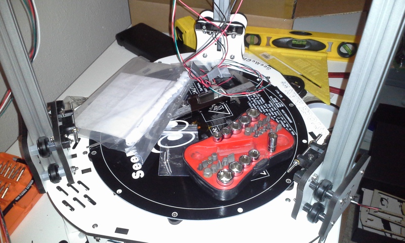

I have not attached the glass to the bed. I just set it on it. But I had the kapton tape for the middle still installed. I have not tried it without that yet. What made me think it is bevelled is going through the tower calibration process. As stated I think I have some wires bound up in the center under it. I will check that today and also remove the kapton tape on the bed thermistor.

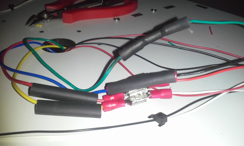

I checked the heatbed wires. They were kind of bound up. I am not sure that was the problem. Fixed it better anyway. I then attached the bed rather than torqued it. That may have been part of the problem as well.

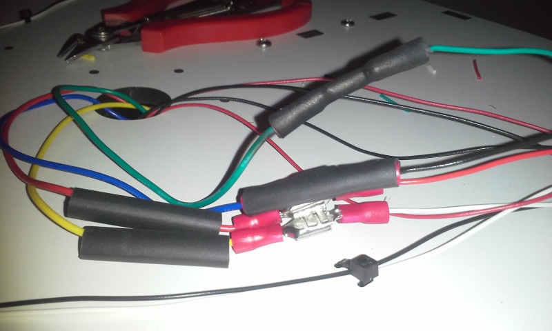

Got the skates, belts and extruder mounted. We did it a little different for the extruder connections. We used spade connectors and heatshrink rather than the twist and kapton tape. I like the look much better even though nobody will see it. We made one little screwup. We put the eyeball skate backs on upside down for 2 of the skates. The are physically the same just flipped 180deg. I double and triple checked that the cams are right and the arm bridge is in the right position. I dont see how it will matter and I am not going to take them apart until I upgrade the skates.

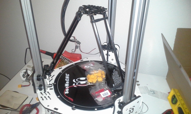

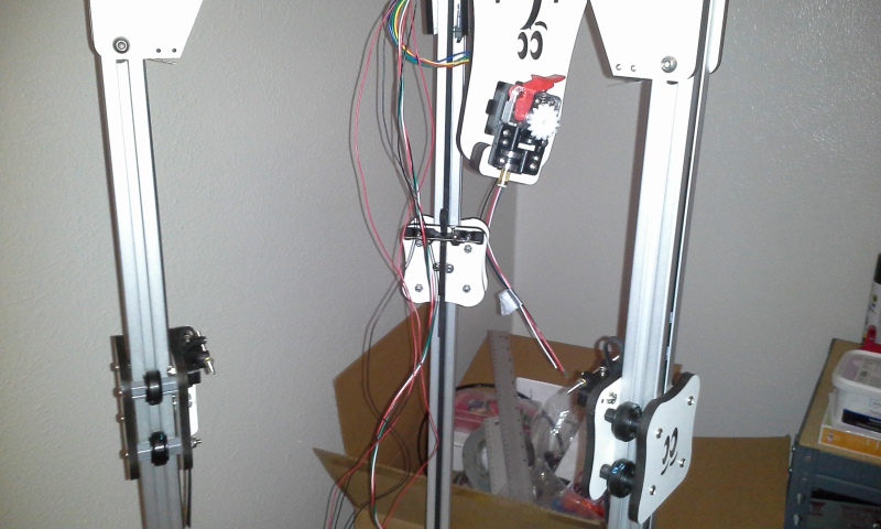

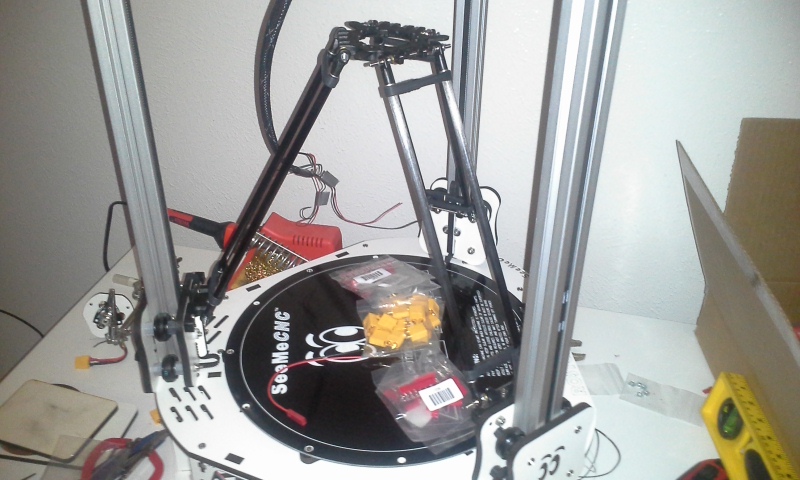

I got the TrickLaser arms installed. They seems pretty sweet but I have no comparison as I am putting them on at build time. I noticed in trying to invert the effector that you can 'kink' the arms to where they will not really be moveable without breaking them. Is this normal? I see that you have to position the effector in a certain way to invert it. In the vids it was just move skate all the way down/up and you should be able to go around to all 3. This was not my experience! Took me a sec to figure it out without damaging the arms.

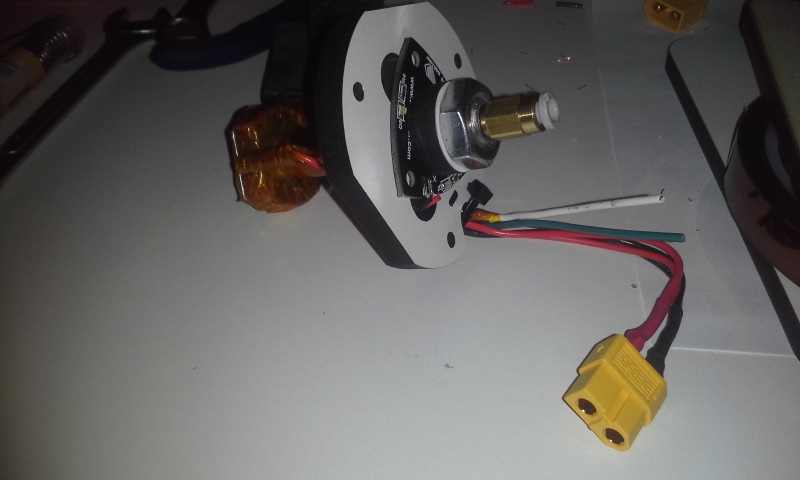

Hot end is coming together with connectors so I can swap it out or repair if needed. TrickLaser hotend heat indicator installed and wired directly to hotend.
These thermisor wires do seem really fragile. I hope I didnt break them taping it all up. I also got a decent square and redid the tower calibration. It was off by about 1/8" over a 8" distance on one tower. The other two were better. Now they are as close as they are going to get I think!

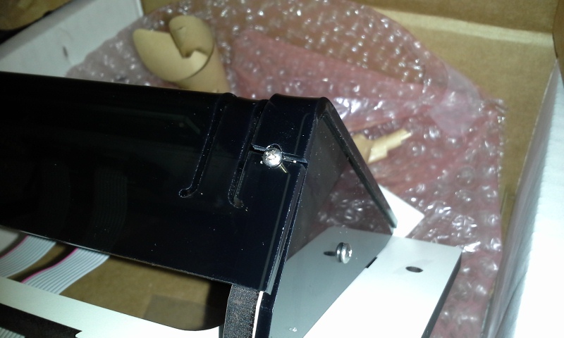

Arms are done and in the down position. Effector is mounted. Hotend is mounted and partially wired. Waiting on one more part. I splurged and got the TrickLaser LED light ring for the underside of the effector. Silly me. I though what I had purchased originally 9 months ago was the underside ring. It was not. Ah well. I think they will both look cool on it. Top of the top is on. Its easy enough to remove if I need to rewire the top for something. Spool holder is on.
Now my fuckup. How many LED smoke panels are cracked on the bottom right below the emergency stop button? Because mine is. Dammit I knew that would happen and just as I release the pressure of tightening the last screw. POP, cracked. I didnt even screw it down all the way. There is still a good 1/8" gap between the side panel and the bottom of the front plate. I am so bummed. I can handle the upside down eyes. But this just killed my night.

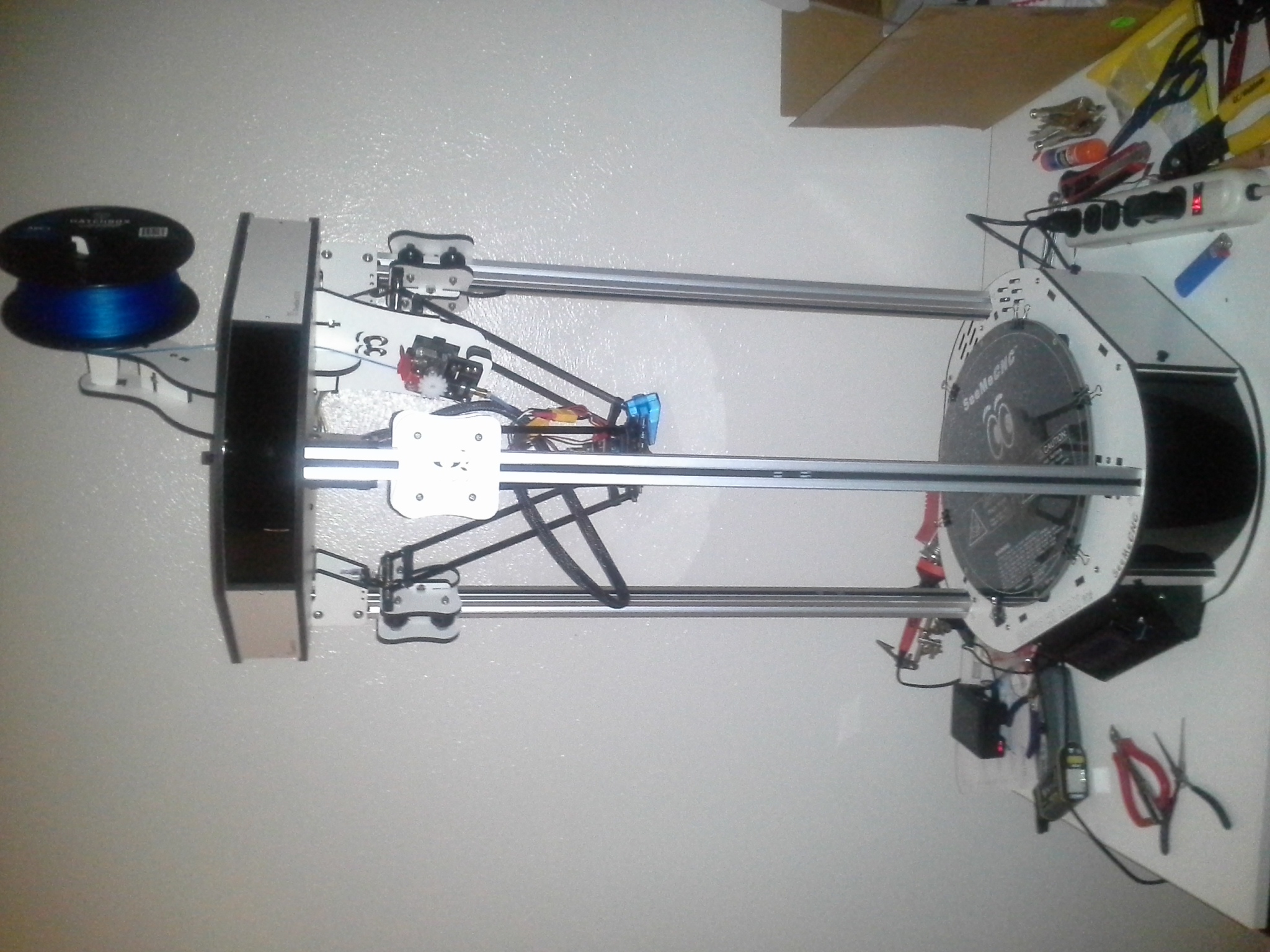

OK everything is done! I have calibrated the bed! It seems like the steppers are getting very, very hot though. So hot that I cannot keep my fingers on them after 10-15 seconds. Is this normal? I will get some exact temps as I do the first print as it has cooled down a bit now.
OK looking good now. Some small issues but overall I think it will be usable.

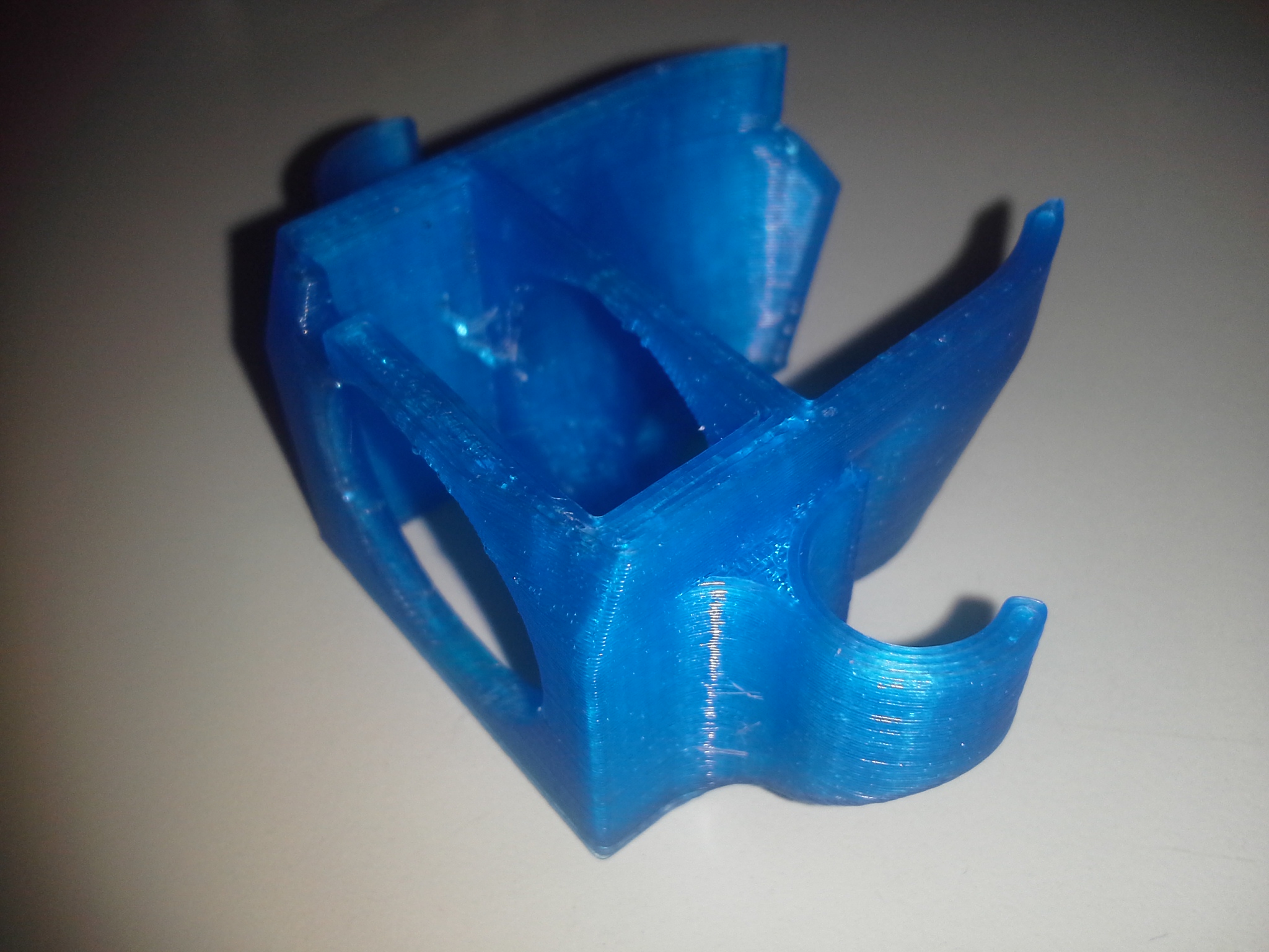

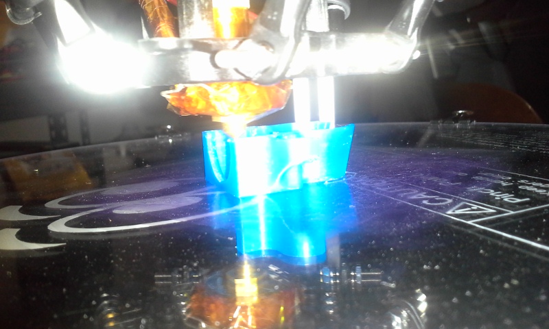

I guess its not too hot. The extruder is at 54c. It is printing KICK ASS though! I got some clear blue ABS from hatchbox and it seems to be doing really good! I am freaking ecstatic! First layer looks good from here. At layer 28 of the fan shroud now and I cant see any issues.

Overall this was a good build I think. I have had success right off the bat in printing the fan shrouds. Excellent kit SMCNC!
