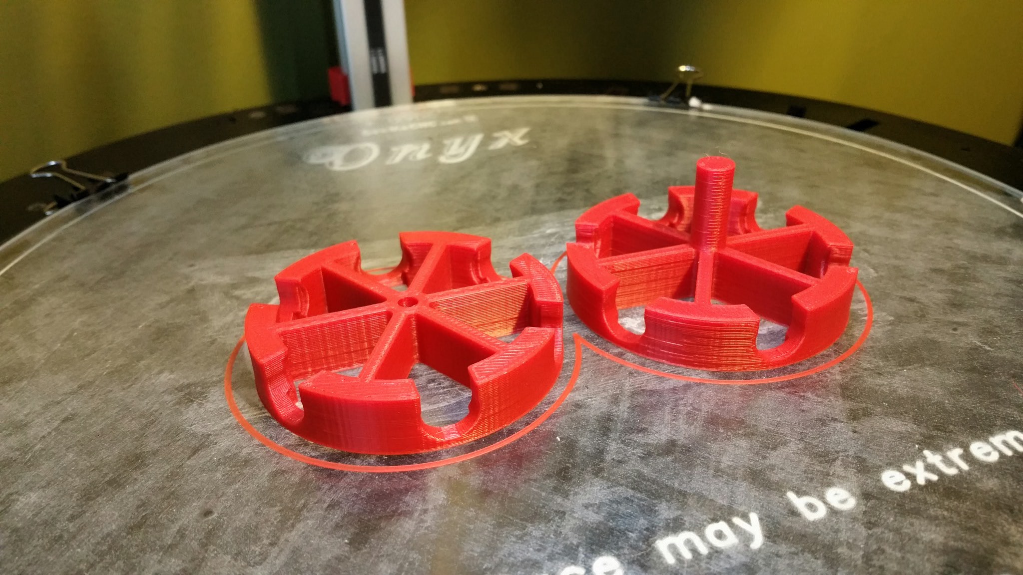

So I'm starting to get the hang of this software now and I definitely am enjoying what it has to offer over the others I have used. I am still having some issues with it (z-scar, weird top infill issues, and lacking alternative infill options) , but overall it is working pretty good for a new piece of software that I haven't mastered yet. I'm going to keep using it as my primary slicer and hopefully in a few months I can say that I don't regret buying it.
Here was my first customer print using S3D. Red IC3D ABS with 0.2mm layers and 70% infill with a solid layer every 10 layers. Solid 8 layer interface between wheel and spindle on RH part. Biggest negative about the print is that the wipe process at the end of each layer pushed material out (KISSlicer dominates S3D at this).
