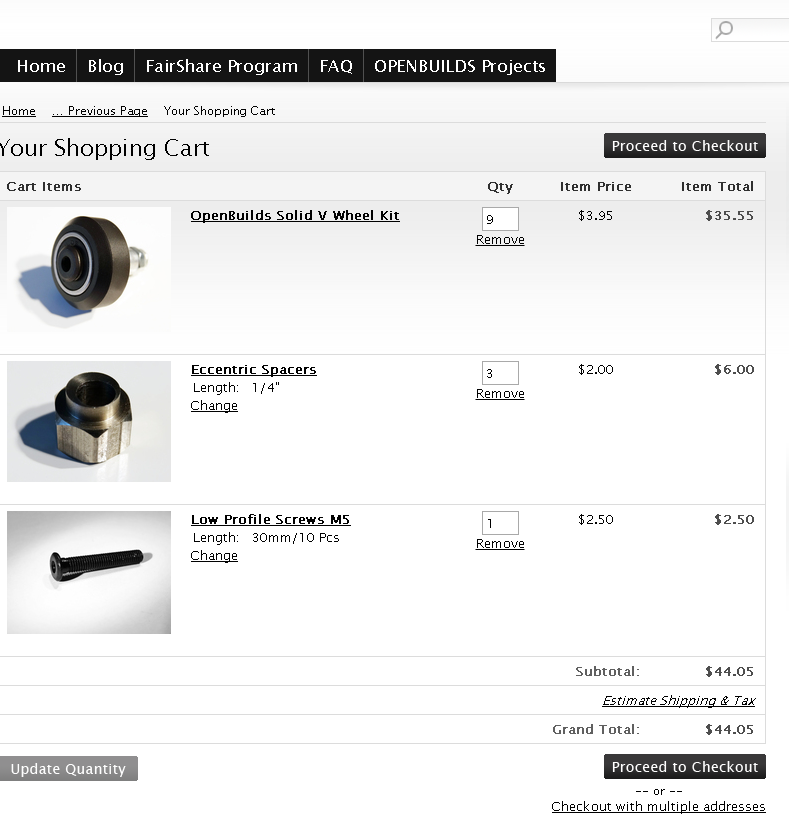

can you take a look at the v wheel kit, it has everything you listed except the eccentric spacer, but if you buy the kits looks like you can save a few bucks.
Have you tried the new Xtreme V wheels?

the wheel "kit" only comes with 25mm long screws, they need to be 30mm
with the wheel kits you still need (3) 1/4" eccentric spacers, (27) precision washers 1x5x10, and (9) 30mm long 5mm screws.
by the time you add that, the cost is the same.
Important note: you must stack (2) 1mm thick precision washers on top of the 1/4" spacers so truck clears the extrusion. I do not recommend regular washers, they are not a precise, consistent or flat.
I have not tried the "Extreme" wheels, but they are hard polycarbonate, which I think may ride rougher than the delrin plastic ones.

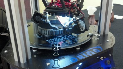

I agree, the V1 platform is a bit stiffer than the V2. I do like the 3 part fan mounting tabs on the V2... but you can still mount 3 part fans to V1 platform (see attached pic) I mount hot end below platform so the fans are mounted with long pieces of M3 threaded rod to get them close to platform. Added benefit is you can swivel fans on rods to point them blowing just past heater block.Jimustanguitar wrote:I've stuck with the two-piece V1 platform the whole time. It's much sturdier than the hollow V2 platform, IMO.0110-m-p wrote:Any thoughts on whether or not it is worth it to upgrade the platform and carriage bases on my V1 to V2 components when doing this upgrade? Supposedly the V2 platform is stiffer.
