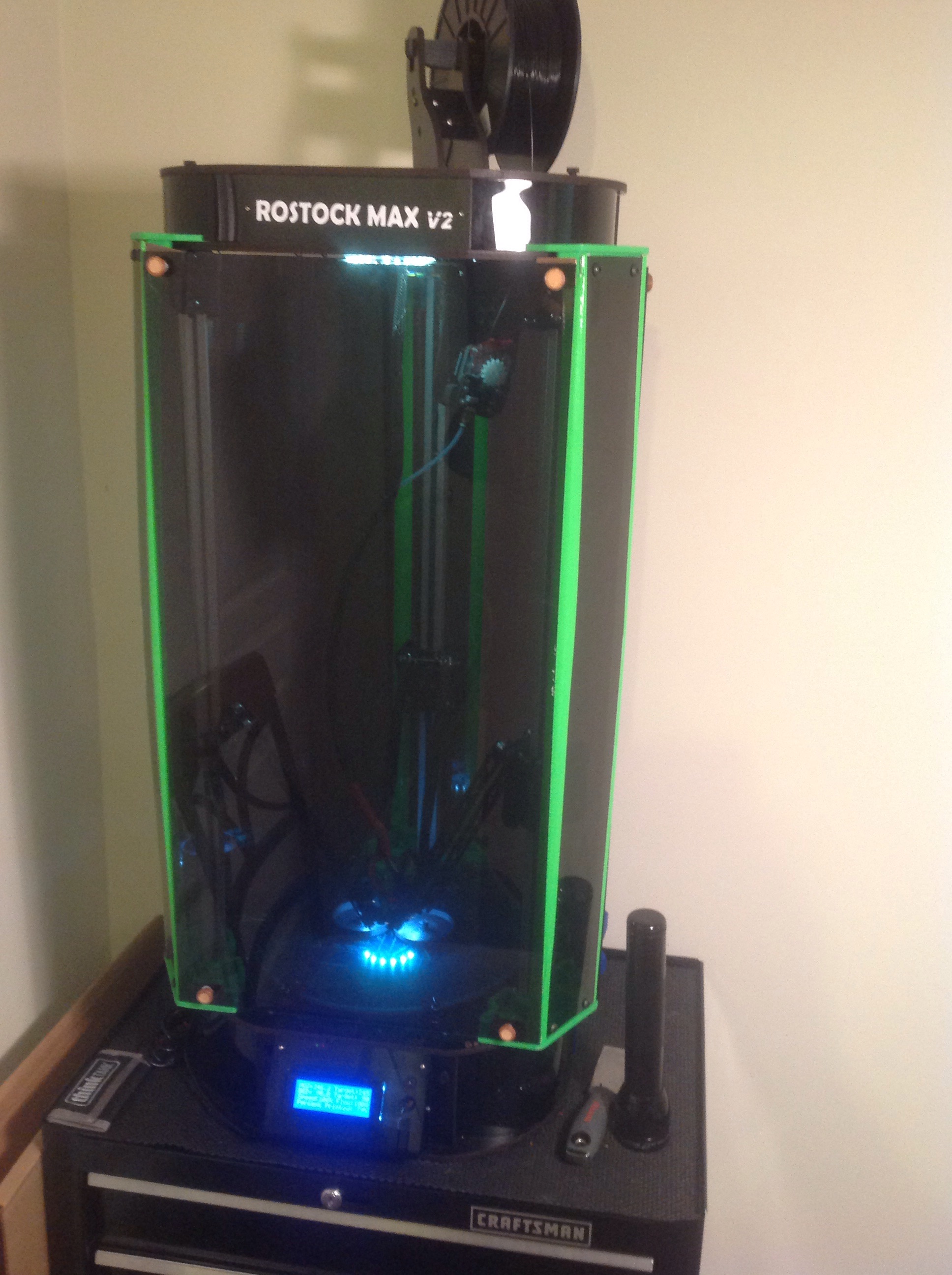

0110-m-p wrote:Got all the heat-set inserts installed and will hopefully be finishing it up this weekend. Still trying to decide if I want to spend the money on 1/4" acrylic panels for the entire enclosure or if I want to do painted wood with acrylic windows (would be MUCH cheaper).
Anyway on with the pictures...
Heat-set insert installation tip installed in my 40W soldering iron. Setting "4" on the iron seemed to work well.
[img]https://farm8.staticflickr.com/7580/151 ... c98f_b.jpg[/img]
Pre-loaded inserts into the first top and bottom mounting bracket. Holes are a little undersized for these inserts, but a bit of extra heat fixed that problem.
[img]https://farm8.staticflickr.com/7466/151 ... 2096_b.jpg[/img]
First set of inserts installed....really gives printed parts a more professional look.
[img]https://farm8.staticflickr.com/7580/155 ... e632_b.jpg[/img]
All mounting brackets complete with heat-set inserts...
[img]https://farm8.staticflickr.com/7570/155 ... a515_b.jpg[/img]
Shot of the stainless hardware and polycarbonate hinges that I am planning on using. Hinges will look awesome on acyrlic/polycarbonate doors...maybe not so much on wood :(.
[img]https://farm6.staticflickr.com/5616/157 ... dcaa_b.jpg[/img]

If you look at the box's of hardware, those are 1/4-20 screws. The blind nuts also work quite well for the purpose. I also advise not using the precise bracket design he is, if you have a V2, but rather the adapted design here: http://repables.com/r/719/

No changes at all in the lower bracket. Works perfectly well. I just need to print the shims to lock it in eventually. Or not, since it works just fine.

I used nuts and bolts to fasten th brackets to the horizontal surfaces. It was actually faster than printing the wedges < s >

Not using the wedges will save you a step in the future if you add more wires; I had to modify my wedges with a hole so I can run additional wires up the cheapskate channel slots for a second hotend and stepper motor cables for dual head printing. I am using plastic banding strips from packages to cover the wires inside the channel.

You could run those wires through the holes in the brackets that are outboard (I personally use them for tools). I find that cable ducting deals with the wires, even though it doesn't look nearly as nice. I do plan to eventually print out some nicer looking cable ducts, but that's a Soon™ project.

Looking good. Just realised I have spare acrylic from making an enclosure for a CNC mill, so it's time to get onto this I reckon. I've moved most of my cabling to a loom which runs up the back ages ago, so no worries on the channels. Might modify the Z tower top and bottom to support the conduit, but there should be another photo in here sometime soon :)

What color tint did you use on your enclosure? It has the perfect amount of dark. Also, what material is that? Acrylic or polycarbonate? How thick are the cuts? The original creator of these brackets recommends 1/4" thick.

I just made some tabs to lock the bottom brackets into place, you're more than welcome to use them. I've attached them to this post.
Xenocrates wrote:No changes at all in the lower bracket. Works perfectly well. I just need to print the shims to lock it in eventually. Or not, since it works just fine.
Bottom Bracket Slot Tab.STL
Tabs that lock the bottom brackets into place. Should need to print six of them, two for each bottom bracket.

Those wedges went in really well. So well, in fact, that I snapped 'em trying to dig them out again to remove the plates. Ooops.
I should have checked the parts in a CAD package before just printing them too - no McMaster Carr here in Oz and I'm struggling to find inserts big enough for the holes in those prints. Most are at least a couple mm smaller on the outer diameter.

Could you epoxy them in the larger holes?
