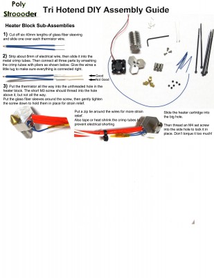

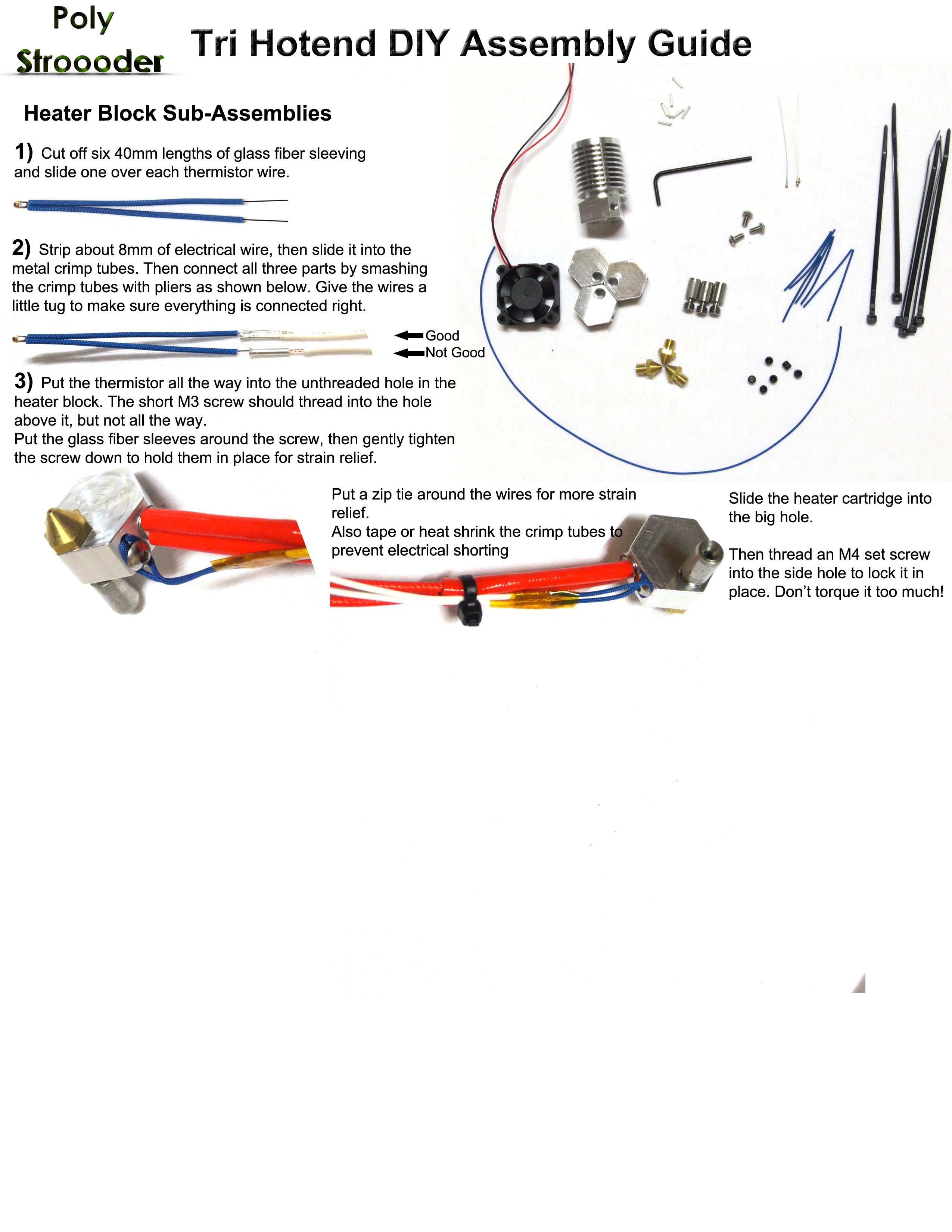

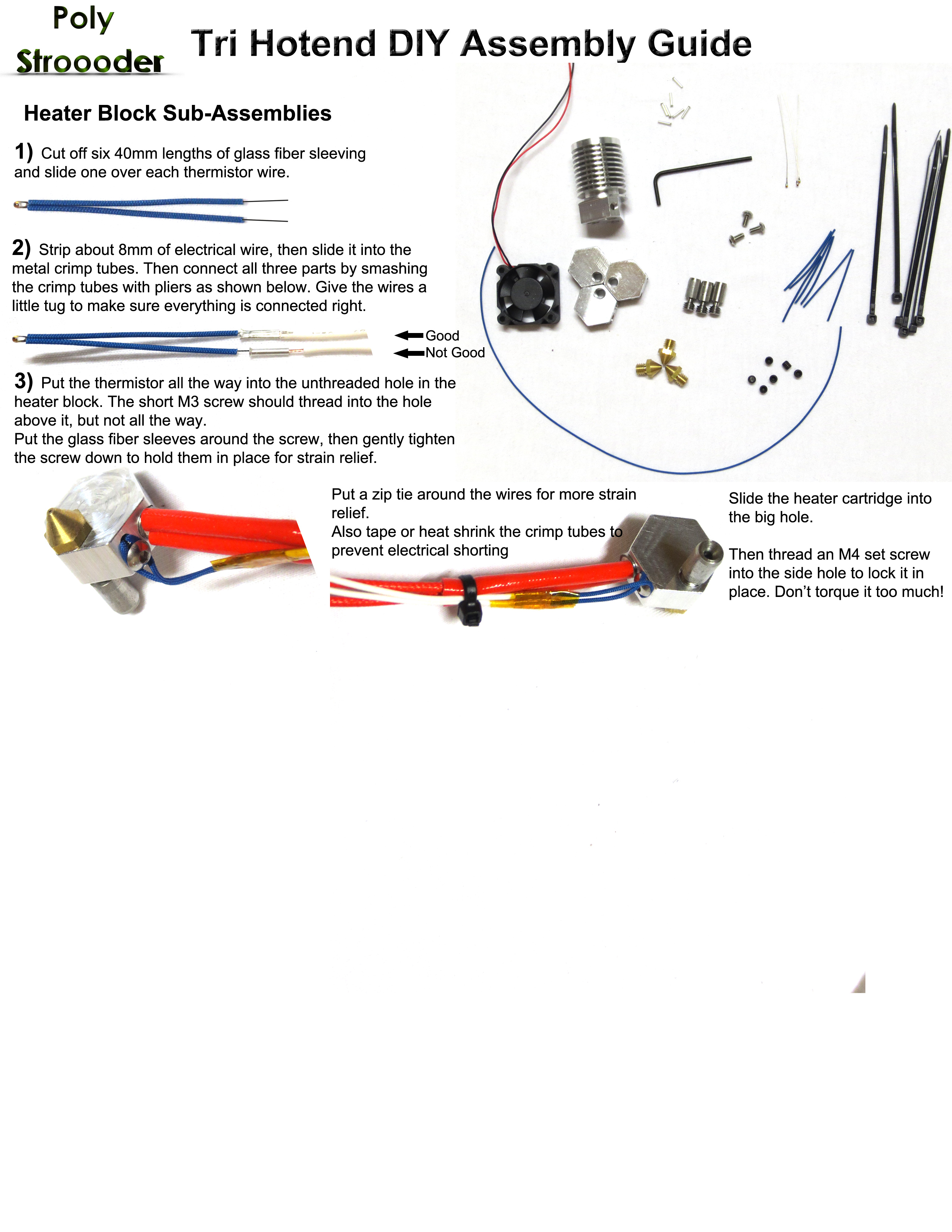

What comes in the box:
- 1 Tri heatsink
- 3 Tri hexagon heater blocks
- 3 Tri thermal isolators
- 1 0.50mm M6 brass nozzle
- 2 0.35mm M6 brass nozzles
- 3 2 foot long 2mmID 4mmOD PTFE bowden tubes
- 3 12v 40 watt 6mm heater cartridges
- 3 104GT-2 Semitec thermistors
- 6 uncut glass fiber sleeves (for thermistor connections)
- 7 crimp tubes (for thermistor connections)
- 6 short zip ties (for wire management)
- 6 uncut electrical wires (for thermistor connections)
- 1 30mm or 40mm 12 volt fan
- 6 M4 set screws
- 3 M3 short hex head screws (for the thermistors)
- 2 M3 long hex head screws (for the fan)
- 1 small hex wrench for the set screws
- Printed instructions and important information
What you need:
- A working 3d printer
- Basic assembly skills
- Pliers
- Scissors
- Electrical Multimeter (recommended) - Time
I just copy pasted that straight from polystroooder.com The kit will include everything you need (the Rostock Max/Orion adapter plate too) along with printed instructions for DIY assembly and some other paper stuff. I was just working on the assembly instructions now, I'll show you what I have so far;

That information was exactly what I was looking for, I must have missed it on the site.
I did figure out that for Repetier, the thermistors would be set for type 8, the same as the E3D.
Thanks for the info.
