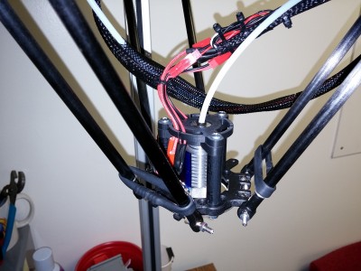

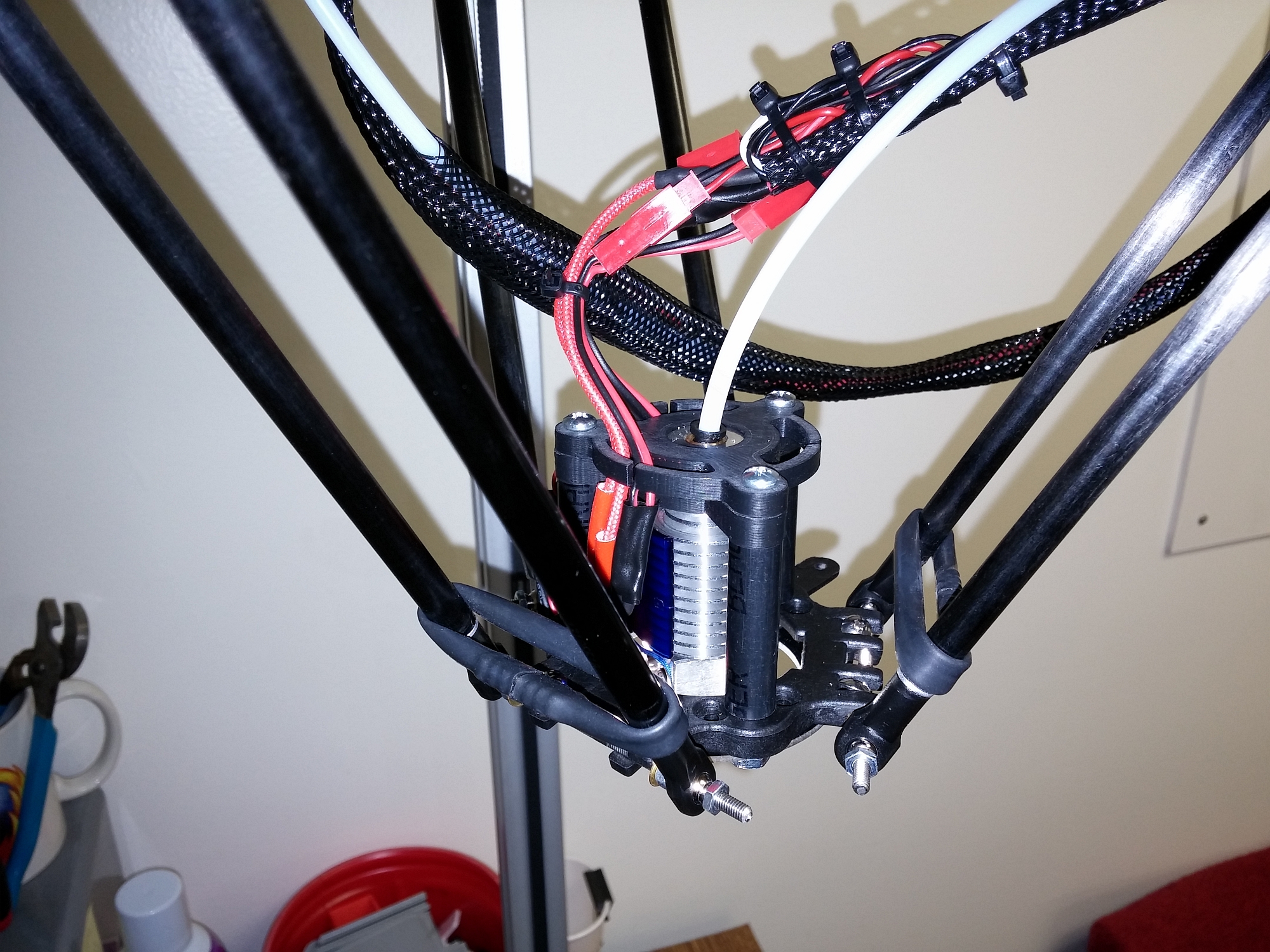

I installed the E3D V6. It was purchased from the Filastruder website.
The nozzles are about half the size of the stock nozzles.
Heating and cooling is much faster since the heat block is very small.
I used the SeeMeCNC J-Head mount with stock aluminum spacers and screws. Right now, I'm using a 1" fan that's wedged and hot glued in the space between the effector and the J-Head mount. A fan and decent speed is necessary for this hot end. I had the fan turned pretty low and the PLA jammed inside the steel liner.
[img]http://i.imgur.com/eqdLkit.jpg[/img]
[img]http://i.imgur.com/OWXv0TQ.jpg[/img]
The space between the effector and j-head mount is about half an inch too small to fit the blue fan holder + fan. I might order some spacers 3/8" OD, 3/16" ID, 1/2" aluminum spacers and 6-32 2.5" machine screws. If anyone wants to try to get a bulk discount on ordering those parts PM me.
