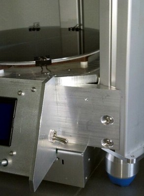

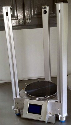

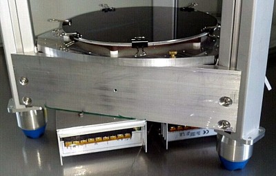

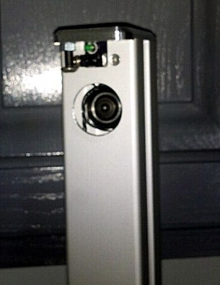

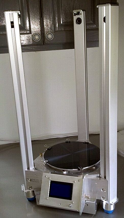

Here are a few progress pics of the V2 NEMESIS Air Delta 3D Printer production release version.
Made a few changes and refinements from v1...
-Simplified frame sides machined from 1/2" thick aluminum.
-Table made of precision ground Mic-6 aluminum tooling plate.
-Dual power supplies 12 volt & 24 volt
-Moved idler pulley inside extrusion
-Changed to optical end stop switches with LED
-Larger LCD mounted at angle for easy viewing
