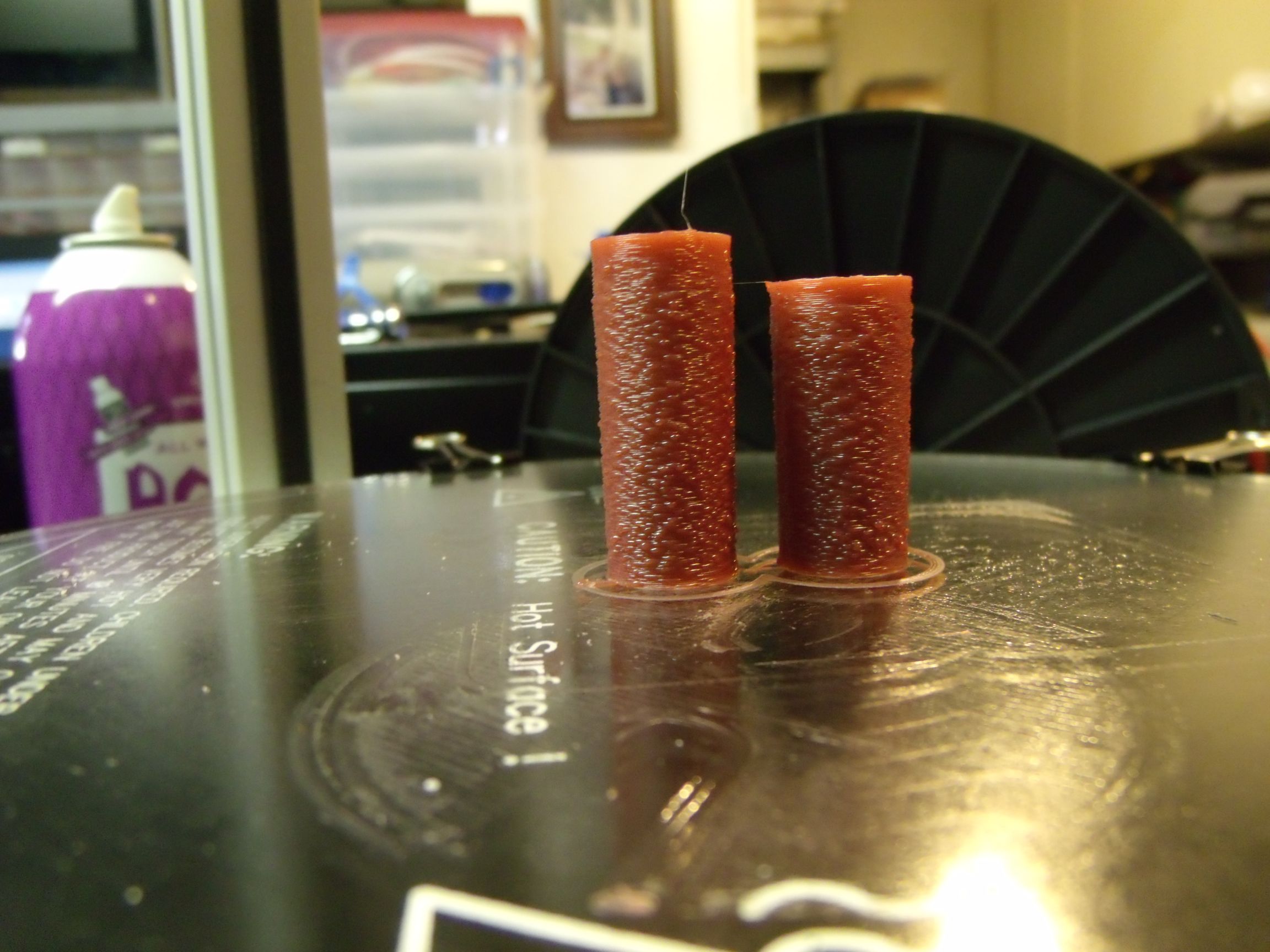

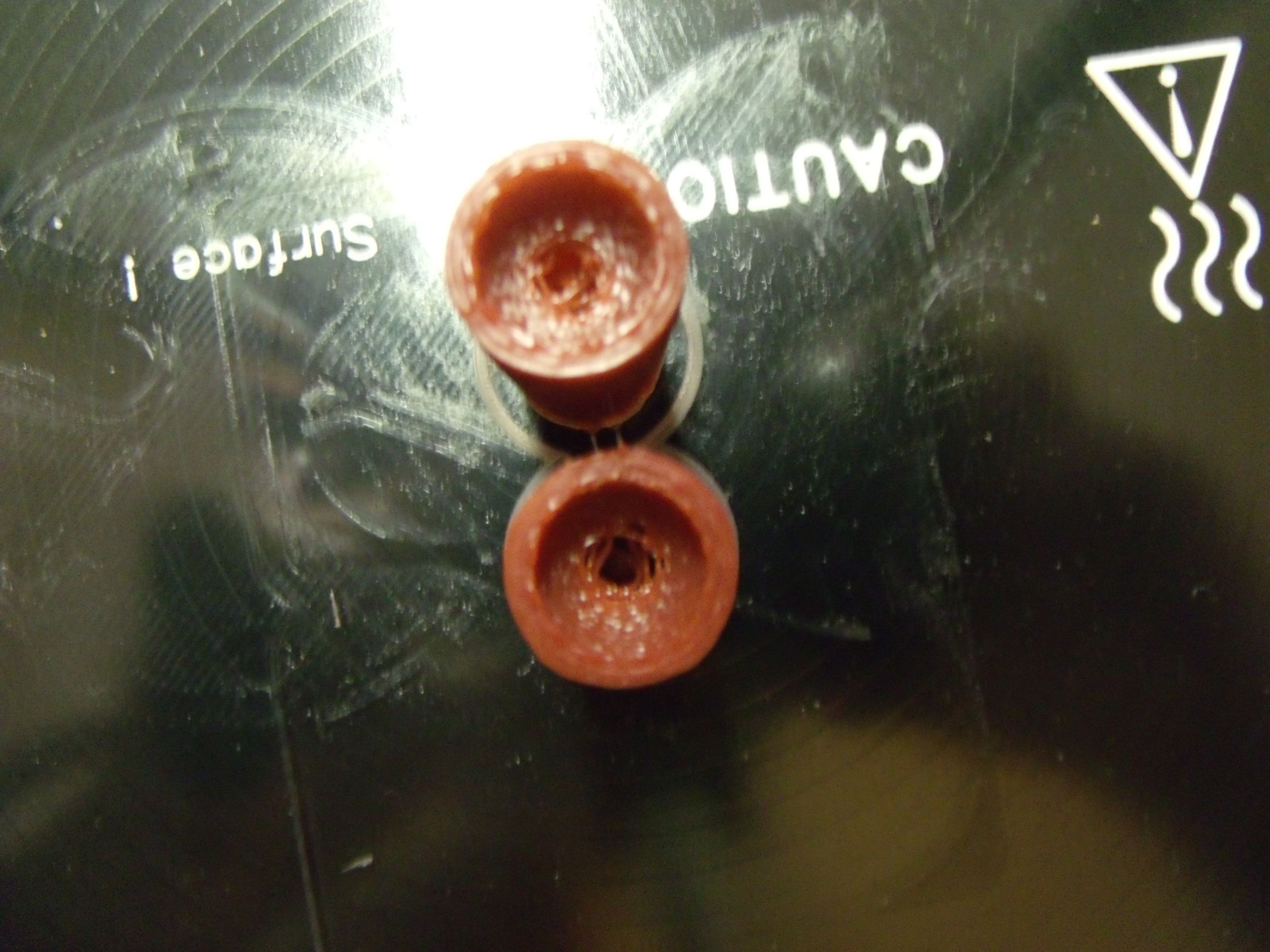

After printing the two Rod Ends. A couple of comments.
Printed with Cura with ABS at 230c, bed temp at 90c
The one at the rear is shorter than the one in the front.
The shorter one is the Rod End 5.7 5.3.stl
After printing these I question if maybe the cup end should be toward the glass for better quality of the cup.

At some point as I was making revs, I think I did extend the length of the rod end adapters, which is probably why one of them is shorter. I must've forgot about that revision.
Your ABS looks awfully bubbly - I wonder if that has anything to do with the quality of the bridging.
You're right that the original design has the cups printed down. For some reason, slic3r originally decided to lay mine down the other way (even though I drew it cup-down in Alibre).
Just for laughs, I tried it, and I actually decided I like it better that way - at least on my printer, I tend to see a "flare" on the first layer or two, and I felt like it would be better not to deal with that on the ball end. Here's a couple of photos, top and bottom:

[img]http://i.imgur.com/2uslQpYl.jpg[/img]
[img]http://i.imgur.com/0x9wmEGl.jpg[/img]

Yeah, Cura is my goto Slicer but not so good on the Rod ends. The outside of the cylinders feel like 80 grit sandpaper. I will reslice with Slic3r and see if Ibdjohns1 wrote:At some point as I was making revs, I think I did extend the length of the rod end adapters, which is probably why one of them is shorter. I must've forgot about that revision.![]()
can get better results. This is the first time where Cura has failed me. I will try adjusting some settings also, I will not give up on Cura! Of course if I wanted a real person's slicer I would plunk down $140 for Simplify 3D. NOT IN THIS LIFETIME!
Re: An easy magnetic ball solution.
I got good results on the rod ends both with slic3r 1.0.0 and with KISSlicer.
The bubbles might be an effect of your filament picking up moisture from the air. Might be time for your spool to spend the night in a 170F oven. Either that, extruding too hot, or too fast?
Thanks for the ideas, I think a little too hot at 230c I will retry at 210c.bdjohns1 wrote:I got good results on the rod ends both with slic3r 1.0.0 and with KISSlicer.
