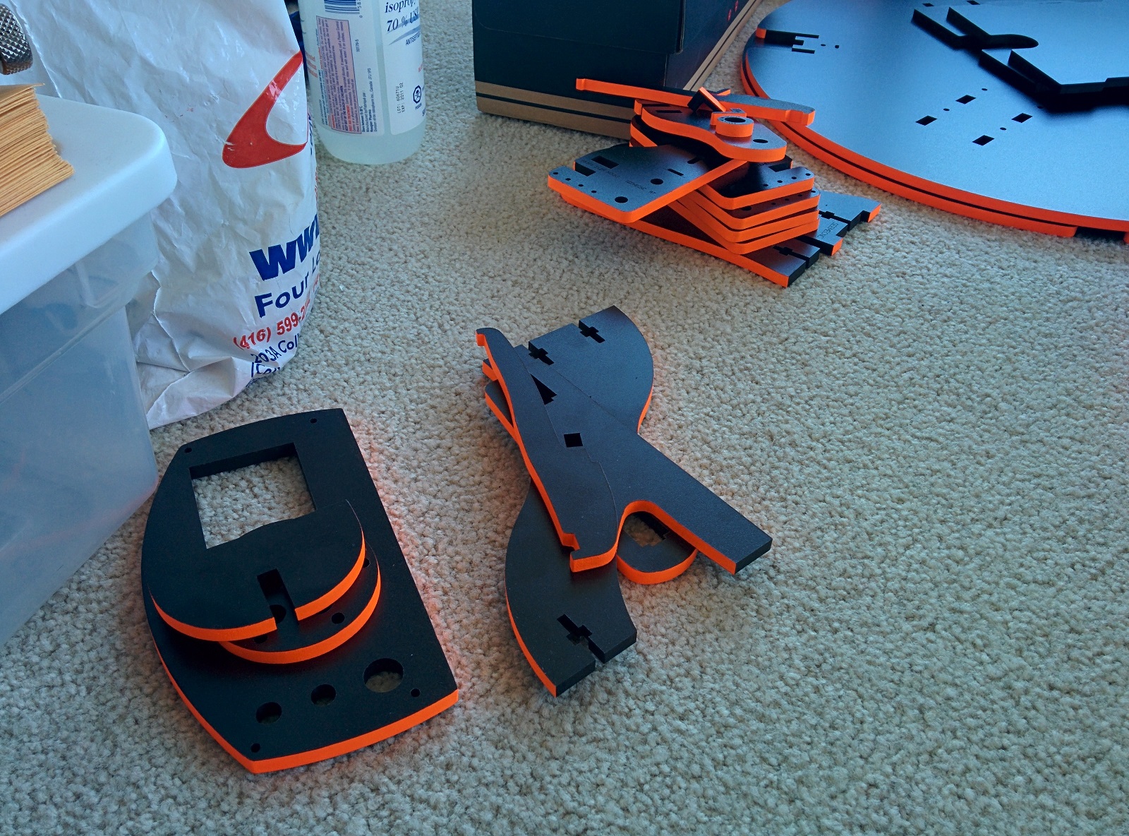

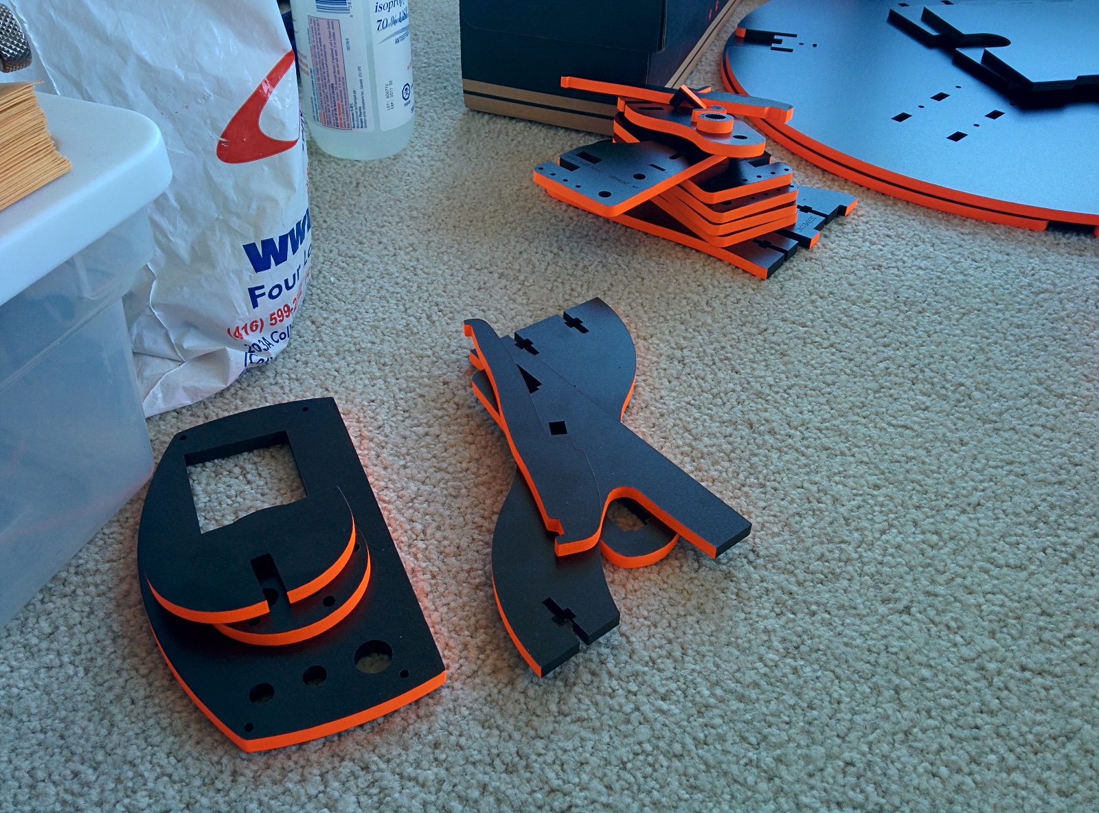

Re: GeraldO's Build
That orange looks good on the black background.GeraldO wrote:Well my replicator was good at making people deaf so I'm hoping to blind people with the orange awesomeness instead
The masking tape is coming off and it looks fantastic!
Re: GeraldO's Build
Thanks!GBIADS wrote:That orange looks good on the black background.GeraldO wrote:Well my replicator was good at making people deaf so I'm hoping to blind people with the orange awesomeness instead

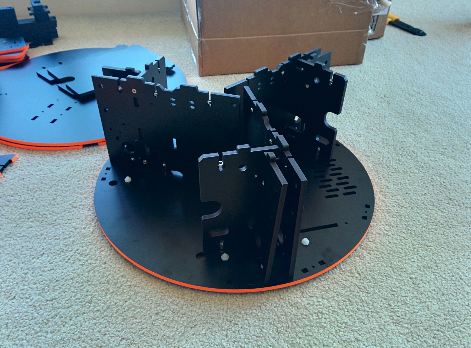

Construction getting kind of slowed now because I need to source some M3x5 bolts for the Astrosyn dampers I bought from Cope. I have a box of 100 M3x10 bolts so I may just grind down a few to size instead of trying to find some M3x5s locally (impossible in Vancouver on the weekend).
That being said, all of the masking tape is off and the base is underway!

Re: GeraldO's Build
The more you take pictures and the Orange shows up the more I like it. Is that a florescent Orange?
Re: GeraldO's Build
Yup! We used acrylic fluorescent orange with an undercoat of pure white to help it pop out.
Providing humanity its only hope when the robot revolution begins: http://www.anti-robot.com/! Join the anti-robot revolution!
Re: GeraldO's Build
Pop out is a good description. I can't wait to see it fully assembled because this has to be the most colorful build I haveGeraldO wrote:Yup! We used acrylic fluorescent orange with an undercoat of pure white to help it pop out.

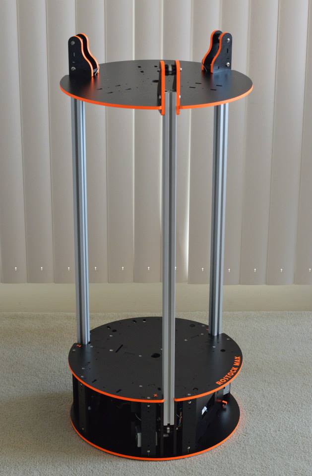

Re: GeraldO's Build
Got the towers up and am assembling the u-joints for the carriages. There's going to be lots of sanding as the aluminum joints are not fitting into carriage u-joints at all.
I have trick laser arms in the mail so I guess I can afford to just make it work for now and replace them during the week.
Re: GeraldO's Build
After futzing with sanding the cams I decided just to wait until the Trick laser arms arrive early next week :p

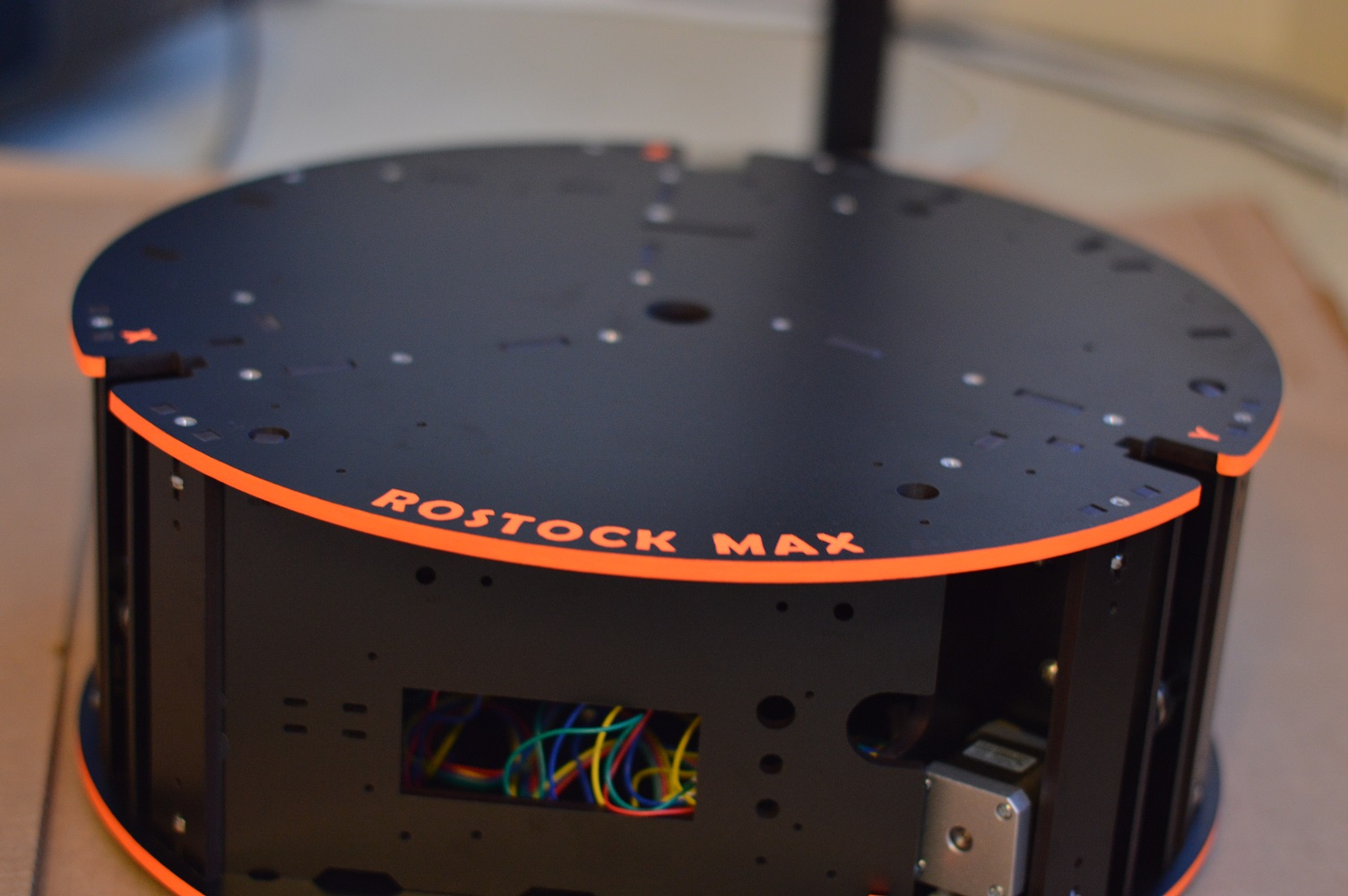

Re: GeraldO's Build

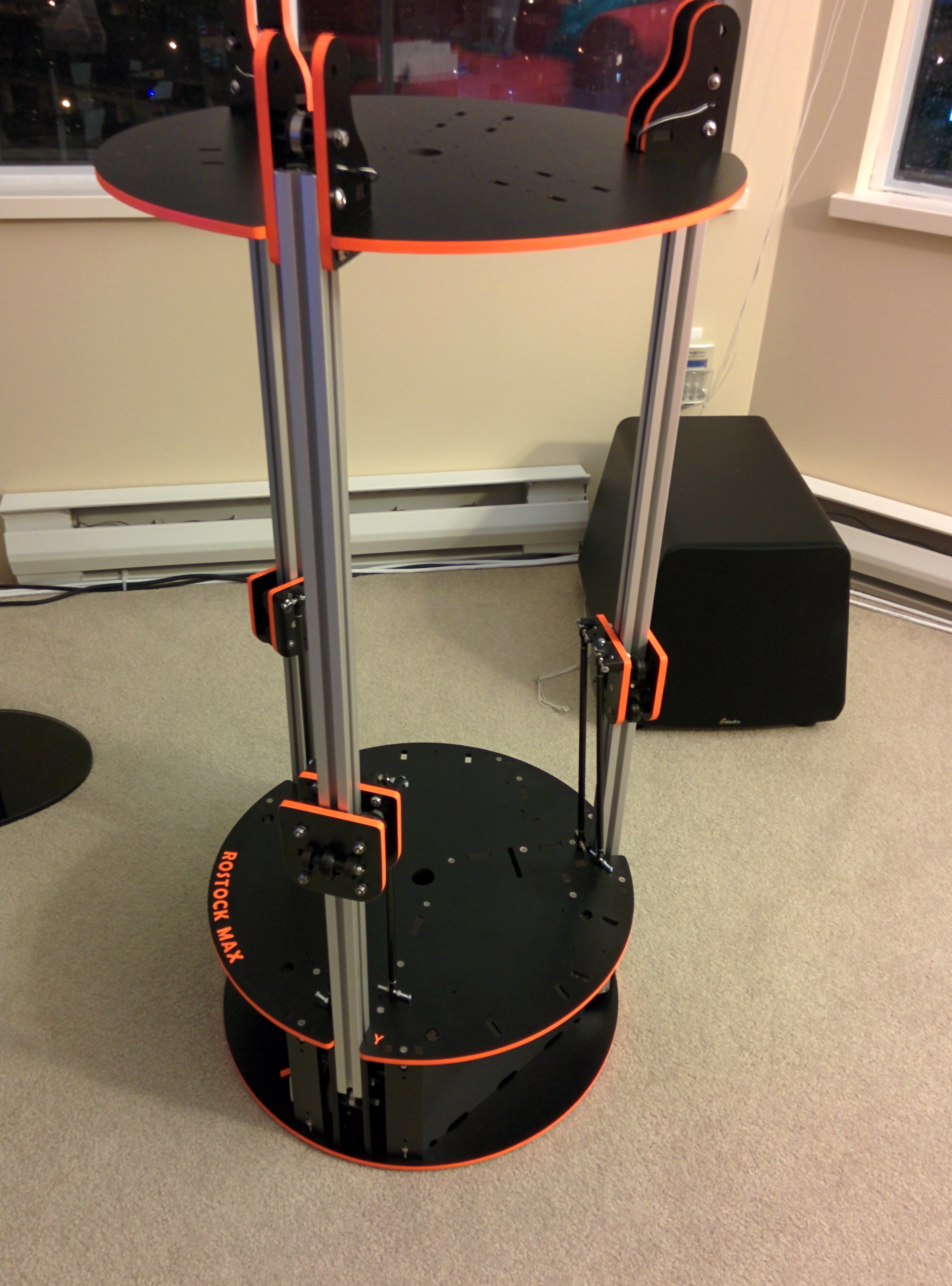

Well here's where we got to before stopping with the cams.
I also started getting a head start on soldering up the connectors for the hot end and the HBP. RTV is curing and most solder joints are ready for JST connectors. Will resume after I get those new delta arms.

Re: GeraldO's Build
Looking Good!

Alrighty! Back to the build! I didn't have much time today however, I *DID* get the carriages and trick laser arms attached. I also bought the "add an inch" plates for the tower carriages because who doesn't like an extra inch?
Here she is! The bearings are all setup and tensioned with the carriages moving freely up and down but in no other direction. Hopefully I'll be printing this weekend!

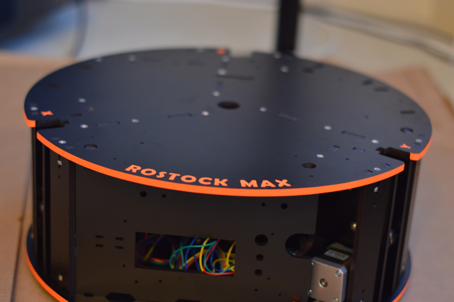

Success! Machine has been built and powers on! Vrefs were set way WAYYY too high on my DRV8825s but I think I'm in a good spot w/ theri trimpots. Tested heating and it maintains a stable temperature! Motion is still a bit weird but I haven't calibrated end-stops or z-height yet.
Pics will be up once it gets cleaned up a bit-- but it looks great!

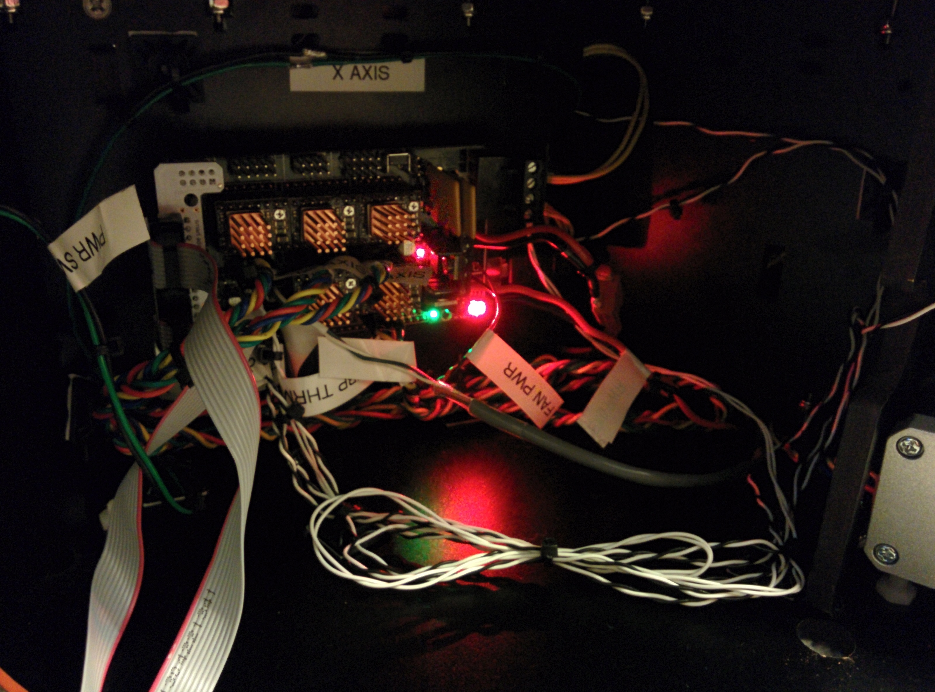

Well, I don't have pics of the frame but I'm fast calibrating this thing and after a few days it's starting to look like I can get good prints out of it. I didn't even need to adjust the delta radius!
Until I get more exterior pics, I took a lot of time to organize cables in the electronics bay. It needs a fan to cool the DRV8825s but it's nice and clean!

I do like those heatsinks you are using. They look great and I bet they work good.
Re: GeraldO's Build

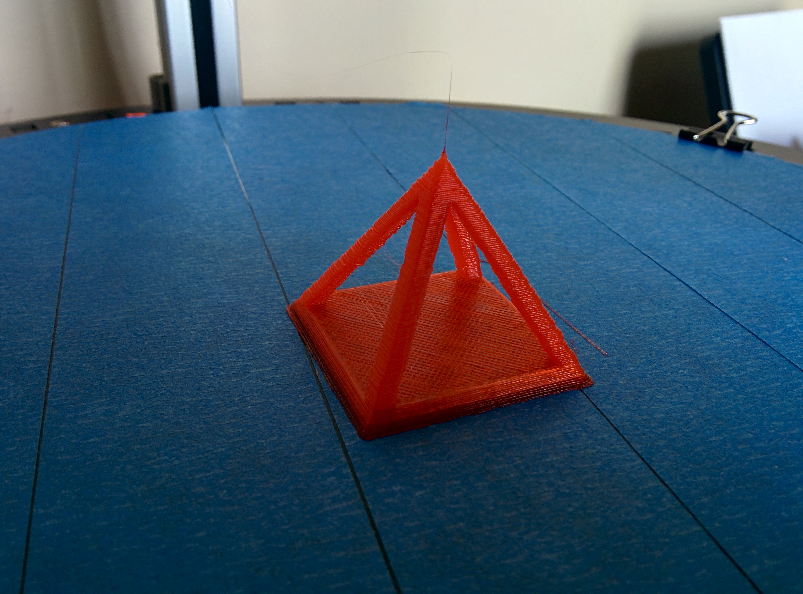

They're doing a pretty good job. Keeping the steppers warm to the touch, but not hot. My extruder is cranked up a little higher and is uncomfortable to the touch but not super hot.
That being said, I'm running into some problems right now with my layer alignment. I seem to have my retraction dialed in but my layers are all over the place. Take a look at the pic below of the hollow calibration pyramid: Retraction looks great but the layers rarely align. Here's what I've checked so far to try to resolve the problem:
= Retension belts (they're very firmly tight now)
= Double checked vrefs aren't set too high (heatsinks are warm but not overly hot, no thunking audible for missed steps)
= Using trick laser arms so I'm pretty sure I don't have the delta arms blues (no arm binding and the effector plate moves freely in all directions) I'm also using their zero-lash straps (rubber bands)
= Ensured freedom of motion for the carriages (eccentric cam adjustments) and ensured that the carriages can only move up/down and not side-side or rotate at all
Any help or insight into the problem would be greatly appreciated -- it's so close to being 100% awesome!!
