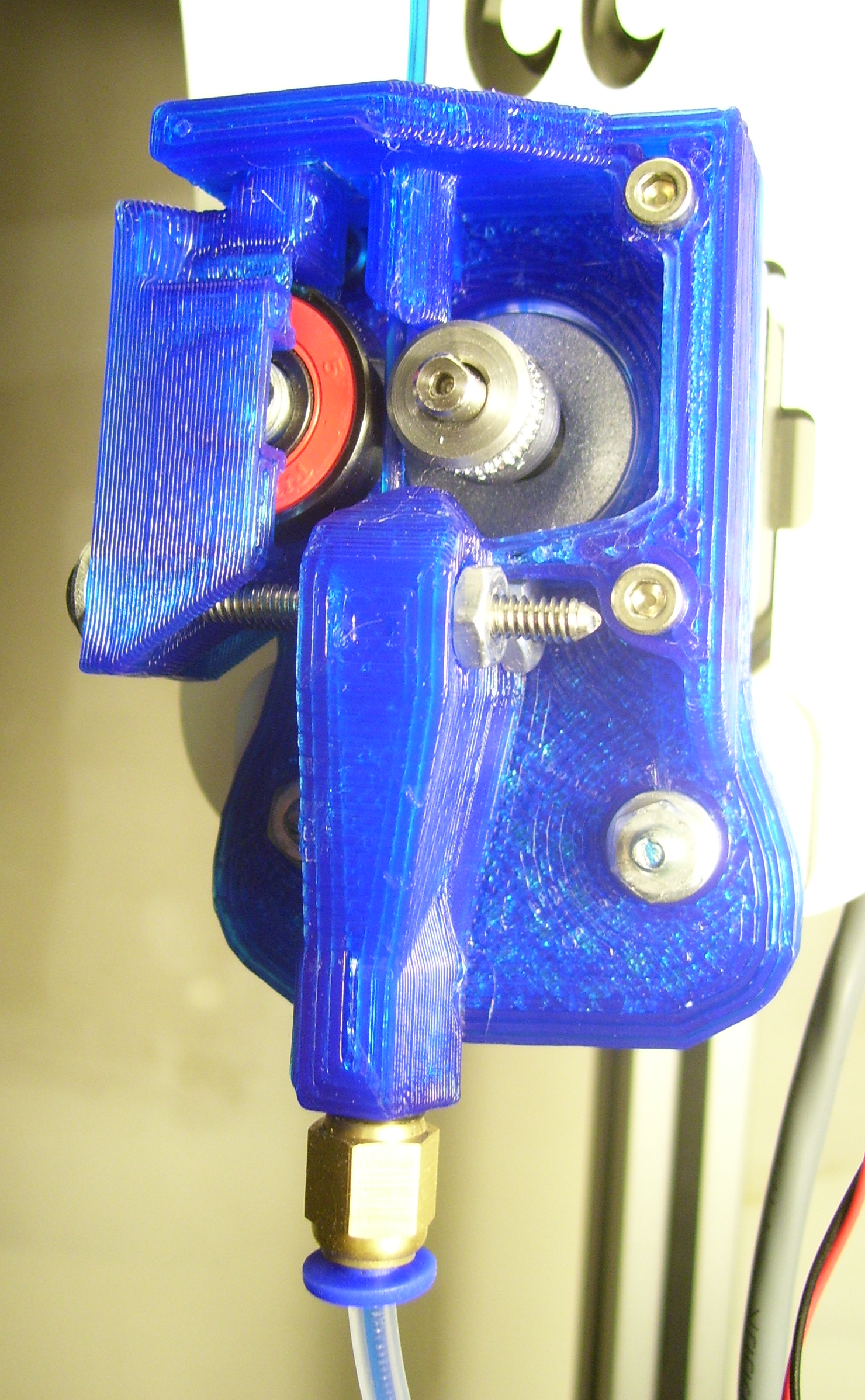

EZ Extruder skips
Re: EZ Extruder skips
How does the resistance feel when you're manually pushing filament from the extruder end of the bowden tube? You may have hit a case where there's a bit of a narrow spot in the bowden tube, but that would be pretty surprising.
Post by osr »
There's significantly more force required to push filament through the tube than to just push it through the extruder, but it's not hard to do. When the printhead is up high and the tube has a loop in it, there seems to be more friction. Should I lubricate the inside of the tube? What should I use?

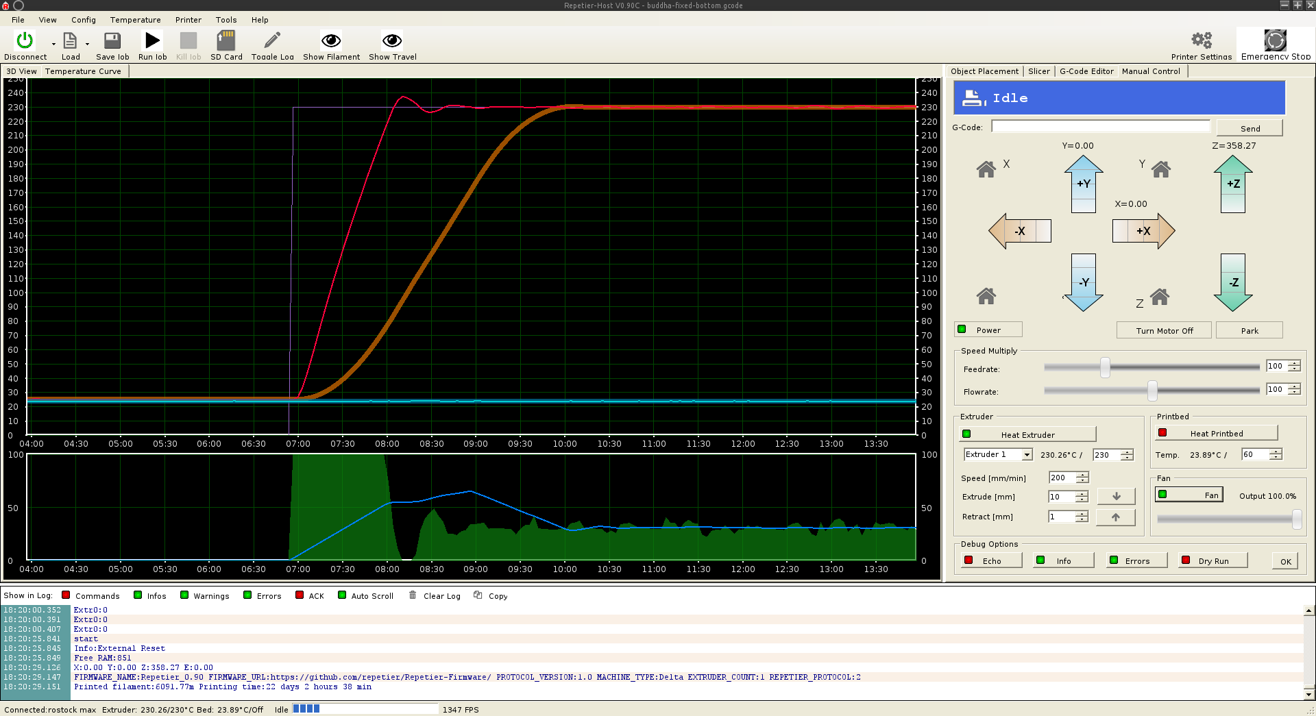

Here's what I would do. COMPLETELY disassemble the hot end, including unscrewing the PEEK from everything else and carefully inspecting it and the PTFE liners. You may find a thin layer of plastic hanging around on the outside of the inner or outer liners (or both.) You can remove that pretty easy as it will be thin and won't adhere well to the PTFE. (Yay for Teflon, I guess.) Make sure that the ends of the liner tubes are completely flat, of equal length, exactly long enough to reach from the top of the inside of the hot end to the nozzle when screwed in, and that there are no burrs. Inspect the inside of the metal and PEEK components and ensure no plastic is hanging out in there either. What happens is that this plastic will swell and increase the feed pressure, and then the cussing starts.
IF:
  • The inside of the hot end and both PTFE liners are clean and free of burrs;
  • The hot end is assembled tightly, with no room for plastic to get out;
  • The nozzle is not clogged and free of burrs;
  • The temperature is correct (might want to verify with a thermocouple, since the thermistor can't be sworn in);
  • The PEEK section is cooled with a fan and shroud;
  • The fan shroud is insulated w/ Kapton tape to prevent it from leaking air down onto the hot end;
  • Your PID loop is tuned well*;
  • Your extruder steps/mm is calibrated correctly; and
  • Your heat is correct for the filament...
...then you should be good to go.
The asterisk for the PID loop is because I don't use the SeeMe hot end anymore. Someone who does can tell you where the duty cycle (% of time turned on) should be in Repetier. That's the lower of the two curves in the Temperature Curve tab. I have an E3D hot end, and when I've had some issue the duty cycle has often been 50-80%. The usual duty cycle is 25-35%. When it shoots up too far above normal, it means something's wrong and you're likely to have critical melt creep sooner or later. The automated PID tuning you get with Repetier is okay but not that great. It produces a duty cycle that looks like an earthquake on a seizmograph. For even heating, it should look more like the profile of a gentle mountain range (see attachment).
I got a lot better at PID tuning after I read this: http://www.pcbheaven.com/wikipages/PID_Theory/ (way more useful than the Wikipedia article)
Repetier also has a "dead time" heat manager that you can elect by changing the heat manager in EEPROM from 1 to 3. You have to be using a newer version to get that feature. Information is here. I don't like it as much as PID tuning beacuse the duty cycle curve can be made a lot flatter with PID.
If all that doesn't work, I recommend upgrading to an E3D all-metal hot end. It can withstand much higher temperatures and has fewer things to go wrong with it. There's a huge thread here if you're interested.

I spent some more time trying to get my Rostock max to work properly today. I tried most of your suggestions, 626pilot. I wish I could say I found a chunk of plastic in the hot end or something, but there wasn't anything obvious. I replaced the teflon tube again, carefully shaving away slices until the pneumatic fitting just touched it as the o-ring compressed. I could still see through it, but the inside of my 0.5mm nozzle looked a little dirty, so I installed a new 0.7mm nozzle. I don't have a thermocouple, but the temp couldn't be too far off could it? I've tried everything between 190c and 220c, so even if it was a few degrees off I must have been at the perfect temp at some point. I have a peek fan and shroud already, but I used the tape as you suggested. My temp curve looks almost as nice as yours, never varying more than a degree. I also cleaned my extruder gear again. I printed an object at 30mm/s (infill, perimeters, etc...) and I would say that the skipping went from constant to every so often. I'm not sure which of the things I did caused the improvement, but it wasn't enough. Increasing the speed to 40mm/s gave me constant skipping again. Squeezing the bearing against the filament by hand puts a stop to it, and I held it that way for a few minutes to see if the bowden tube would pull out of its fitting. It didn't. I can't say that my hot end is set up perfectly, but there doesn't seem to be anything wrong with it. I can easily feed filament by hand, and if I pause the print and try again when the skipping is at its worst, there doesn't seem to be any extra resistance in the hot end. Maybe the teeth on the extruder gear are too sharp. Maybe I'm expecting more speed than it can handle. It doesn't really matter, because I'm not interested in fighting with the EZ extruder any longer. I'm going to have to replace it with something that will securely clamp down on the filament, but I'm not sure what. The easiest thing I can think of is the airtripper design, since I can mount it to the existing bracket. I might try that first. The Greg's Wade reloaded is what I have on my Prusas, and it works very well. If I hold the spool above the printer so it can't turn, it has a good enough grip to lift the entire printer off the table and climb the filament. This is the extruder I'm most familiar with, but I'd love to hear everyone's recommendations.
foshon wrote:IMHO, the wades in any variation is far from a better solution. First, the drive gears are printed. Any flaw in the eccentricity of the printed gears is transferred to your print. Second, these gears wear; meaning the first revolution after you set them your settings have changed, a very tiny amount sure but they have changed.
I would agree with you if my EZ extruder worked the way it's supposed to, but I'd rather have any other extruder at this point. You're right about the printed gears. They do have to be perfectly flat and round to get a nice smooth extrusion, but that's not too difficult a thing to do when you have a 3D printer. Backlash can be a problem too, but I haven't seen much since I switched to herringbone gears. I haven't noticed any wear on my PLA gears. Are yours ABS? I wish SeemeCNC would injection mold some. Are you using the EZ extruder on your Rostock? How fast can it go?

The 0.7mm is working much better than the 0.5mm. I can print at 30mm/s now, with just a few random skips, and now that I've lowered the current, they aren't as noticeable as before. I am starting to suspect that the diameter of my 0.5mm nozzle might be off, because the print quality is much better with the 0.7mm nozzle. The beads melt into each other now, but before they were just next to each other. I entered a lower than actual filament diameter to compensate for it before, but it's no longer necessary with the 0.7mm nozzle. After I've cleaned the 0.5mm nozzle, I'll measure the filament extruded from it. It's soaking in alcohol now. I've never turned on the hot end without the nozzle attached, but I slid a piece of filament through while I was assembling it, and there wasn't any friction. I did check my bowden tube for resistance before, and it seemed to catch slightly where the pnuematic fittings had dug into it, so I cut the tips off of both ends. Now it slides right through. I still can't go much faster than 30mm/s without constant skipping though. I think I was just unlucky and got a bad gear or a weak spring or something. How fast can you print with your EZ-struder?
I went ahead and modified the airtripper design to bolt to the EZ-studer mount. Actually, I started with the BI version since I only have 608 bearings on hand. Here's the link to that mod.
http://bootsindustries.com/portfolio-it ... i-edition/

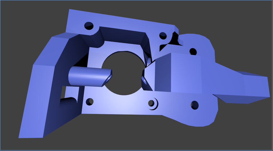

Here's mine.
And here's the stl, in case anyone wants to try it out.
airtripper_mod_2.stl

I didn't change the bearing holder at all. I am printing it now, and I'm hoping it will let me go faster than 30mm/s.

Here's my printed extruder.
I had to make a few changes to my first design. The mounting holes were a little too low. The gear that the airtripper uses is a smaller diameter than the mk7, so the filament path was too close to the gear. I had to slide everything over so the filament wouldn't curve around the gear. A few things could still use a little tweaking, like the size of the nut captures, but this version is working well for me.
airtripper_mod_v4.stl
(146.18 KiB) Downloaded 488 times
