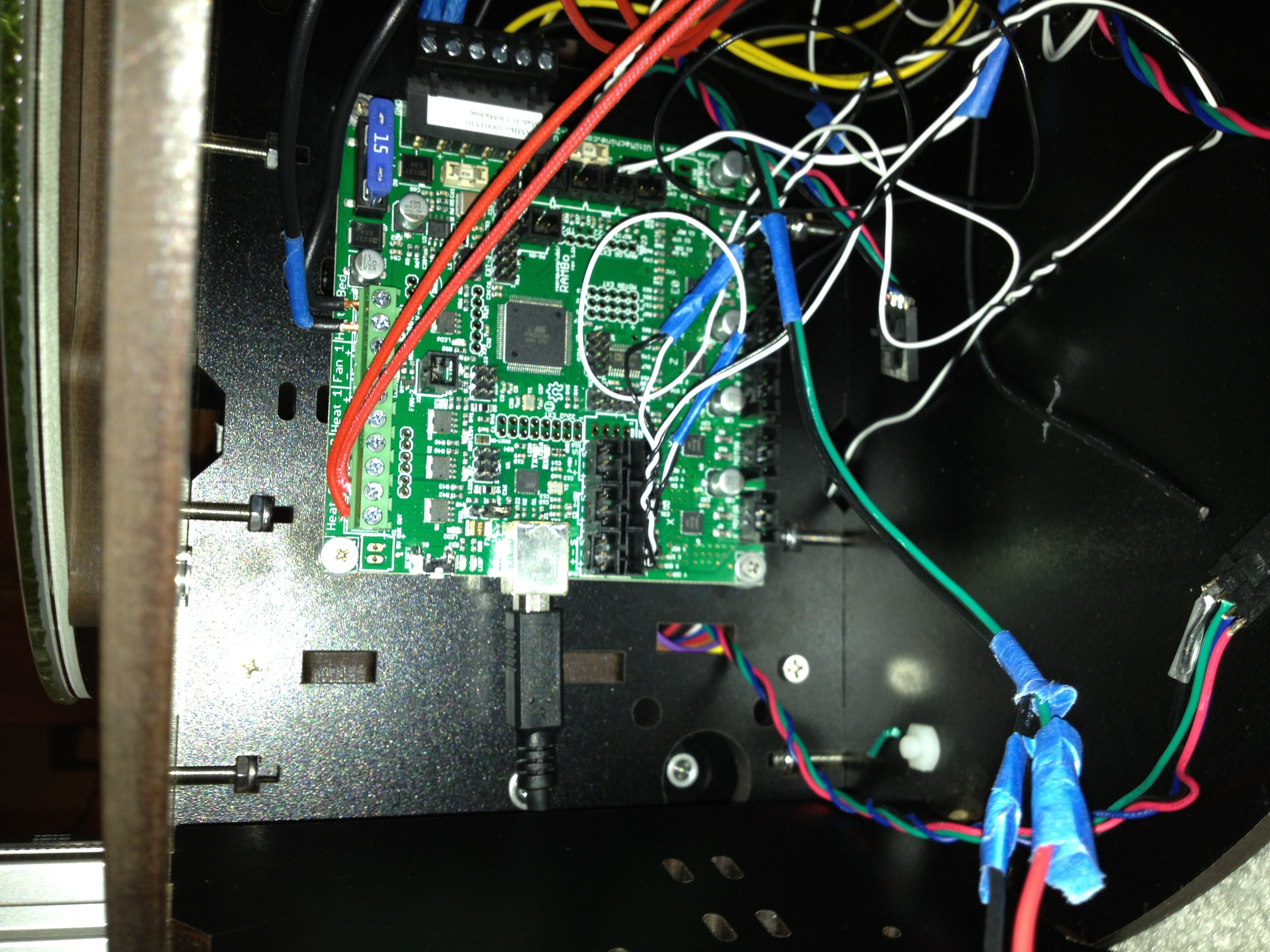

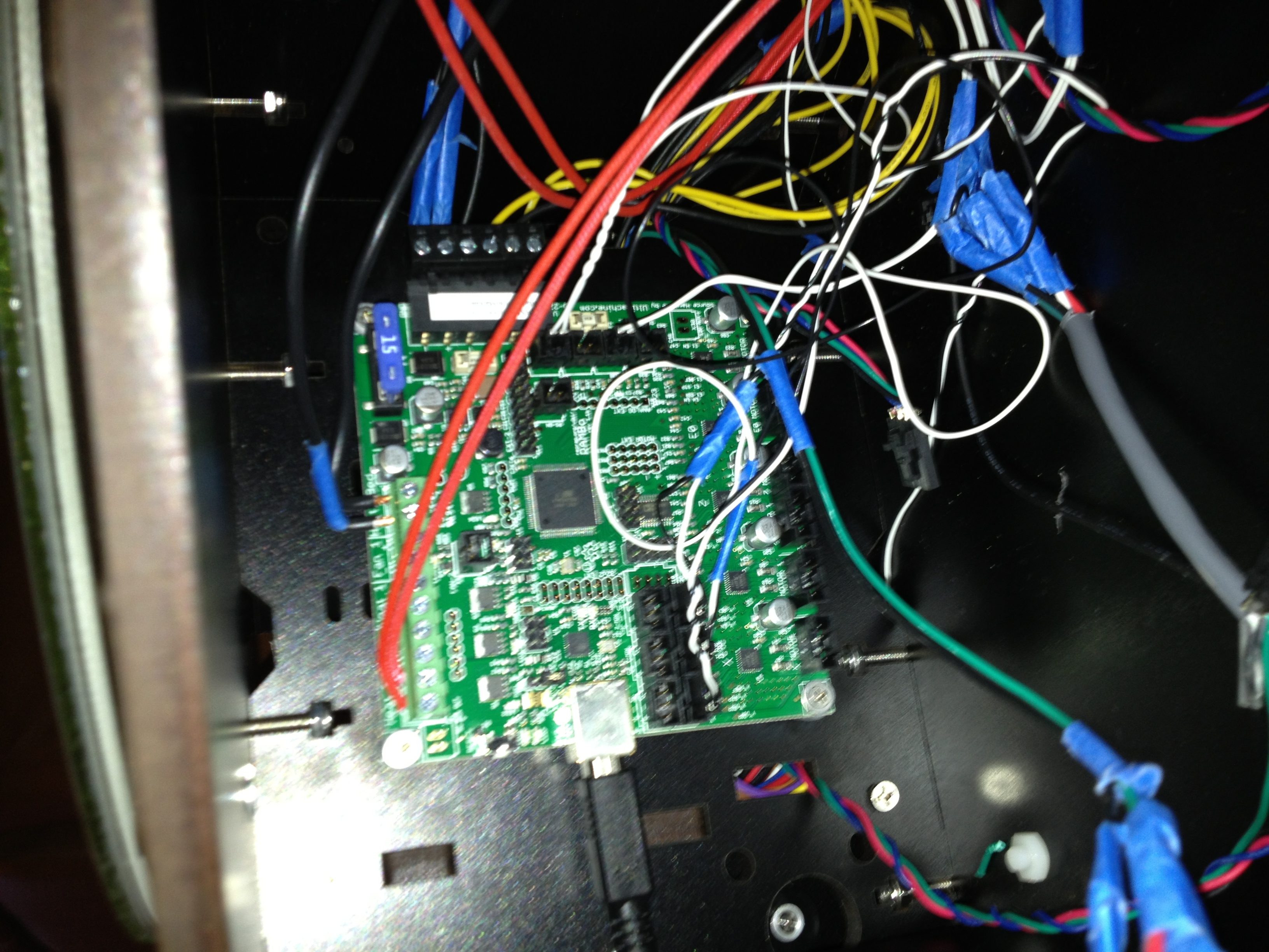

The stepper wiring is definitely in the right order. I get different results every time I open the electronics door, even if I don't change anything. So I think this might go back to the off/on switch having loose pins, or it could be the 4 pin connector sockets that are loose between the plugs and the rambo board. I'll try sticking tape on the bottom half to act like a shim; that should prevent them from wobbling so much.
Check out the Tri hotend!
Re: Default Rostock

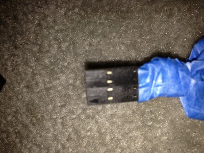

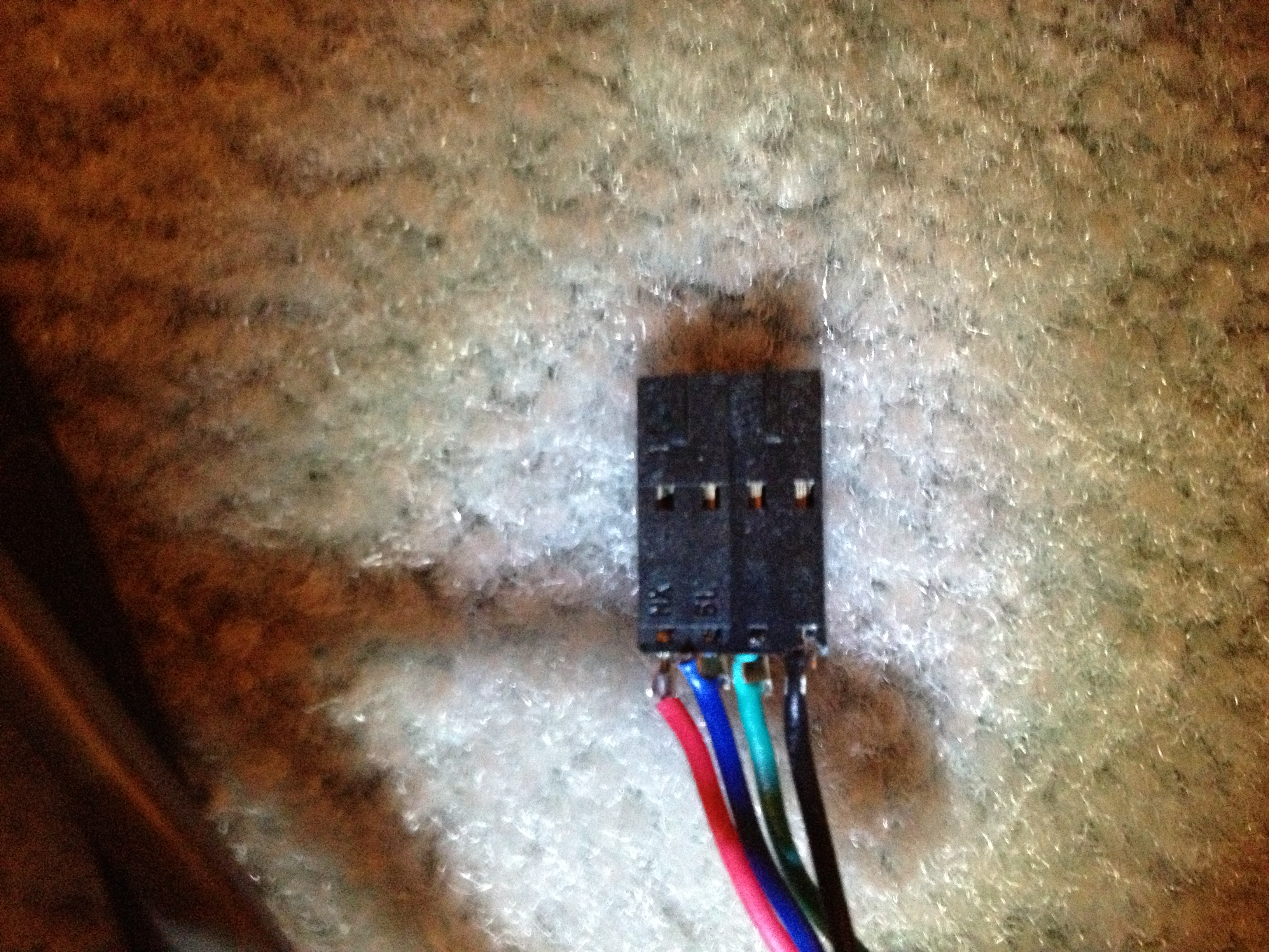

show me a pic of your connectors / crimps something isn't right here.Generic Default wrote:The stepper wiring is definitely in the right order. I get different results every time I open the electronics door, even if I don't change anything. So I think this might go back to the off/on switch having loose pins, or it could be the 4 pin connector sockets that are loose between the plugs and the rambo board. I'll try sticking tape on the bottom half to act like a shim; that should prevent them from wobbling so much.
- Generic Default
- Posts: 554
Re: Default Rostock

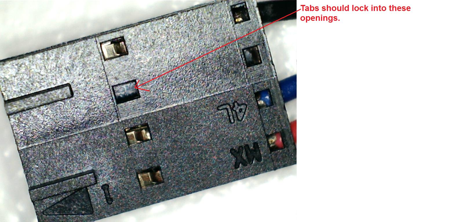

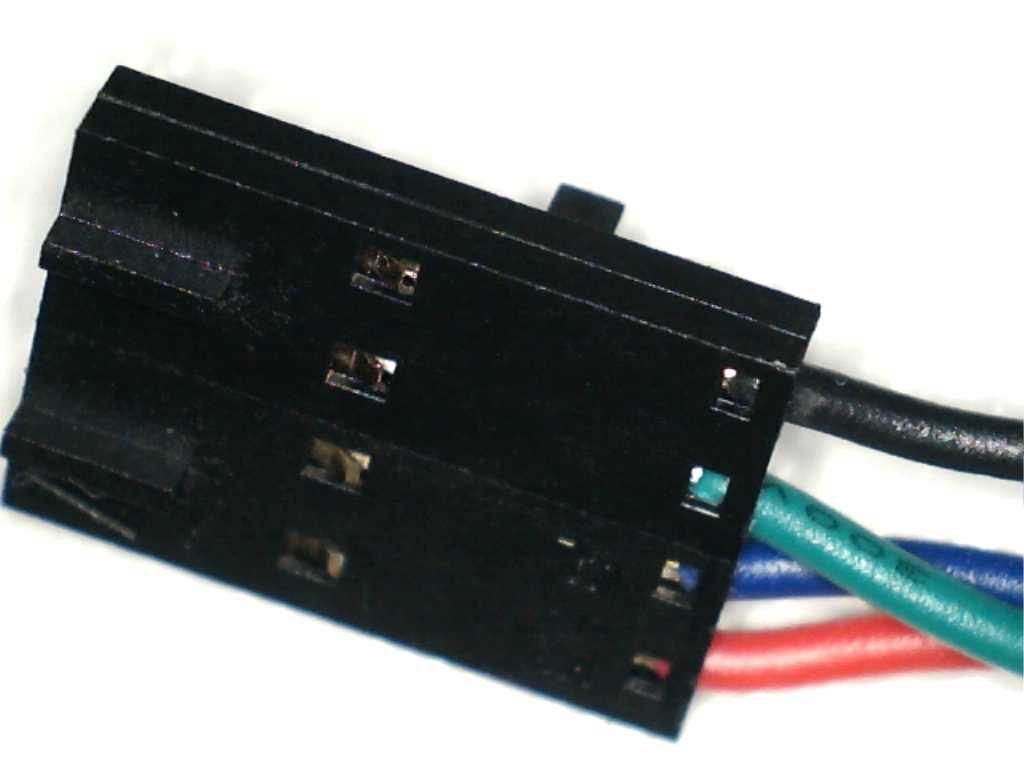

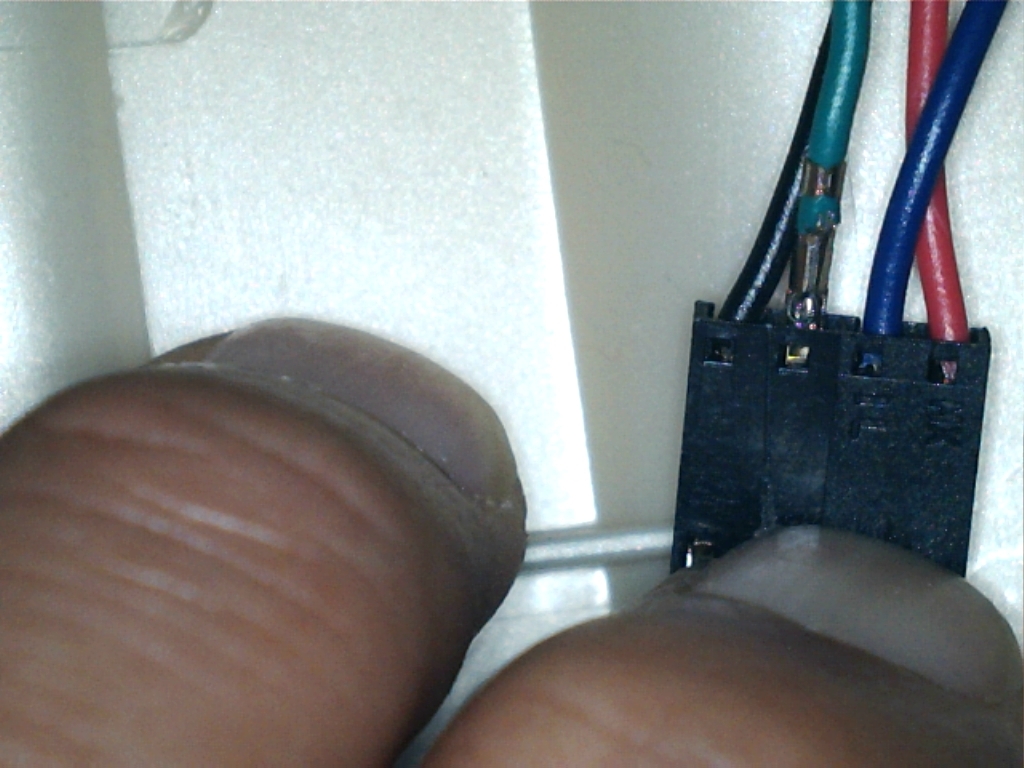

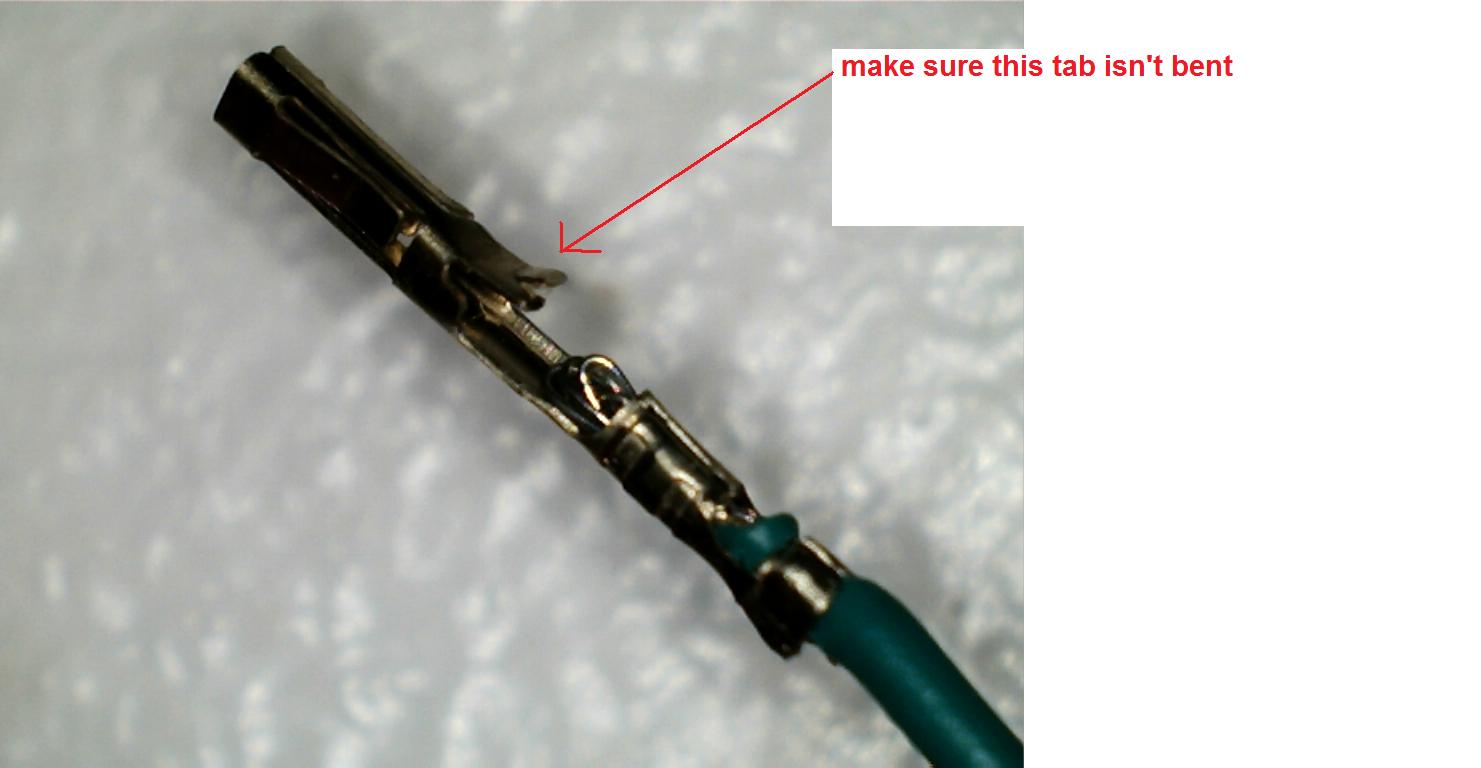

from that second pic i can tell you thats your problem. your pins aren't crimped properly not allowing you to push them all the way in, doesn't even look like the locking tab is in the hole either.
you might want to get a new set of pins and recrimp them with a better tool. it should look like the photo i posted. I believe you may also be shorting some of those pins together, with them not being all the way in, they could come out and short (causing other problems)
also if your using blue tape to splice your wiring, its just a matter of time till something comes apart.
do it right the first time (or in your case the next time) and you might not have some of these issues.
pins are all the way in, locking tab protruding into locking hole

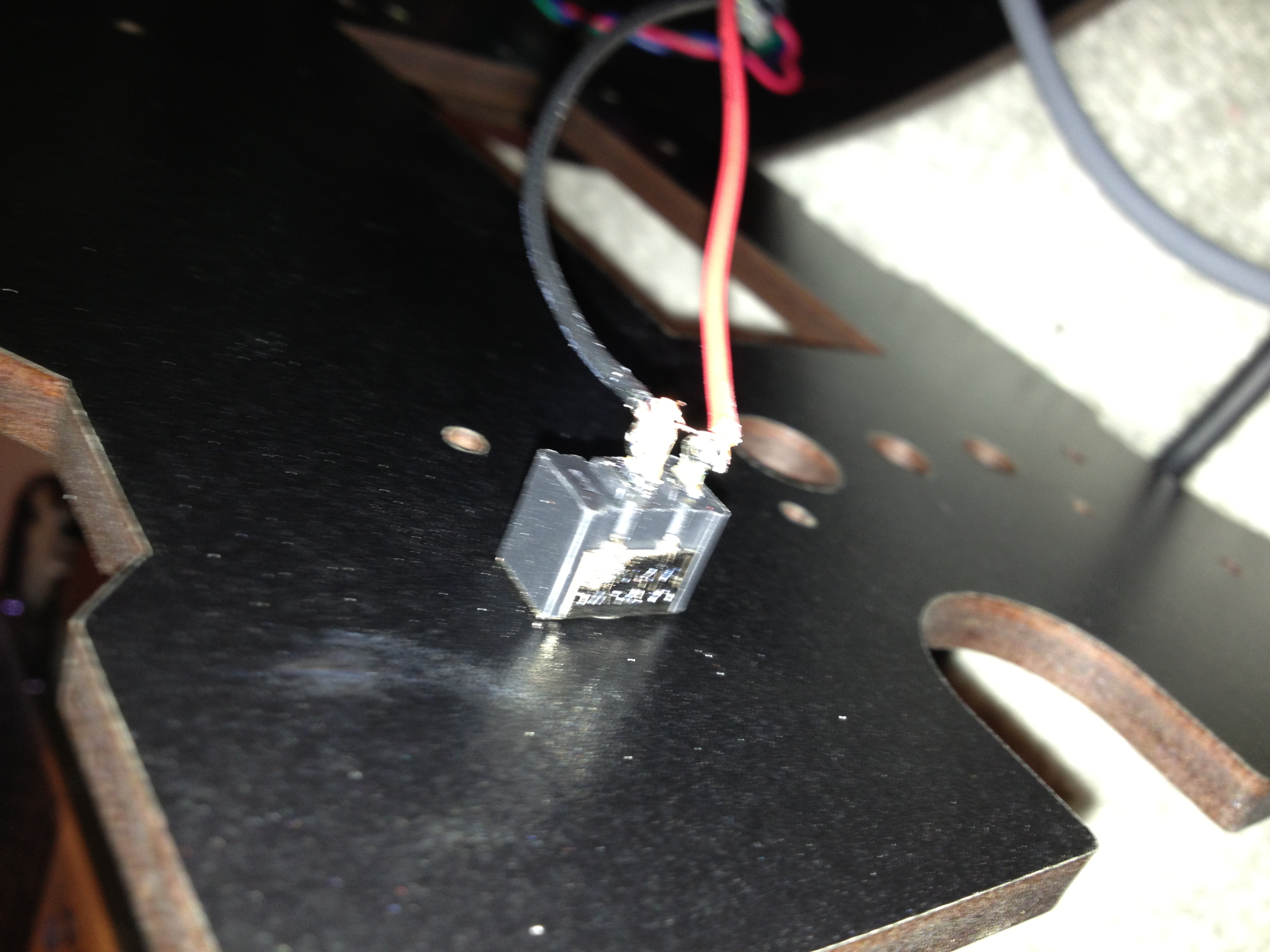

I had a flaky on/off switch when I first assembled the machine. It would actually start up and then cut off after a while. I thought I had a bad power supply. I talked with Steve at Seemecnc and it turns out the insides of the switch are sensitive to overheating when you solder the wires to them. I replaced the on/off switch with a beefier one and have had no problems since. I don't know if they have updated the switch since then (March).

Broose wrote:I had a flaky on/off switch when I first assembled the machine. I thought I had a bad power supply. I talked with Steve at Seemecnc and it turns out the insides are sensitive to overheating when you solder the wires to them. I replaced the on/off switch with a beefier one and have had no problems since.
if you do it right, you shouldn't overheat the switch.

I'm not saying I did it correctly! I probably used a Weller soldering gun which has way too much power because my iron was out of commission at the time.cambo3d wrote:Broose wrote:I had a flaky on/off switch when I first assembled the machine. I thought I had a bad power supply. I talked with Steve at Seemecnc and it turns out the insides are sensitive to overheating when you solder the wires to them. I replaced the on/off switch with a beefier one and have had no problems since.

I think I had that same problem with my switch. There is really no decent way to solder the wires to it without melting the plastic that the pin is stuck in, and then it starts sliding around in it. I might just get some alligator clips and hang them out of my electronics door as an easy way to turn it on or off. Or maybe I'll just solder the two wires directly together and use the power supply switch instead.

you can get a beefier switch that wont be prone to heat damage from radio shack.
For the pins, ultimaker.com sells replacement pins or you can get them from mouser.
the part numbers to the pins from mouser are 538-16-02-0102 for the 22-24 gauge pins/wires and 538-16-02-0096 for the 24-30 gauge pins/wires. there cheap I keep a lot full handy for mods. They probably sell the correct crimper or a universal one, which is what i used. if you look up the part number it should tell you what crimper to use on the website. i believe genes new manual also list one.
Re: Default Rostock

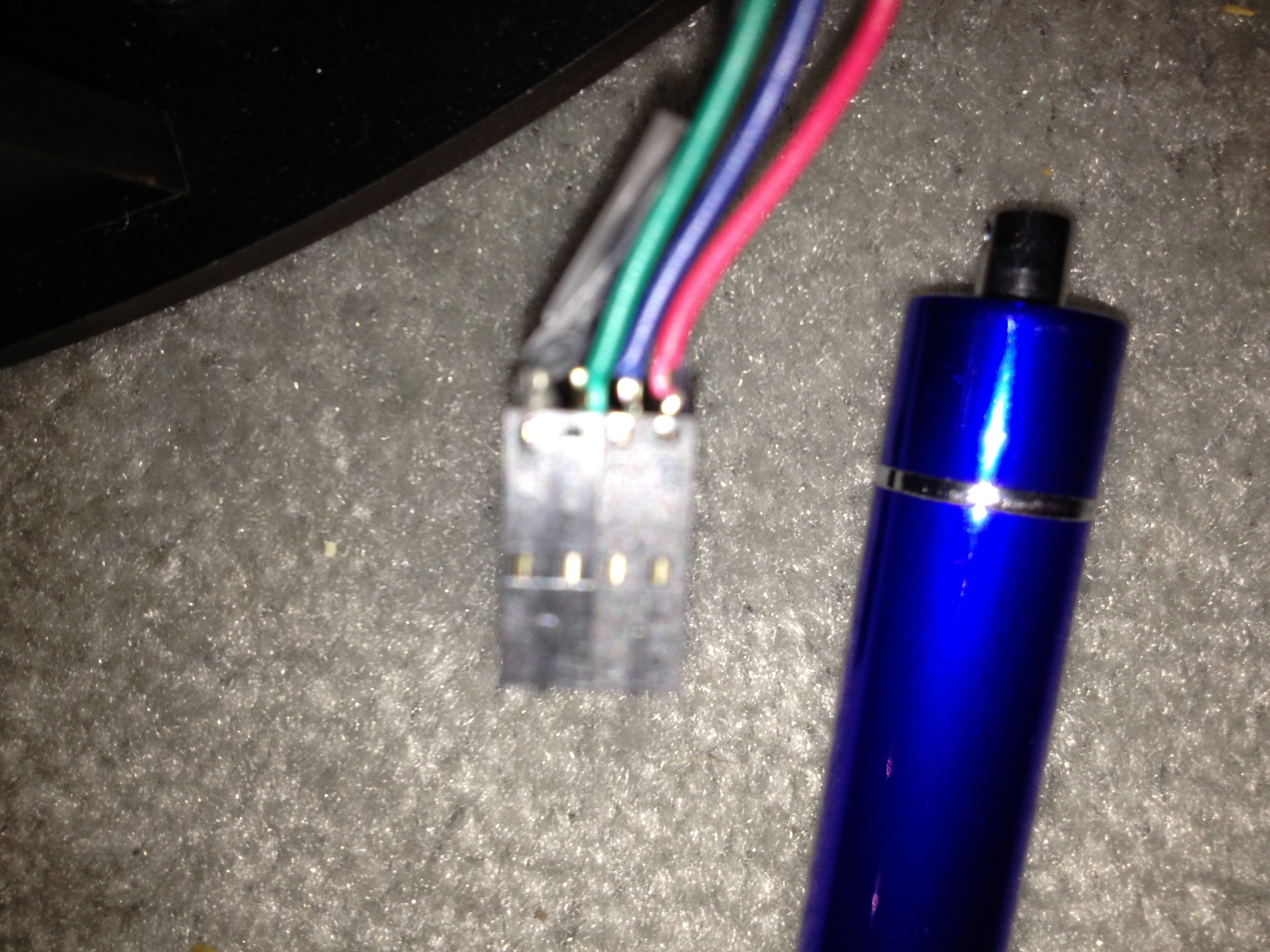

Here's a thread with photos on how to crimp with needle nose pliers, or better, you can get a crimper
http://forum.seemecnc.com/viewtopic.php ... mps#p12194
I didn't trust my crimping capabilities with pliers so I also soldered the connections a little after crimping, making sure it wasn't so much solder that the crimp wouldn't fit into the connector

Thanks for helping me through this guys. I just spent the last 3 hours un-crimping, crimp-fixing, and re-crimping every single bad crimp I made. So now they're correctly done and all four motors are spinning smoothly and quietly.
I also just extruded my first 10mm of nylon! Which is a big relief after 6 days of building and fixing.
Everything seems to be working fine, except all three axises are inverted and I can't seem to change it by uploading the firmware with the inverted stuff. In arduino, there are the tabs at the top for all of the files that get opened when I open the Repetier.ino file. I changed the invert part from true to false, but when I compiled and uploaded, it didn't change anything. Arduino prints this at the bottom after I compile and upload;
