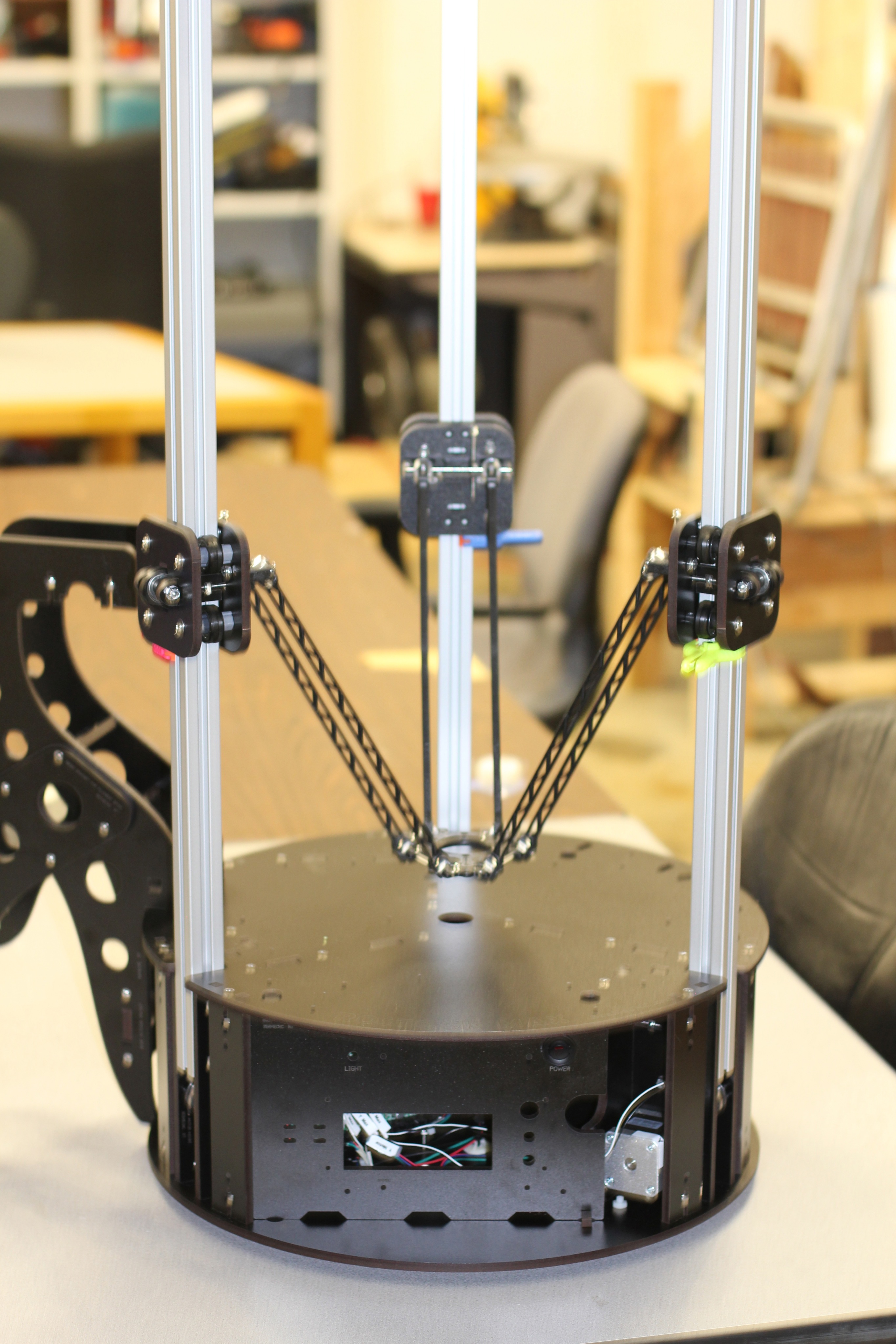

Here is a photo. It looks like a delta thing now, instead of a gazebo.
Looks like a delta thing.

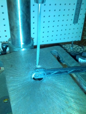

Don't do this.
Post by kbob »

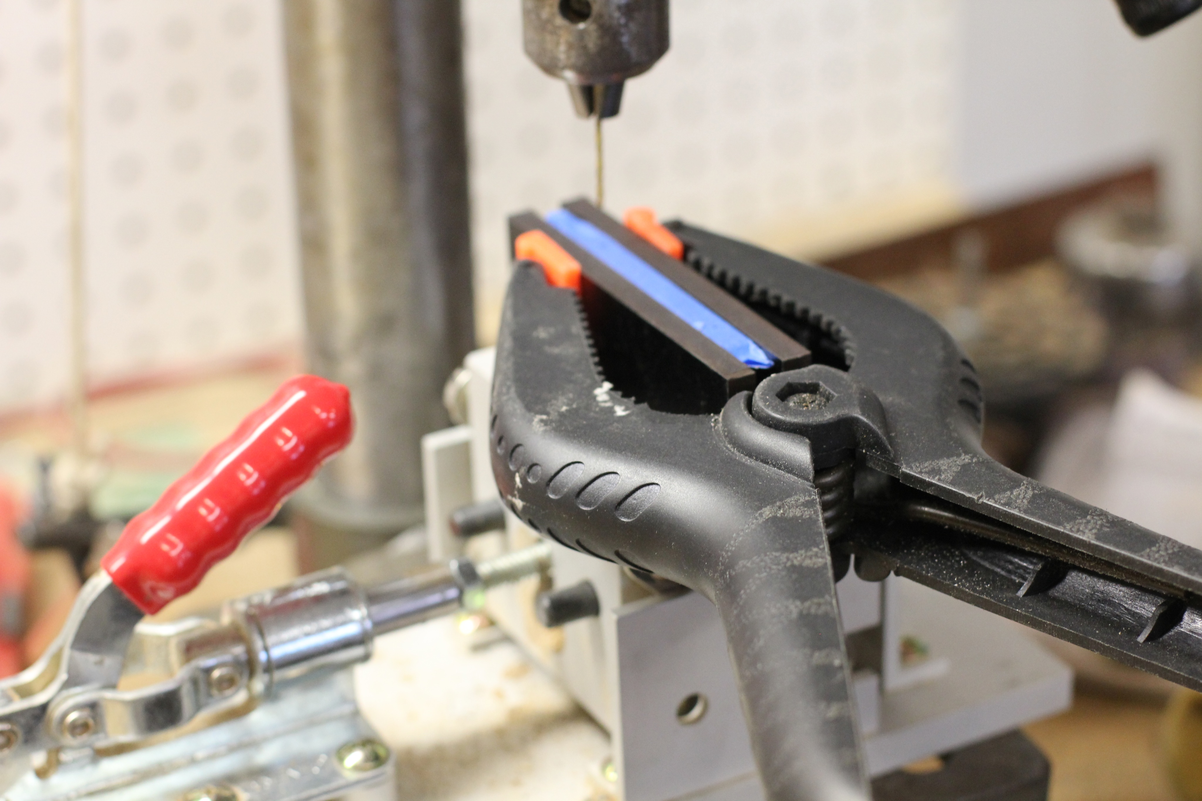

Actually, it worked pretty well. I did not over-enlarge any of the holes in the delta arms. I did not even put an eye out.
Delta file in a drill press.  (Sorry about the white balance.)
This is a small delta file in a drill press. I used it to ream out the holes in the delta arms*. It removed a whole lot of material very quickly. I basically just touched the spinning file to the hole, then re-tested the fit. Most holes were big enough after a single touch; a couple needed a second go.
I did not have any real reaming tools, so I improvised.
* I'll leave the delta puns to you guys.

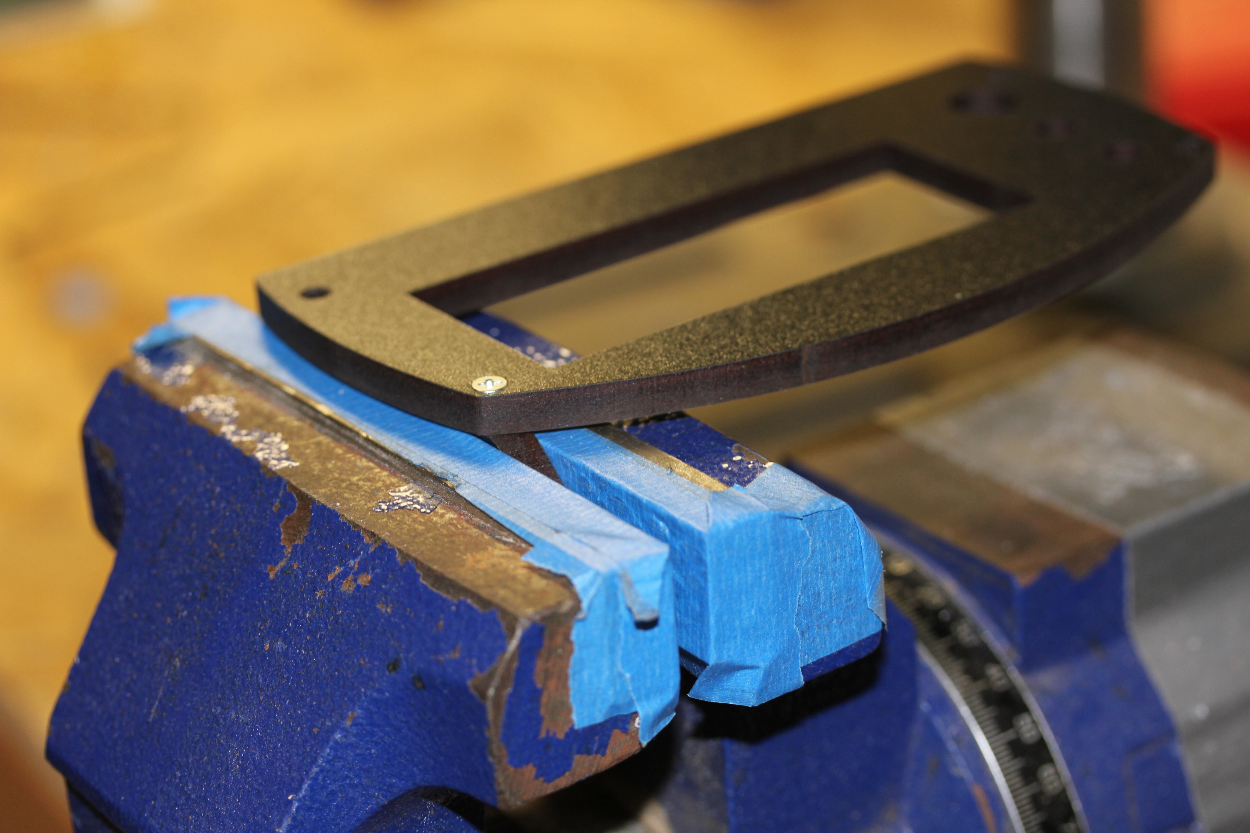

The photos of the split LCD panel ends in Gene's manual made me very very cautious about splitting mine. I pressed the pieces between two other pieces of melamine using both a vise and a clamp before i drilled the pilot holes. The blue tape is there so I could mark where to drill. Pencil on blackened fiberboard was not visible.
Vise plus clamp
Vise plus clamp
I clamped it in a vise to put the screws in, too.
Just a vise
Just a vise
There was no splitting. I also carved out extra clearance around the SD slot with an X-Acto knife so the left end would slide all the way onto the board. The right end needed just a little carving to clear the rotary encoder's pins.
A black Sharpie dressed up the countersink holes. The fiberboard sucks up Sharpie ink like a sponge.

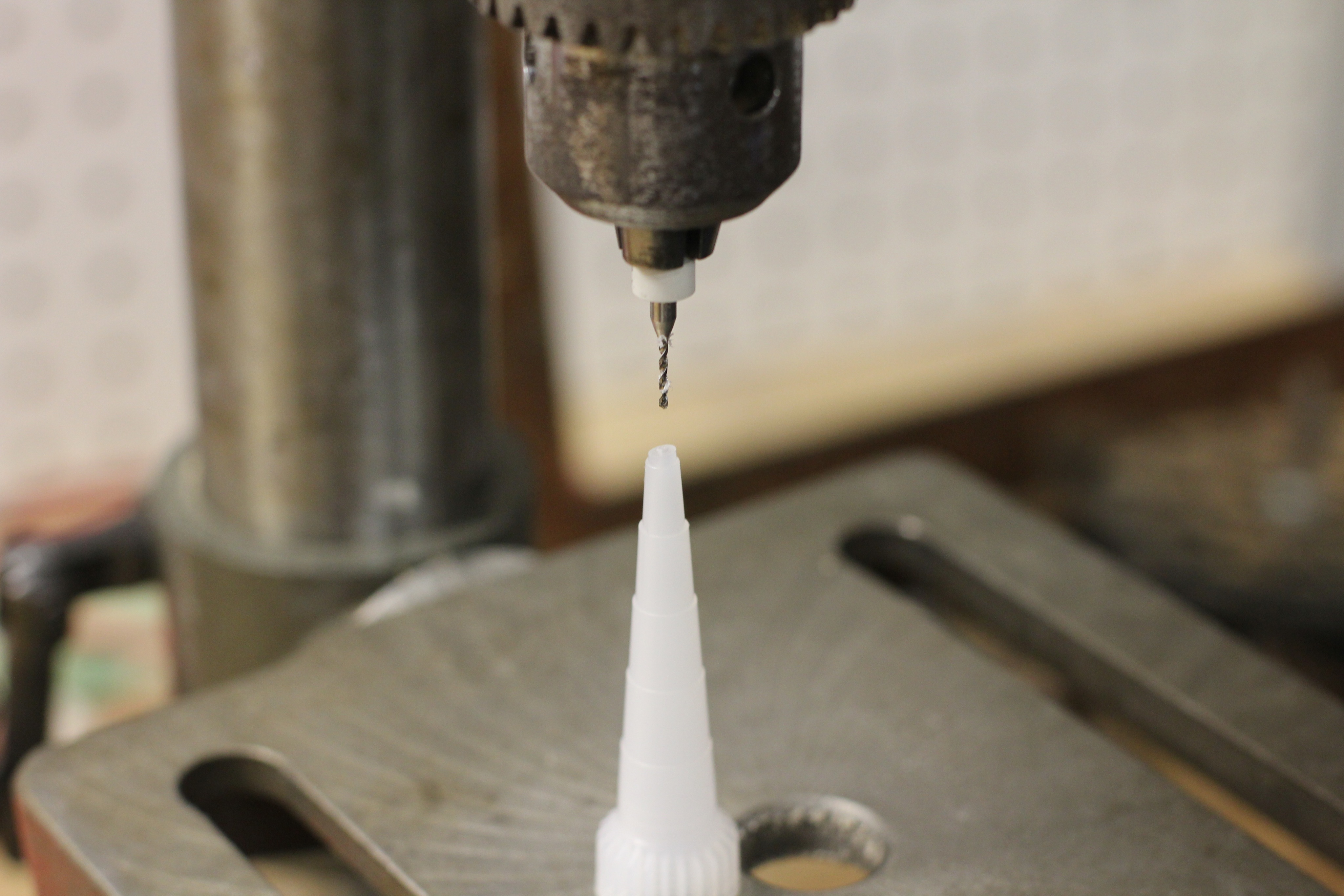

I am _not_ anal retentive!
Post by kbob »
I just wanted to ensure a good round hole in the RTV applicator. It's not like i used a torque wrench on the drill chuck or anything.
Not overkill at all.

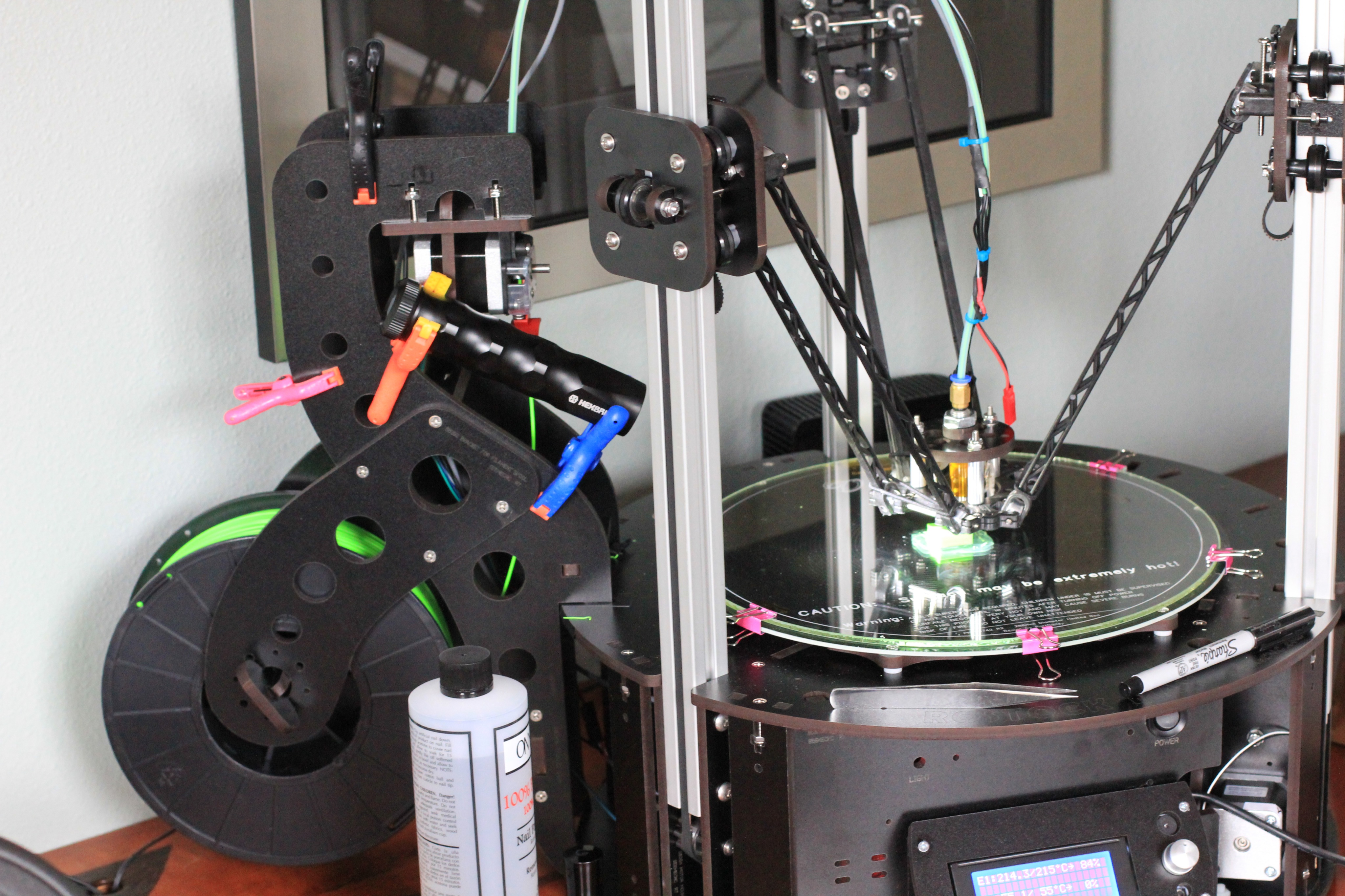

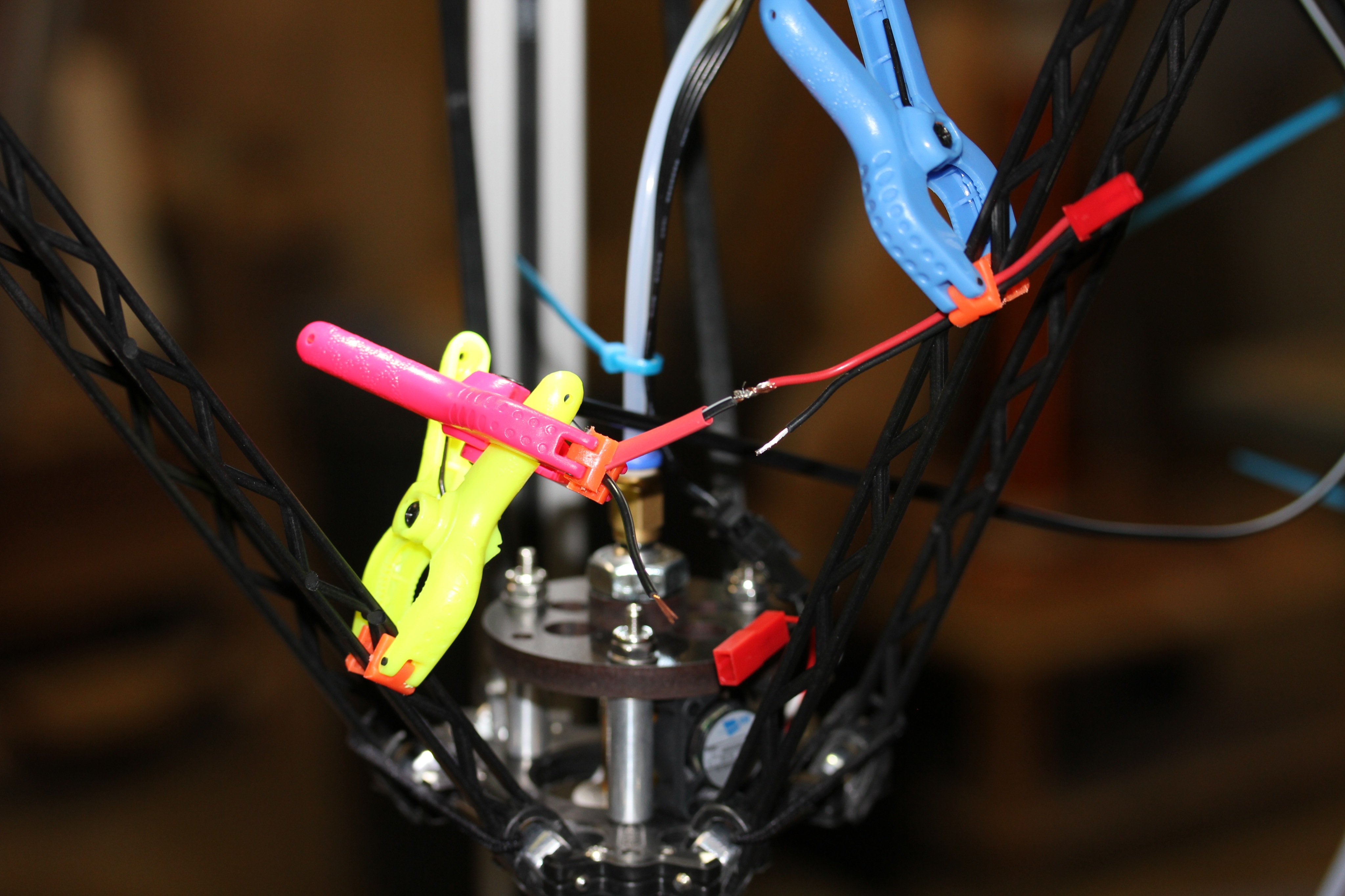

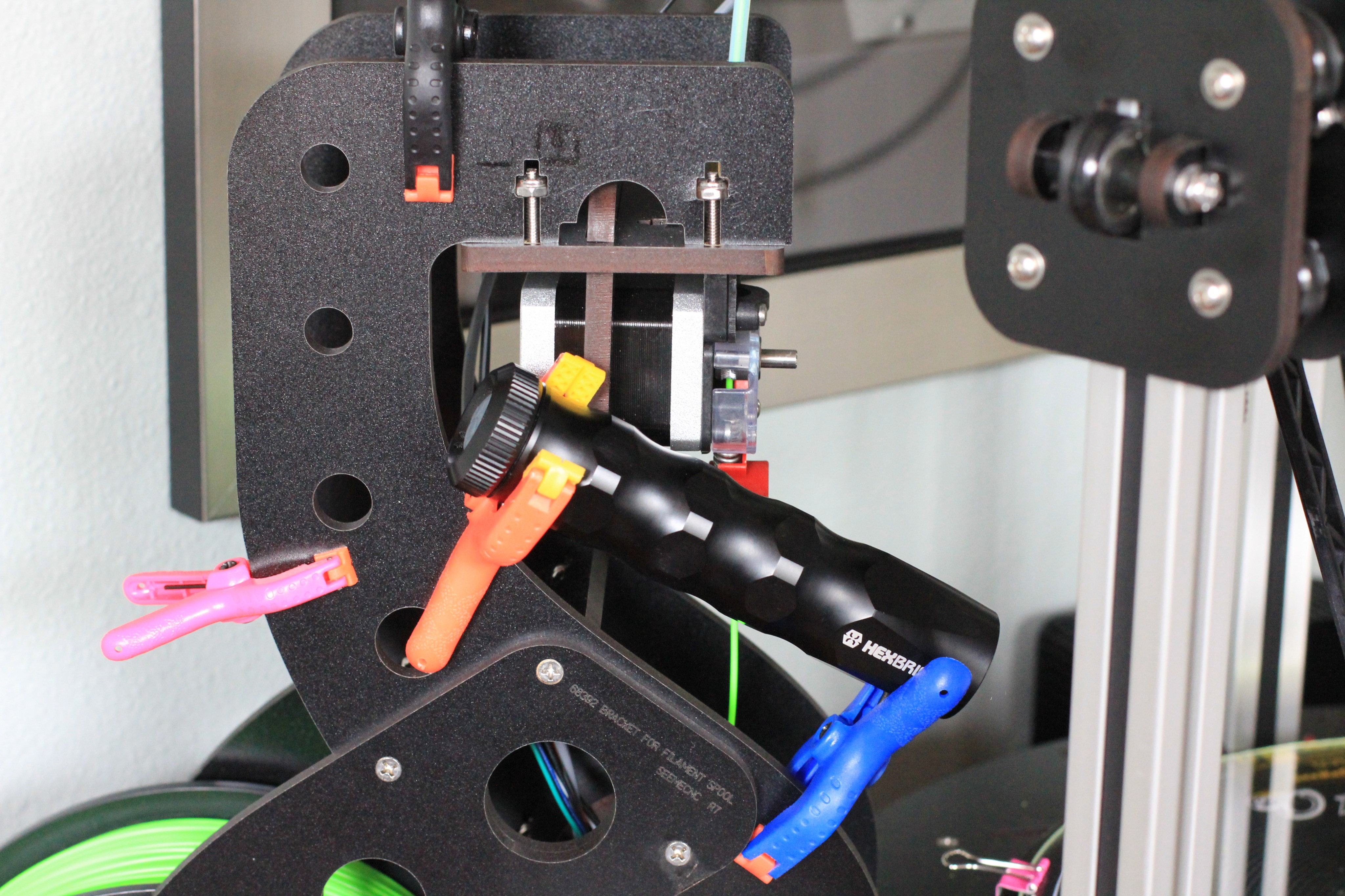

Last night I was printing long after dark. Since there isn't a task light near my printer, I installed an LED lighting system. Sort of.
Photographed in the daytime?
The light.
The light.
Those colorful clothespins are from Horrible Fright. http://www.harborfreight.com/22-piece-s ... 69374.html I use them to hold the Cheapskates in place when I transport the printer in the car.
Note the Onyx nail polish remover bottle. Only use genuine Onyx brand acetone; it was formulated specifically for your Onyx bed!

ApacheXMD
Posts: 186
Post by ApacheXMD »
Off topic: Nice flashlight! I was sooo tempted to get one of those hexbrights, but I have too many flashlights as is.
kbob
Posts: 286
Location: Eugene, OR, US
Post by kbob »
ApacheXMD wrote:Off topic: Nice flashlight! I was sooo tempted to get one of those hexbrights, but I have too many flashlights as is.
Thanks. I find myself using it a lot more than I thought I would.

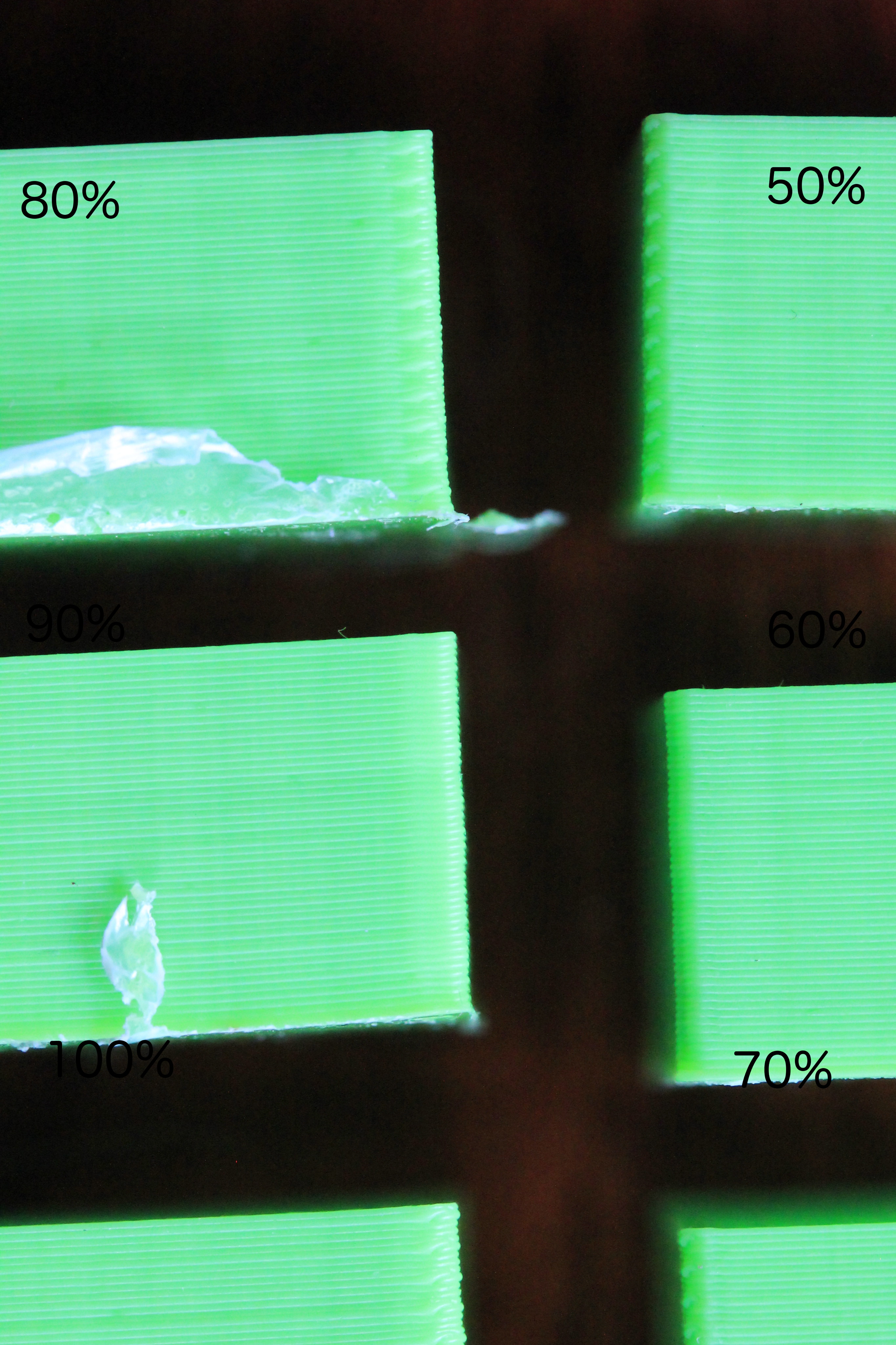

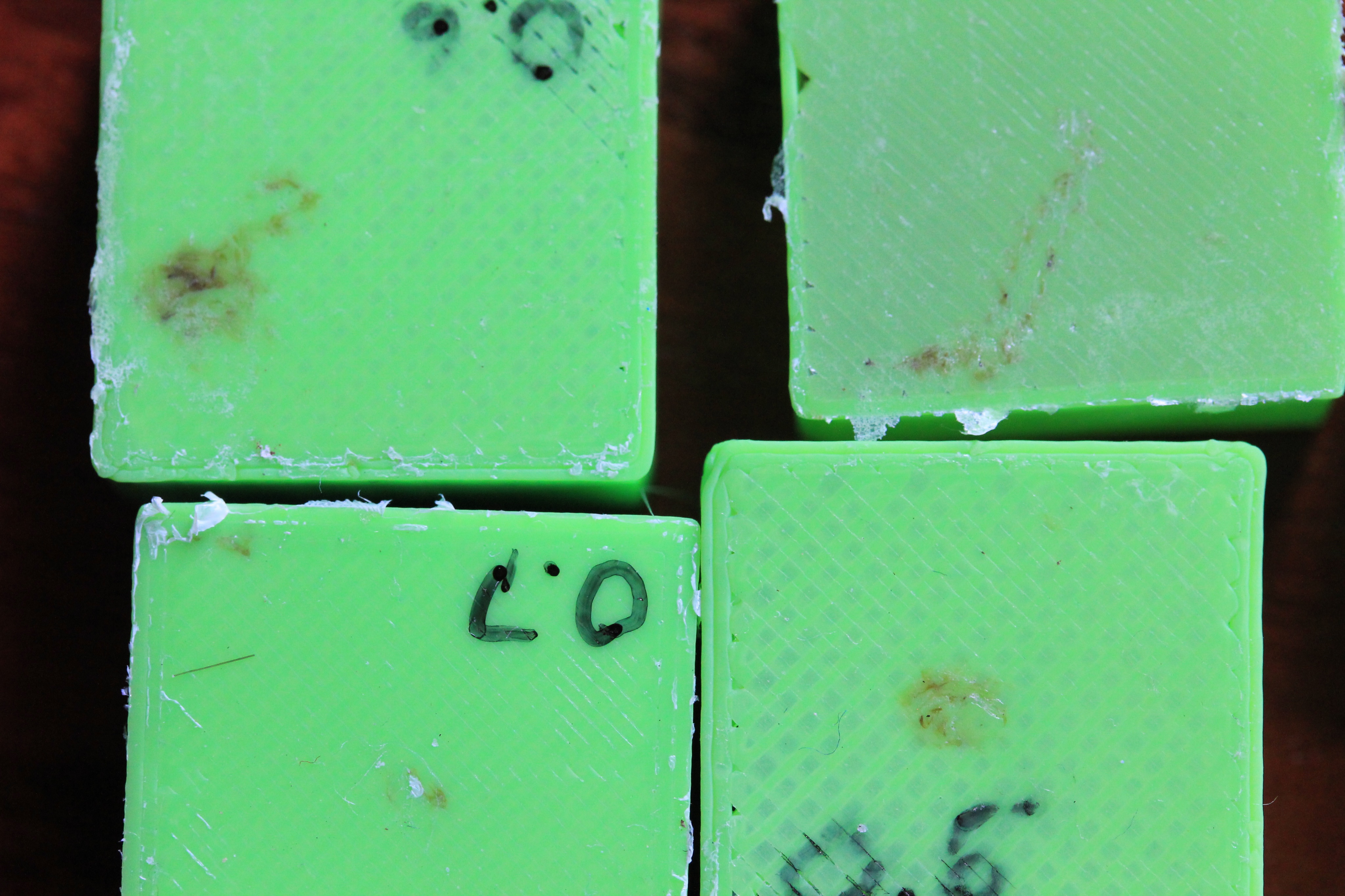

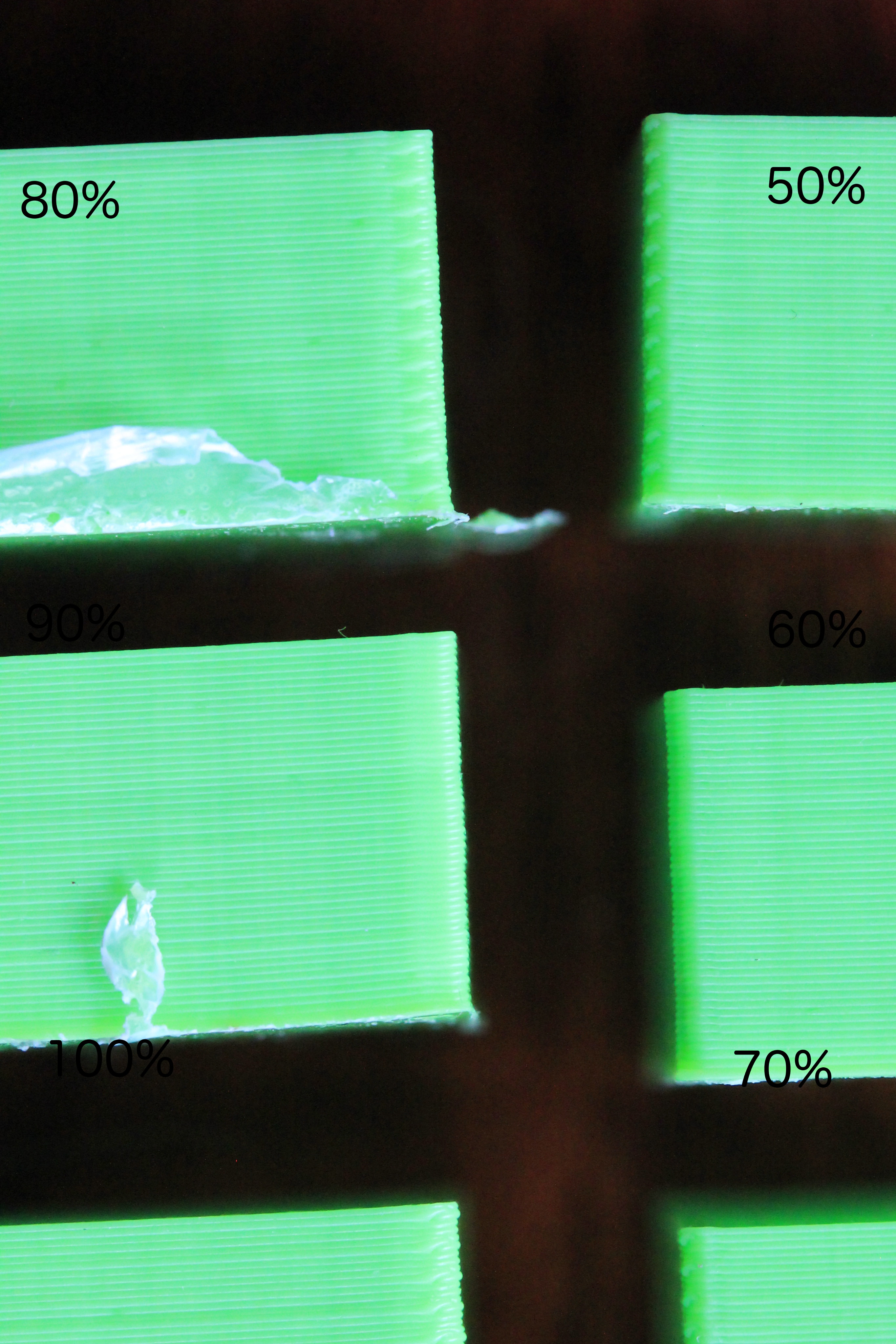

Now the printer is operational, it's time to dial it in.
I've read Gene's manual and followed the procedures.
I've read polygonhell's tips on tuning the amount of extrusion. I don't have a caliper with sufficient resolution yet (UPS is delivering it tomorrow). My digital caliper says the single layer wall thickness is 0.6 mm. Or 0.8mm. In lieu of the right tool, I tried printing the solid blocks with different infill percentages. There are visible gaps all the way up to 90% infill, so I set Slic3r's Extrusion Multiplier to 0.95 and called it good. I will revisit that when I get a new caliper.
20x20mm blocks, 50-100% infill
Same blocks, side view
Am I right? Am I way off? These were all printed with 0.2mm layer height and 0.55mm default extrusion width.
Is there another calibration document I should know about?
So that's what I've got. But here are the problems I know of.
  • I have brown spots (burns, I think) on the underside of many prints. Here are some of those same blocks agin.
    Same blocks, brown spots on bottom

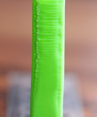

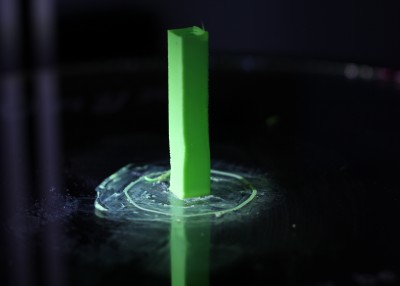

  • I printed the 50mm tower with a single layer perimeter and no infill. It came out crooked with a bead down its back. Should I be concerned? What is this object supposed to test?
    50mm tower.  Crooked.
    Same tower, close up.
  • I have no idea whether my hot end temperature or bed temperature is high, low, or just right. I have not yet bought a thermocouple-based thermometer to calibrate the thermistor. If I did, what temperature would I aim for? (ABS)
  • I am using a lot of ABS juice. Anything else and the prints curl right up off the glass. Elmer's glue stick did not work well. I've tried bed temperatures up to 95℃ (uncalibrated); the Onyx can't get to 100℃. Would a different bed temperature help?
So I guess my top level question is, how do I dial this printer in now that it's sort of working? Where do I go from here?
Posts: 5358
Printing ABS with an un-verified thermistor is risky. If it's under-reading, you run the risk of ruining the PEEK section of the hot end - Harbor Fright sells a nice little meter that has a good thermocouple on it for under $40. (I'm lucky, I've got three HFs within easy driving distance! :) )
I've found that I'm getting MUCH better prints from PLA than I ever got from ABS. I think it's a combination of different properties in the material and maybe PLA is a bit more forgiving of my uncoordinated stumbling around. :)
Blobbing and stringing boils down to slicer adjustments - I'm not good enough at that yet to recommend anything to anybody. :)
When you print a cube of known dimensions, how accurate is the result you're getting? BTW, a 20%-25% infill is plenty for most things you'll be printing.
Congrats on finishing your build and thank you very much for the feedback you've given on the 2nd edition!
Posts: 2417
Location: Redmond WA
Post by Polygonhell »
The 100% fill clube looks pretty good at 100%
The tower is a notoriously difficult print, the fact it even looks like a tower is a win. The issue is heat, if you really want to print a better one, pint 4 at a time, it gives them time to cool between layers, active cooling can also help.
You will get seams on parts, the start and endpoints have to overlap, the size of the seam is dependent on the slicer, and the settings in it.
The strings can be cleaned up with the retraction settings, 3mm is probably too little for the stock SeeMeCNC hotend, try 5mm of retract at 30mm/s and 5mm of Wipe in KisSlicer.
