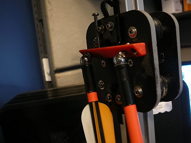

Do you have pictures of just the parts you used? I'm having trouble visualizing the assembly.Flateric wrote:Here's a few more pics of the setup.
I went with crossbow bolts for my arms. I used nylon cup'd inserts from the bulk nut and bolt bins from Home Depot. They offered exactly the same inner cup diameter and size as the prints and the out diameter also match the magnets perfectly. The magnets also match the crossbow bolt diameter perfectly.

Did you have to drill out a hole onto the Chrome steel balls? Or did you just JB Weld them onto the screw?Flateric wrote:Here's a few more pics of the setup.
To mount the whole works up to the arm itself I got some of the heat shrink tubing that has an adhesive inside it that liquifies when you are heat shrinking the tubes. This glued the nylon cup ontop of the magnet and the magnet to the shaft of the crossbow bolt. The entire assembly from center pivot point (the center of the ball that the boom end pivots on) to the other ends pivot point is 269mm exactly. The heat shrink tube also aligned and centered up everything nicely when I did the heating, so that was also a nice benefit.
I choose the nylon cups because I happened to notice them strickly by chance when I was there shopping today for some stainless. I don't know what they are originally intended for but I like the fact that this way I have perfect consistency throughout all my boom ends and removed my own possible "screwing the printed ones up" from the equation. A personal choice nothing more. I have used Xnaron's included printable boom ends and they also work perfectly as well.
Here are some pics of the various parts mounted up. Notes the crossbow bolt fins still intact! This is.....ummm. so that they move the air around and assist cooling, ya that's it, that's what they do! I just left them attached as a little joke really nothing more.
Some new observations I have about this mod is. You can literally crank your speed up to much higher levels than you might guess with absolutely no slop or effect on the quality of the print and surface finish. Provided of course you compensate with adjusted heat and extrusion adjustments for the higher speeds. But mechanically it's rock solid and an excellent upgrade.
Xnaron is polishing up the files and triple checking everything to be sure it is "just right" and they should be available this week or weekend I am told. But don't hesitate to get his kit he plans to offer or order up all the bits and print em yourself.
The quality in person is really stunning. I can't express how impressed you'll be with it.
Also the magnets he recommends are plenty strong enough and even with my dual hotend tests so far the carriage has no chance of coming loose even at speeds and jerks that no sane person could or ever would print at.
How did you bore and polish the barrel of your E3d hotend?Flateric wrote:Hotend was e3d with bored and polished barrel, no fan at all or cooling fan for part. Dead air with head moving through it for only cooling.
It's what I thought. I saw some on Ebay with tapped holes in them already but they were 1/2 inch. I will try Flateric's method and Mig weld then 4 taps strong and fast.xnaron wrote:elqisqeyano wrote:
Flateric welded them. My kit will use jb weld. It works very well and has held up to many hours of printing. Ultimately I would like to be able to drill a hole in the balls and glue in a 3mm stud. Drilling chrome steel is very hard. I need better carbide bits.
