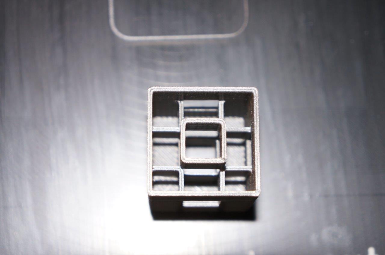

Here is the hollow cube

I am printing anywhere from 0.2 to 0.35mm layers on the 0.5mm nozzle jhead.cambo3d wrote:would you mind posting your settings?
KISS Settings
Destring:
4.5/4.5/5
30
0.5
5
Fan: 30
1.75MM PLA printing about 185C (ultimachine silver). I find KISS slices heavy so I have my flow tweak set to 0.93.
Style:
using 0.55mm for extrustion and infill width.
Let me know if you want anything more specific.

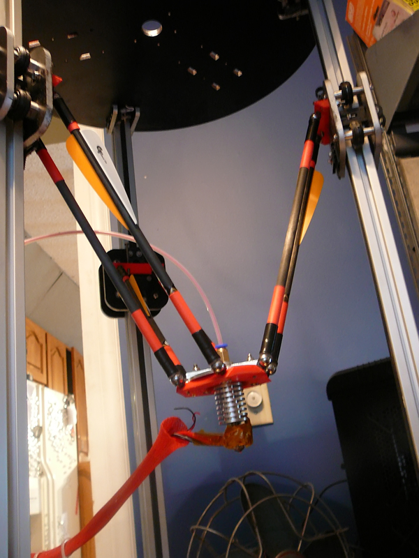

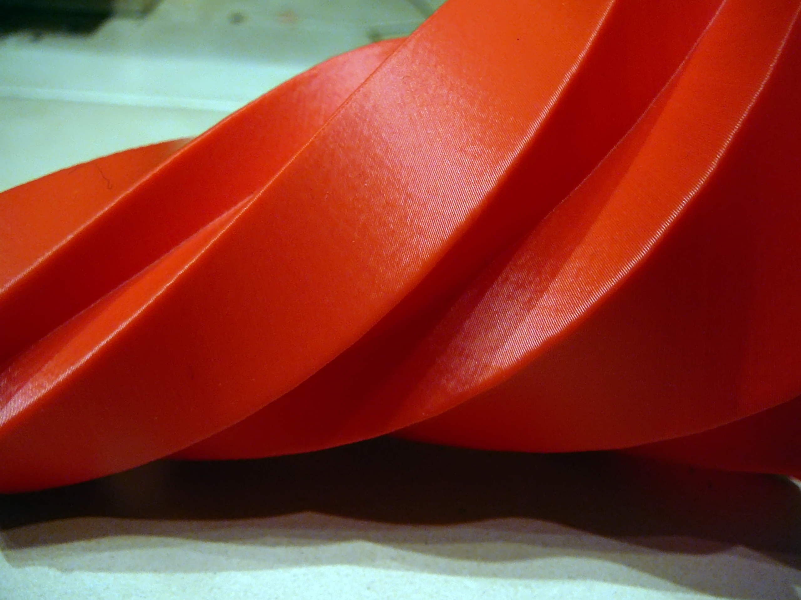

I print my ABS (such as this) directly onto the glass with a tiny bit of hairspray. Unless you let your parts cool, getting them off can be challenging.
Bed temp is usually 90-105 for ABS.
Hotend temp for both prints shown was 237.
Hotend was e3d with bored and polished barrel, no fan at all or cooling fan for part. Dead air with head moving through it for only cooling.
Layer size for top video was .35 layer size for plus vase was .2mm.

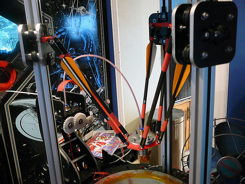

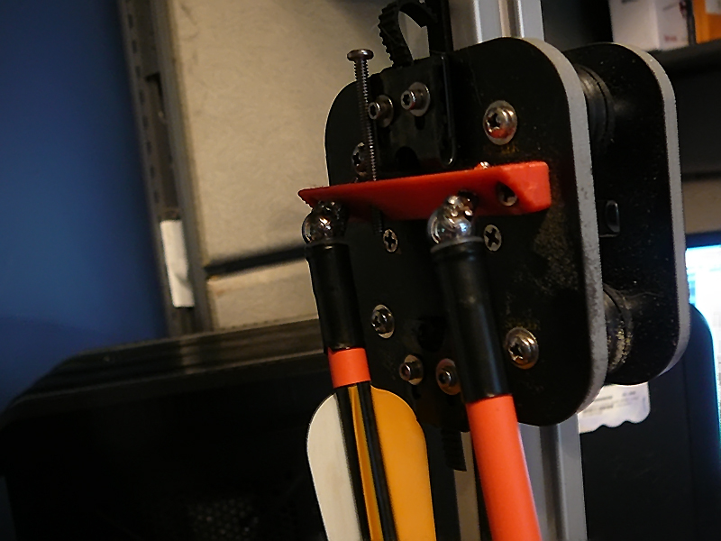

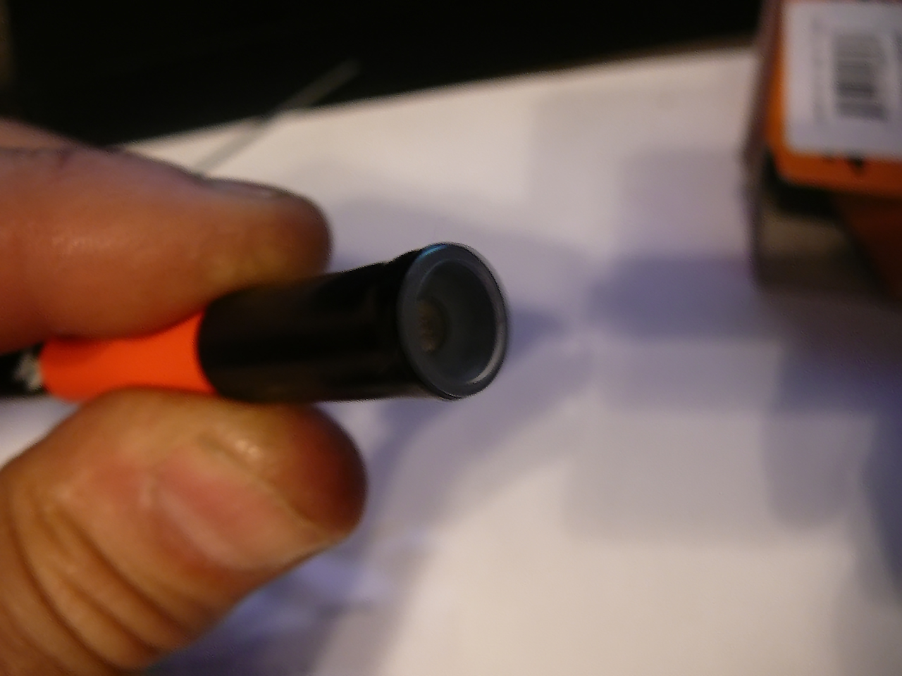

Here's a few more pics of the setup.
I went with crossbow bolts for my arms. I used nylon cup'd inserts from the bulk nut and bolt bins from Home Depot. They offered exactly the same inner cup diameter and size as the prints and the out diameter also match the magnets perfectly. The magnets also match the crossbow bolt diameter perfectly.
To mount the whole works up to the arm itself I got some of the heat shrink tubing that has an adhesive inside it that liquifies when you are heat shrinking the tubes. This glued the nylon cup ontop of the magnet and the magnet to the shaft of the crossbow bolt. The entire assembly from center pivot point (the center of the ball that the boom end pivots on) to the other ends pivot point is 269mm exactly. The heat shrink tube also aligned and centered up everything nicely when I did the heating, so that was also a nice benefit.
I choose the nylon cups because I happened to notice them strickly by chance when I was there shopping today for some stainless. I don't know what they are originally intended for but I like the fact that this way I have perfect consistency throughout all my boom ends and removed my own possible "screwing the printed ones up" from the equation. A personal choice nothing more. I have used Xnaron's included printable boom ends and they also work perfectly as well.
Here are some pics of the various parts mounted up. Notes the crossbow bolt fins still intact! This is.....ummm. so that they move the air around and assist cooling, ya that's it, that's what they do! I just left them attached as a little joke really nothing more.
Some new observations I have about this mod is. You can literally crank your speed up to much higher levels than you might guess with absolutely no slop or effect on the quality of the print and surface finish. Provided of course you compensate with adjusted heat and extrusion adjustments for the higher speeds. But mechanically it's rock solid and an excellent upgrade.
