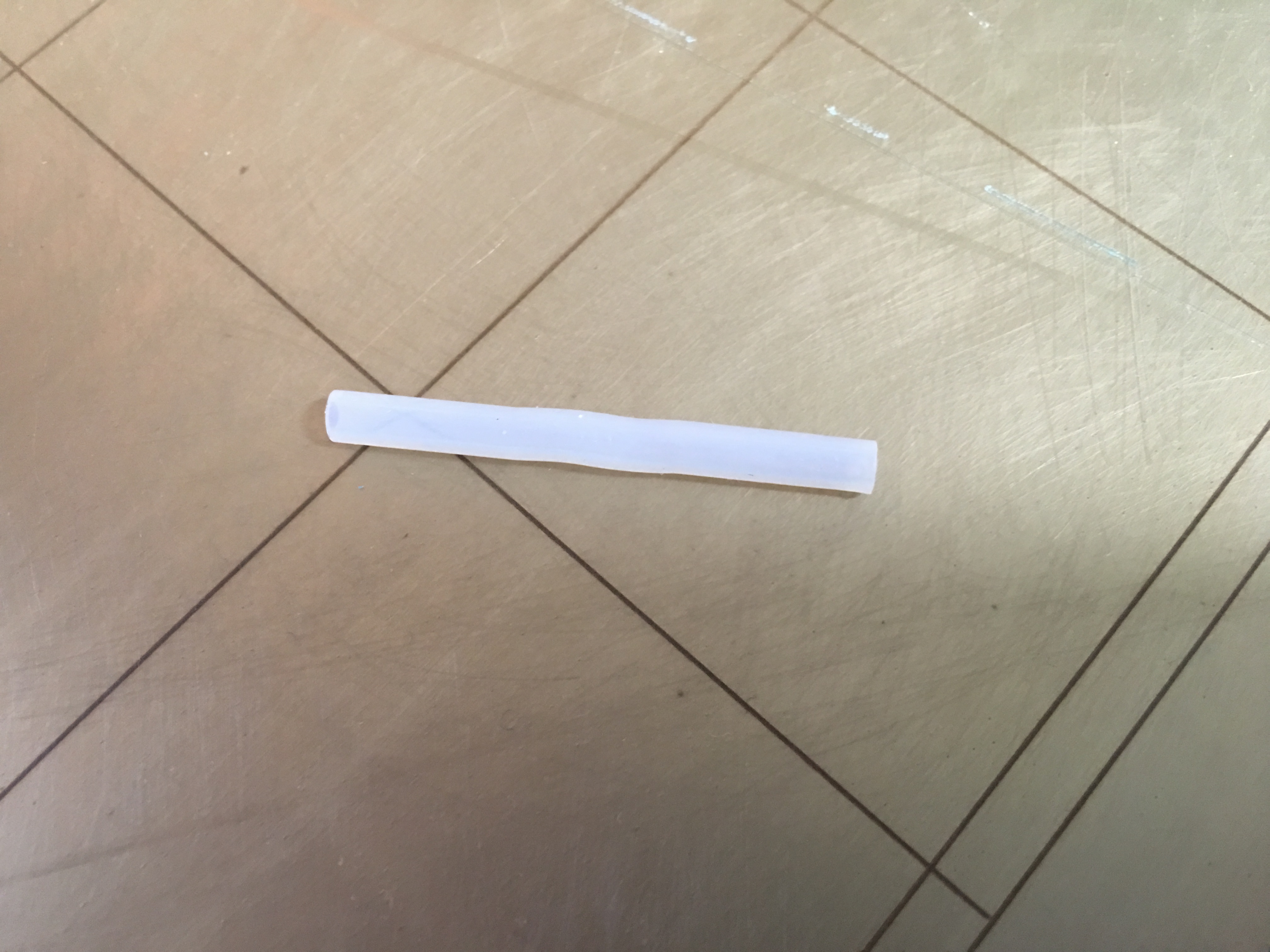

I knew I had a while before I could fiddle again, so I ordered some cap tubing.
The little insert of the hot end was actually kinked:
Got my hopes up too early though... I replaced it with a short piece of cap, and then replaced the whole bowden tube with some. The filament glides through so nice! But, alas, not my stringing culprit.
Adding my current test gcode. It's a 2x of the other one in the x/y to get a little more movement before hopping.

by adarcher
Shoot, my file was wrong. It's the same model as before, scaled XY 200%
I had modified it from the duet web interface to 185... no change in strings.
I don't have a thermal couple, not sure how to even use one in this case to test things.
I put in a request to get a replacement hotend kit so I can test that.
I'll put my hotend back together in the mean time and try your gcode. I couldn't get the screws loose to attach a different one.
Thanks for the continued support.
