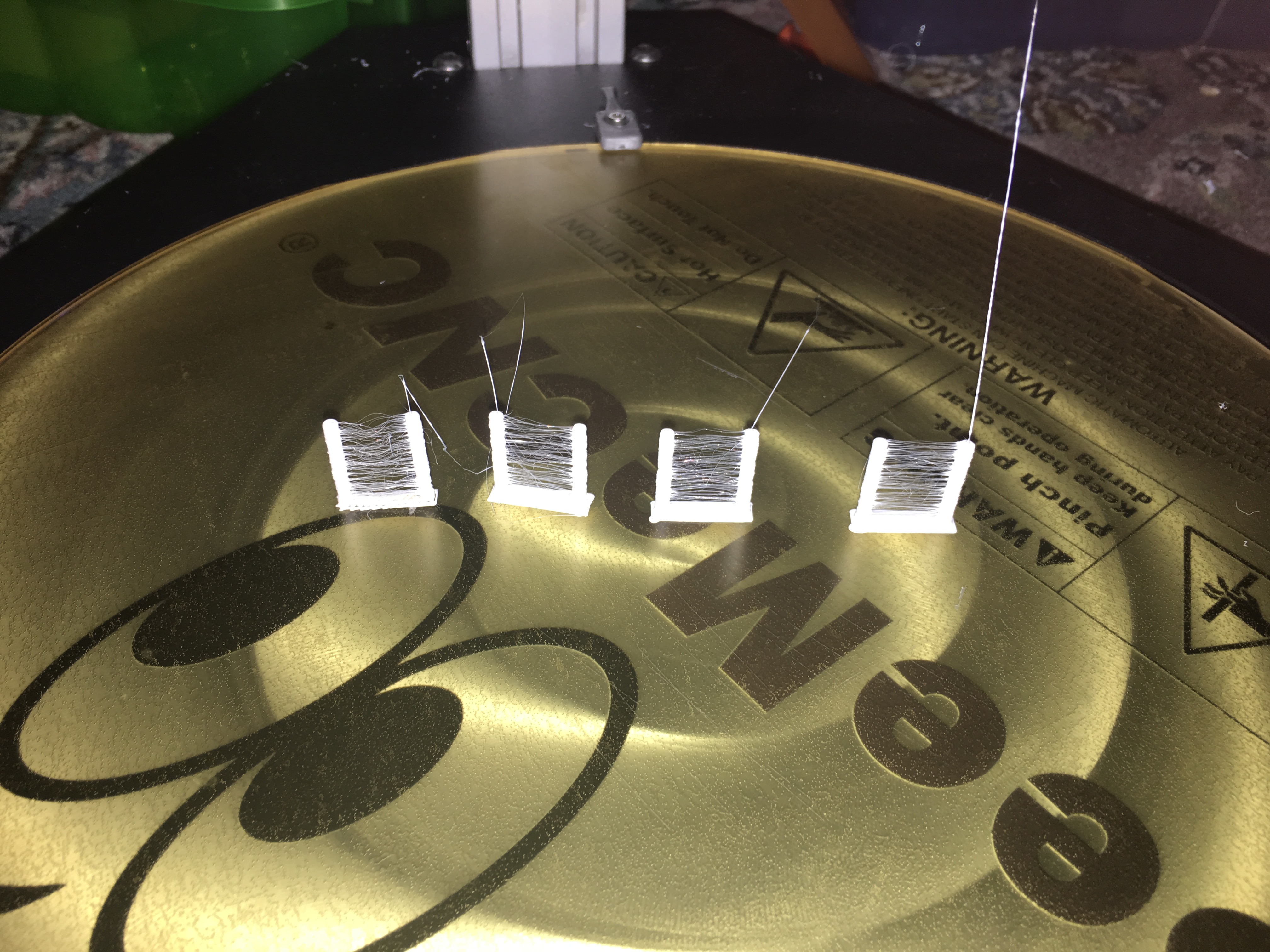

Here’s a comparison pic of different settings, left to right:
210, 6mm retraction 50mm/s
210-200, bottom to top gradient
190
210, 3.2mm 45mm/s
They all look the same to me.
I can see the extruder nob retract, but it’s almost as if it isn’t from all the strings—includingbto one on top at the end. I’ve tried repitier and marlin and reprap gcode flavors.

In re tuning for stringing,  suggest you change one variable.
Also keep a log of all changes.
Test series one
EG keep temperature at 190
Set Zhop to 1mm
Retract Speed 45
Zhop when retracted check
Then
Retract distance 2
Retract distance 3 (better or worse)
Retract distance 3.2 (better or worse)
Retract distance 3.8 (better or worse)
Retract distance 4.4 (better or worse)
Retract distance 5
Test Series 2
Best case from retract distance above
Temperature 190
Temperature 185
Temperature 180 (check your material spec first)
Temperature 195
Temperature 200
Temperature 205
Temperature 210
Below you can see how I am tuning simplify3d.. I have 23 changes so far, and I can roll back to a profile if I make a change that is worse than before.

Re: First homing: horrible grinding sounds
I’ll look at that gcode for the crawl fix.
As for the tip of changing one thing, already doing that.
I’m showing you that where you’d usually see a difference, you’re not.

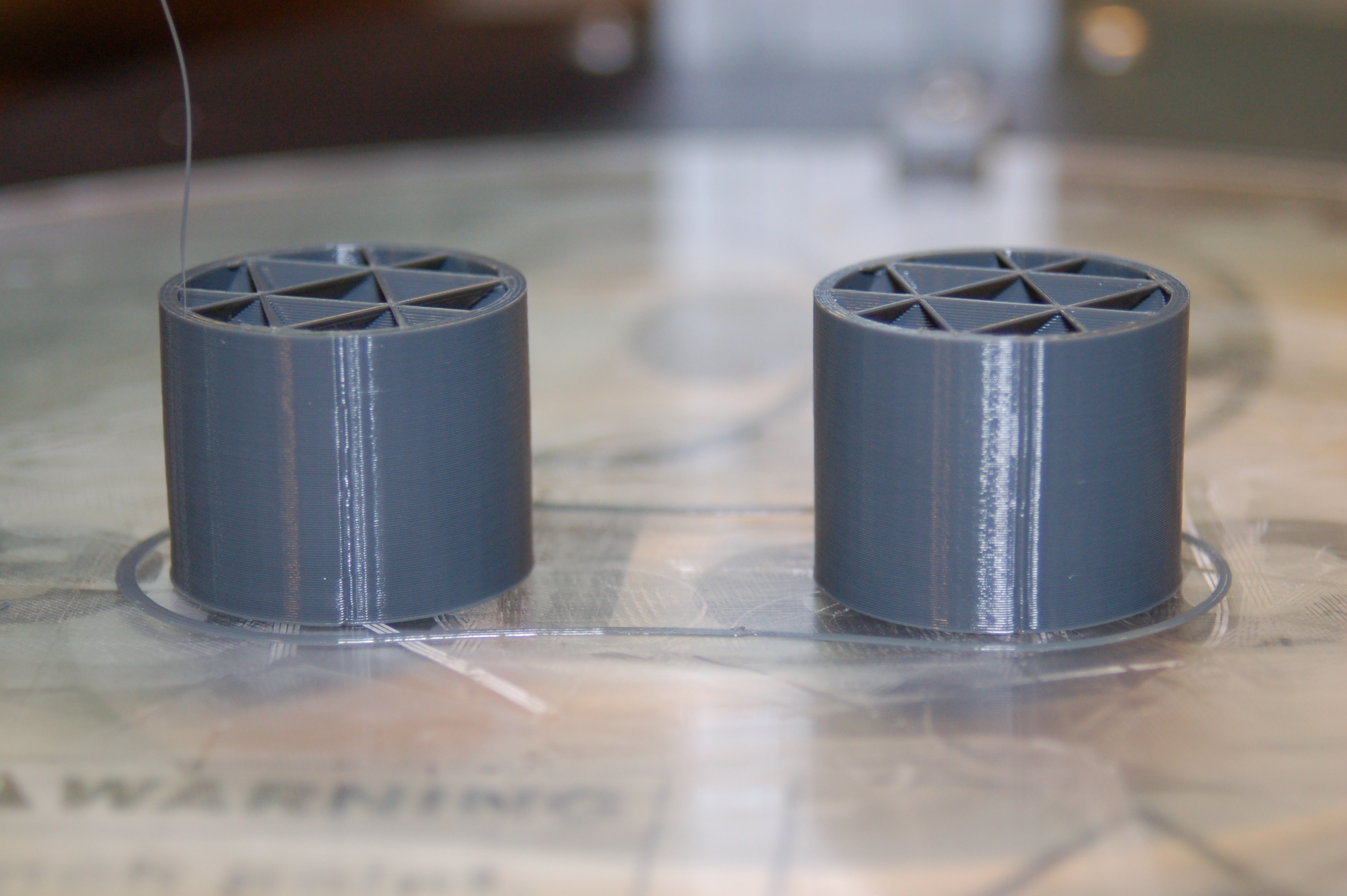

Someone want to just run my gcode and see what they get?
I wiped out cura, got cure 3.2 (looks like there's nice new features), and set it up fresh.
I downloaded the string test and sliced it.
I first printed it and it came out similar (actually worse, the z seam looks gnarly). Then I redid the extruder tuning like in the manual and tried again. Not sure about the difference, but the Z travel went crazy fast after that. I got hopeful since something different happened, but the same results. Thick web between the poles.
 A_stringing_test.gcode- (924.32 KiB) Downloaded 437 times
I'm printing this part right now. It's not so much a "stringing test" as it is a "let's see how much heat we can dump into two little plastic posts" test.
When I ran the test I was using Atomic Gunmetal Gray, which is my go-to material of late. That part prints /very/ quickly - there's no time for the previous layer to cool down and that's contributing quite a bit to the stringing issue. You can't print tiny things like that fast - there's just no time for the part layer to cool enough before the next layer is put down. I'm printing what I use for retract calibration - a pair of 25mm cylinders about 25-30mm apart. I'm printing this using the SE300 PLA Default profile from github @ 195C. When it's done, I'll take a photo of it and post the gcode here.

Here's the image (it's unresized): Here's the gcode: I stopped the print as it got the point across.
Give it a shot and let me know how it works!

The model I used was the one linked previously by wepollock: https://www.thingiverse.com/thing:2640671\
OK, I did a few mm of your code and it does string less, but still has a thin web between the two disks and a lot in the infill. You've got a point about the other model, it stays hotter than the larger disks.
I'll try the other one at half speed, I'd like to be able to print small items like that.

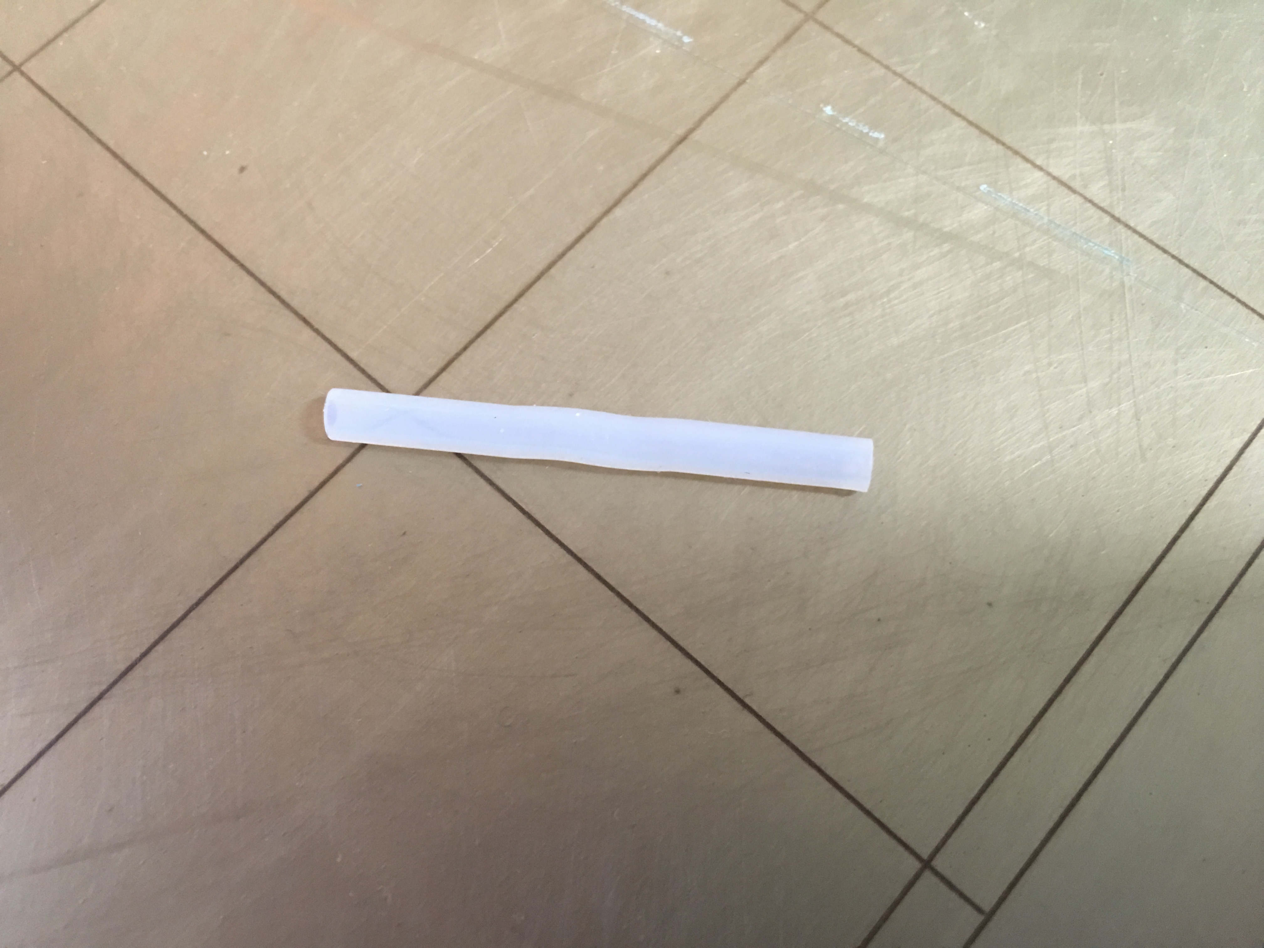

I found the reason why my hot end was so mucked up even though it never blobbed. The strings often waff around if the layer fan is on, and get caught on the nozzle/heater block.
I got a 6" ptfe tube I had laying around and used that with the effector held in my hand. If I had 3 hands I would have recorded it having the same pressure problem. I even tried holding it straight up with the tube as straight as I could make it. I compared it to my e3dv6 on my v2 and prusa and those both stopped immediately but would ooze a little if I left it sit with no retraction. I've got an extra beatup e3dv6 as well, and I might try that after reducing the top down to the 10mm diameter.

I knew I had a while before I could fiddle again, so I ordered some cap tubing.
The little insert of the hot end was actually kinked: Got my hopes up too early though... I replaced it with a short piece of cap, and then replaced the whole bowden tube with some. The filament glides through so nice! But, alas, not my stringing culprit.
Adding my current test gcode. It's a 2x of the other one in the x/y to get a little more movement before hopping.

If you're printing with the default SE300 Cura profiles, it's unlikely that you've got a retraction issue.
I'd look at how hot you think you're printing vs how hot you're actually printing - test using a thermocouple.
I'll try your gcode sample and let you know how it goes.
[edit]
I cut back the temp from 205 to 198 and I was getting angel hair strings. I suspect had I cut it back to 190, it would've stopped that as well. If you can point me to the STL for that particular print, I'd be happy to slice it and trying printing it here at 190.
[edit]

Shoot, my file was wrong.  It's the same model as before, scaled XY 200%
I had modified it from the duet web interface to 185... no change in strings.
I don't have a thermal couple, not sure how to even use one in this case to test things.
I put in a request to get a replacement hotend kit so I can test that.
I'll put my hotend back together in the mean time and try your gcode. I couldn't get the screws loose to attach a different one.
