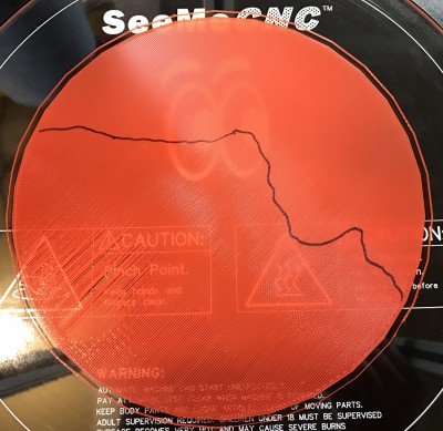

Does anyone know how to use the Auto Calibration plugin in OctoPrint?  It seems the plugin is no longer compatible with more recent versions of OctoPrint since when I try to "activate" the plugin it fails.
I can't hardly print anything with my Rostock Max V3, one side is so close it drags and filament won't extrude and the other side its too far away and I get spaghetti.
I have tried the probe script but it doesnt improve anything. It only probes I think 4 places.
Thanks for any help anyone can offer!
Re: Rostock Max v3 calibrating script.
What happens when you flip the glass over?  Same result?
