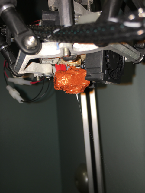

Here is a quick photo of my silicone paint job. I did a test on a spare chunk of aluminum first, and was able to easily remove it after it cured. So I felt comfortable using this on my hotend since I could change my mind at any time.
Cura slicer, Duet Wifi, iMac
Re: Layer cooling for MAX METAL platform
ramai wrote:Here is a quick photo of my silicone paint job. I did a test on a spare chunk of aluminum first, and was able to easily remove it after it cured. So I felt comfortable using this on my hotend since I could change my mind at any time.
Thanks for the picture and your paint job looks good, please let us know of any future problems like it falls apart etc.

My permatex paint job is still holding up. I also ran a PID autotune after the silicone was applied, and found my new values to be quite a bit different than the old values.

Wow it looks amazing! Much cleaner than my crappy paint job. I think I might have to do this.
