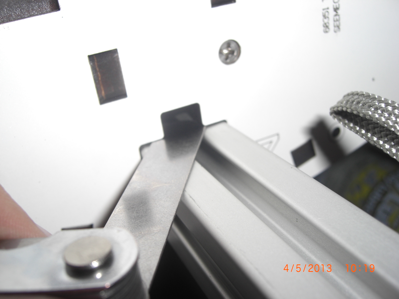

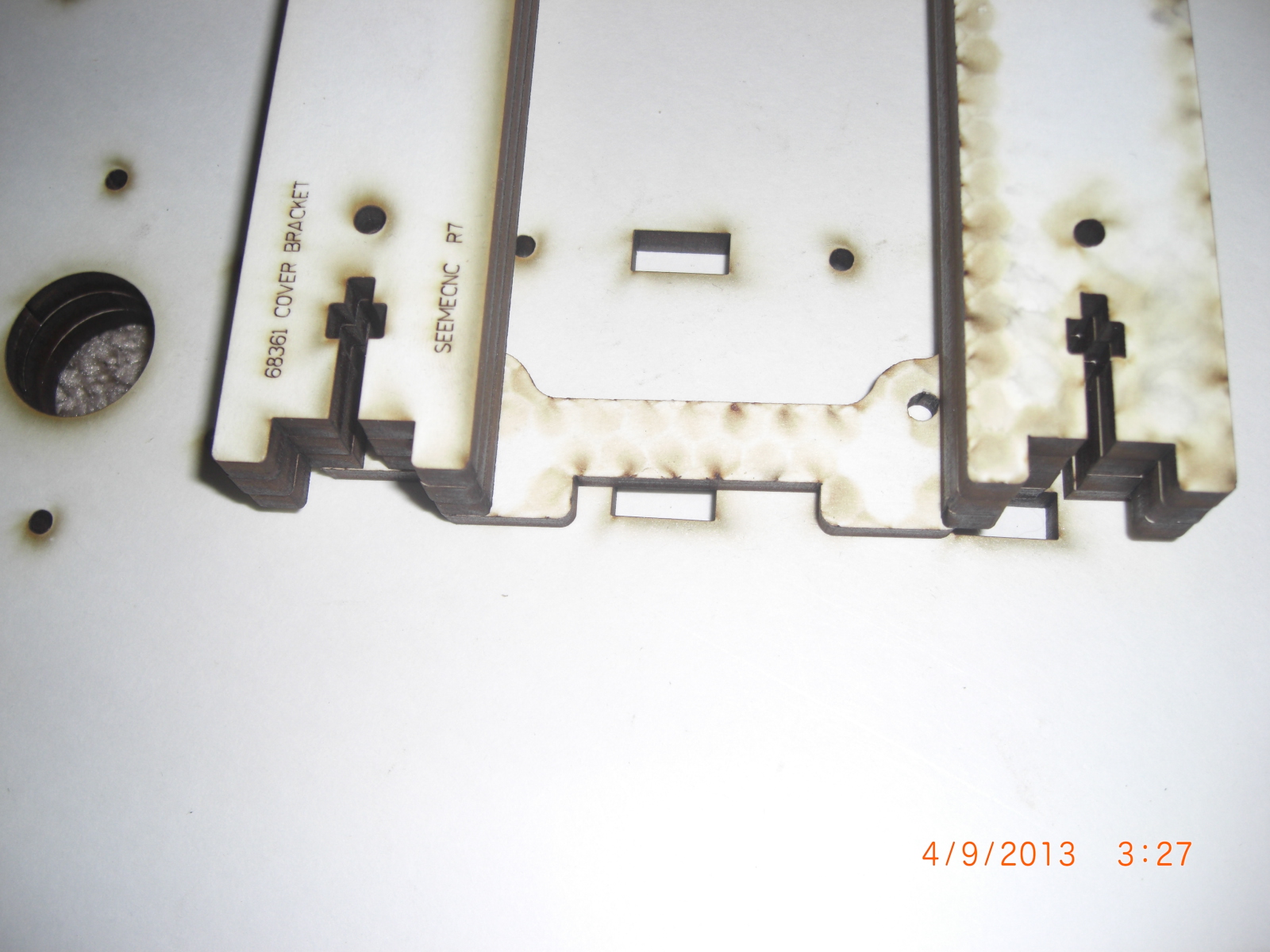

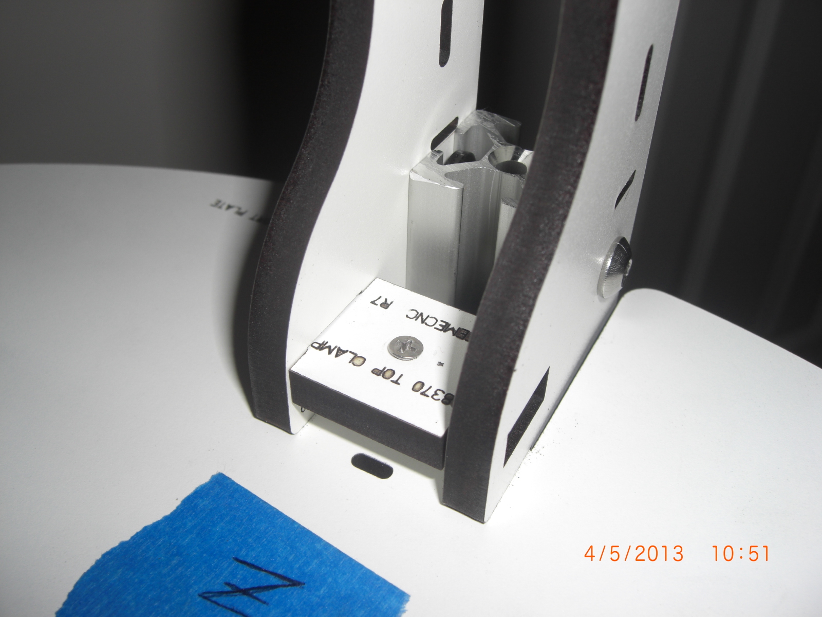

I thought I'd share this with everyone since there has been some confusion on how much gap to have between the extrusion and the frame. I am in the process of reassembly and I might as well show you how i did it. Following procedures assume you have checked your laser cut parts and all are aligned properly.
for this to work part numbers 68351 (base table top), 68368 (top support plate), and 68369 (TOP IDLER MOUNTS, check hole alignment) need to be perfectly the same. Sand if you need to square them up. photo shown below of the two circular plates stacked on top of each other. yes i know my spelling is wrong.
Once your ready to install the aluminum extrusions here's how to get them perfectly the same height. installation bolts are installed snug but not tightened yet at this point. If you dont have an extra t-slot nut, use whatever that fits in that hole.
WHATEVER, you used here make sure that the material is snug against the extrusion. (note: this assumes that all your extrusions are the same length also, check before you proceed)
install the screw that holds the top support plate to the extrusion, its one single screw held in by an anchor nut on the other side. (you can do this step before hand also, i just chose to put it here in the write up)
Once the above has been done. Grab the feeler gauges, flat automotive type, you get these from any autoparts store, I got mine from advance auto parts.
use the feeler gauge as space gauge. Press the extrusion against it and tighten up the bolts for the bottom. (select a feeler gauge that will give you the same space for the bottom and the top, mine came out to be .024in or .610mm)
next go to the top, and do the same thing. once you have the space correct tighten down the bolts.
Now repeat this procedure for the other two towers.
Once done all three towers will be at the same height and perpendicular to each other. Oh yeah, DONT FORGET TO REMOVE YOUR ALIGNMENT TOOLS (IE. T-SLOT NUT THAT YOU USED TO ALIGN THE BOTTOM AND THE MATERIAL YOU USED TO ALIGN THE TOP

I recommend to measure the height.
Re: Another rostock max build
Posted: Fri Apr 05, 2013 1:55 am
by cambo3d
it is measured, they all measured the same. And you can do this once your done aligning all the towers just to double check.
Everything should measure the same if all your laser cut parts are aligned like I stated earlier.
Posted: Fri Apr 05, 2013 2:18 am
by aehM_Key
Ok, great. I aligned with the marks and it was few mm off, when measuring.

Great job on the pictures and the explanation! This certainly has to be the best way to install the extrusions, the idea of using the t-nut on its side at the bottom was brilliant!
Thanks for writing this up, I am just at the point of installing the uprights and this is a godsend.

I just installed my uprights using your tips and everything came out perfect without trying to eyeball the lines and screwing around.
I highly recommend your method for anyone building the Rostock Max. Thank you for sharing these ideas with us. I'm not going to
mention a change to the "manual" but if anyone from SeemeCNC reads this thread they should consider this method of installing the
extrusions as the official method and document it as such.
Carl

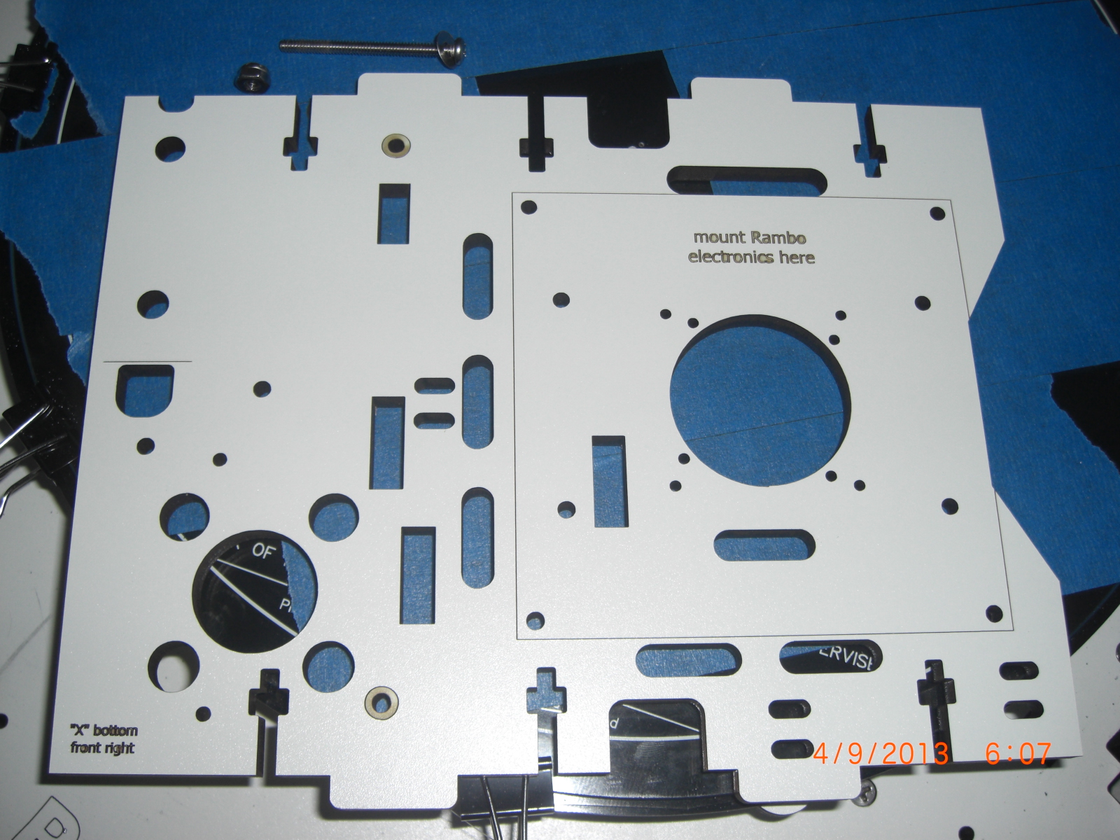

my new frame kit arrived from tricklaser.com also.. check out my custom made belt tensioner mount.
original left, new on the right http://forum.seemecnc.com/viewtopic.php ... &start=220
tricklaser TL-1 frame looks well cut and pre-removed from laser cutting sheet. packed nicely. will be assembling this and posting another report.
after some unpacking and visual inspection the kit is well cut, and very well aligned. top plate is perfectly symmetrical to the bottom plates. I can rotate the top plate to all three positions and the slots line up.
rambo mount is inside like the new rostockmax kits but it has more holes for mounting and running wires. also a fan mount.
