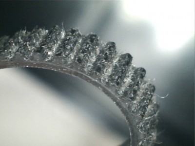

I took the belts off to check, there is some fraying but the teeth are still intact, i ordered another set to replace anyway.
bad section good section

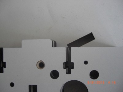

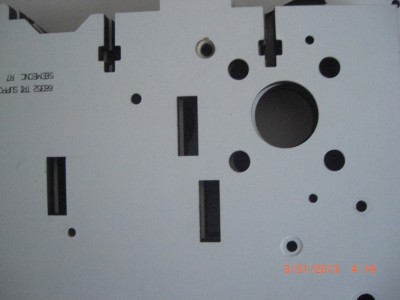

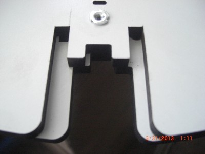

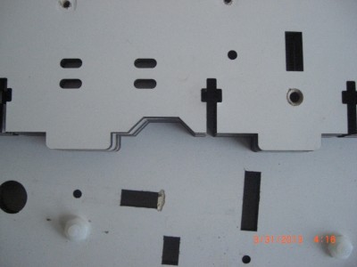

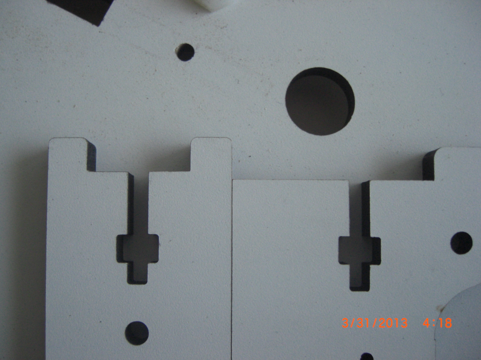

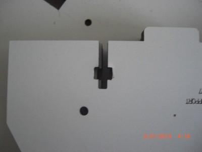

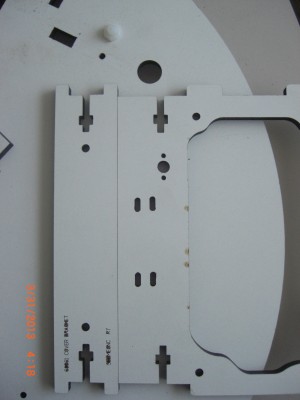

after seeing apachexmd's problem almost similar to mine.
I decided to take my rostock apart, I found the same issue he had. contacting seemecnc right away!
no matter where i rotate this, it's always off alignment. I'm gonna do some further investigating. I believe this is part of my calibration issues. after taking a couple more measurements and comparing i'm convinced my frame is off alignment. Wished i would have done this before I assembled it.
EDIT: 4/4/2013
THIS IS MAKES A DIFFERENCE IN HOW LEVEL AND SQUARE THE MACHINE IS ON FINAL ASSEMBLY. I WOULD SUGGEST TO ANYONE BEFORE ACTUALLY ASSEMBLING THE MACHINE, TO CHECK FOR ALIGNMENT OF THE LASER CUT PARTS. I'M WAITING FOR ANOTHER FULL FRAME KIT FROM TRICKLASER.COM. TO SEE IF THEIR KIT IS ANY BETTER; IF NOT, I'LL HAVE TO COME UP WITH SOMETHING TO KEEP THE BASE FLAT/LEVEL OR JUST REMAKE THE BASE ALL TOGETHER ON MY CNC ROUTER.
assembly suggestions:
check the alignment of all parts, especially all critical to alignment of the towers and the bed platform. the top plate needs to be aligned with the top of the bottom base plate (the labeled circular plate), I found that these two parts are not symmetrical, when I compared the extrusion alignment slots in the melamine, I found they were off unless you rotate it to a some what matching position, Even then you still have to sand a little for an even fit.My first kit was way off, replacement parts were better but still not symmetrical.
For the bed platform, make sure that all the individual vertical partitions are all the same height, if not, this will cause warping of your bed platform when tightening down the assembly screws.
My power supply retainer partition was way off, to a point causing extreme warping. Not only was this partition not the same height, slots on the partition needed to be sanded smaller to prevent it from warping the other partitions. there is major discrepancy in the fit of this particular piece. it is not dimensioned correctly. unfortunately this part was not included in my seemecnc care package of replacement parts. my workaround for this is to just leave it in the slots not tightened down, the slots itself will keep the partition from coming out. I would remove this altogether but it keeps the power supply in place.

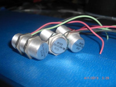

I'm going to try integrate these hall effect switches into my reassembly. The limit switches and the screws are bit finicky when it comes time to adjust z height. I'm hoping these will be better, accuracy wise. I had these in my electronics pile from other projects. http://sccatalog.honeywell.com/pdbdownl ... 13A-10.pdf

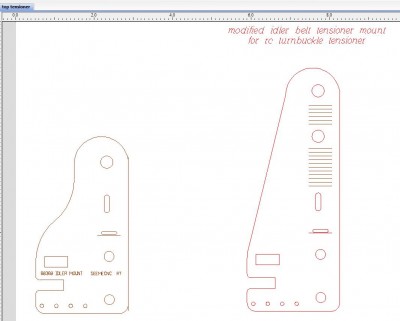

Reflecting back on ideas that I put a hold to, I've been working on modified upper idler belt tensioner mounts so I can get my turnbuckle idea to work. http://forum.seemecnc.com/viewtopic.php ... 8&start=90 Still plan to use off the shelf parts. Stock mount works but if you tighten the screw to much is damages the melamine. With this setup it shouldn't do that. If anyone wants a set. I'll see if can get someone to cut a larger run of these after I've tested them. I can put together a plug and play kit or you can have someone laser cut a set for you. I'll post the final dxf file here and other parts needed. Once everything is tested.

Re: Another rostock max build
Good for seemecnc! Sucks that you have to build it all over again but at least it should be flat and straight this time around. I like all the tensioner ideas too. Keep it up! (so i can steal them

Do you have any ideas of what to make the new part from? I would be interested in purchasing a set if they become available.cambo3d wrote:kudos, to seemecnc, they are shipping a replacement set for my misaligned parts. I ordered a frame set from tricklaser.com to try out also, Might actually end up with 2 rostocks after i'm done building..
Reflecting back on ideas that I put a hold to, I've been working on modified drawings for the upper idler belt tensioner mounts so I can get my turnbuckle idea to work. http://forum.seemecnc.com/viewtopic.php ... 8&start=90 Still plan to use off the shelf parts. Stock mount works but if you tighten the screw to much is damages the melamine. With this setup it shouldn't do that. I'll see if can get someone to cut a larger run of these so if anyone wants a set, I can get a plug in play kit together.
Carl
same melamine as the rostock
Why would this new configuration not be damaged as you tighten the screw if it is made from the same material?cambo3d wrote:same melamine as the rostock
with the stock setup you have to tighten down the screw against the melamine in order to keep the idler tensioner in place and it damages the melamine if you over tighten it. With this setup, you actually have to keep the screws that hold the idler tensioner loose so you can adjust the tension via the turnbuckle.

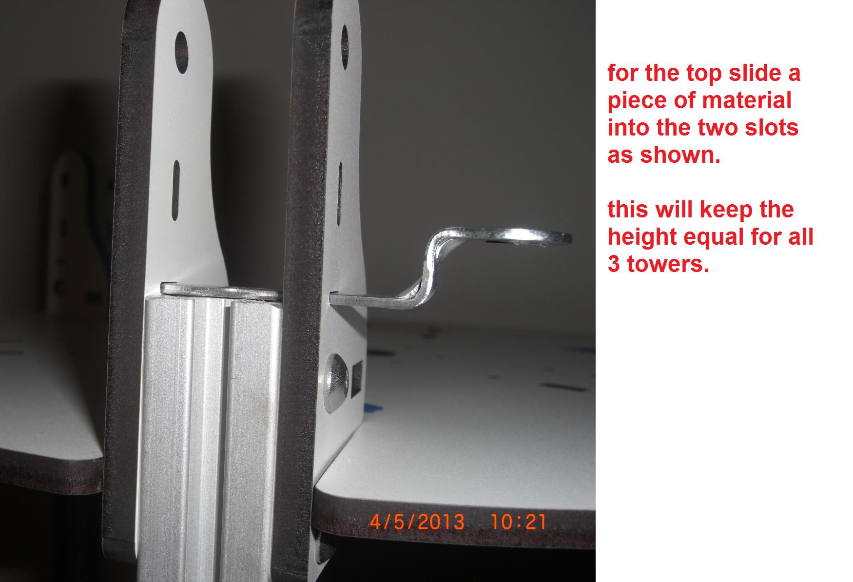

Better way to get your extrusions aligned properly
I thought I'd share this with everyone since there has been some confusion on how much gap to have between the extrusion and the frame. I am in the process of reassembly and I might as well show you how i did it. Following procedures assume you have checked your laser cut parts and all are aligned properly.
for this to work part numbers 68351 (base table top), 68368 (top support plate), and 68369 (TOP IDLER MOUNTS, check hole alignment) need to be perfectly the same. Sand if you need to square them up. photo shown below of the two circular plates stacked on top of each other. yes i know my spelling is wrong. Once your ready to install the aluminum extrusions here's how to get them perfectly the same height. installation bolts are installed snug but not tightened yet at this point. If you dont have an extra t-slot nut, use whatever that fits in that hole. WHATEVER, you used here make sure that the material is snug against the extrusion. (note: this assumes that all your extrusions are the same length also, check before you proceed)
install the screw that holds the top support plate to the extrusion, its one single screw held in by an anchor nut on the other side. (you can do this step before hand also, i just chose to put it here in the write up) Once the above has been done. Grab the feeler gauges, flat automotive type, you get these from any autoparts store, I got mine from advance auto parts.
use the feeler gauge as space gauge. Press the extrusion against it and tighten up the bolts for the bottom. (select a feeler gauge that will give you the same space for the bottom and the top, mine came out to be .024in or .610mm) next go to the top, and do the same thing. once you have the space correct tighten down the bolts. Now repeat this procedure for the other two towers.
Once done all three towers will be at the same height and perpendicular to each other. Oh yeah, DONT FORGET TO REMOVE YOUR ALIGNMENT TOOLS (IE. T-SLOT NUT THAT YOU USED TO ALIGN THE BOTTOM AND THE MATERIAL YOU USED TO ALIGN THE TOP
I recommend to measure the height.
it is measured, they all measured the same. And you can do this once your done aligning all the towers just to double check.
Everything should measure the same if all your laser cut parts are aligned like I stated earlier.
Ok, great. I aligned with the marks and it was few mm off, when measuring.
