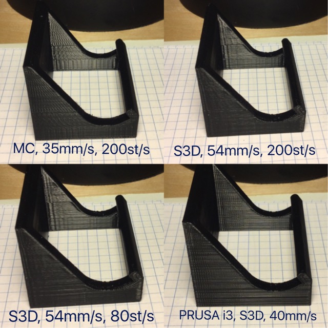

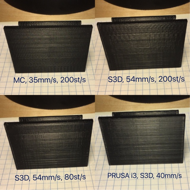

FWIW, here are my pictures of the thing I was printing under different conditions (an iphone holder).
I was slicing in MatterControl and Simplify3D. The banding gets tighter and more pronounced as you go higher, likely because the print slowed down as the layers got smaller. I also did a print on my Prusa i3 for comparison (less even layers but no banding).
The most annoying thing about the banding is that it is print-speed dependent, which makes the back non-uniform in prints with varying speed. I suppose I could keep the print speed the same to see if it gives me a more uniform pattern (at the expense of too-short layer times at the top or a slower overall print) - just wish I didn't have to do that. I figured I would add this data point in case it is helpful. I suppose I'll bite the bullet and get the Duet, if that's what solves this issue.

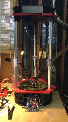

Well, this arrived today:
So here is my "before" picture: And I'll report once I get the Duet installed and configured. Hope it's not a mess - I might be posting on the Duet board for help!

And now the moment we've all been waiting for (or at least I have)...
Duet installed, calibrated, and...
Drum roll... Same GCODE file. No question - the banding is entirely due to the delta segmentation. I can die happy now.
This is a MAX V2 with stock EZ Struder, stock hotend with 0.35mm nozzle, stock motors (with Astrosyn dampers).
Printed on black PLA.
And now a picture of my printer looking like it's barfing a controller board: I'm going to do some additional calibration and cleanup, and if there is interest I can post my config.g file.
