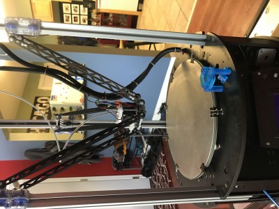

Not sure if anyone ever looks at this section anymore unfortunately I've got a V1 Rostock max that has upgrades still all the original electronics. It will not connect to my new touch bar MacBook Pro with the USBc ports. I do use an adapter, from what I can see the computer does recognize that there is a Rambo but Arduino will not send the Firmware to the machine.
I haven't used my Rostock in a while because of other printer purchases but id rather get some use out of it since I can't sell it for anything worth having at this point. I went ahead and installed a volcano e3d on this bad boy and plan to use it for non precise prints that I need printed quickly out of PETG.
any help would be greatly appreciated this is surely the best most active forum I've ever been on.

You can replace the controller with a Duet. I've done this to my V1s. I attach the Duet to the front door after removing the LCD panel.

Hey Gene just checked it out man a bit expensive for the board. I recently purchased a Form2 and really don't want to invest too much into the Rostock past the upgrades I've already done
Added new injection carriages, e3d volcano and the new ball joint arms, aluminum plate for heated bed.

You could grab yourself a Rasberry Pi 3 and install Octoprint on it. You'd get wireless printing out of the deal (the Pi 3 has built-in WiFi) and you can return the Mac to holding a door open. ;)
