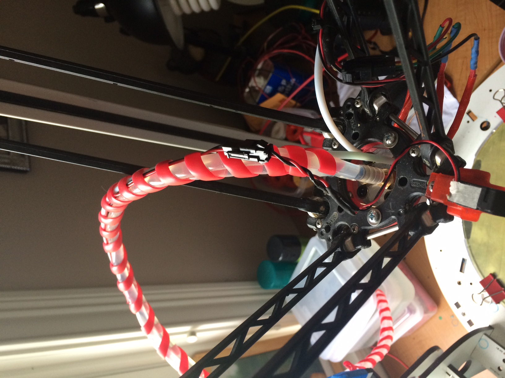

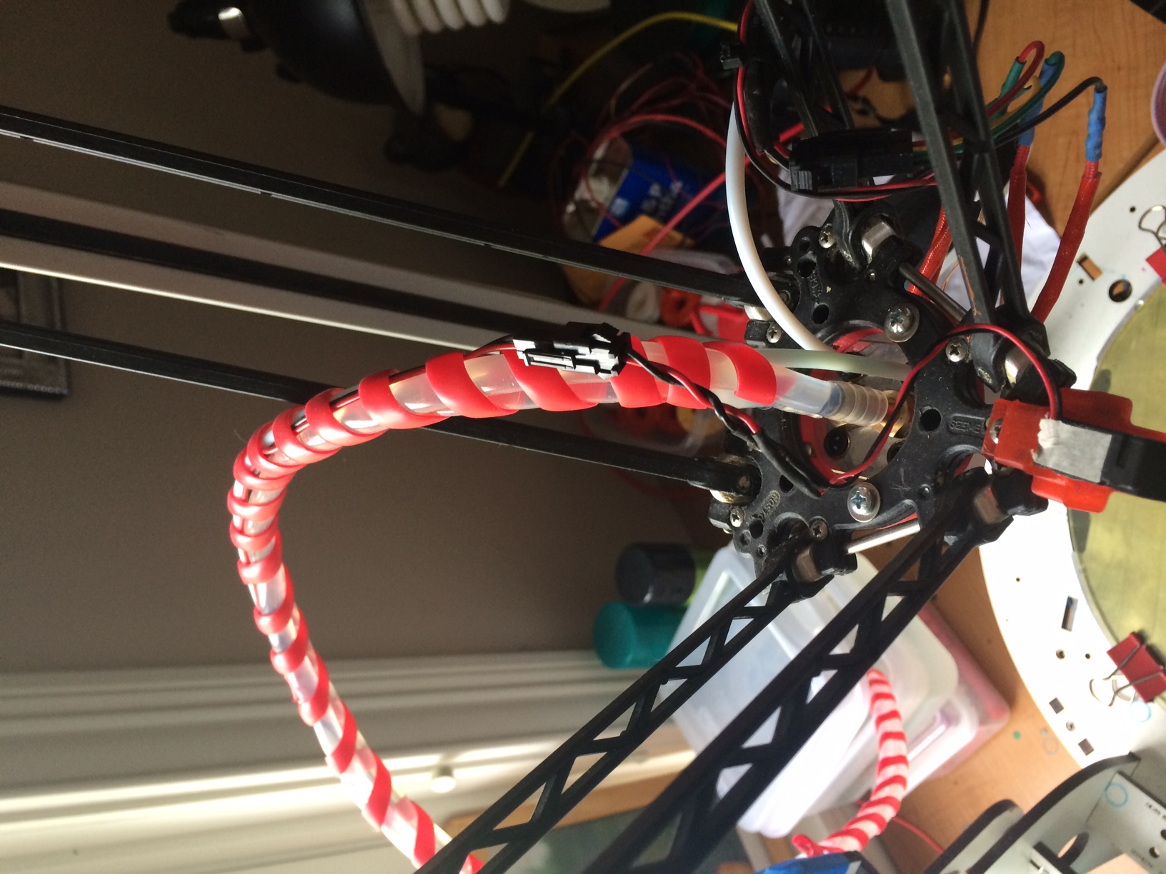

Finally got around to at least getting one head of the kraken printing, are you supporting the silicone tubing for the water cooler in any way?
Re: Kraken thread
Yes, I used cable wrap and wrapped both silicone tubes to one of the Bowden tubes that goes to a sidearm. From there, the silicone tubes split off to my water reservoir. This is the only photo I could find:

Here you go, this shows the Bowden with the silicone tubes wrapped together.
Re: Kraken thread
That red wrapping you used looks good, it matches the color of the effector.
