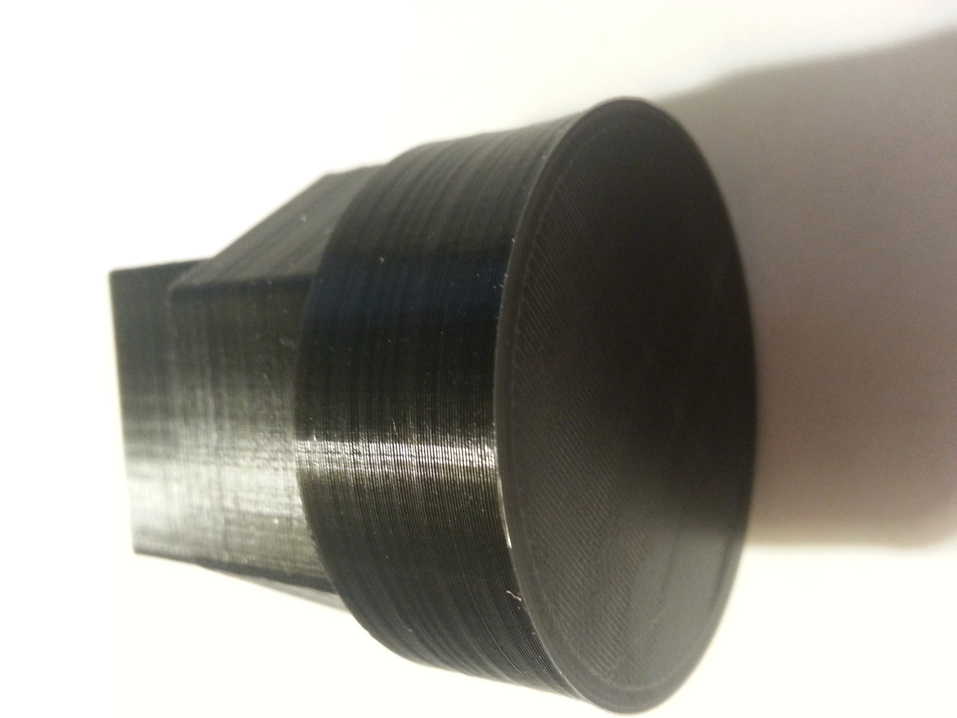

Ran a simple circle and I'm pretty stoked about the results. This was only a 200mm circle. ( I need to figure out how to remove the polygonal crap in DesignSpark). Anyways, started at 90mm/s then jumped to 180mm/s. Tried to increase the temp but it didn't want to go above 227c. The steppers stayed about 37c after 15mins of printing. I have the current somewhat low at 145.
The camera's auto focus was going nuts, sorry about that.

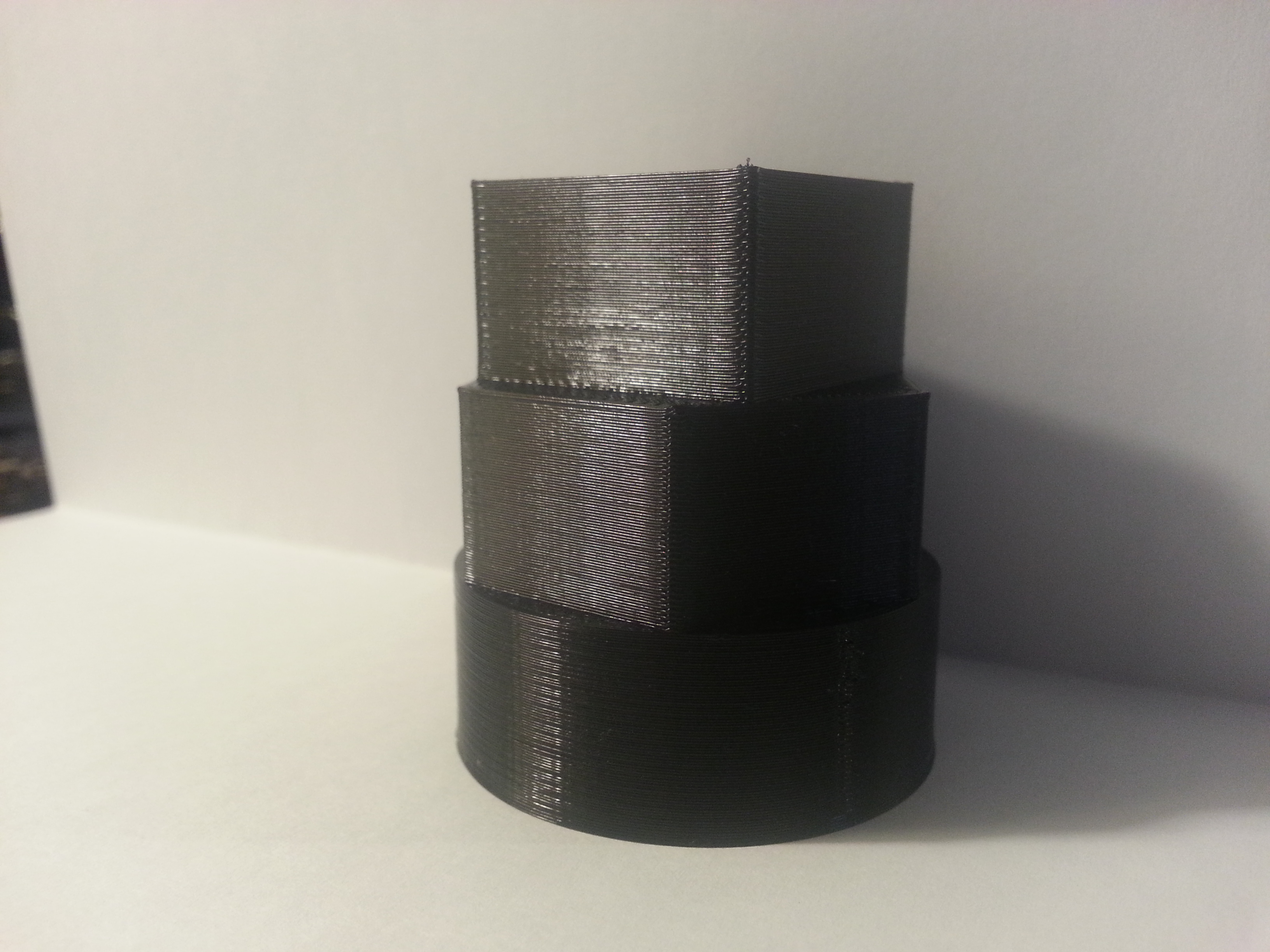

I finally setup the smoothieboard and this whole time I thought it was capable of 1/32 micro stepping, but I guess that's not the case without external drivers. This is my first print on the new controller and I must say that my calibration isn't quite matching what I was capable of doing with the Rambo and a dial indicator. I'll have to work on it a bit more with the auto calibration or try my hand at manually calibrating it.
Also need to figure out the layer lines that are visible on the bottom section and how to control the nozzle lifting that's creating the seam on the lower right side. No changes have been made to Simplify3D, but the nozzle purposly pauses and lifts at that location before coming back down and starting a new layer. Maybe it's normal, just never noticed it on the Rambo.

A question: have any of you tested printing with 1 perimeter and zero infill? My Rostock was banding about average vs what's been shown here, but then I happened to print a 1 perimeter calibration brick w/o infill (I was checking over/under extrusion vs layer height), and lo and behold it was as smooth as the proverbial baby's bottom, with all other settings the same as before!
Doesn't quite make sense, as I don't think the banding has the same pitch as the infill grid, but I was shocked & surprised when I saw how smooth the hollow box was. Could it have to do either with accel/decel associated with infill printing, or maybe the infill deposition reheating the perimeters & making them bulge? The difference was so striking, it seems like a major clue to me.
Unfortunately, I've had my printer in pieces, putting Trick Laser arms on it, as well as a MakerHive quick-change hot end board. I've been traveling and work-stressed, so only get a few hours on a Sunday afternoon to work on it every couple of weeks. Right now, hotend adapter is miswired, so the machine is dead, hoping to be back running tomorrow, though. Not sure I'll have time to also get it recalibrate do too, but will try some test prints when I do.
Meanwhile, have any of you guys tried a 1-perimeter print with no infill? If so, what did it look like?

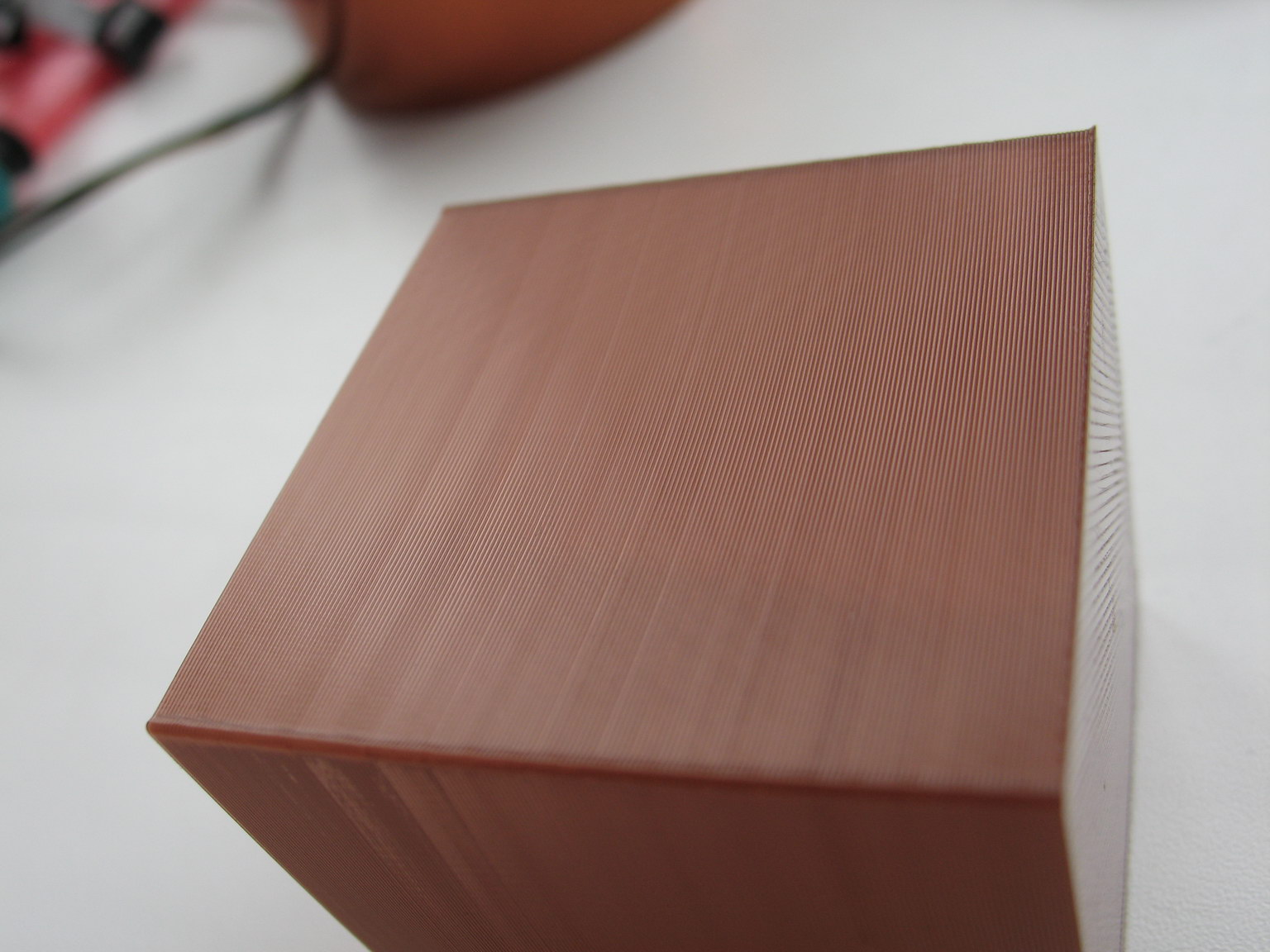

More perimeters only seem to mask the banding effect. The speed also plays a large role in the visual banding.
To date the best "fix" is to increase the overall resolution. By either lowering the pulley size or increase number of steps per revolution ( or both in the case of the below picture)
Infill from 10% to 100% produce the same sized external banding regardless of the infill percentage. I've tested 10% infill with no top, even the internal infill has the same vertical lines in each pass. Zero infill with multiple perimeters produces it as-well

Thanks for the additional info, and wow, that's a gorgeous print!
So, it seems we know these things:
- Essentially no discernible banding with perimeters only
- Any amount of infill produces it
- Extra perimeters mask but don't vanquish it
- 0.9 degree steppers and small pulleys pretty much eliminate it
I'm having a hard time coming up with a mental model for what could be happening, sure would like to figure out a good-enough solution that doesn't involve taking apart my printer coz it takes me a month of Sundays (literally) to find time to do anything.
It doesn't seem like a fundamental issue of insufficient spatial resolution, because it doesn't show up on perimeters.
The only way I can think of the infill causing it is if it's smooshing out the already deposited plastic in the perimeters.
It can't be just a heat-related thing, else the 0.9 steppers wouldn't make a difference.
So it seems it has to be an overshoot issue, where the hotend nozzle is traveling some distance into the perimeter when changing directions as it hits the perimeter area.
Can't be play in the arms, universal joints, cheapskates or belt stretch or 0.9 motors & smaller pulleys wouldn't make a difference. (UNLESS the print speed changed in the process - but it sounds like you're slowing down, just not radically.)
That leaves the steppers themselves, and I'll put another hypothesis out there: It's that whenever we have a situation where the head needs to change course abruptly, if we're also somewhere between full steps, the weaker holding power of the micro step positions isn't enough to stop the head right where we want it, so it overshoots. Places where we *are* right on a full step position, there's enough holding torque to avoid the overshoot. So we get ripples, depending on where the infill bumps into the perimeter, and where the full steps of the motors fall.
Changing to a smaller pulley not only reduces the amount of head travel per motor revolution (which should produce ripples with a shorter period), but it increases mechanical advantage, so the transient load felt ny the motor will be less, and the wimpy microstep holding torque may be enough to stop the head where we want it. I'd imagine that half as many microsteps with 2x the stator poles would give the same res but better holding torque.
What can we do short of a motor/pulley upgrade?
It'll slow printing a good bit, but I'd think cutting jerk way down would help. Can we control decel separate than accel? (Noob here) If so, set decel low but let accel (when the head will be moving get away from the perimeter after a direction change) where it was.
