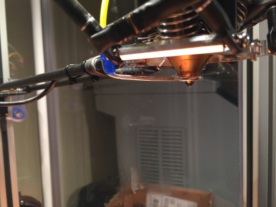

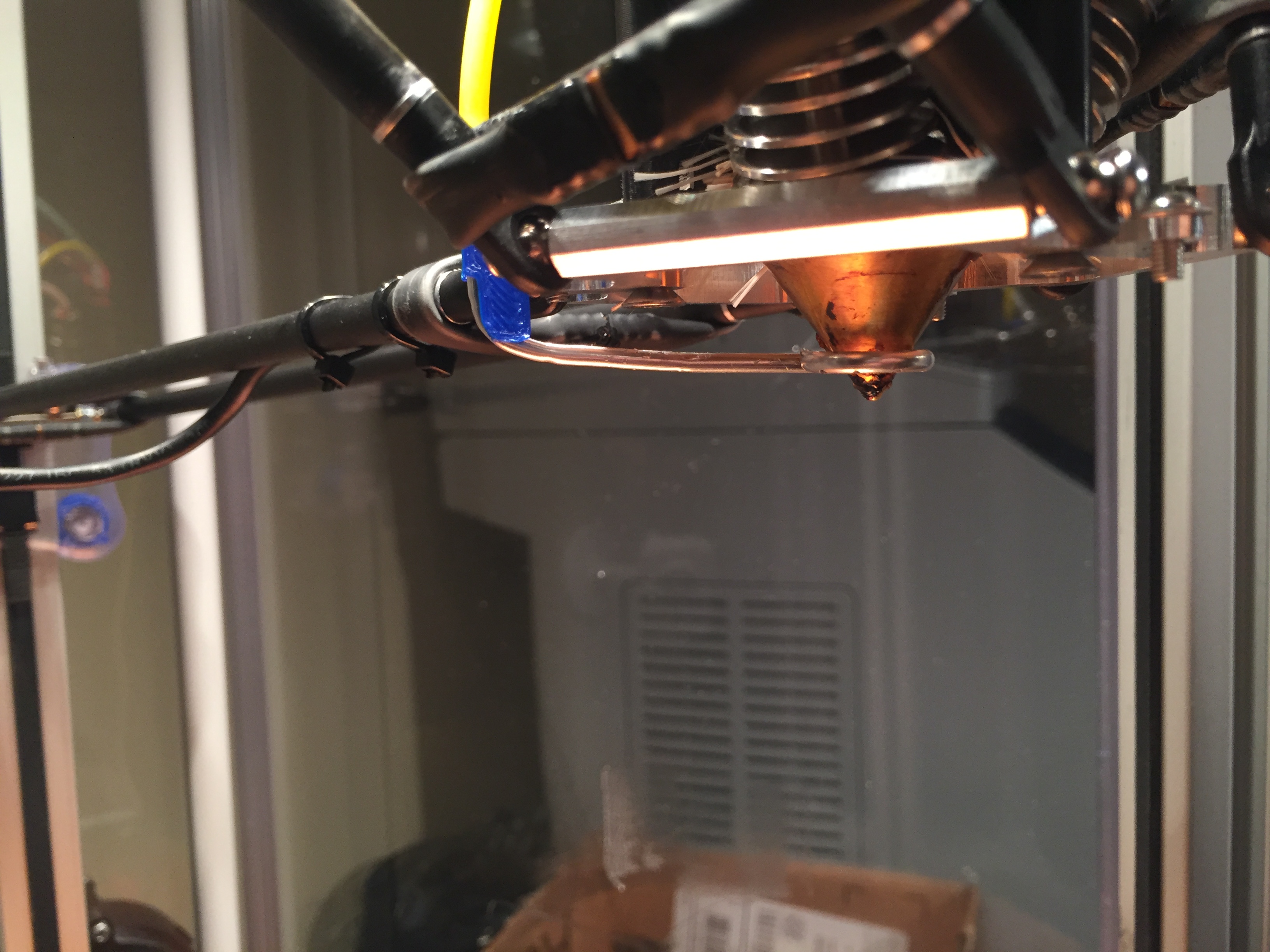

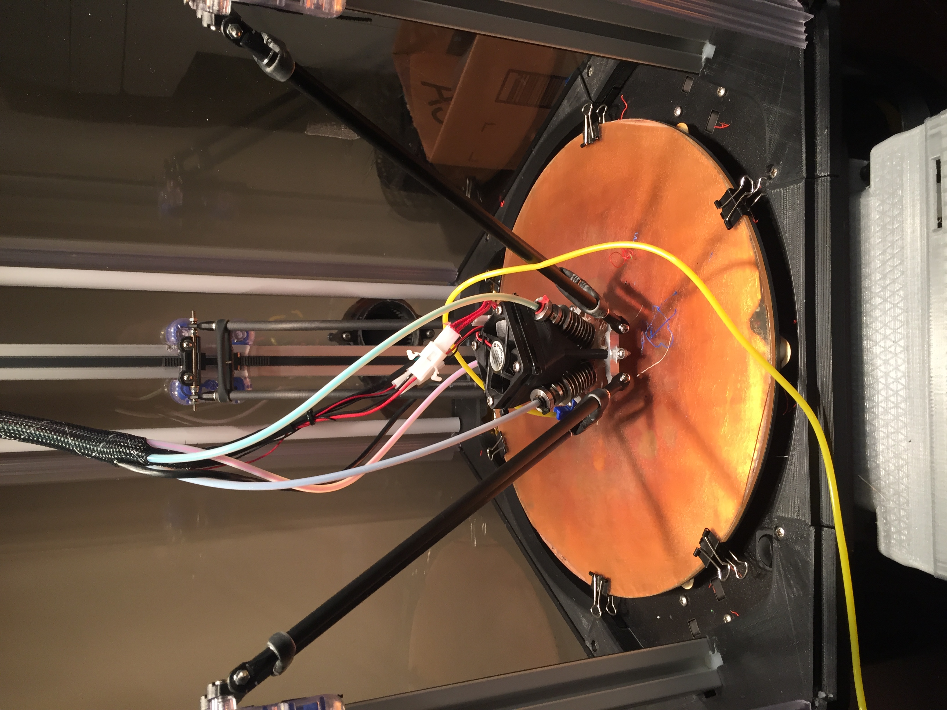

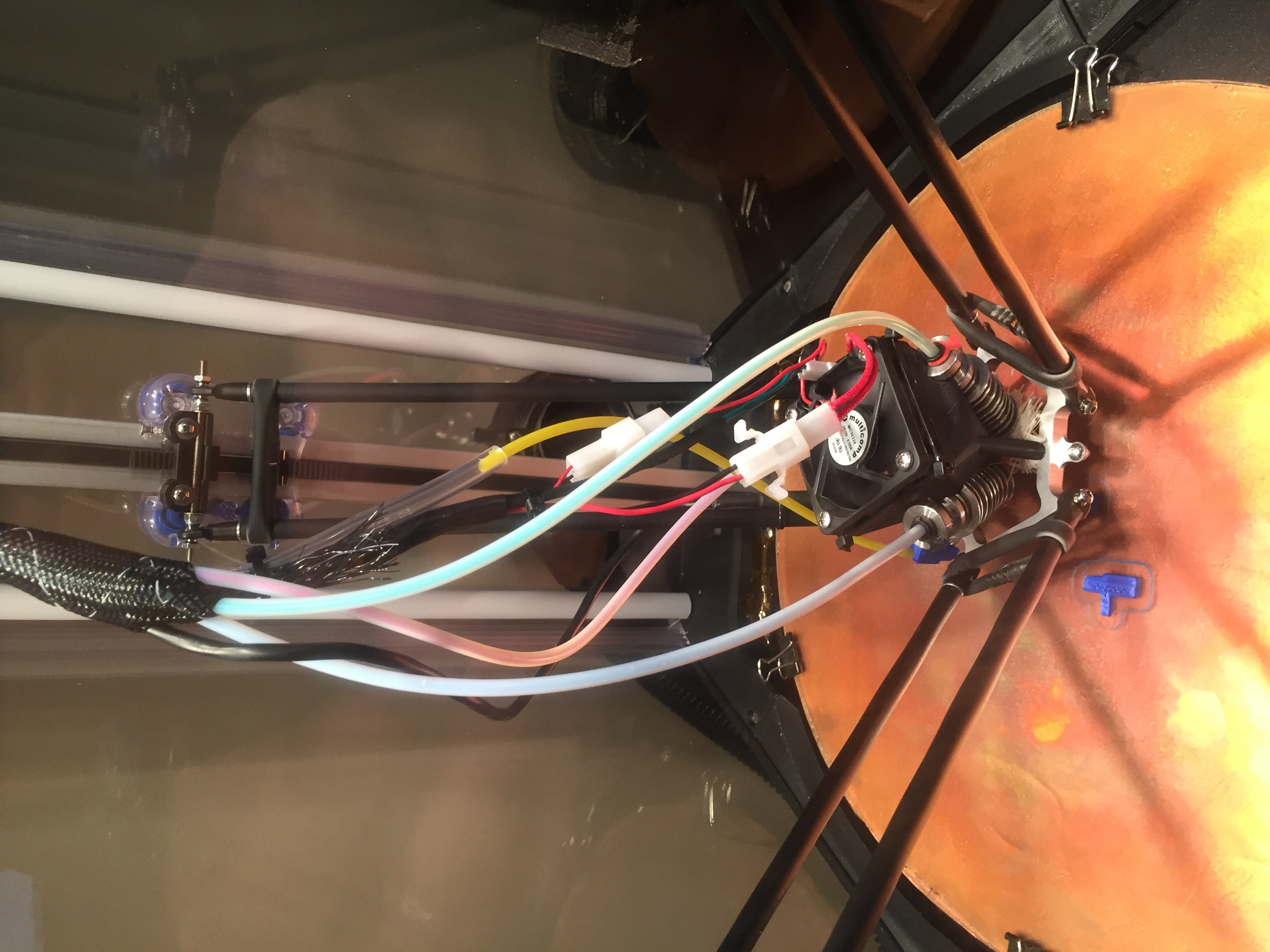

Installed the BerdAir. Will see how it works on small prints with the heat chamber. I set the air pump on top of the printer to deliver cool air from he ambient room. Not totally happy with how I bent the tubing and will tweet it later.
Addendum: Added photos and the STL of the the bracket I made for the BerdAir.

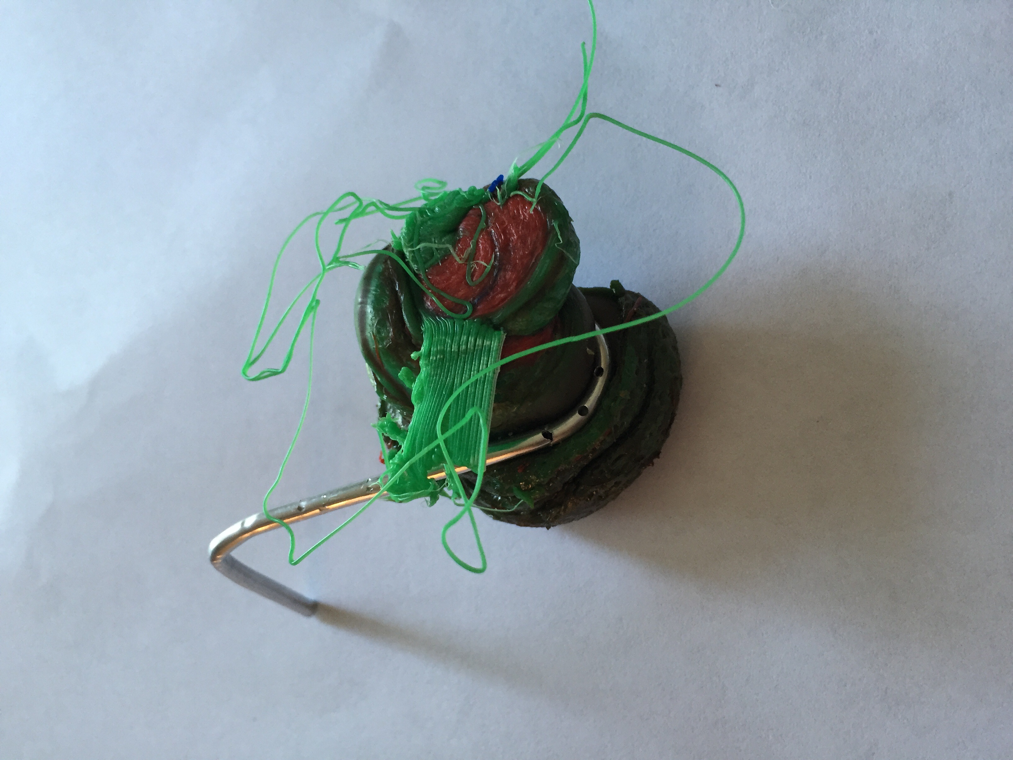

Massive failure. Just ordered some new BerdAir tubing.
My first layer didn't adhere. I had too much of a gap and thus poor adherence. Try again.

Yep. That's the weak point of the Berd Air. Perhaps if we could anchor it at 3 points or so (Perhaps when I get a new one I'll solder a pair of supports to it, so it won't potentially droop into the work piece, as I've mostly stopped having adherence issues)

I also realized I had the fan on at 100% for the first layers. Likely didn't help with poor adherence of the first layer.
