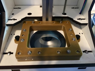

Along with the above, I needed to do something about a new vat. I had started to build a flex vat 18 months ago with a new built in leveling build plate. I finished that off today. Here's the new 3 part flex vat with .005" FEP film. Custom made to fit the DropLit V1 beta I have. I can cut the base plate to rectangular to reclaim the extra print surface too.
I am now 257 layers into a 425 layer print but I have not opened the door to look inside. I have an intermittent issue that might be static related that causes the Pi to stop communicating with the printer and projector and I don't want to risk messing it up. I need to permanently mount the Pi as it is just laying on the desk. I did get 12" HDMI and USB cables to minimize the cable runs form it to the projector and GRBL controller.

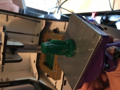

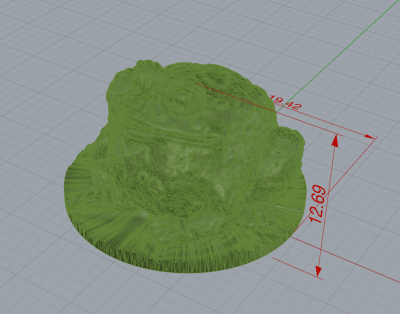

Here's what I'm trying to print:
Here's what I got after my wife walked into my office and the static must have zapped the GRBL. 300ish layers:
It is stretched in Z but I think I figured that out. NanoDLP had 3mm pitch leadscrew and the DropLit V1 has a 1/4-20 (20 turns/in) screw. That's a a little over 1/2 so that probably was the problem. I do know that my Z is calibrated, I instruct it to move 100mm and it does.
I mounted the pi on the side of the DropLit so hopefully that will fix the zapping problem. I am running toad two print now.

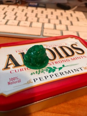

DropLit 3D printer and projector: $1200
Hours of pain and agony: 40
Cute printed toad: priceless!
Lessons learned with nanoDLP:
1) don't trust the slice after changing anything in the Printer Profile. For some reason, it doesn't pick up the new parameters and there is apparently no way to force re slicing, you have to re upload your model and reslice.
2) prepare the projector manually first and have it project a black slide. Otherwise, the projector's logo (at least with my Acer) burns in on the first few layers
I would still like to figure out how to automate the projector startup and shutdown. When this print was complete, I do have ending gcode to lift the part from the vat. But I was attending a wake tonight so that happened while I was away. When I came home the toad was fine but I now have "Acer" and "HDMI detected" plastic burned in my vat!
