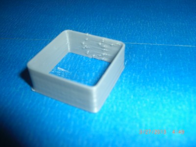

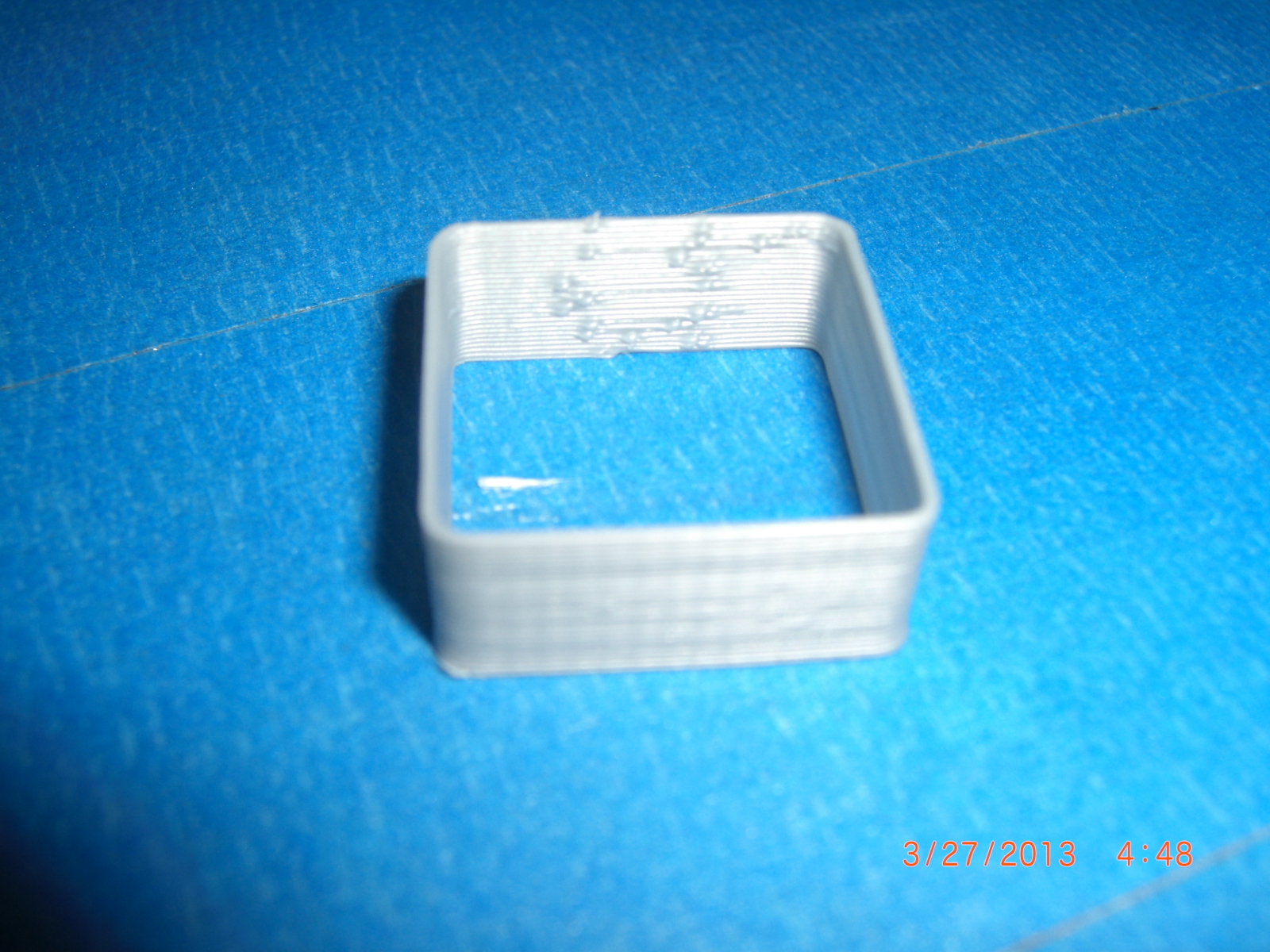

with the thin walled calibration print, what exactly am i checking for? height, width,??? http://www.thingiverse.com/thing:5573
or just thickness of the wall?
Re: Another rostock max build
At this point:
getting good first layer adhesion - check
getting good layer adhesion without gaps or overfill - check with a little work to do on the blobs. Your extruder appears to be reasonably well calibrated and filament pressure correct.
no signs of backlash (i.e. parallel sides, plumb sides, layers stacked properly) - check
Now you can measure wall thickness, width and height and compare to your model and slicer settings - priceless (sorry, had to add that!)

do i really need to check that last line, or was that just being funny? seriously i dont know...lol

cambo3d wrote:with the thin walled calibration print, what exactly am i checking for? height, width,??? http://www.thingiverse.com/thing:5573
I have used that to help calibrate x-y steps/mm by comparing the width and length to what it was supposed to be. Most often though the goal with that cube is to tweak single wall thickness. Try to get a good measurement of the wall thickness, one layer is best (be careful not to cut into it with calipers). Now compare that to what the g-code thought the layer thickness was. If they are close, tweak your extruder flow modifier in the slicer. If they are way off apply the change to your e-steps/mm.

Sorry, I was being serious and funny all at once! It is good to verify dimensions at this point.

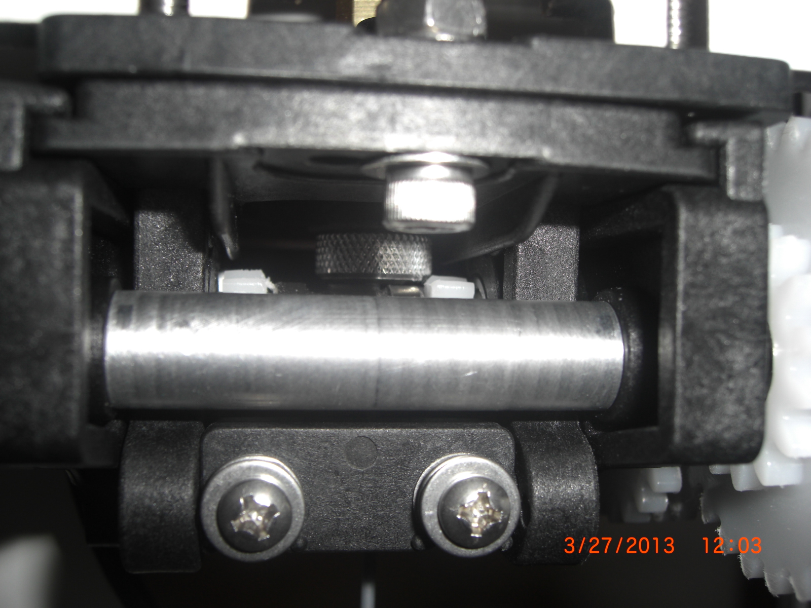

i'm noticing my extruder is getting loud, sounds like wood creaking ...hmmm

Mine also creaks. And sounds like a can full of rocks on retracts. My other printer has a direct drive extruder (bowden also) and is much, much quieter. I want to figure out how to get one on here and try it out.

Mine has the same squeak. I haven't gotten a chance to try 3in1 Oil on the gears yet.
I took the extruder apart and checked it nothing seems to be out of the ordinary, but at the same time while it was off, i sanded a bevel into the smaller gears near the filament roller, it seemed like it was rubbing against the bottom of the bowden adapter nut. I Put it all back together and the creaking noises went away. I can't be positive that's what caused it but might have been a combination of that and retorquing the assembly bolts. at least the noise is gone for now.
gabrielk had that issue too and he posted about shaving a bit of plastic to allow the knurled nut to thread a little higher up to avoid the gear

I saw that but i didn't want to sand that area down, i think its that length for a reason to help the filament from binding. I think beveling the gear is a better ideaApacheXMD wrote:gabrielk had that issue too and he posted about shaving a bit of plastic to allow the knurled nut to thread a little higher up to avoid the gear

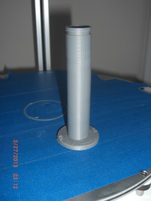

I got a little ambitious last night. Since my calibration prints were coming out ok, I'd try something more useful. The spool holder, not perfect but still gonna be put to use. http://www.thingiverse.com/thing:60750
what infill pattern would you have used for the base of the spool holder and how do i get rid of the blobs.

The print looks pretty good.
On the base it just looks like you are extruding too much plastic.

do i just adjust flow rate, while its printing to reduce plastic? then change it back when the infill is done?Polygonhell wrote:The print looks pretty good.
