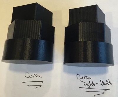

Re: Vertical Banding Revisited

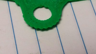

So... My belts were looser from the last round of modifications that I normally like, and I was suspicious that this had something to do with my print quality on the bandaid piece. Tightened the belts, reset my Z0, and bam - The print was absolutely identical. I couldn't tell a difference at all :/           I'll have to try a different slicer as the next test.

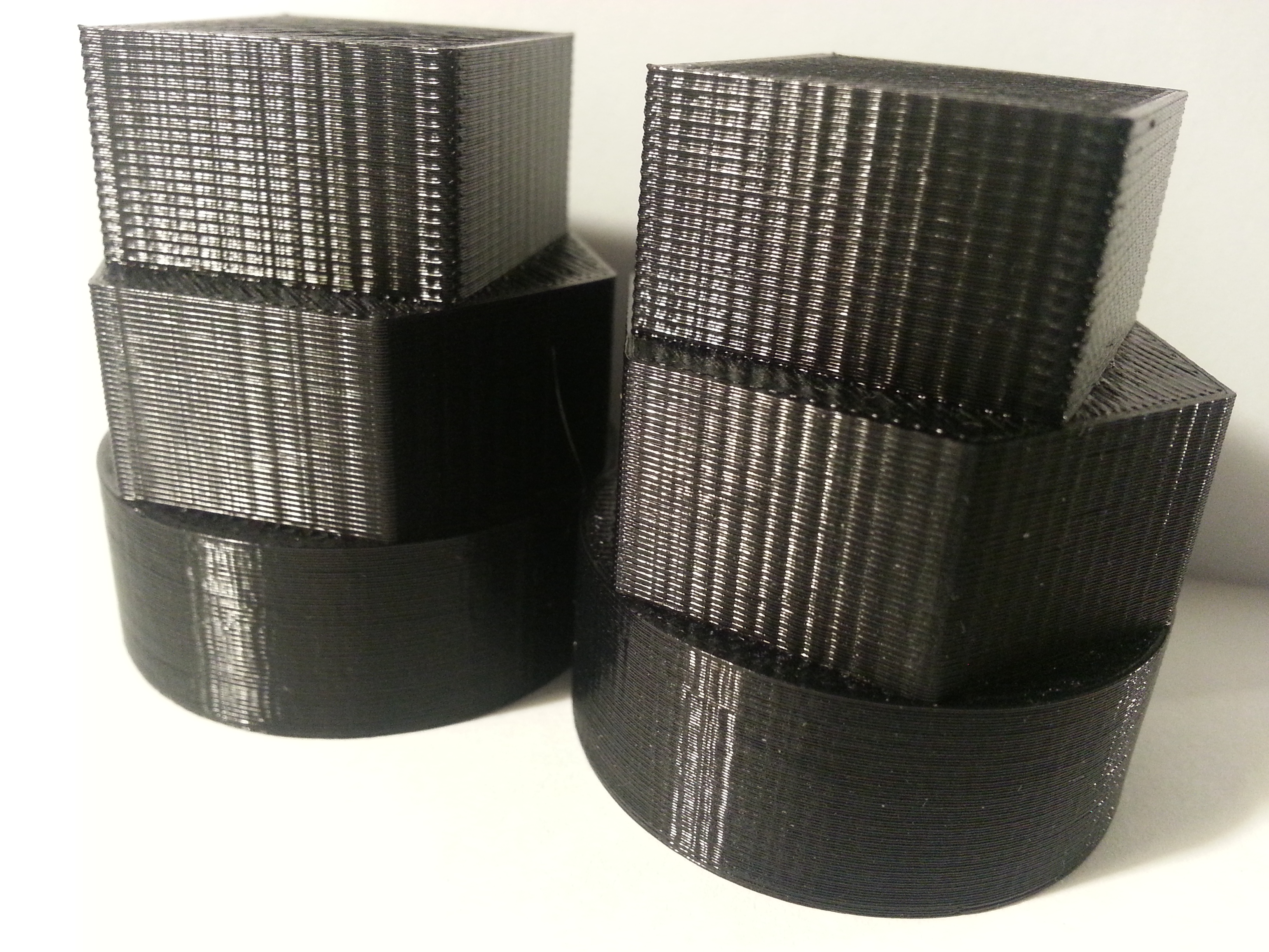

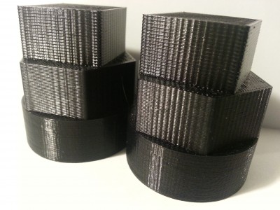

The original on the right was printed at #define MOTOR_CURRENT {155,155,155,165,0}
The left was printed the exact same print settings, #define MOTOR_CURRENT {130,130,130,165,0}
At that low of current I'm sure I would see issues towards the perimeter, although nothing noticed at the center.
The banding is muted, not as sharp. Specifically on the center section. My only theory is the current is creating a stronger magnetic force causing the armature to snap every step. This might be why the banding smooths out when printing at higher speeds.
Anyways, It made a difference enough to want to explore .9 degree steppers and/or/with 1/32 microstepping. I don't think the Rambo 1.3 supports?(could be wrong).
Guess I'll order a few 400 step motors and wait for the GLCD to come in before installing the Smoothieboard.
The other options I would like try is running the belt smooth side down over the top pulley. Or looking for a finer tooth/belt combo.

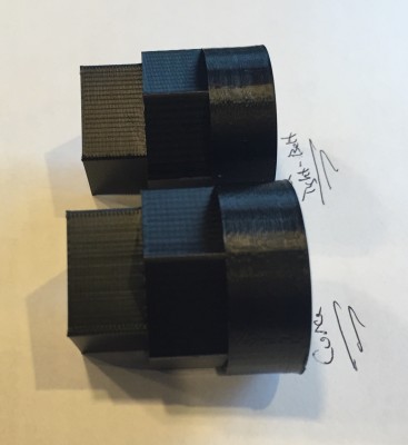

After I tightened the belts and cheapskates I reprinted and compared.  It is much better but still present.

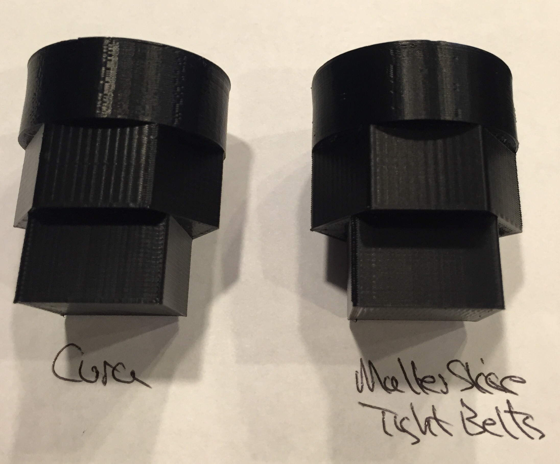

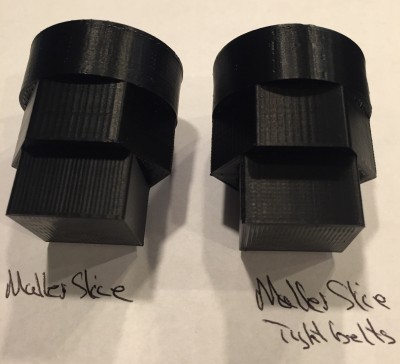

I reprinted using Cura.  I dont think this is really any different!!

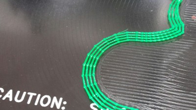

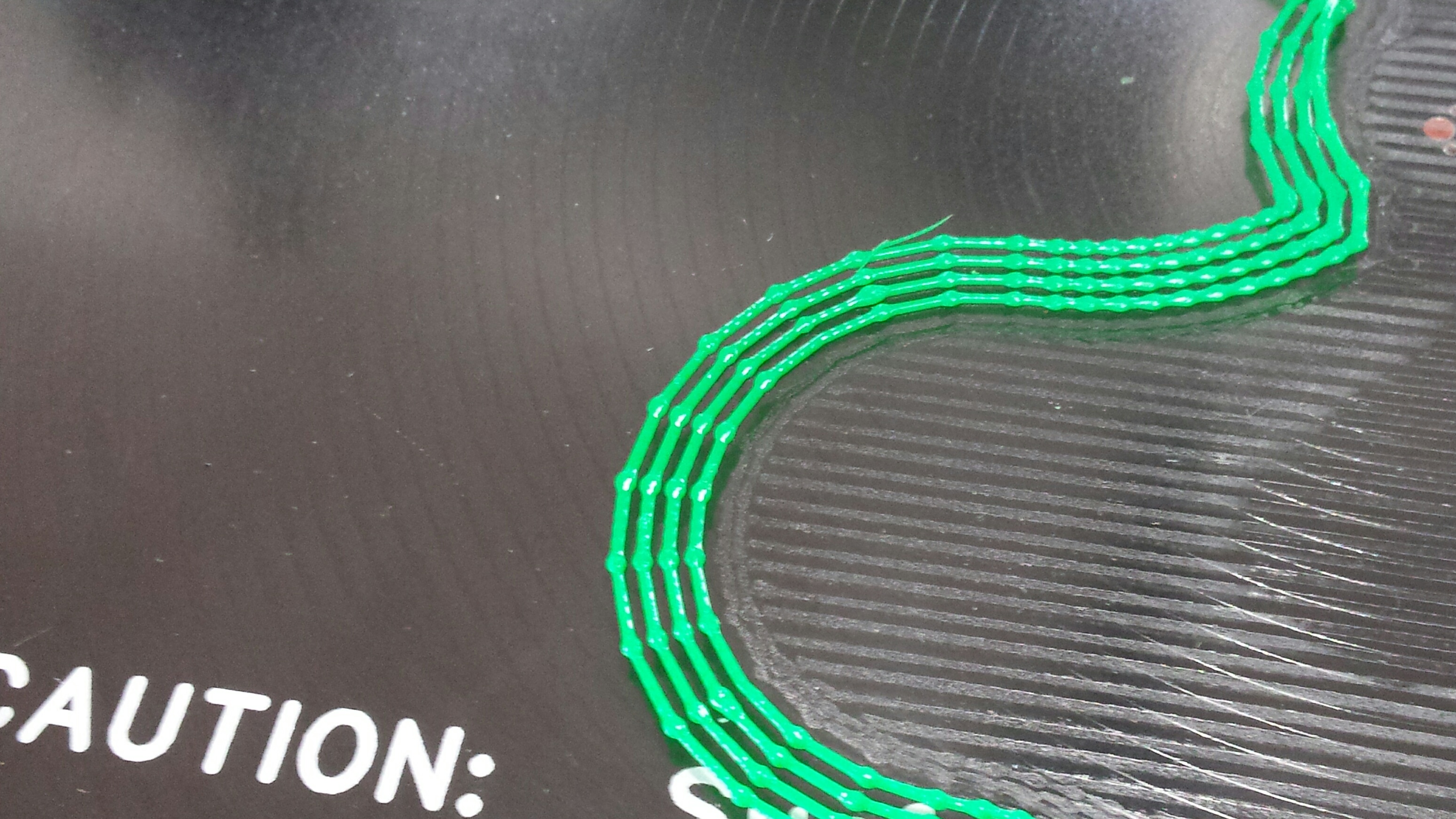

I wanted to bump this as I think it is very important, I was pondering this, and I wanted to throw this out there, I do think this is related to a problem I was having a few months ago with ALL of my prints, namely the printer would print in steps, stopping and leaving material and then continuing on. a reload of a clean configuration file  solved it. here is a pic of what it looked like
 if I did a print it showed the same thing is the radius of all the prints, this is the perimeter of a print. it would show extreme vertical banding which this produced obviously in the print
at first I thought this may be a problem with my extruder stepper not stopping its extruding when the head stopped, but working thru it with JJ seemed to suggest it was actually how the Rambo was interpreting the slice data as it did not matter which slicer I used. the hot end would stop and start as it made a radius, not on the straight sections of the print though.

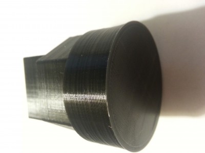

400 step motors installed with 16 tooth pulleys. Just finished the calibration and a quick test to make sure my config was correct.
Starting the banding test now.

(steps * microstepping) / (teeth * pitch)
(400 * 16)/ (16 * 2) = 200 steps per mm
This is by far my best print to date.
