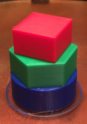

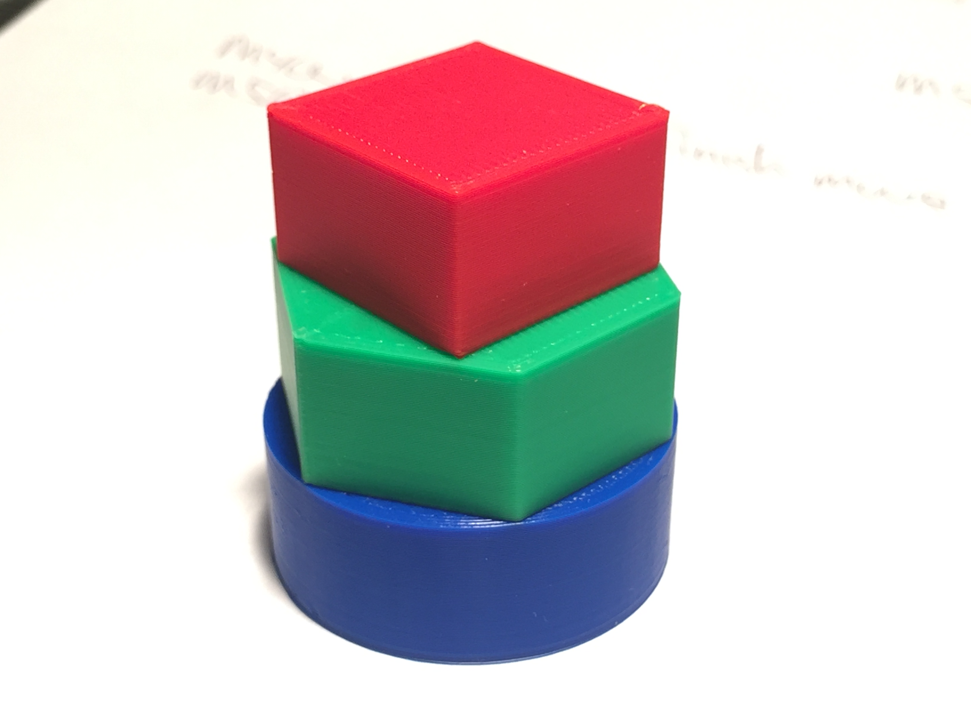

Re: My "BAP"
Getting closer!!!
Printing the BandAid in multi-color. Inserted the M567 P0 E1.00:0.00:0.00 gcode into the print file gcode at each change in geometric shape. This switches the extruder and extrudes each color at 100% (I.e. 1.0).
The cool part with this mixing g-code is that you can set any ratio of the extruders.
For example is that you can:
- Run extruders 1 and 2 using Tool 0 at 50% each: M567 P0 E0.50:0.50:0.00
- Run all three extruders using Tool 0 at 33%: M567 P0 E0.33:0.33:0.33

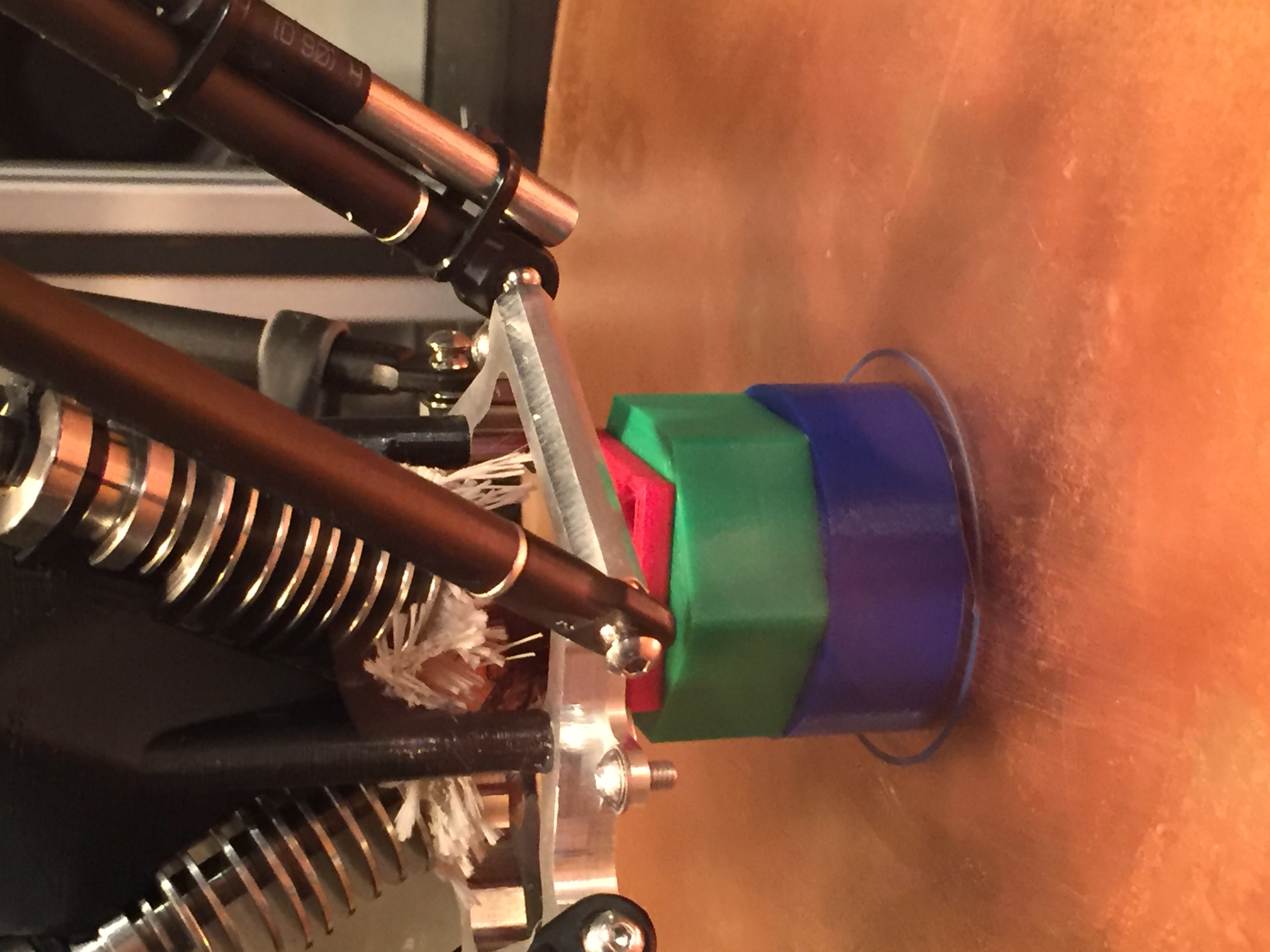

Re: My "BAP"
As well, with the Duet web interface you can issue this M567 code and send it to the printer at any point in the print. The one issue I need to resolve is that there is a 30 seconds delay and pause in the print when I send this code. I think this is due to the print buffer being used/full.
I have a question out to the RepRap forum on if a M400 g-code as suggested by "IMBoring25" will keep the buffer clear and make the change without pause. I am going to try that next!!!

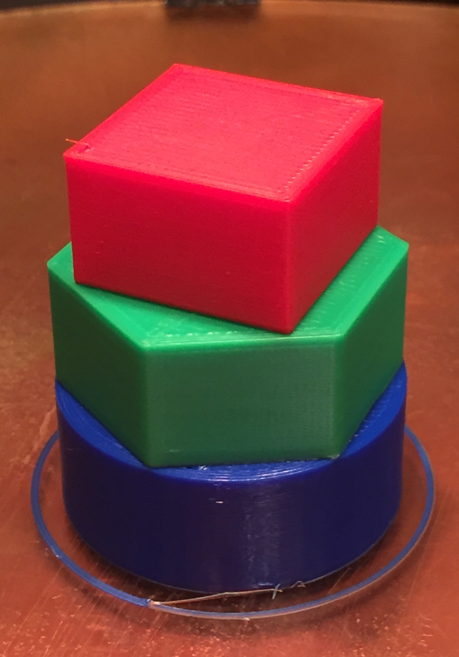

Re: My "BAP"
The final print!!
Re: My "BAP"
Turned out great!
Have you tried converting 0..255 RGB values into percentages and see how close you get to the target color? I won't be as good as CYMK, but it might be ballpark-ish.
