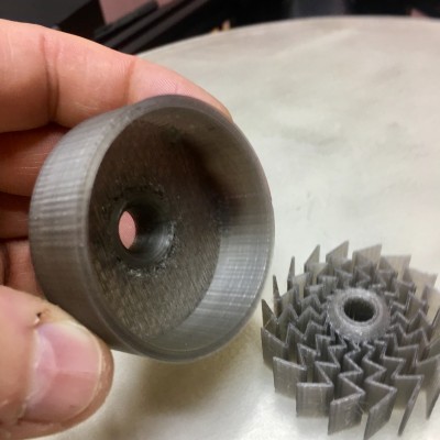

A couple of tricks I like to use is to use zig zags like the support in this photo:
You can either make the entire support structure the zig zag like the one in the photo or put a 1 or 2 layer hight zig zag on top of a more solid support platform in order to cut down bonding surface area.
All of the above can also be used to add support to an existing STL file. Organic shapes like figurines (Yoda!) might be more challenging so auto generated supports might be a better option. I design primarily functional and mechanical things so the "Supporting Rules" work well.
