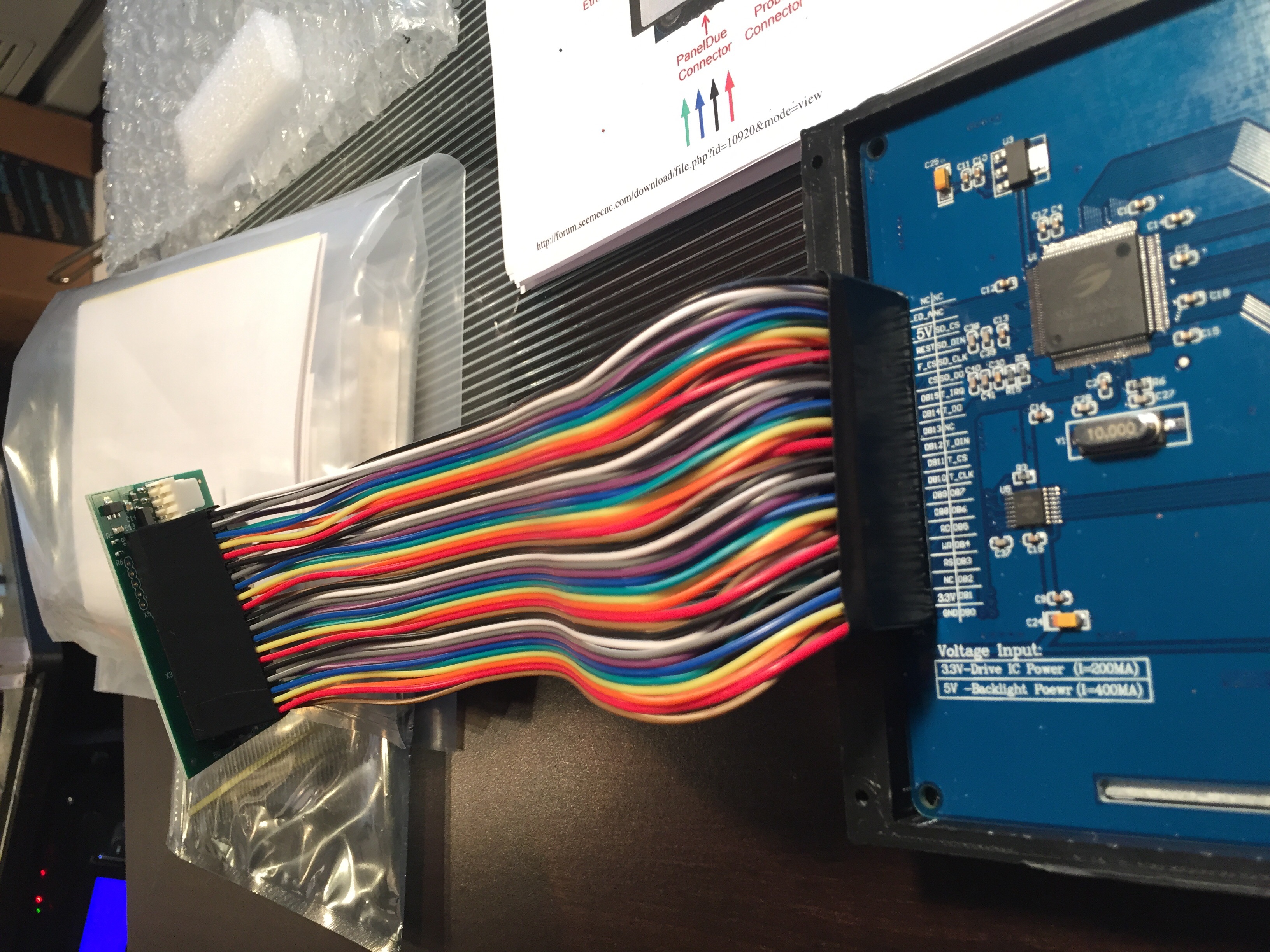

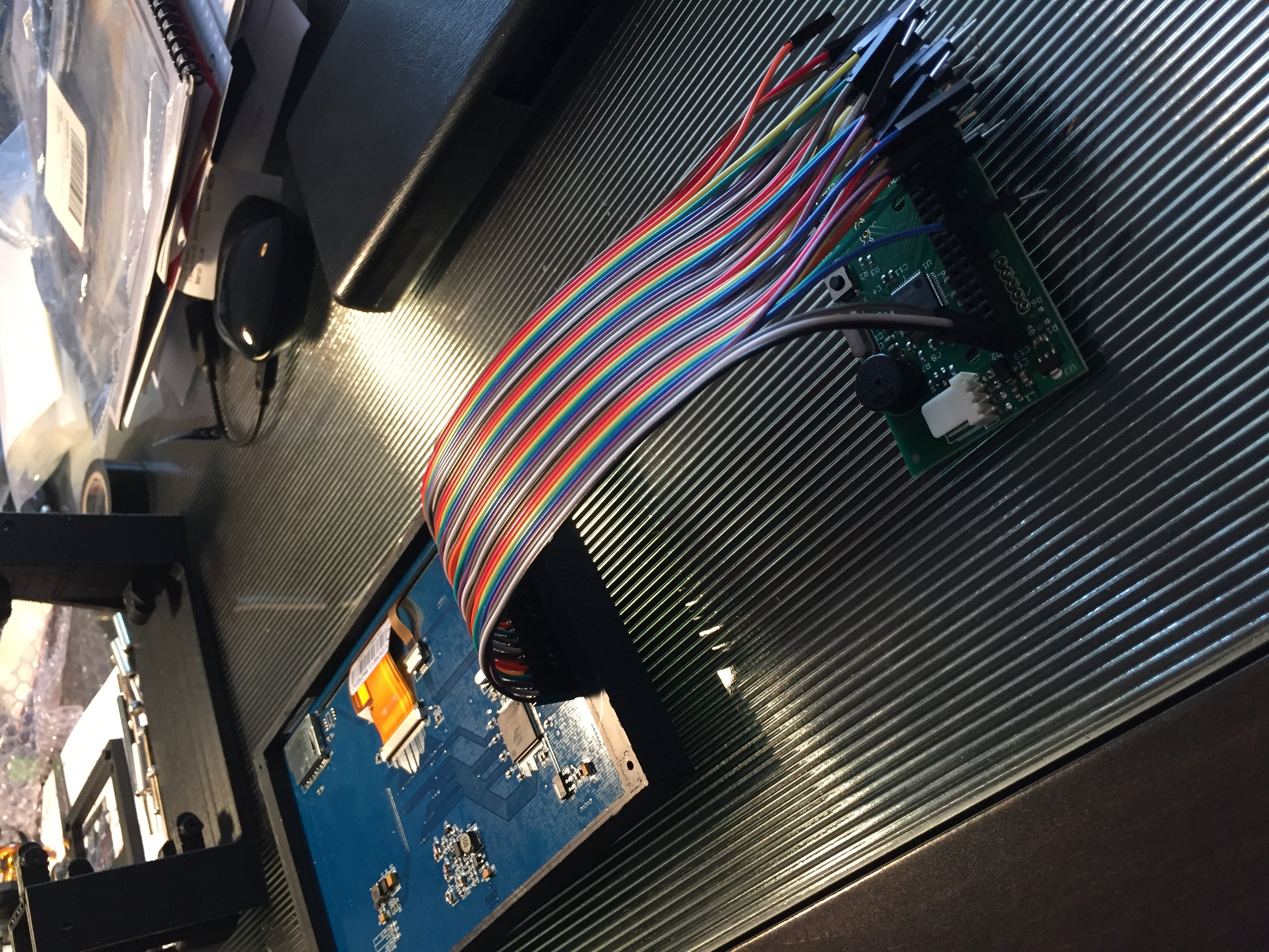

Printing the above Duet and PanelDue files. Also connected the PanelDue and the PanelDue controller with a 40 pin male to female bread board connector ribbon. Importantly, if you do not connect your controller directly to the PanelDue, make sure you connect them correctly.

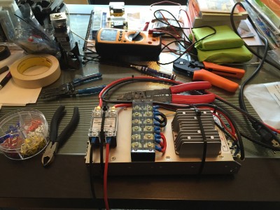

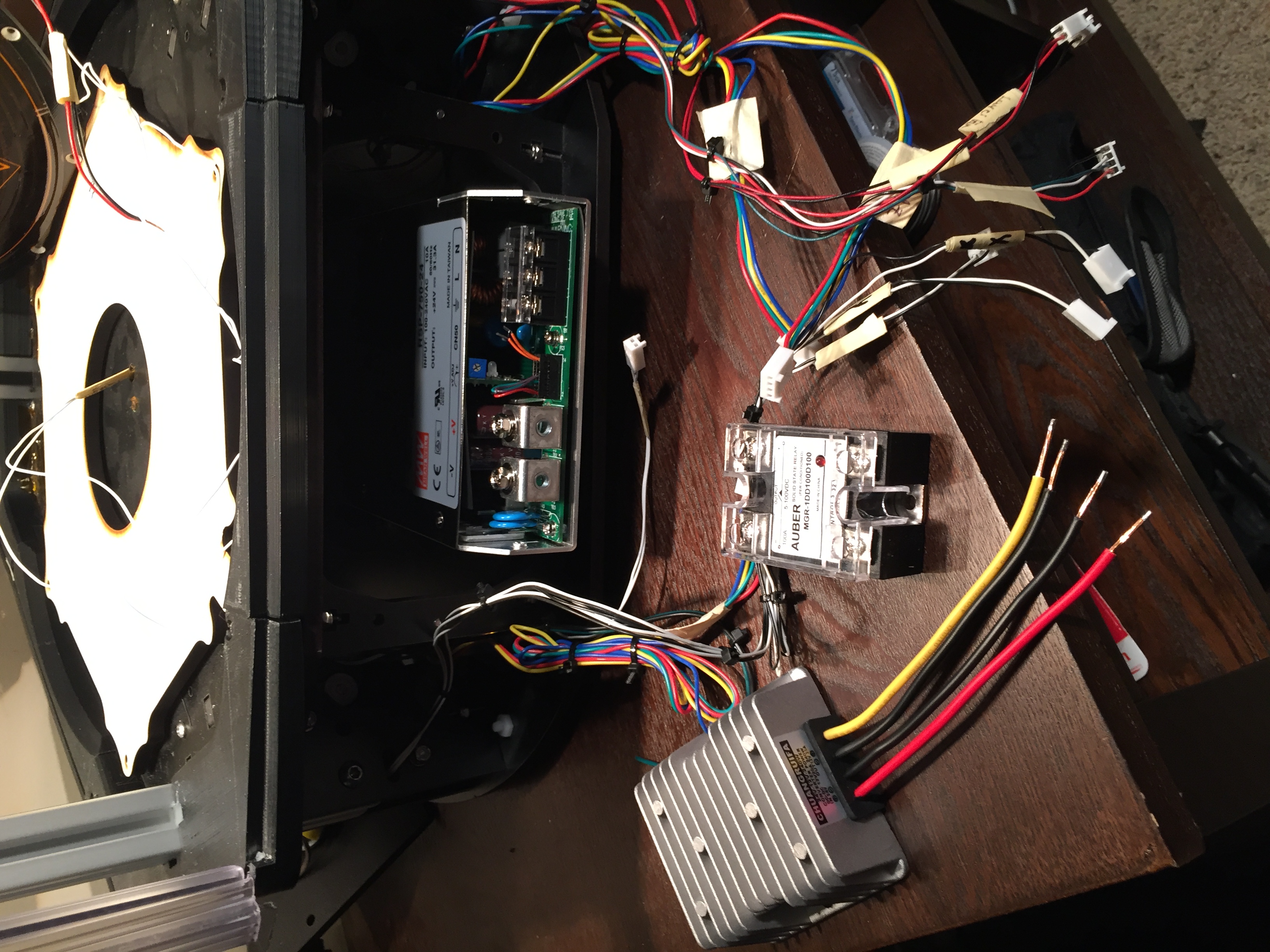

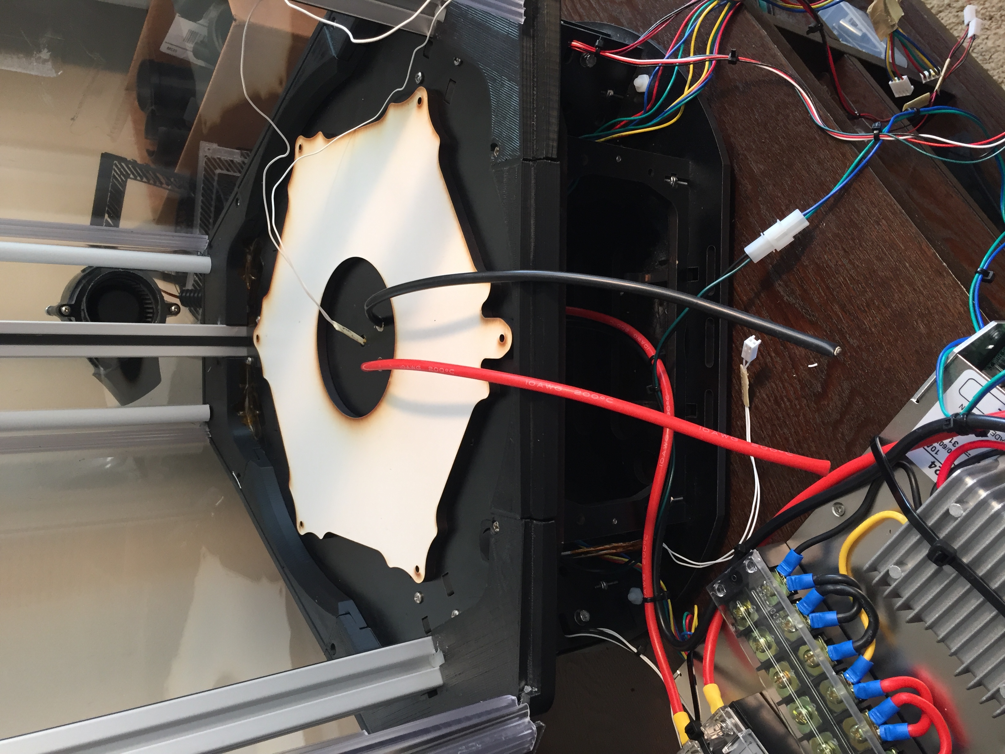

Upgrading to a 24V power supply.
Have everything including the RSP-750-24, Auber SSR and the 24V to 12v converter. Have changed out all of the connectors to the Molex .100 connectors. Was a bit of a pain, but not bad.
Next..... wire up the Power supply and fire it back up. That is the easy part.
The hard part for me will be updating and making sure the Duex, Duex4 and PanelDue are updated. Making sure that everything is set up in regard to the boards are my biggest concerns since that is not my fortee. Thankfully there have been a bunch of awesome post which I have read multiple times and I'm confident we can get it done. The optimistic realist in me says says minimal issues and a steep learning curve!!!
After all of this........ add my three geared steppers to run the Diamond head.

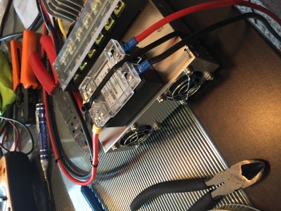

Finish wiring up the power supply.
After I get the printer up and running I'm going to print out a bracket to attach to the power supply. To this bracket I think I will attach the home made "electrical bus," the step down transformer, and the SSR. I think will design a hole in this bracket such that the SSR sits directly against the metal of the power supply. Then place thermal paste between the SSR and power supply to acts as a mild heat sink. I have found that SSR's can fail when there is poor heat transfer to the heat sink. Thermal paste off optimizes that heat transfer. Per others in the forum, this SSR does not create much heat, this should not be an issue with the power supply.

looks good; where did you find that covered terminal block?
Re: My "BAP"
Thanks,Windshadow wrote:looks good; where did you find that covered terminal block?
I found the terminal block on Amazon (https://www.amazon.com/gp/product/B00UV ... UTF8&psc=1). I've used these before in similar fashion and have always been happy with them. I also picked up most of the other items from Amazon including the transformer, wires [silicone flexible high temp 10 (http://www.amazon.com/gp/product/B017TG ... ge_o00_s00) and 12 AWG (http://www.amazon.com/gp/product/B015O7 ... ailpages00)]. Not sure this heavy wire is needed, but is not to expensive and easy to work with. Also picked up the Ferrule connectors as mhackney mentioned. I really like them and have used them before, but not much.
Of note all the wiring and connectors from the 12 volt system I removed and it looked awesome!!!

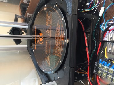

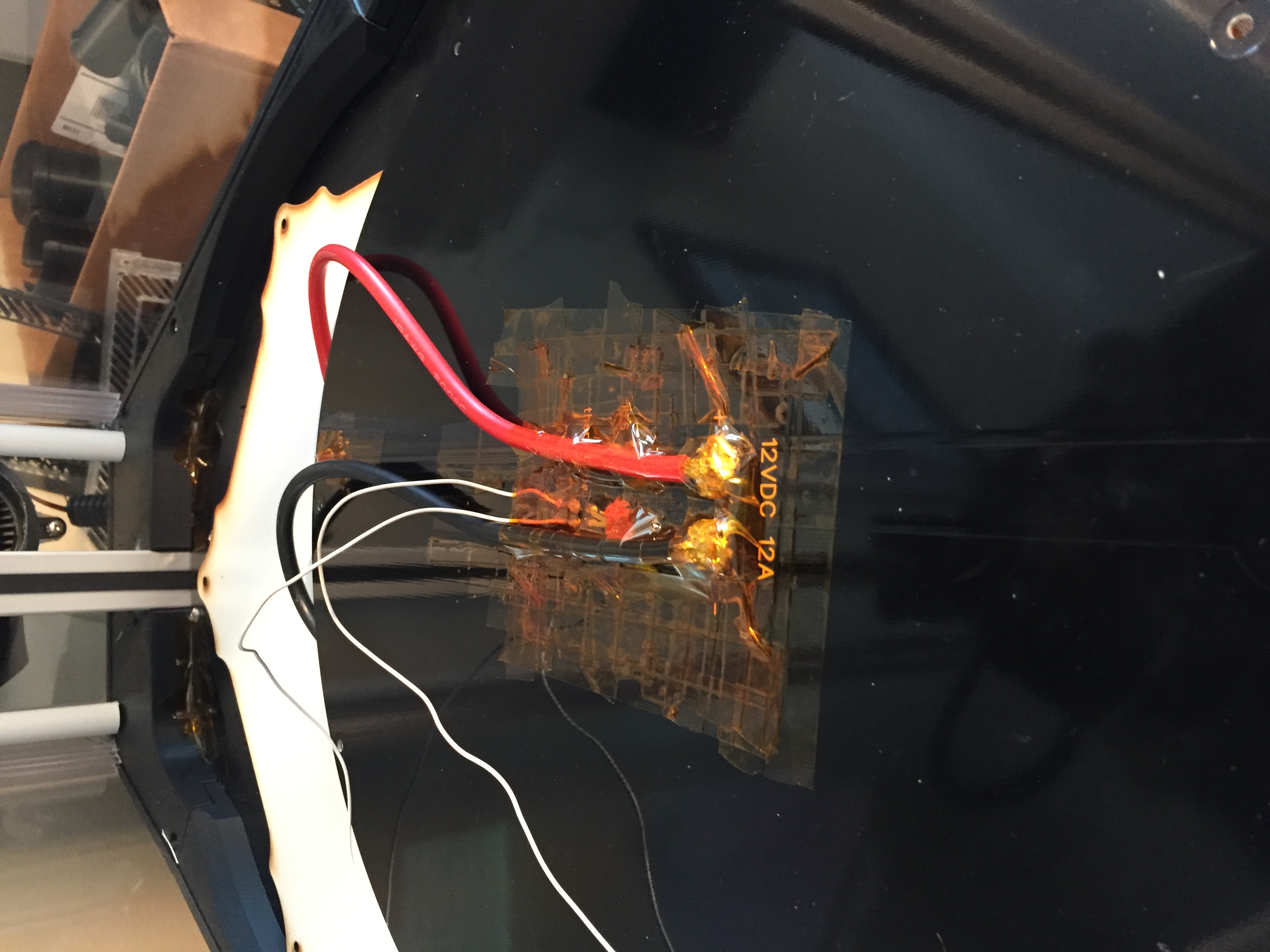

Soldered the Onyx to the 10 AWG. Reinstalled the Onyx and snug him down as per the build instructions. Turned on the power unit with the switch, then engaged the SSR for 3-4 seconds. It instantly warms up to the touch and the LED lights up.
Next install and connect the Duet and etc. Then calibrate!

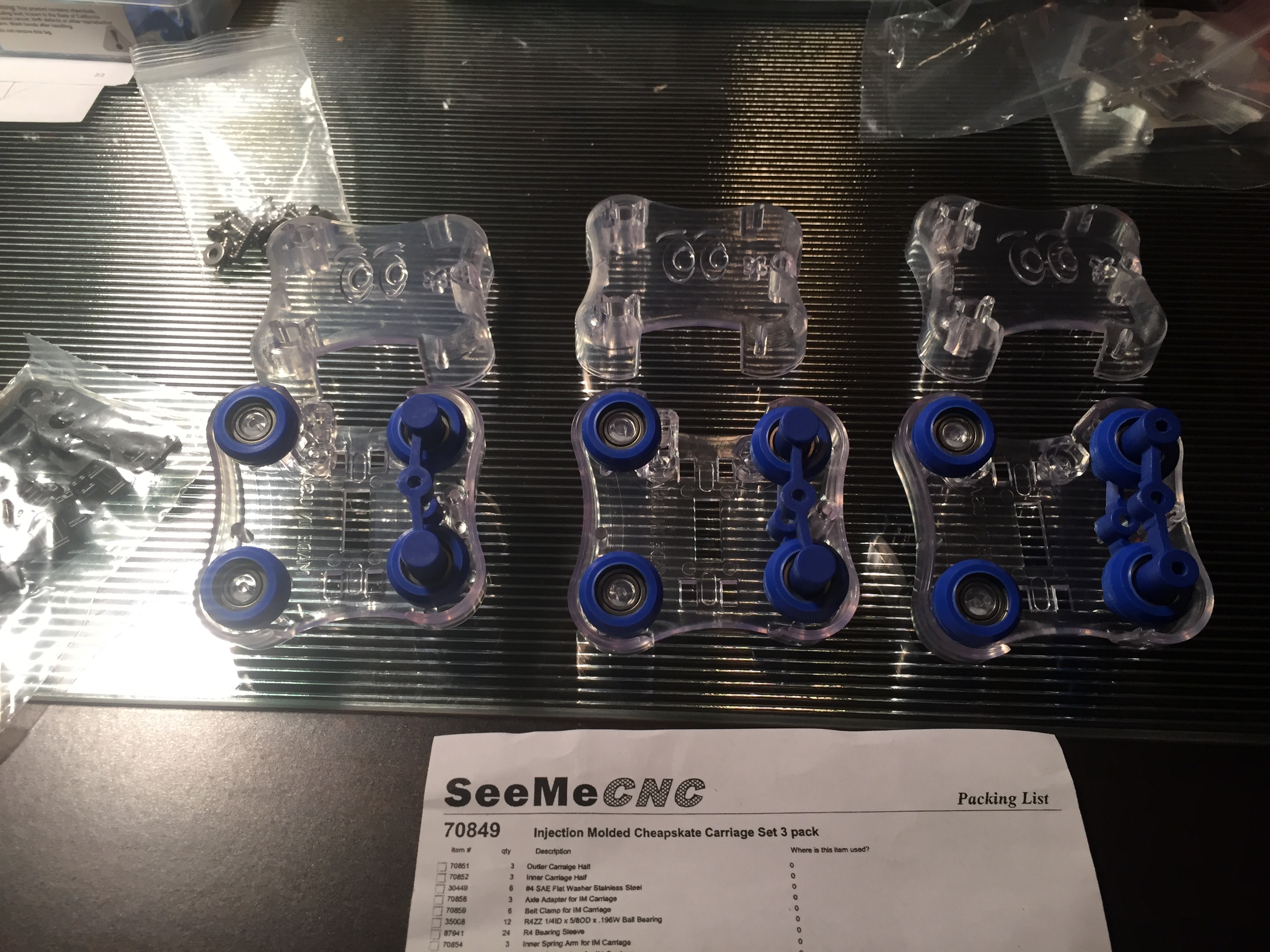

New Cheepskate Carriages. Easy to assemble!!

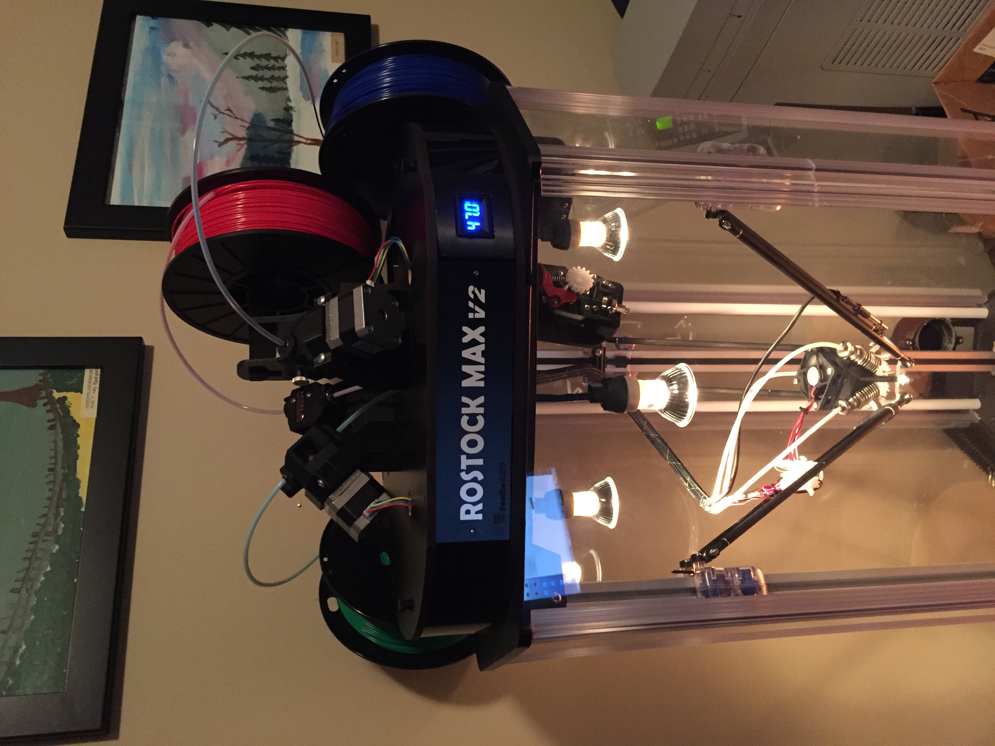

Up and running after installing a 24v power supply, SSR for the bed, Duet, Duex, trick laser platform, new SeeMeCNC carriages. Calibrated the bed manually at the three axis and center in concert with the horizontal radius (i.e. Delta radius). Prints awesome thus far!! Printing FSR pads and brackets now.
What I impressed with is the difference in how smooth the axis steppers sound. Clearly smoother in motion!!! Not as "choppy" with a much higher frequency of noise suggesting finer motion.

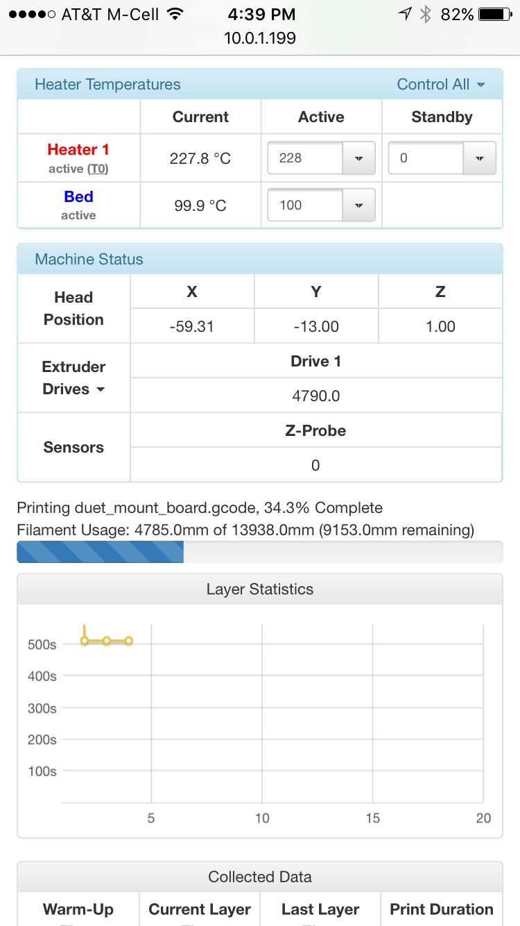

I have printed the FSR brackets for more than an hour now and my bed varies fro 99.9 to 100.1. The hot end varies from 227.9 to 228.1.3D-Print wrote:Setup the Duet board and got it up and running. Love the web interface.

Here are my final PrintBed and HotEnd settings.
M301 H0 P24 I0.80 D105 T0.50 S1.0 ; PID settings for Print Bed
M301 H1 P08 I0.20 D109 T0.50 S1.0 ; PID settings for extruder 0

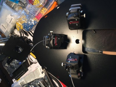

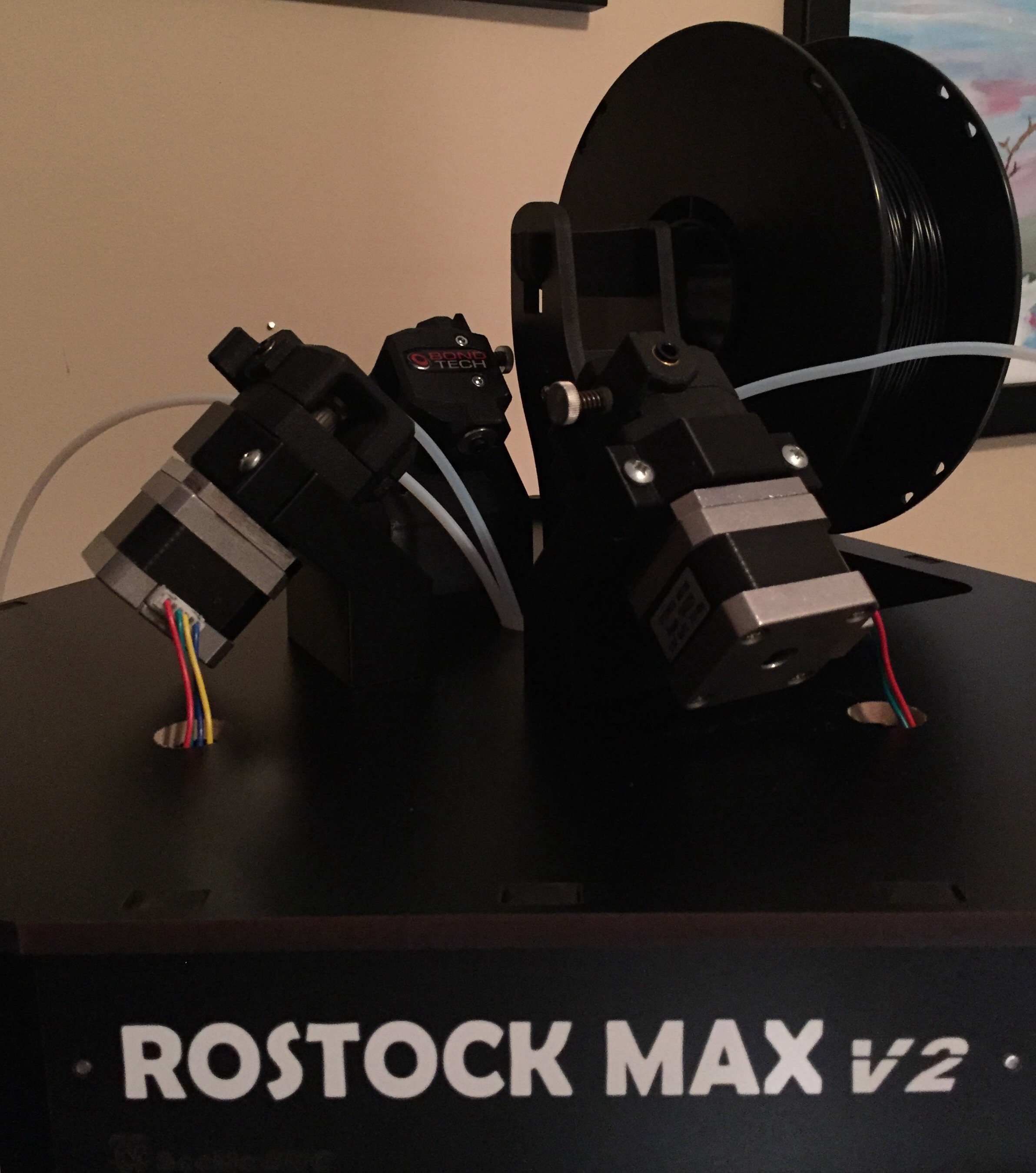

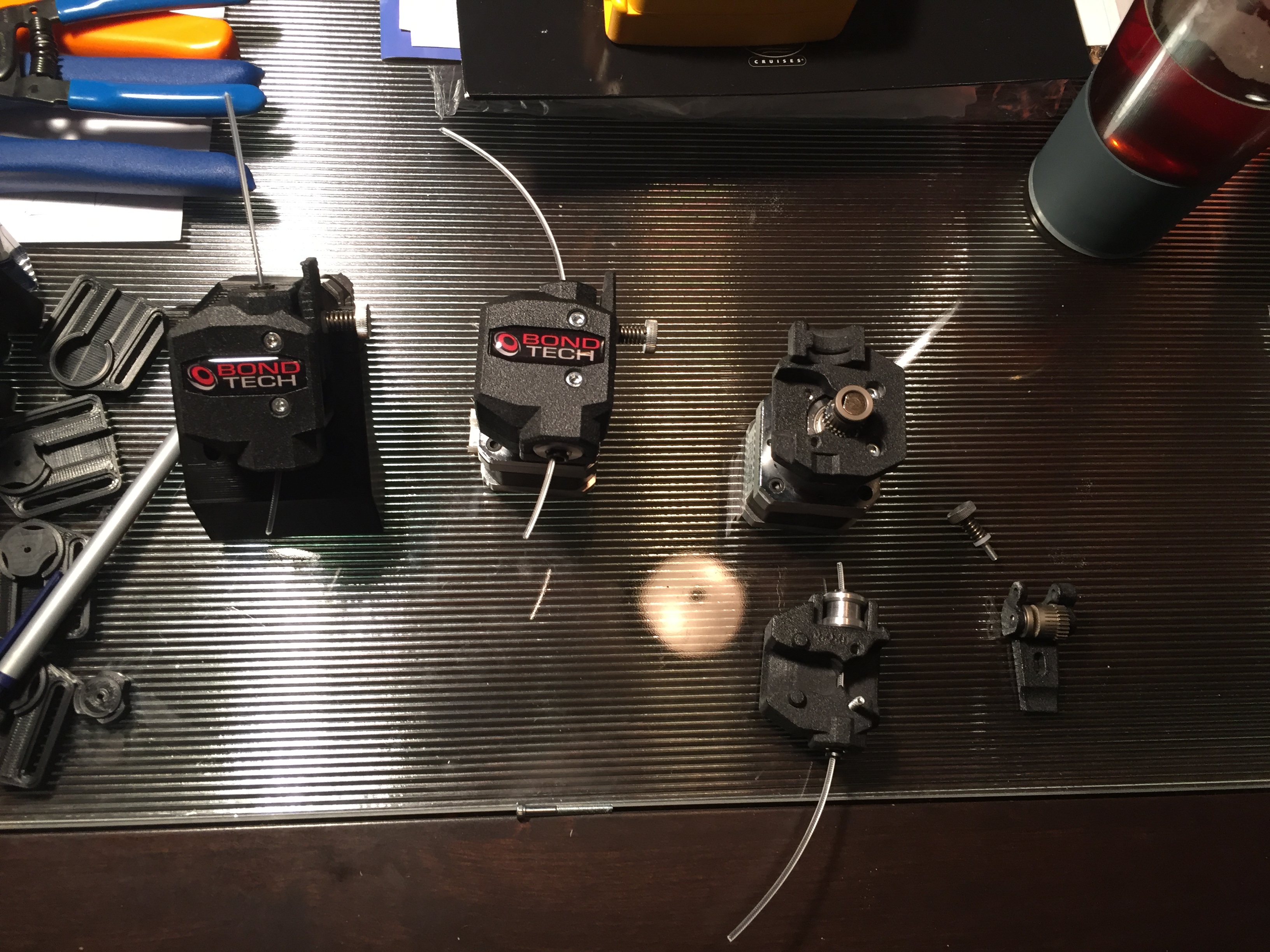

Bond Tech Extruders for the Diamond head assembled. Right now I'm printing out the other two mounting brackets.

Sitting on the deck and love the new Duet web interface. Easily monitor what the printer is doing from my iPhone.
IMBoring25
- Posts: 616
Re: My "BAP"
Or what the printer thinks it's doing...
Re: My "BAP"
Exactly! Need to add the video streaming to make sure!!IMBoring25 wrote:Or what the printer thinks it's doing...

Have the BondTech extruders to the top!

I have all the extruder steppers set up and have set up the config.g file for the multiple stepper such there is mixing as defined my the tools. Thus far everything works appropriately with extrusion from each stepper as expected. I do still need to calibrate the steppers for steps/mm.
Even though everything works, I have a question to David Crocker about my set up. Specifically regarding the Duex4 board,the terminal connections and their relationships to config.g commands. I want to make sure I'm accurate when I post all the details here on the forum.
Of interest.... when I did try to print the print did not start because "no tool was selected" despite this being in the last line of my config.g. When I turn on the printer my Tool 1 is activated, however when I start to print, it shuts off Tool 1 and I cannot turn it back on. The printer then gives me "no Tool selected" error. Need to read more about why this is happening. Any insight/suggestions?
Re: My "BAP"
I have learned that the Duet-Duex4 expects to have a "Tool 0 (T0)". If you don't define "T0" you will get the prior error.Of interest.... when I did try to print the print did not start because "no tool was selected" despite this being in the last line of my config.g. When I turn on the printer my Tool 1 is activated, however when I start to print, it shuts off Tool 1 and I cannot turn it back on. The printer then gives me "no Tool selected" error. Need to read more about why this is happening. Any insight/suggestions?
I had "commented" T0, the standard SeeMeCNC HotEnd settings. Once is set up a T0 it is printing fine!!!
