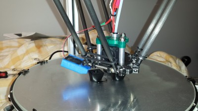

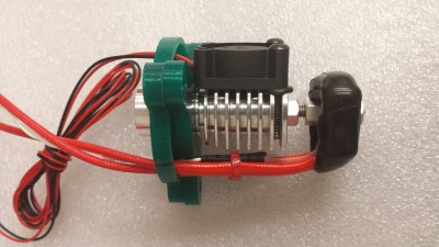

Just want to clarify a few things with the Prometheus v2 beta that I plan to install on the Rostock Max v2.
1. this is as good as any for the hot-end mount?
http://www.thingiverse.com/thing:298553
1b. which J plate for a stock setup? or is that a silly question. I planned to print all 3 options and see whats working.
2. i am removing the old hot end (brass). Should I add connectors for the wiring?
3. anyone have a pic or short video of their rigging of prometheus v2 on a rostock max v2?
Thanks for the help. I'm looking forward to the freedom to print all sorts of wonderful materials.

I used the same linked mount. A couple pictures are attached.
If you use the stock aluminum posts, you will need some spacers to clear the fan height. I used 2 #6 flat washers per post that were matched heights so I did not skew the hot end.

that looks great!
now i'm ready to switch hot ends. Thanks for the pics

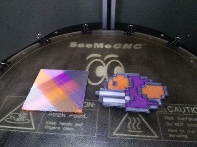

Obviously not printed with the Prometheus system, but the hotend is a Prometheus v2. I can't say enough good things about this hotend, it's been flawless from day one.
Don't mind the colors
Just testing the Flappy bird with the colors already loaded.
