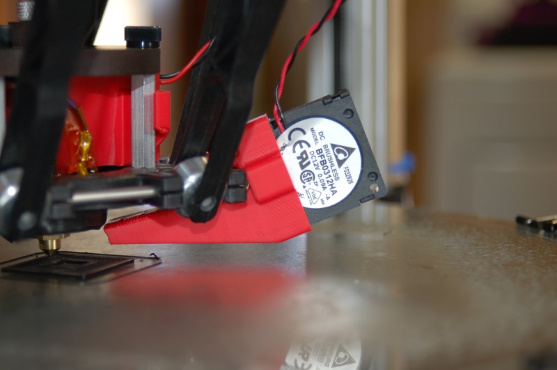

Recently one of the SeeMeCNC Assembly Minions (Andy) developed this: http://repables.com/r/171/ - it's a fan shroud designed to hold a 25mm squirrel cage fan. Here's what it looks like installed on Orange Menace:
[img]http://www.geneb.org/rostock-max/fan-shroud.jpg[/img]
They don't appear to have those fans in their online store yet, but email them at [email protected] and I'm sure they can point you where you need to go to buy one. This fan and shroud is now being shipped installed on the new Orion printers as a default option.
The awesome thing about this fan is that it doesn't have ANY effect on the hot end temperature at all, which is a problem I've found with other layer fan shrouds. If at all possible, print the fan shroud out of ABS. You won't use it while printing with ABS, but it needs to be able to withstand ABS-like temperatures when you're printing with ABS instead of PLA.
Adding a LED ring will be problematic if you use Andy's fan shroud because it'll block access to the bottom of the effector platform, but I think that the fan shroud brings enough to the table that you'd be better off choosing a different lighting method. I've removed the LED ring from the printers I'm using his duct with.
As to lighting wiring, you can get yourself an SPST micro switch (the same one used for the power switch) and wire that directly to the power supply, either 12 or 5 volt lines depending on what the lights require. You'll want to connect the ground wire directly to the lamps/LEDs and connect the hot wire to the switch.

Gene, you showed this a bit ago:
geneb wrote: ...
I have the fan and printed this shroud. Did you have to drill a hole in your effector for it or did you attach it some other way?
thanks,
Michael
Re: [NEW! 18Dec13] Rostock MAX Assembly Manual
I learned something new! I took my effector off in preparation to drill a hole to mount the fan & shroud and discovered that there are holes in the corners! Mine had molding flash covering most of them up so I couldn't see them with it installed. Now I have a shiny new fan and shroud!
\o/
The fan duct is EXCELLENT for printing PLA. I can run that sucker at 100% for the whole print job and the hot end temp never dips.
