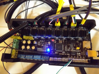

This is the azteeg x3 pro wired with 8 steppers. They're all drawing 2.25 amps. I need to get a fan on this thing! And an enclosure.
On the first or second page of this thread I talked briefly about a repeatable limit switch for this machine. My current prototype version is shown below. I ran a few repeatability tests with a dial indicator to see how consistently it homes on the X axis (turret).
I did 20 homing cycles in a row and checked the position of the dial each time; the needle was consistently within 0.0002". Pretty good for a 2 dollar homemade limit switch made of stuff from the local hardware store and with one 3d printed piece! I can't reliably indicate any more accurate than 0.0002" so I'll have to get an expensive indicator if I want to determine the exact repeatability value. It's still much better than the clicky limit switches common on 3d printers.

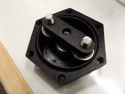

And here is my test of a harmonic gear. Since I can't get the surface finish good enough for an elliptical shaped plug and ball race, I have to use bearings as rollers on the ID of the flex spline. The flex spline is actually a small assembly with 4 bearings in it to keep stuff stable. I'll work on a self contained unit capable of a lot of torque and zero backlash.
The hypocyloid gear type you suggest I make looks like it works the same in fit and function as a strain wave gear, but cheaper to machine on a mill or live tooled cnc lathe. A reduction ratio of 30 or more with zero backlash, high maximum torque, good efficiency, and no backdrive-ability is what I need on this machine. Plus it has to be compact and not too expensive.
So for rotary axes my choices are down to;
Dual Worm
Roller Strain Wave
Hypocyloid

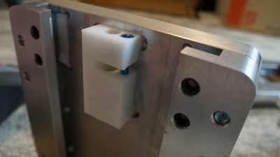

Captain Starfish wrote:What he said. More photos and videos of the beast in operation please, but what you've shown us so far is a thing of beauty.
How are the plastic guides holding out so far, considering smooth motion in the 'allowed' degree of freedom vs stiffness in the others?
Rather than the strain wave harmonic drive style, also worth looking at hypocycloidal eccentric gears. Nice smooth curves = relatively easy to machine the rotor and the ring can be done with some steel rod stubs. Considering putting one together to rebuild my el cheapo chinese 4th axis which is currently belt driven off a NEMA23 stepper and which I can backdrive by hand - even if it's only a bit of 8mm rod in the chuck.

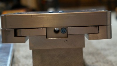

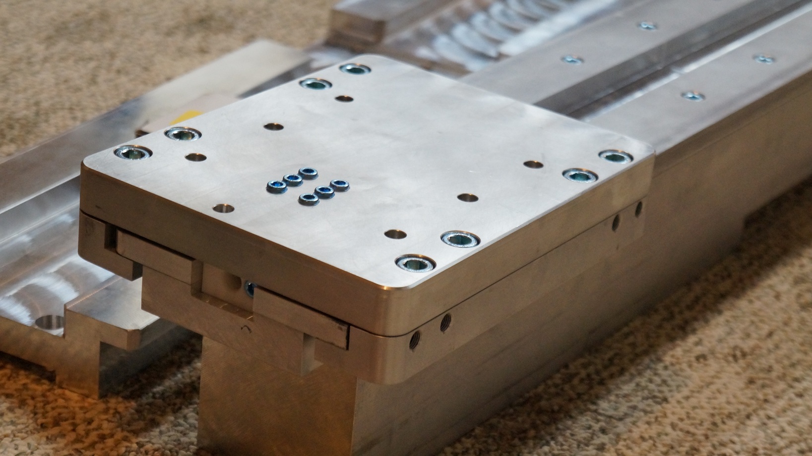

1) "How are the plastic guides holding out so far, considering smooth motion in the 'allowed' degree of freedom vs stiffness in the others?"
The acetal pads aren't showing any signs of wear. The un-anodized aluminum boxways are slightly burnished where the acetal pads contact them. It's not a loss of dimensional tolerances really, more like the crests of the trochoidal tool marks are getting lapped into a mirror-like finish. The wear rate of the system is much lower than any metal on metal system. It's also quite rigid at the contact surfaces, the main cause of displacement is the thin (6mm) aluminum locking gibs on the bottom, and the small contact area of the set screws on the sides.
I improved the side-load rigidity by putting steel shims in the gap between the side plates and the acetal wear pads, so the steel shims distribute the set screw force over a larger area.

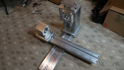

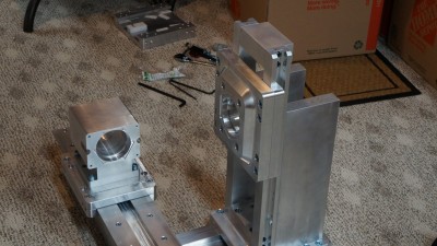

Bit of an update here....
I started out with the concept for this thing in Fall 2015, was building it by February 2016, and I had the first prototype working and making 5 axis parts by July 2016.
Now it's August 2017. I started building a version 2 prototype (V2) at the beginning of July 2017, based off of the design I had mostly completed by spring of this year. Now I'm approximately 50% of the way done with the version 2 prototype.
That's the back story. I also withheld some......strategic........information, specifically that I have been planning on doing a crowdfunding campaign since the very beginning. And also that this machine has additive capabilities. It killed me to have to withhold this from you guys, especially since I have had a video of it working with a hybrid additive/subtractive part since mid 2016. It's one of the reasons why none of my photos on this forum show the entire machine, even though it's right next to the camera!
V2 is similar in function and form to V1, but improved in every way. It's much larger and heavier. While V1 can cut plastics and metals with small tools (under 3/8"), it lacks rigidity and power. Plus I had to make it on a minimal budget, which forced me to go as cheap as possible on the machine and make design compromises. As a result it is difficult to align to the tolerances I want. V2 avoids this alignment entirely, and is significantly more rigid and powerful. I've attached a few photos, I'll be resuming this build log.
I realize that this forum thread may seem unrelated to 3d printing at this point. I still have my rostock max v1 behind me right now, and I'm using it to make certain non-rigid parts of this machine. The V2 machine will have 3d printing capabilities as well. I'm aiming for a Kickstarter late this year, my main problem right now is that I've spent $1,000 on this prototype so far and I need about $2,000 more to finish it, so I can't really make any progress until I get funding. I still have a bunch of pictures from the build so far, I'll be posting on this thread a bit over the next few weeks. Ask away!

Yup, the plastic slider boxways are great. If I were going to build a machine with very long travels, I would consider rolling elements for efficiency. But boxways are a lot more rigid, and are pretty much immune to contamination. Since most parts can be done with only a few inches of X and Z travel, it makes sense to stick with boxways.
Work envelopes:
6 inch chucks----> 7" dia x 10" length
ER40 Collets-----> 1.1875" dia x 12" length
16C Collets------> 1.625" dia x 12" length
5Ax Fixture------> 6" square x 10" length
3Ax Bed----------> 12" long x 6" deep x 6" tall
Each of of the things listed above is a different way of holding work. The machine is optimized for mill-turn work, but can do horizontal 5 axis work as well as basic 3 axis stuff as well. It won't have the same large Y overhang as most 3 axis mills, so plate/sheet work will be limited in size.
Turning spindles: ~10 ft*lbs torque, 4 horsepower, 2500 RPM for chucks, 4000 RPM for collets
Milling spindle: 5 ft*lbs torque, 4 horsepower, 10000 RPM, peak power at 5000rpm. Max tool size 3/4" shank (ER32)
Live tools: 3 ft*lbs torque, 3 horsepower, 6000 RPM. Max tool size 1/2" shank (ER20)
The turning spindles will definitely have an indexing mechanism, I have both a harmonic drive and a worm drive tested and working right now. All motors (except steppers) will have a 2048 count pulse encoder, which will allow closed loop control and rigid tapping on all spindles.
Machine axis movement speeds will be dependent on stepper or servo. Steppers won't slide an axis more than about 120 IPM. Servos might get it up to 600 or so, which is more than enough.
There are now 3 serious contenders for low-cost servos. VESC, O-Drive, and ClearPath. The first two will need firmware mods to work with any CNC controller. I'll be using the Smoothie v2 pro when it comes out, which allows an indefinite number of stepper/servo drivers to be connected. Plan is to offer the machine as a modular kit, so people can buy sub-assemblies and put it together in 30 minutes or less for the mechanical stuff.

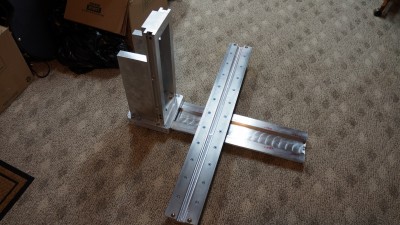

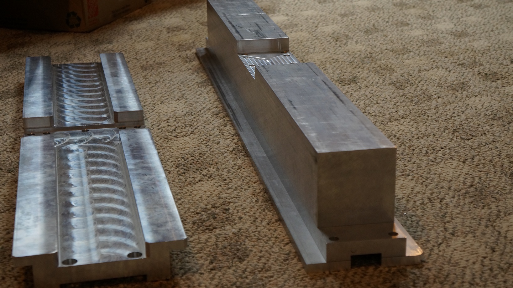

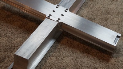

Some close ups of the boxway system; Note that the boxway locks are not tightened in the second photo, which is why they are at a slight angle.

No updates for the last month because I ran out of money; I just got funded by a very generous person a few days ago.
Back to making parts now, I just bought the metal for the vertical milling column (y axis) and the headstock block. So hopefully I'll have time to machine those over the next week or two.
Besides seeking funding, I redesigned quite a bit of the machine over the last month. The headstock(s) now have a pulley box on the back that is almost fully enclosed to keep chips and coolant out. It still has an opening for the spindle bore to allow long pieces of bar stock to pass through. I want to keep it easy to modify because I'm planning on adding a drawtube mechanism that will allow the machine to run automated, pulling the bar through after each part and clamping on the bar with the collet. Bore size is 1.89", which lets it use 16c collets for a through-bore capability of just over 1.5 inches. The 6 inch chuck can do 1.75" through bore. Spindle bearings have been sized up to 65mm to allow for a thicker spindle tube, this should increase rigidity as well.
The back side of the headstock will have a 1:1 chevron belt pulley; the pulley shaft that connects to the motor will have an absolute rotary encoder on it, looks like 4096 resolution and an index pulse. The pulley box also housed a worm gear system that can be engaged to give the machine a more rigid 4th axis. I still have to work out the pivot mechanism for the worm gear so it engages the big gear when an air cylinder is actuated. This is a very compact setup, it would be a lot easier for me if they made tapered roller bearings down to 1/2 inch bore.
Also I should mention the driving force for each linear axis. I'm still using 1/2 inch leadscrews with a fast travel pitch in acetal nuts. The nuts are 3 inches long, and they're held in place by a light press fit to take forward and reverse forces as well as 7 M6 screws. They're adjustable for backlash by turning a SHCS from the back, which compresses the nut around its flexible bottleneck joint a tiny bit. The acme threads are tapped with the same leadscrew that they run on, which means backlash is near-zero without compensation. The adjustment screw is there for long term use, I'm guessing the threads will wear a few thousandths after months or years of use. I'll be testing this quite a bit.....For now I only know that the backlash is well under 0.001".

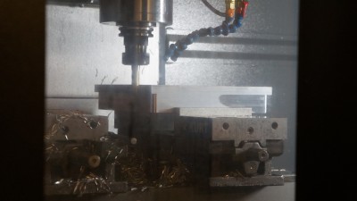

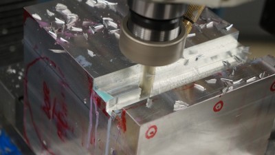

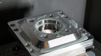

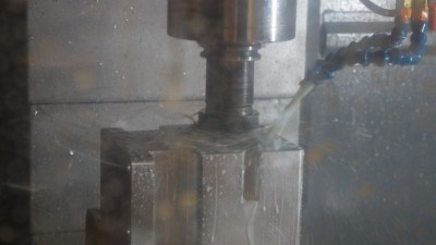

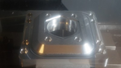

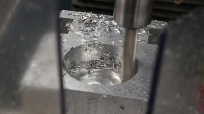

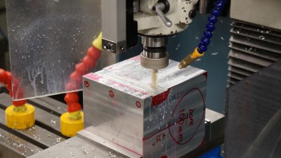

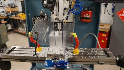

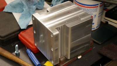

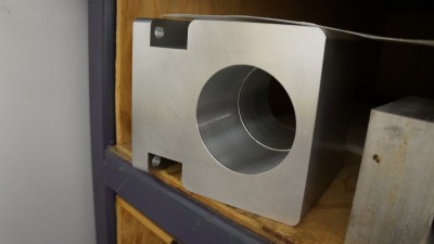

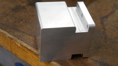

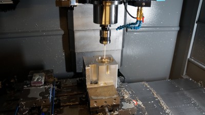

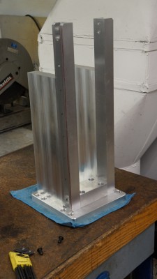

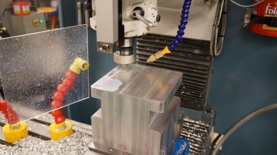

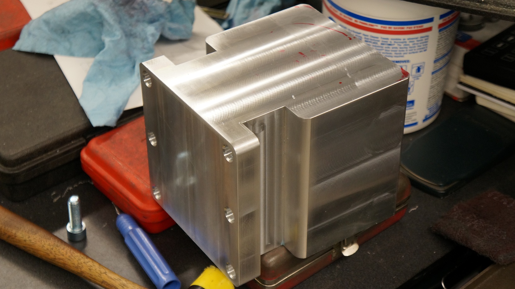

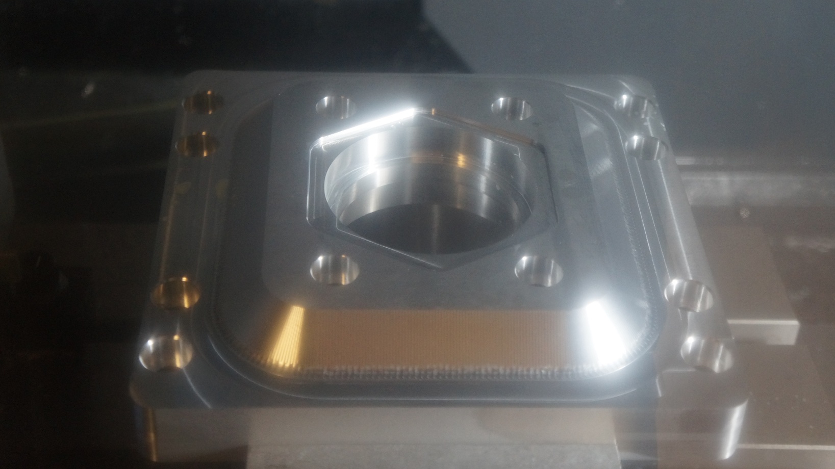

I made progress on the main headstock block today. I still have to rough out the center hole, line bore it, and make 100mm bearing pockets on both sides of the block. The block is 6x6x7", and I'm trying to keep the bearing pockets round, square, concentric within a few ten-thousandths of an inch over the six inch distance. I'll show the method as soon as I get it done. Japanese NSK bearings are on the way.
Here are some pictures I took while machining the block today;
https://endless-sphere.com/forums/viewt ... 30&t=76363
Looks like for now I'll be going with 130kv 63mm outrunners, since that's the only thing available. It doesn't make sense to spend twice as much on a larger motor when my wall outlet can only do ~1500 watts.

Double post because nobody responded. This headstock is a pain to make without the right machines and tools. I had to do two interpolating operations to get a rough through hole. Then I had to move it to another machine to bore the through hole to act as a reference surface so that the back side bearing pocket can use the bored through hole as a reference surface.
Of course the probe stem was just a tiny bit too big; this means I'll have to wait a while for a special coaxial indicator so I can align the back bore. All of this effort to get some very accurately aligned bearing pockets.
I wish this could be built like 3d printers, where you don't have to worry about precision to get a working machine.

No lathe fun times for the bore on these? Or at least a boring head to keep things coaxial?
I guess if the plan is to flog kits ie make a few of them it's not just a case of knocking one out but of also working out how to most efficiently get good results.
I'm liking the photos. You look like you have a decent setup!

There was no boring head to use for a 3.94" bore. The tool used in the last post to plunge the through hole was just a fly cutter in a big ER40 tool holder. The purpose of probing with the VMC was to align the front bearing pocket to the through hole; the part will be flipped and aligned again for the back pocket. This is the only good way to do it without very specialized tools.

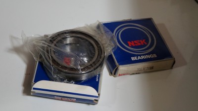

I got the main spindle bearings in yesterday; they're P5 grade angular contacts with a 15 degree contact angle. 65mm inner diameter is as big as I could get in this 6 inch headstock housing. The spindle will have a 6" chuck with a 1.77" through hole, so the machine can turn nice big bar stock without having to cut stuff off before chucking. Plus it can fit a 16c collet. Having the biggest bore possible makes the machine a lot better to use.
And today I got most of the milling column done. It rides on a 10x10 boxway, and the column itself is 8x8 for real rigidity. Most of the hobbyist machines use columns of 3x3 or 4x4 thin walled tube, some use smaller. Having a large column will contribute to the stiffness of this machine. You can't really see in that picture, but the tall bars on the front are the boxways. The top will be braced, and everything will be bolted together and aligned.
I think I'll do this a little bit differently in production; I'll eliminate a few components and try to machine the boxway surfaces directly into the column supports. That way there will be no alignment needed, assembly will be easier, and the mechanical accuracy and rigidity of the system will be improved.

Almost finished the BY block; this is the part that slides up and down vertically on the Y axis while holding the B axis shaft and the milling head. See the render a few posts back if it's confusing. This part just needs a few M4 drilled and tapped holes to put a bearing cover on in the hexagon.
I assembled the milling column and put it on its boxway, then adjusted the preload gibs to check binding moments. I was able to slide the entire milling column on the boxway by pushing at any point on the vertical Y rail, which means the machine won't bind at a ratio of 2.5 or less with the cheap acetal pads I'm using right now. Plan is to make the production version with a better (and more expensive) type of sheet polymer, but since they will be laser cut from sheets, the overall cost will be justified by ease of manufacture. My cheap pads right now have a coefficient of friction of around 0.25 I think. The better ones will be around 0.1. Good news is that my boxway system seems to be incredibly rigid, and there is no perceivable looseness or slop from any direction.
Anyone have questions?
