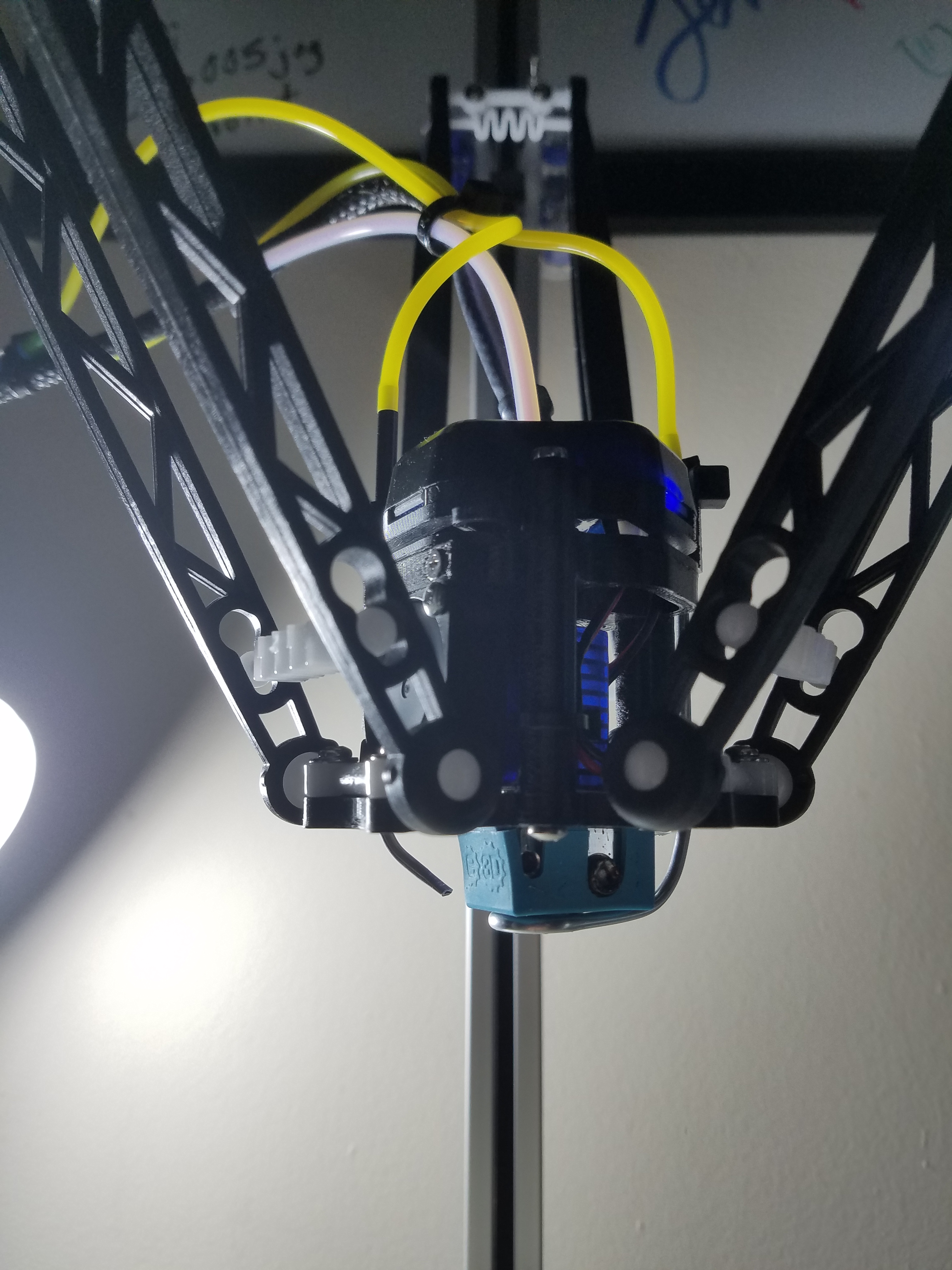

Some Have asked about the cooling pipe fitting the E3D silicon sock,
[img]http://www.themakerhive.com/FTP/jassper ... r/sock.jpg[/img]
YES!

Qdeathstar
Posts: 622
Re: BerdAir comeing soon From Yellow Jacket Concepts
Post by Qdeathstar »
Maybe. getting the bend as perfect as it needs to work. Doubtful.
i see someone managed to get r done.
http://forum.seemecnc.com/download/file ... &mode=view
Posts: 5358
I wonder if putting a spring around that tube would help the bending process. Now that I see how it would fit on a sock-equipped hot end, I suspect Red Sonja (my E3D/Duet machine) needs one of these. :)
Yes, the spring is the way to go. I got a set of springs for tube bending from MicroMark and they work great.
bvandiepenbos
Posts: 923
Location: Goshen, IN
Post by bvandiepenbos »
You can also slip a piece of wire inside tube to help it bend nicer without flattening or kinking as shown in this video...
https://youtu.be/oJPRmSepvBI?t=38s
Or use ABS filament that way you can dissolve it out with acetone if it gets stuck.

bvandiepenbos wrote:You can also slip a piece of wire inside tube to help it bend nicer without flattening or kinking as shown in this video...
I used the wire trick and it works well. Agree with using the ABS. Great idea.
