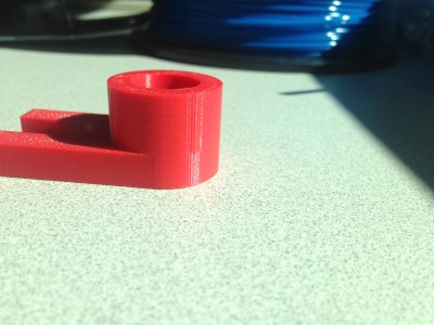

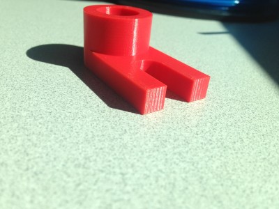

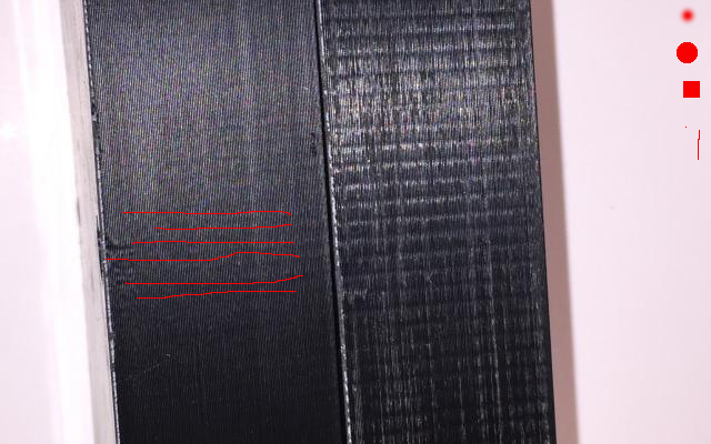

I have two printers, a rostock max v2 and a flashforge creator pro and i get NO banding on the FF at all.
[img]http://i1132.photobucket.com/albums/m562/dunginhawk/C2257739-DF37-43AD-B2B7-5F73471762E2_zpsjbe4dbbq.jpg[/img]

It looks to me like there is banding, just not very pronounced.
Can you print an edge that is like 3 degrees off the X or Y axis?

Yeah i didnt mean to say no banding, but 95% less than my rostock, and im completely willing to accept I may need to tune my printer even more to get it better. but circular prints are great, with little to no banding.
this picture really amplifies it too, so the tiniest bit of banding shows up on the left print, where the right looks worse than it is, although its pretty bad.

I can see them a little bit in the photo. The plastic just has a different sheen to it.
Interestingly, FlashForge's website shows the same kind of ridges in their promo photos for the dreamer model:

so yeah it is definatly more pronounced on the rounded parts.. im seeing the same thing... the first thing i printed was this coiled up thing with lots of angles, and its pretty pronounced there, but not on the flatter spots.
thats what leaves me to believe that its much more to with cartesian vs delta than anything else.
I own one of both and each behave exactly different.
Cartesian - good at straight lines and OK at circles
Delta - good at circles and OK at straight lines.
seems to play to each strength of their design.

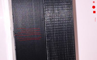

Exact same print setting except I took off the Astrosyn dampers. I'll be honest in saying, I'll never put them back on.
Still have the banding, but the print quality is much improved from the original.
[img]http://i482.photobucket.com/albums/rr189/Onuxis/20150218_202421.jpg[/img]

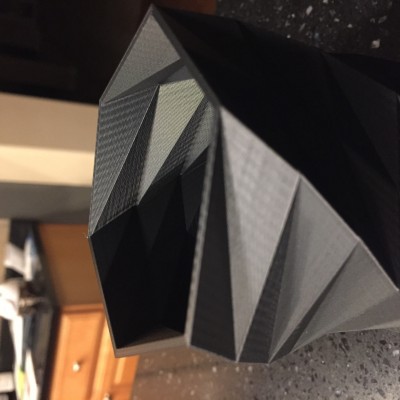

What speeds are you printing. My settings are: Infill 40 mm/s, inside perimeters 40 mm/s, outside perimeters 30 mm/s, and non print moves 300 mm/s.
I only notice this with black and on the vase image attached. I slowed my printing down after my first few prints and have never picked up the speed since that time. It makes since and if so the band would be closer together at the center of the bed than at a the edge with the idea that when the delta arms are at 45 degrees the movement with each step would be less than when they are at 30 degrees and most prominent when the print line is parallel to the delta arm in reference. Humm thinking twice about that one.
In the end you are thinking this is due to stepper degrees?

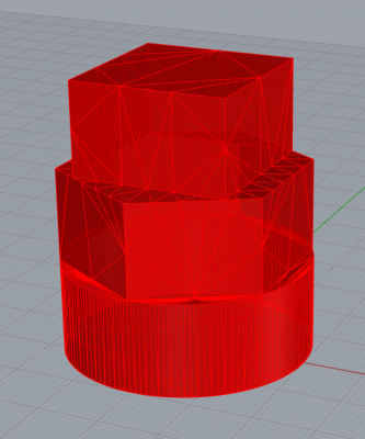

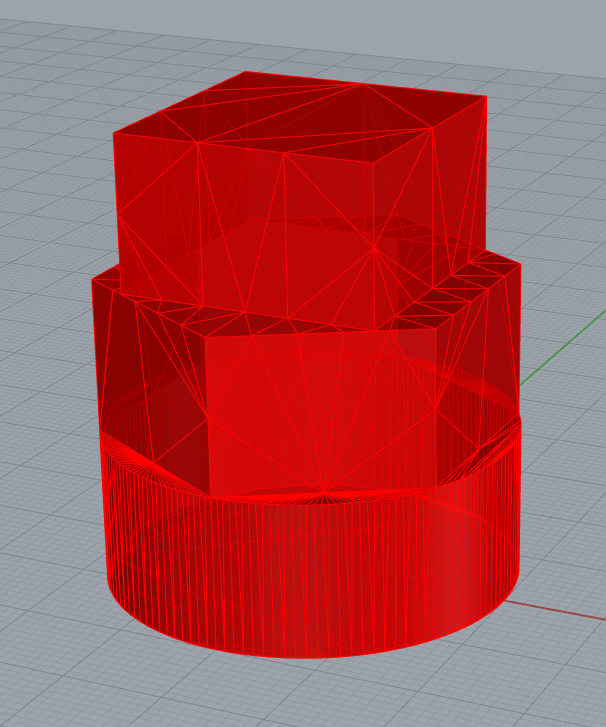

Ok, in an effort to help us compare apples to apples as easily as possible I put together this model - BandAid:
It is a 15mm tall 40mm diameter cylinder with a 15mm tall hexagon extrusion on top and a 15mm tall square extrusion on top of that. Designed to be relatively quick to print but collect a lot of data. You get a curved surface, surfaces not aligned with X or Y and surface in the X-Y plane all in one model. I made the mesh in Rhino and used the highest mesh density it outputs (density=1) to eliminate as many mesh artifacts as possible.
I'm slicing in KISS for my .4mm nozzle Kraken hot end: .4mm extrusion width, .2mm layer height, 25% straight infill, 2 loops/perimeters. .4mm skin thickness (2 layers) at 32.5mm/s perimeters, 42.5mm/s loops, 35mm/s solid and 45mm/s sparse for speeds. If we could each print one of these trying to duplicate these settings it will help comparison. Black filament probably preferred.
