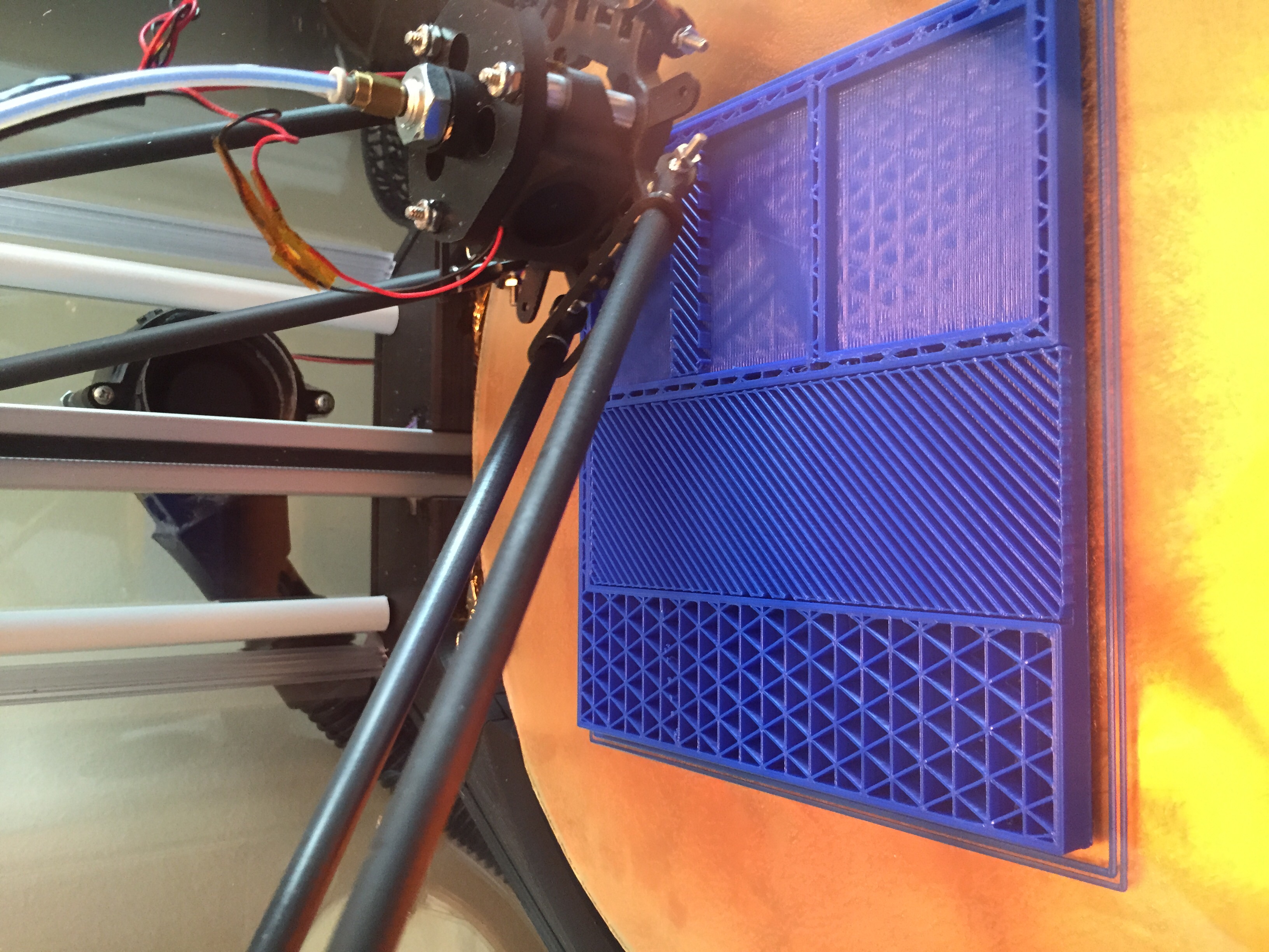

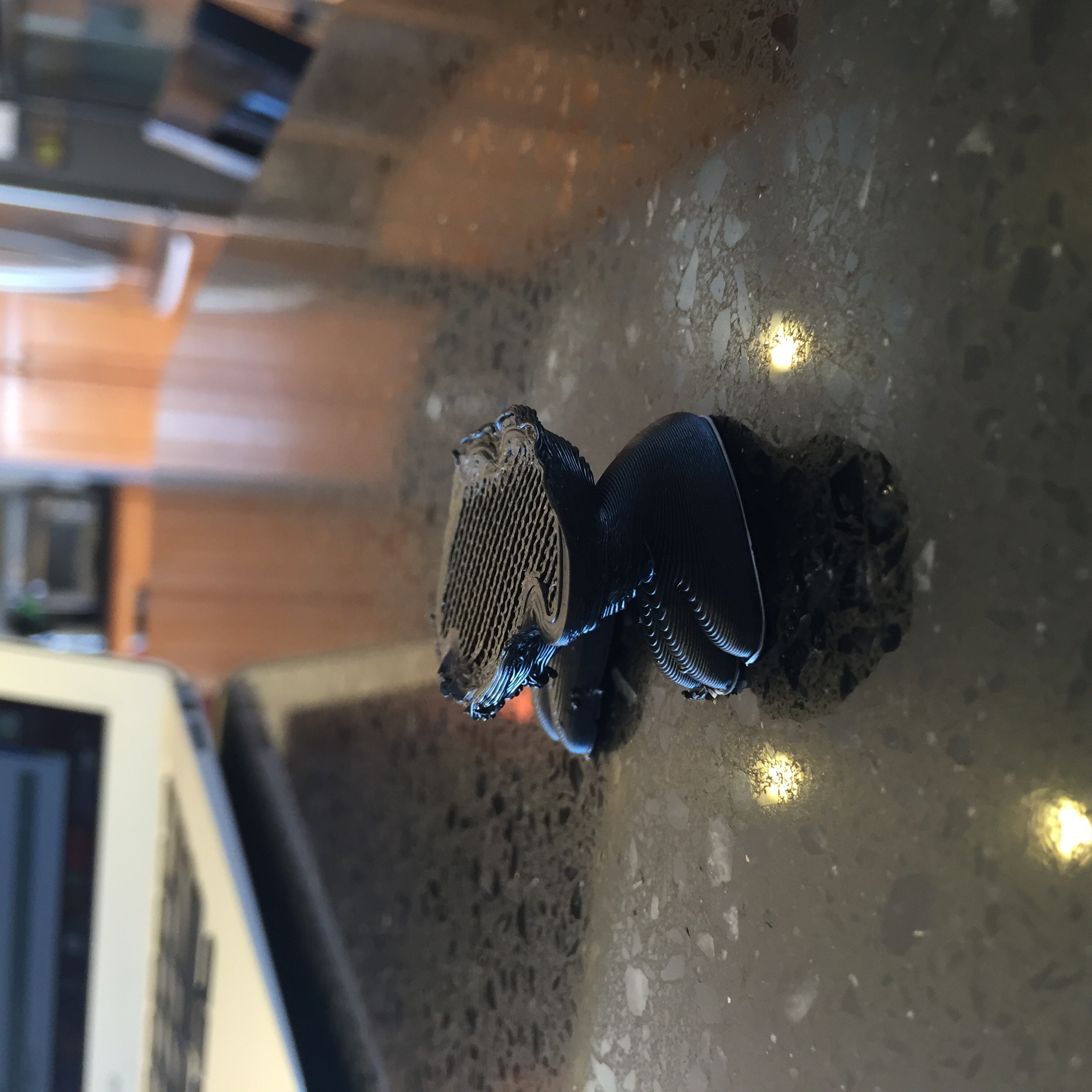

JFettig wrote:What brand ABS are you printing? I have had some really nasty black ABS that comes out looking like that(or worse). Higher temps help layer adhesion, might bring other problems with it though.
What are your speeds?
This is ABS from SeeMeCNC.
HotEnd was 235
Bed 100
Infill 40 mm/s
Inside Perimeters 40
Outside perimeters 30

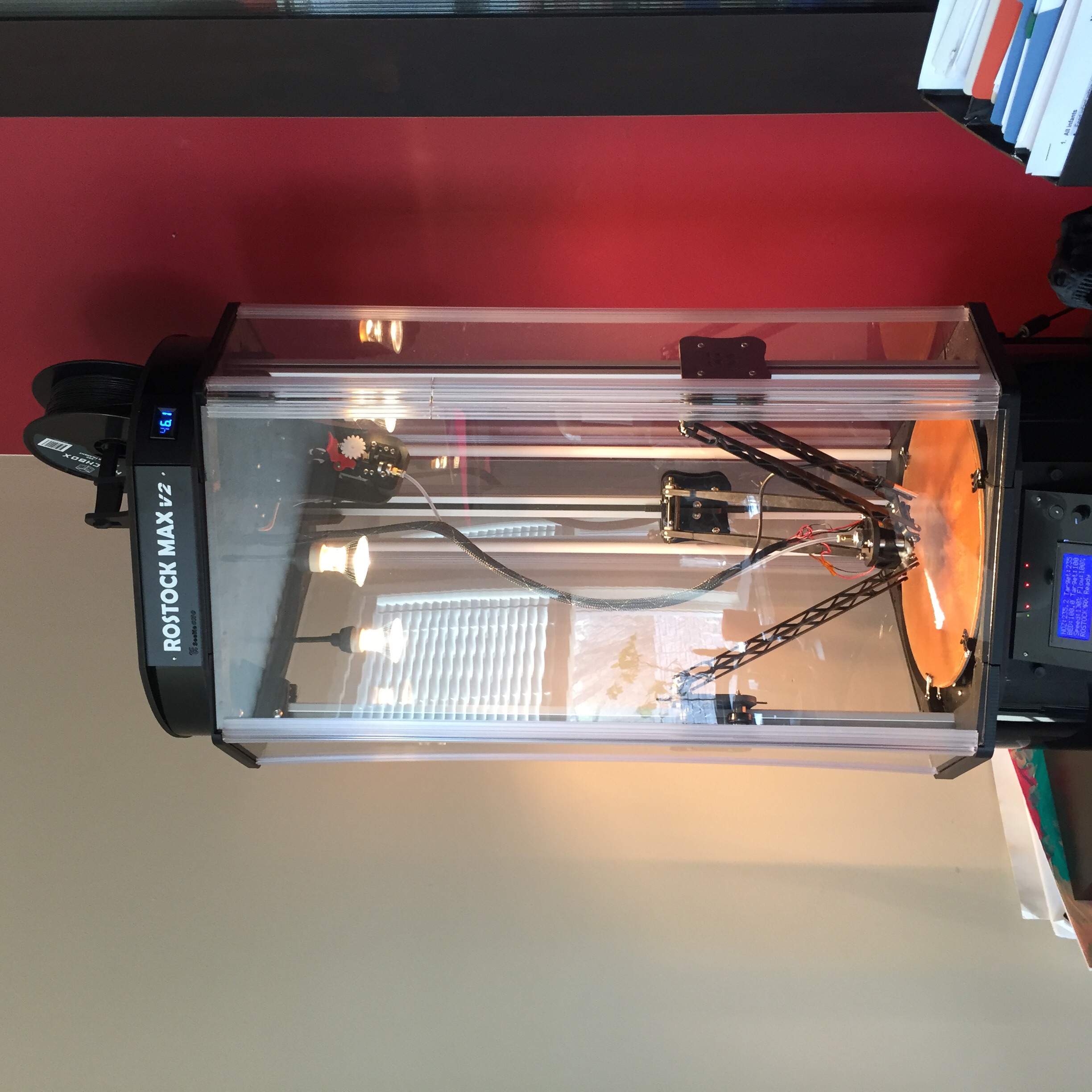

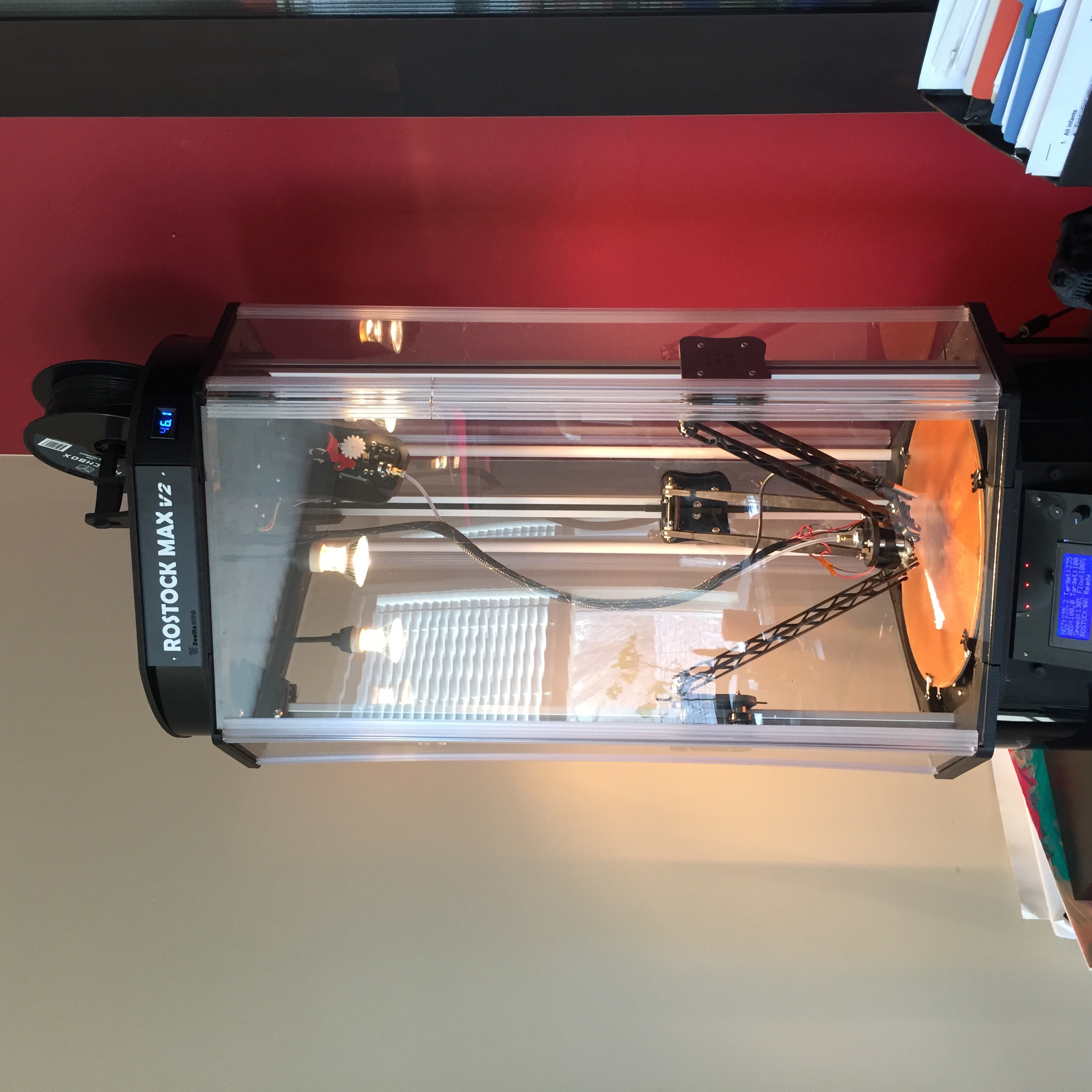

As noted earlier, I added the Halogen bulbs to the enclosure last weekend.
Today, I noted that with the enclosure and the three Halogen bulbs at 100%, the small print shown was not hard and flexing. I noticed with each layer the curled edges were flexing with each subsequent layer, thus it was not hardening by the time the next layer was placed.
When I opened the door this hardened immediately. The chamber was about 55 degrees C which I measured at the edge of the enclosure. Makes me think that the temperature at the center of the bed and at the print end is much hotter.

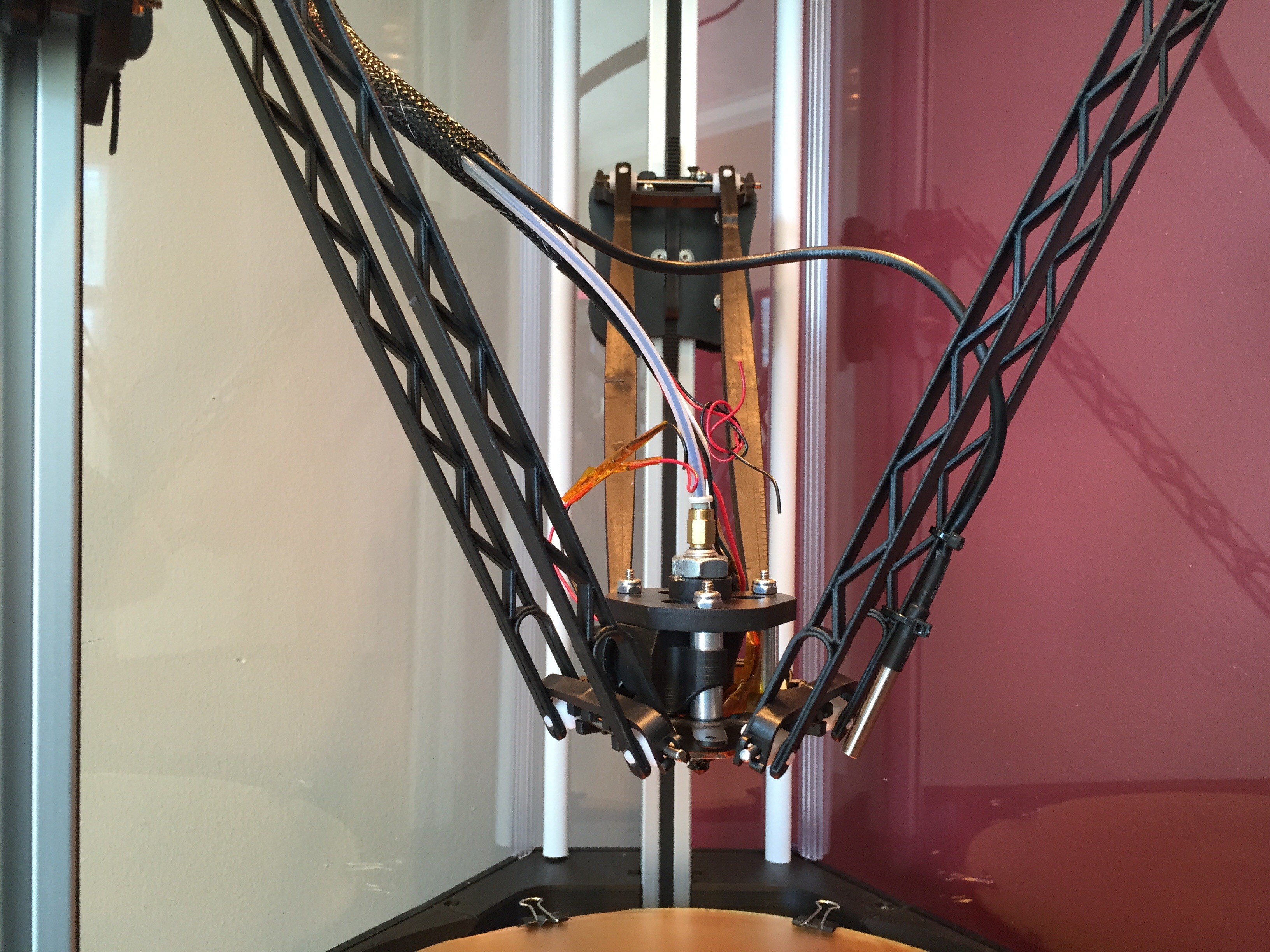

Enclosure Thermometer
Post by 3D-Print »

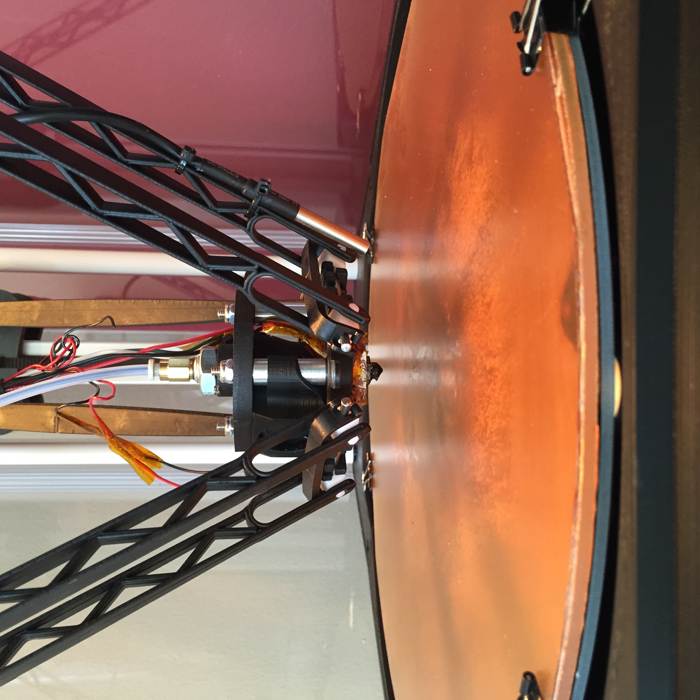

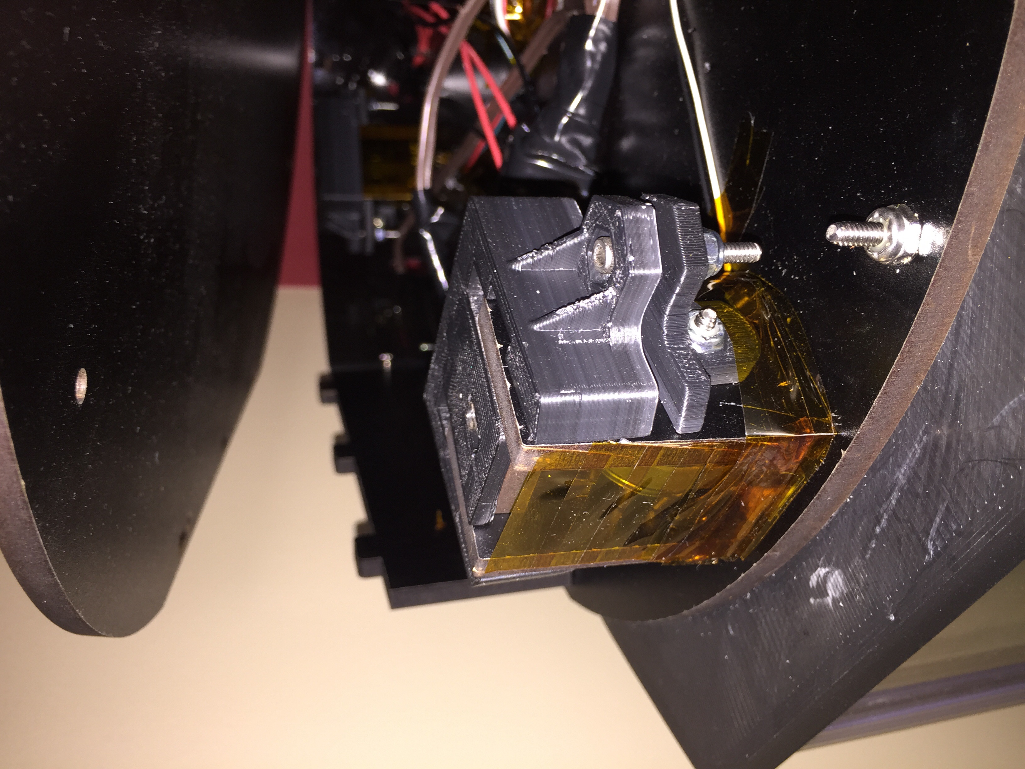

I finally installed the thermometer I previously ordered for my enclosure (http://www.amazon.com/gp/product/B00L0S ... UTF8&psc=1).
I ran 14 gauge wire up the channel of the enclosure after connecting to an unused power pack black and yellow. I slipped the probe down next to the Bowden tube to the print head and zip tied the thermometer tip to one of the Y-axis arms without touching the universal joint. I then tested to make sure that there was no impingement with manual movement of the print head as well as movement through MatterControl. We previously printed a curved bracket and then inserted this bracket (see attached STL) snugly between the upper an lower top plates. I trimmed back the acrylic cover to fit and it looks quite nice. I heated up the HotEnd and print surface and with the three halogen lights in high it is now 46.6 C after 30 min.
Overall looks good, and with this should be able to see what the temperatures of the enclosure are at the level of the print head.

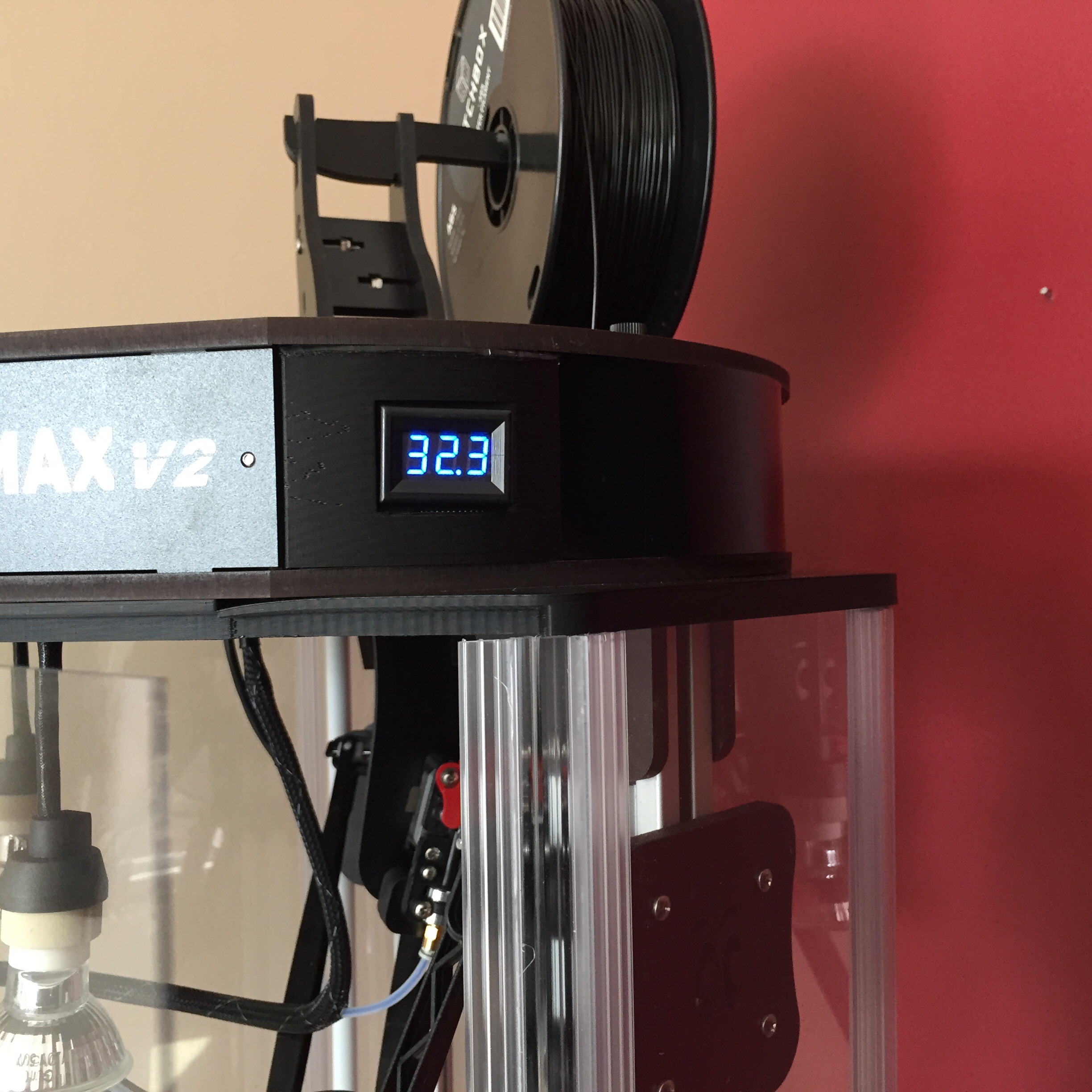

Re: My "BAP"
Post by 3D-Print »
Another image of the thermometer "holder." Of note you can see some dimples in the bracket which occurs when the print head is changing direction when printing fill. This happened using Cura Slicer with the wall being two layers.

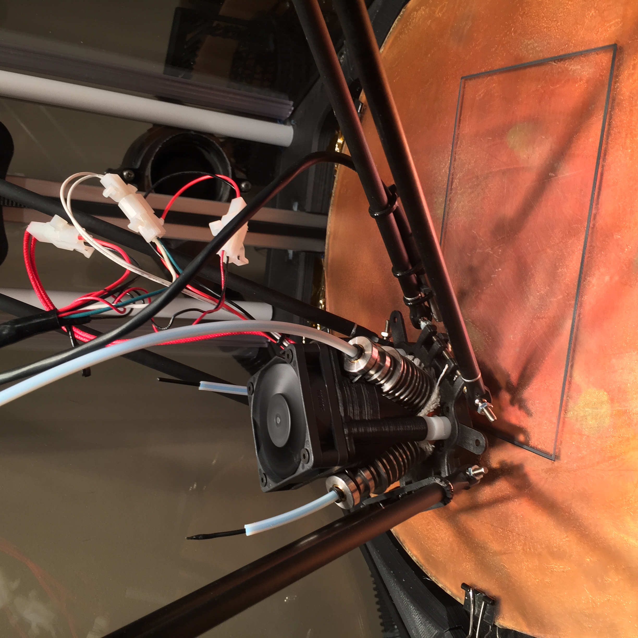

Enclosure Temperature: 65 Degrees C.
Post by 3D-Print »

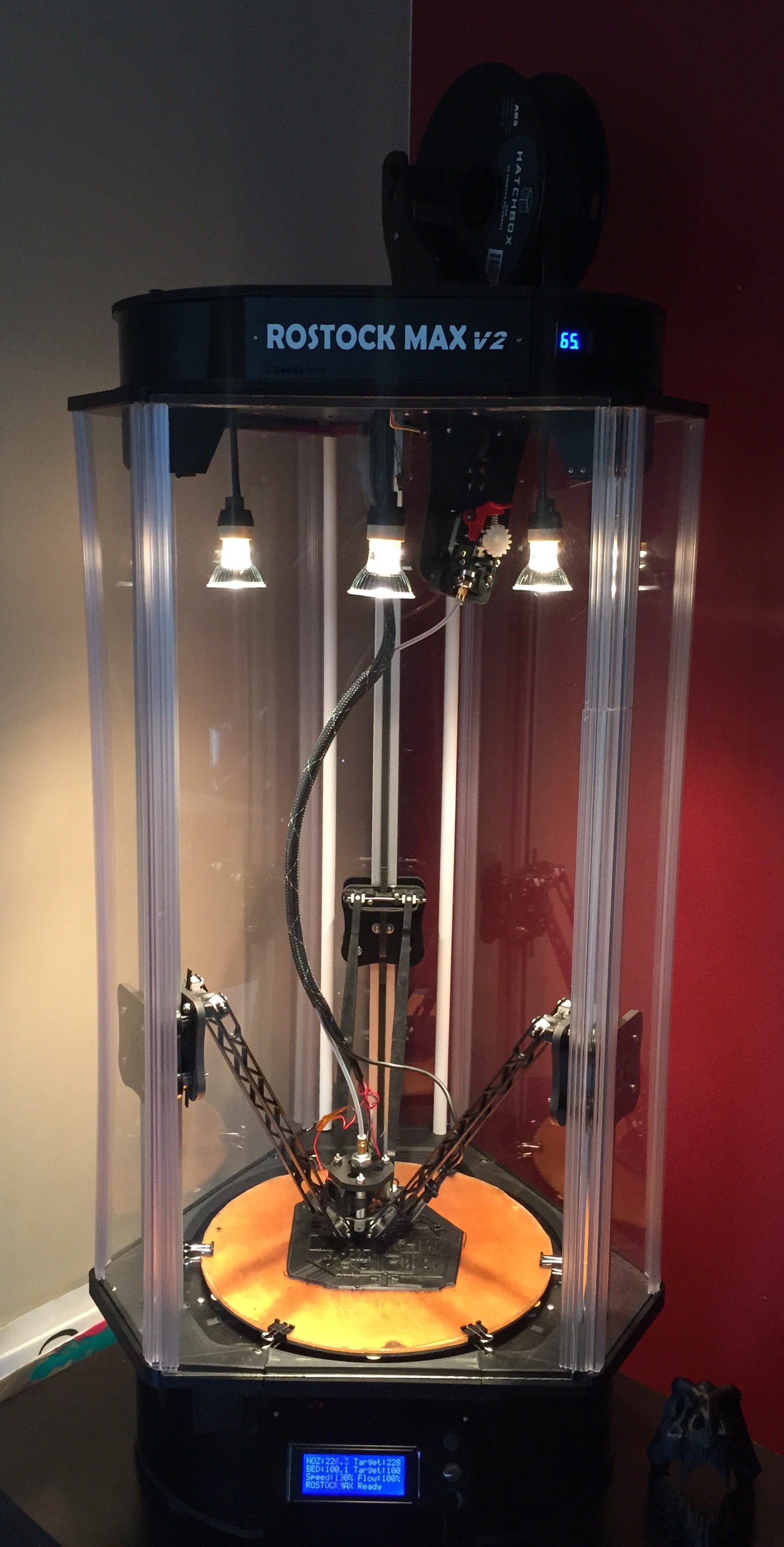

I am printing a long print and left my halogens on high for a bit. It was 65 degrees C at the bed level. I've found that is to hot on prints which have a small footprint. The ABS is to soft at that chamber temp and "fine textured aspects" of the print do not turn out well. In those cases 45 degrees is better.
Addendum: Print Bed was at 100 and the HotEnd at 228.

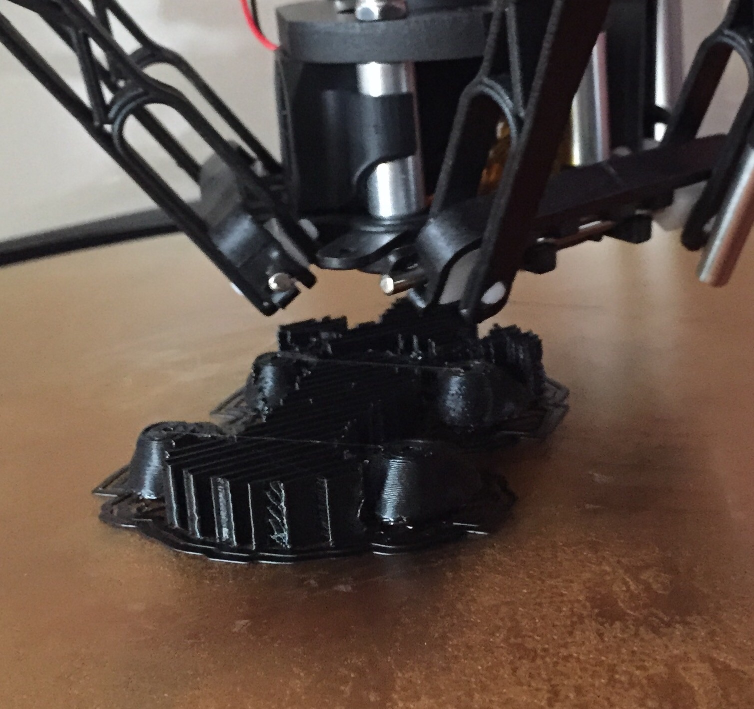

Re: My "BAP"
Post by 3D-Print »
Printing the articulated dog. With these smaller pieces I leave the enclosure door open otherwise the ABS doesn't firm up before the next layer. This is with the bed at 90 degrees and the temp at the print level is 31 degrees C. You can see that the first layers are not as nice and this was when the print bed was at 100 degrees.

TrickArms: My "BAP"
Post by 3D-Print »

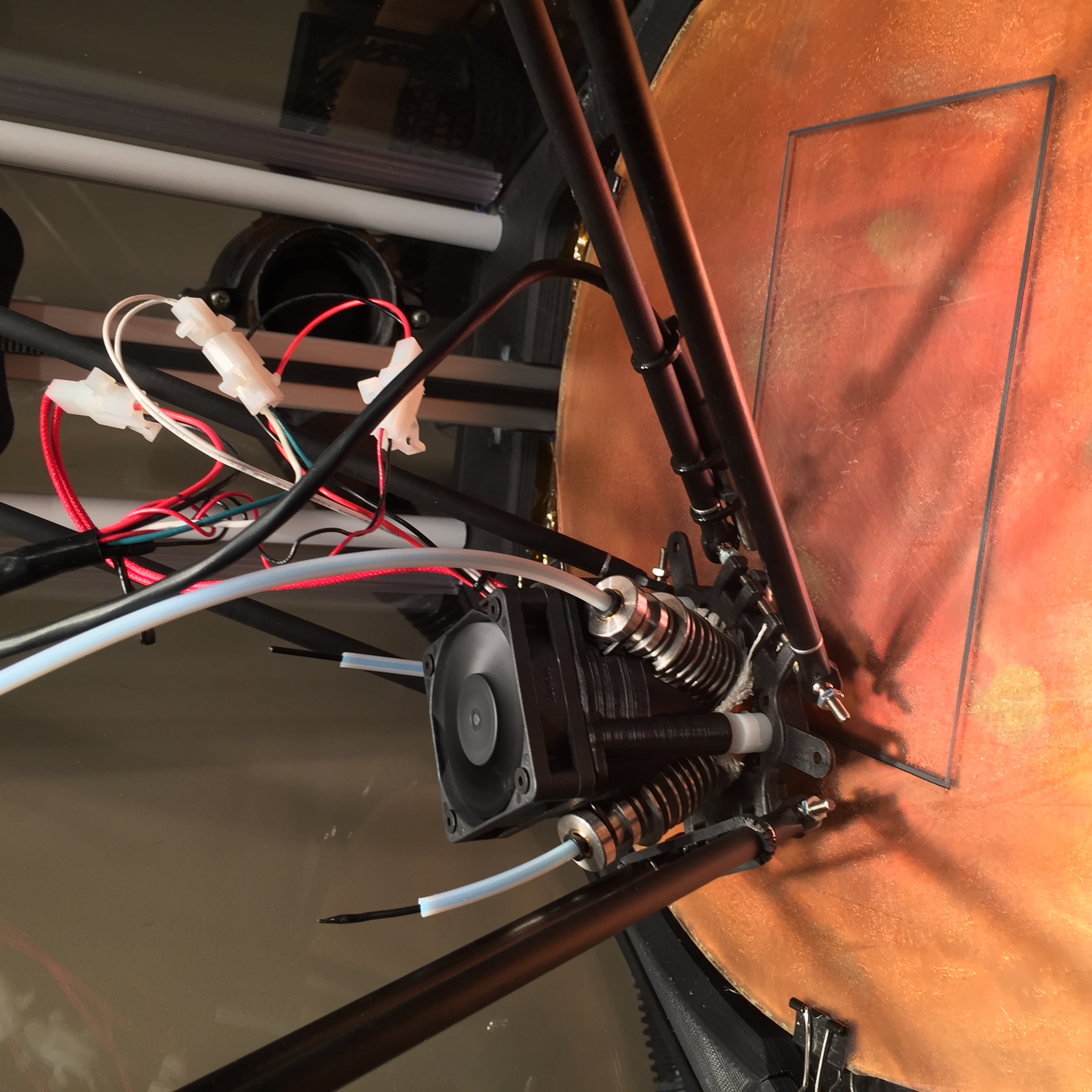

Just upgraded to TrickArms.
In short......... They are AWESOME!!! :D
Print quality has improved and the small shift in the layers during my prints are gone!!!!

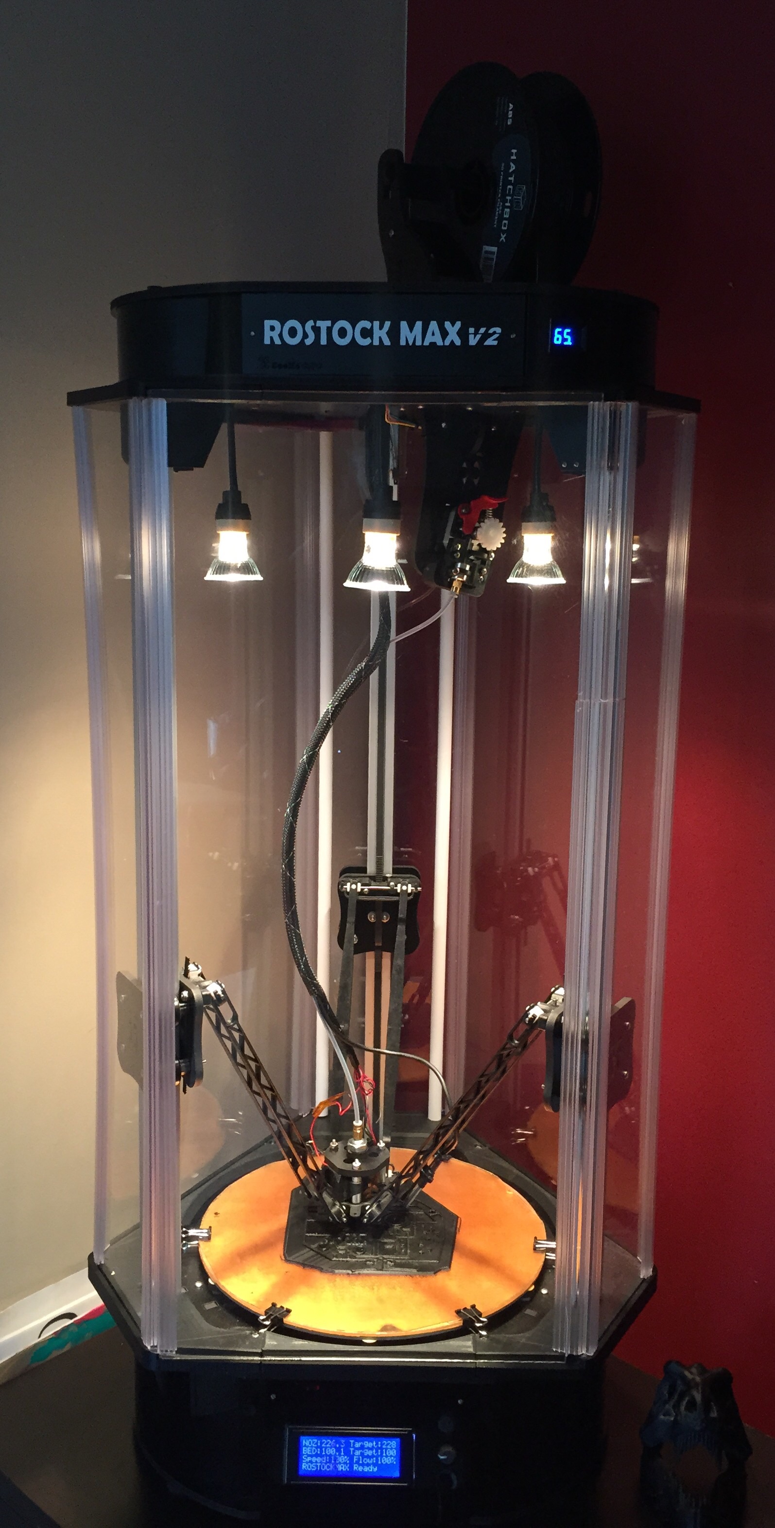

Last weekend I installed a 12 V squirrel cage fan to vent the enclosure. This has worked awesome and nicely/effectively vents the smell of the hot filament. With my halogens within the enclosure, the chamber is still hot. :D
I made another thread if interested in what I did (http://forum.seemecnc.com/viewtopic.php?f=42&t=8458)

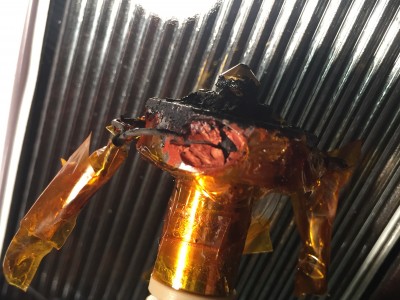

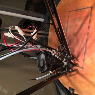

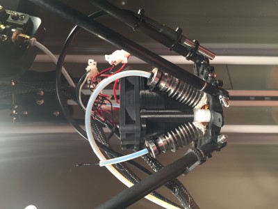

Post by 3D-Print »

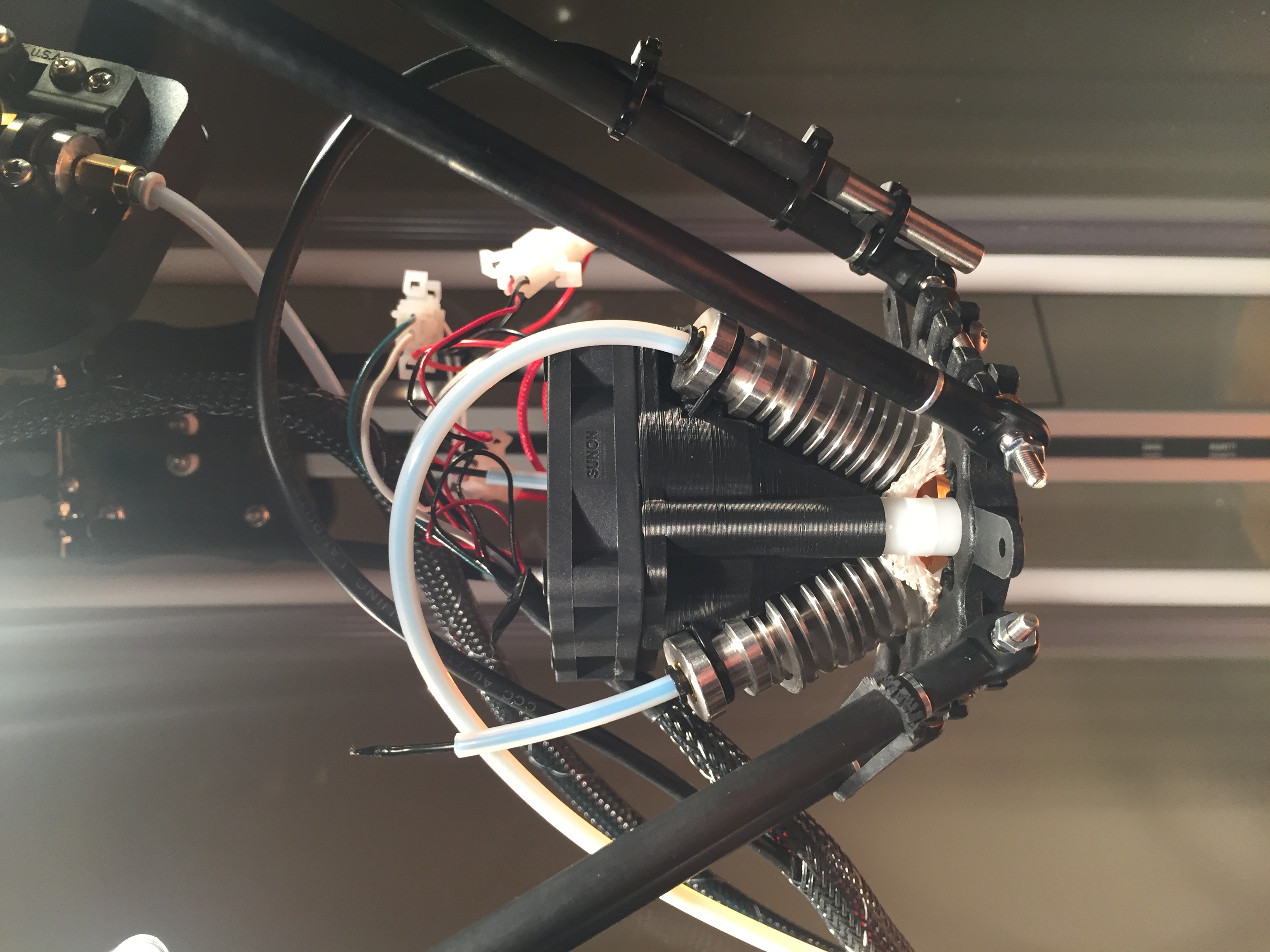

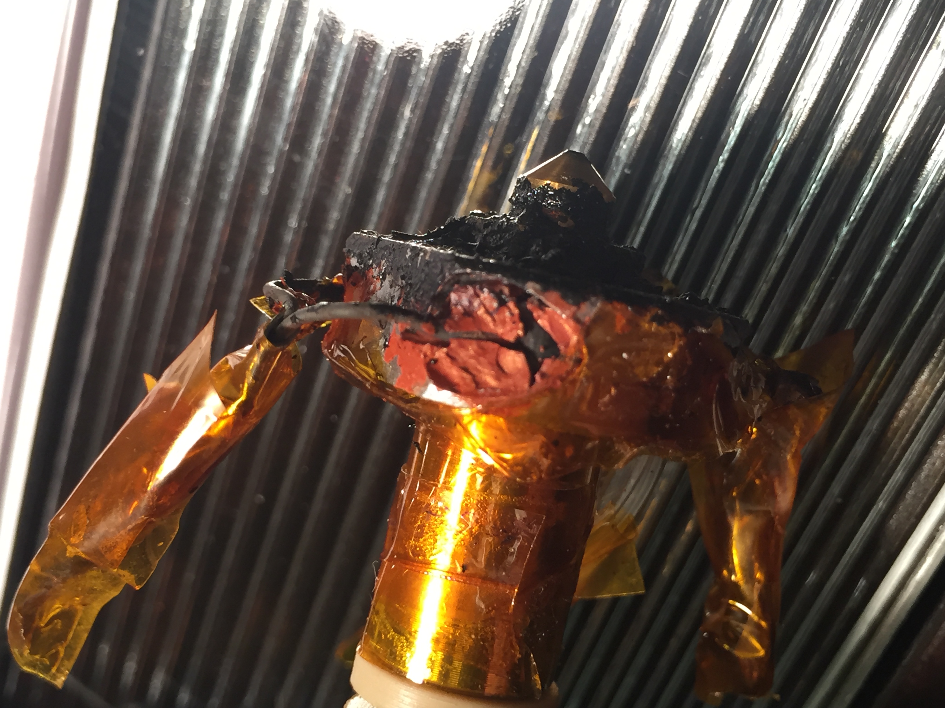

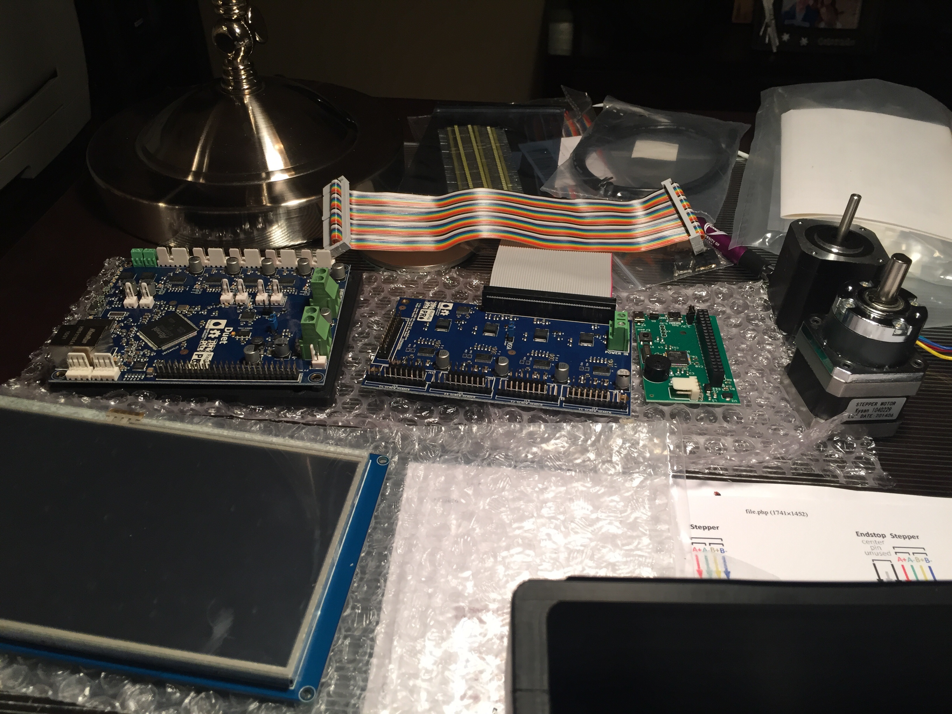

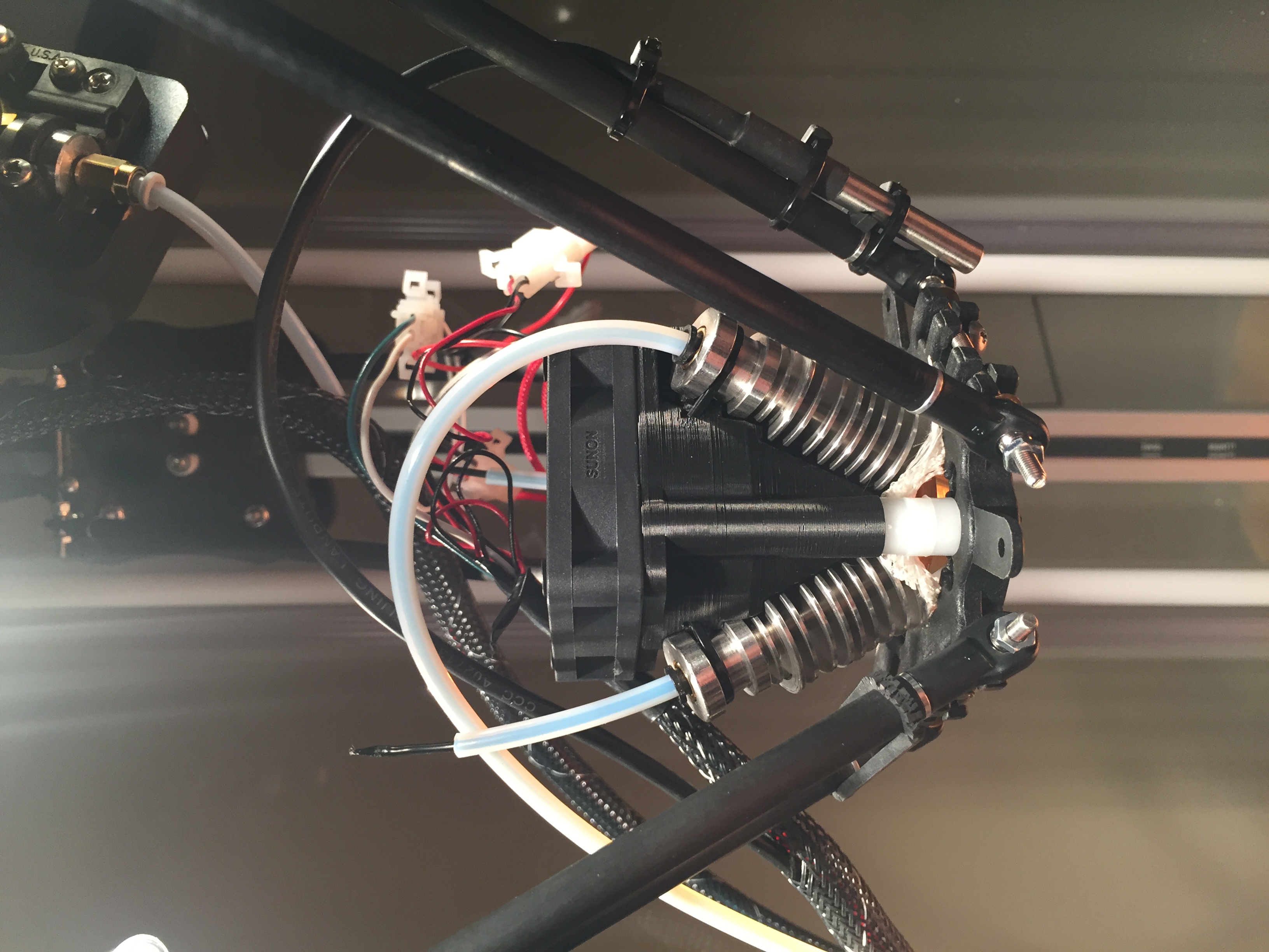

After 1500 hours of printing my hot end would not maintain temp. I took apart the HotEnd and indeed the resisters were loose and as suspected "done/blown!" (Picture #1).
Thus, although I have had the Diamond HotEnd for months, it was time to install it and see how it worked. It took a couple of hours and now am on my first print after recalibration everything. So far so good!! I love the stock HotEnd and have new resistors to repair and thus have a backup!!!

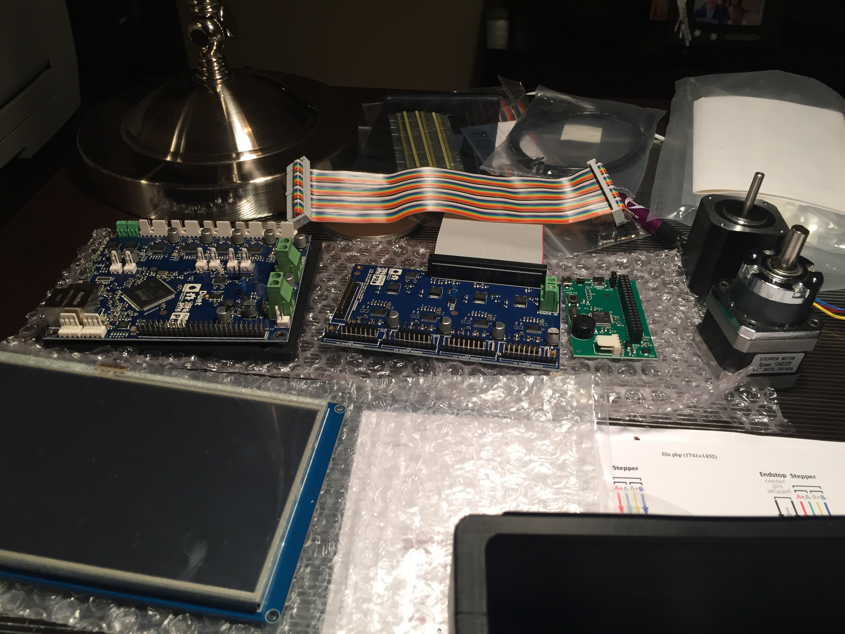

Now that the Diamond is up and running, next is to install the geared steppers and the Duet with Duex4 and PanelDue. Someday I will get RGB printing up and running!!!!!!!

Re: My "BAP"
Post by 3D-Print »
So I've been watching the Diamond HotEnd for the past couple hours. As compared to the stock HotEnd as calibrated, the Diamond needs to be 6-8 degrees cooler for the same effect. I was running the stocks HotEnd at 230 with very mild stringing, no blebs, and great layer adhesion. With the Diamond I have watched each sequential layer I have great and equivalent and awesome layers at 224 degrees.

Re: My "BAP"
Post by 3D-Print »
Here is the bracket I have designed to hold the Duet, Duex4 and PanelDue. Everything is scaled correctly and I'm now printing the base and faceplate. Once printed I will post pictures and files. The only thing I need to add is an "opening" for the USB port of the PanelDuo Controller. One this is done, I will upload this new .STL file.
Enjoy!!
UpDate: 2/13/2016. I added new STL files which after printing, I made sure that everything aligned. Also added in a couple of holes for the USB cable, reset button and SD card on the PanelDue.
