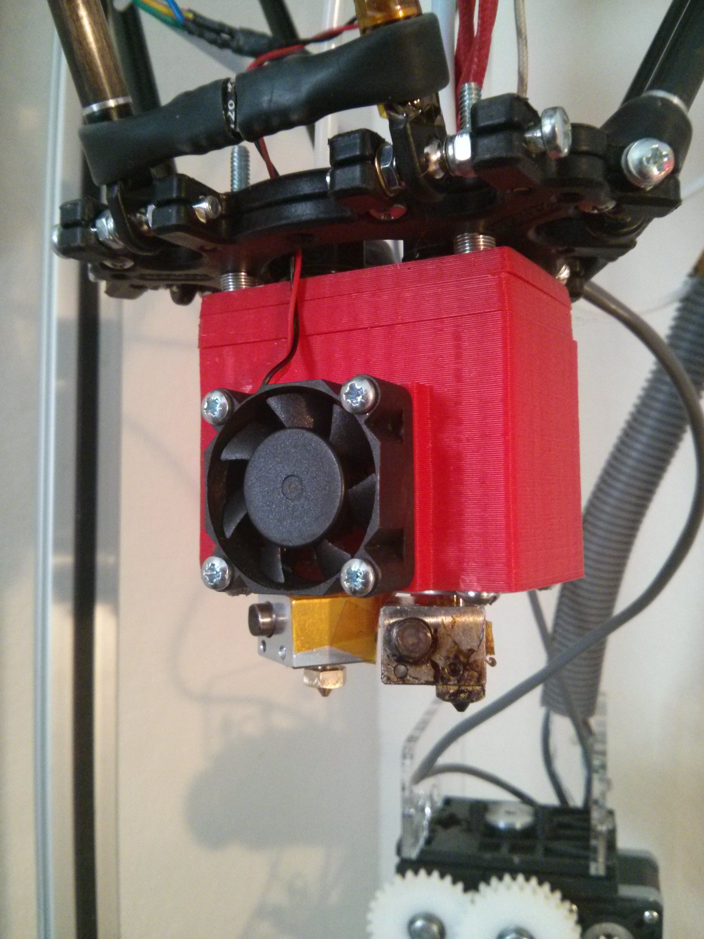

Here is my copy printed and mounted (already properly credited in Thingiverse, of coursedpmacri wrote: For anyone interested, here's the link to my mount for 2 E3Ds: http://www.thingiverse.com/thing:217662
As per the alignment problem, I added springs between the platform and the adaptor, so I was able to level the two hot ends easier.
Already had my first two color printing today (2 am !); double extruder is just so amazing!
Re: Dual extruders
Nice! Where did you get the springs and did you put them on all 4 screws?artexmg wrote:Here is my copy printed and mounted (already properly credited in Thingiverse, of coursedpmacri wrote: For anyone interested, here's the link to my mount for 2 E3Ds: http://www.thingiverse.com/thing:217662)
Re: Dual extruders
I got an assortment box from amazon http://www.amazon.com/Neiko-Steel-Sprin ... y_hi_img_zdpmacri wrote:Nice! Where did you get the springs and did you put them on all 4 screws?artexmg wrote:Here is my copy printed and mounted (already properly credited in Thingiverse, of coursedpmacri wrote: For anyone interested, here's the link to my mount for 2 E3Ds: http://www.thingiverse.com/thing:217662)
I put only 3 and worked fine. Maybe with 4 you have more control, but 3 is less screws to adjust. I guess even two should work.
