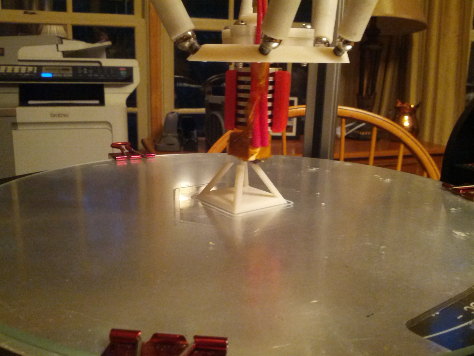

Just received my magnets today so I have all the pieces done accept for the carbon fiber tubes I ordered. I did a quick check on the strength off the magnets and the balls, very secure connection. Now just waiting on the tubes. Will post pics once I assemble everything when the tubes come in.
First print. Looking good!!!
elqisqeyano- Do the magnets fit into your rod ends? Mine fit way too tightly and I had to chase the holes with a drill. Other than that and moving my limit switches because I had them on the other side, the upgrade went pretty easily.elqisqeyano wrote:Just received my magnets today so I have all the pieces done accept for the carbon fiber tubes I ordered. I did a quick check on the strength off the magnets and the balls, very secure connection. Now just waiting on the tubes. Will post pics once I assemble everything when the tubes come in.
Thanks Xnaron!!!

Broose wrote: First print. Looking good!!!
How difficult was it to JB weld the Balls to the cap screws?

Broose wrote:elqisqeyano- Do the magnets fit into your rod ends? Mine fit way too tightly and I had to chase the holes with a drill. Other than that and moving my limit switches because I had them on the other side, the upgrade went pretty easily.elqisqeyano wrote:Just received my magnets today so I have all the pieces done accept for the carbon fiber tubes I ordered. I did a quick check on the strength off the magnets and the balls, very secure connection. Now just waiting on the tubes. Will post pics once I assemble everything when the tubes come in.
Thanks Xnaron!!!
I was able to insert the magnets by forcibly and lightly tapping then into the cup section 'till they were snug. I figured they would be a bit tight but that is a good thing. Now my ends are perfect ID, after lightly tapping magnets in, for when the tubes get here. Your set up look so good and clean. That print is looking flawless. I will be installing my hot end a bit closer to the effector than your install to try and keep my Z height. I will be using aluminum heat shielding insulated tape. Plus the Fan on the E3D should help keep temps cool enough to not melt the effector. At least I am hoping.

Not hard at all. If the ball is sitting on the rod end with the magnet inside, the magnetism holds the cap screw to the ball. I kind of twisted the cap screws upside down into the JB weld to pick up just enough JB Weld on the top.elqisqeyano wrote:Broose wrote: First print. Looking good!!!
I had to carefully use small needle nose pliers on the side of the top part of the cap screw below the ball when installing the cap screw/ball combination, because it still takes a fair amount of force to screw it in, even though I ran a longer 3mm screw through first a few times to get the thread going. On the other hand, if I had had a piece of latex rubber between my fingers and the ball, that might have allowed me to apply more force so that I wouldn't have needed the needle nose pliers.
