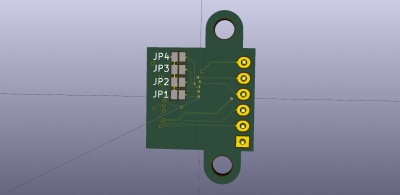

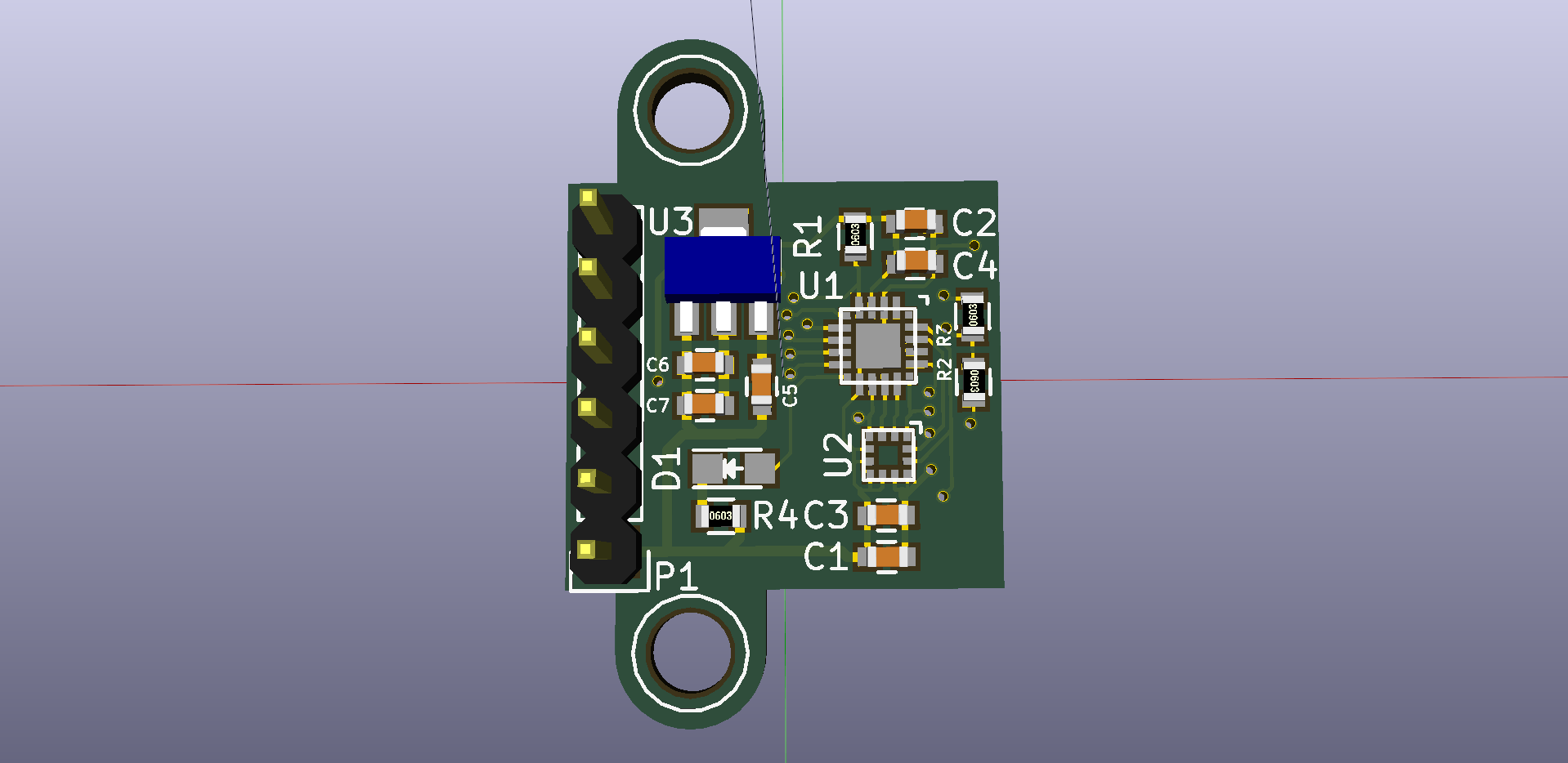

I am just starting to test a simple solution for the V3 to interface with a Duet. In parallel, I've hooked up with a hardware guy in Europe to design and build (as Open Source) an accelerometer probe based on the same chip and an onboard MCU. The programmer for the MCU came in today so I can start porting my code. We also ordered 6 boards to prototype and test. Here's the basic design. The jumpers are to experiment with sensitivity and a couple of other options like printing in X, Y or Z so the board can be mounted in different orientations.
It's going to be a tiny little thing.

Impressive!

What size are mounting holes? 4.2 mm dia. would be good in my opinion. (to fit onto stand off screw)
Also, the older SeeMeCNC aluminum stand offs where .375" dia., so you would want to make sure nothing shorts out with those.

Hey there. Hardware guy here. The holes are M3 at the moment (3.2mm hole in a 6mm clearance circle) but mounting is definitely a thing that will change with the final version.
The plan is to have the board act as a normal ends top, so it'll be fairly universal.

2) This device is shown in the renderings above. It uses an accelerometer from the same family that the HE280 accelerometer is from. It uses a completely different processor that is ideal for applications like this. The boards are at the prototype house and should arrive here at the end of november. I have all of the components to assemble 6 prototypes to test. These are all spoken for. Once we validate the feature set and functionality we will make and design changes and manufacture these. It will be an Open Source project. I am working with Duckle (he's doing the hardware design) on this project. He's in Europe. The way we plan to market these is I'll handle all sales in the Americas and he'll handle Europe and the UK. I suppose either of us would handle PacRim and Australia - it's more a question of favorable shipping rates than anything else.

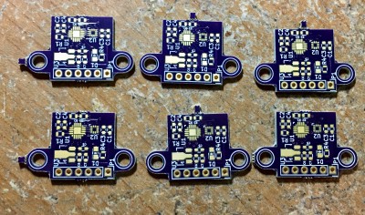

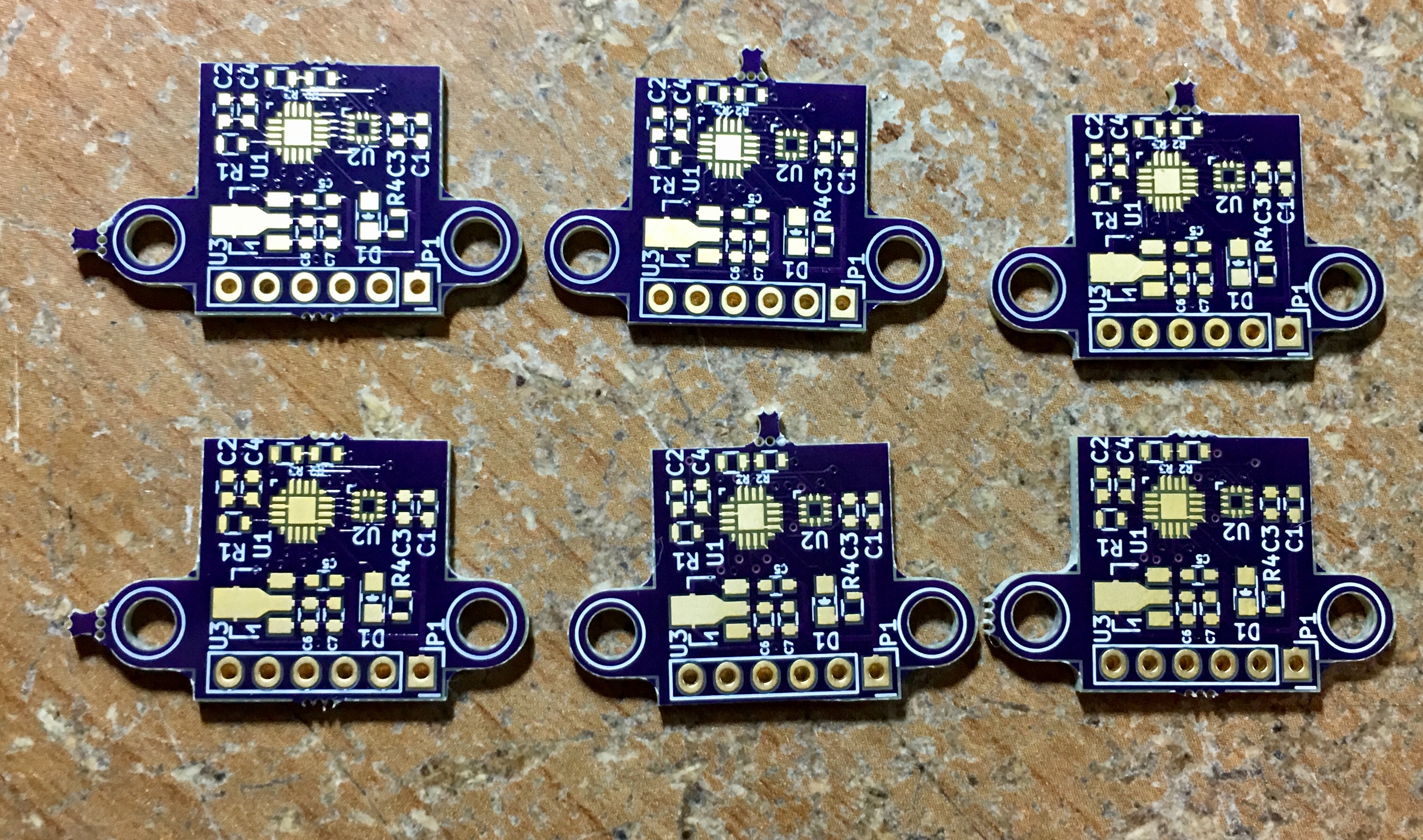

On the "serious news" front, the PCB fab just mailed the 6 prototype PCBs shown above for the free-standing accelerometer probe (no HE280 needed). I also have all the components to assemble them. I am working on the software and have the MCU eval board connected to the accelerometer prototyping board and am working on the I2C communications. Once that is done, the rest of the programming should be straight forward.

The 6 prototype PCBs came in. These are for a dedicated accelerometer probe, no HE280 required. I've made some progress with the firmware but learning a new SDK, IDE and processor eval board is time consuming. But I am talking to the accelerometer now. I just need to sort out how to enable and handle interrupts and then I should be good.

Very nice! Did you have those made at Osh Park?
Re: Interfacing to the new HE280 accelerometer...
Yes, OSH Park. Quick and cheap.

and great quality... i tried one of the chinese guys for a large board i was making (arduino due shield) and the quality difference was noticible.
your planning to hand-solder those? I can't seem to master smd solding for anything smaller than 1208... the solder seems to go everywhere :-/.
Posts: 5358
I suspect there's going to be a toaster oven involved. :)
