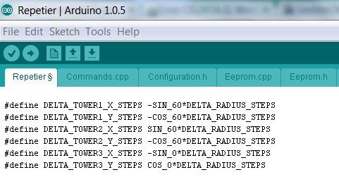

By the way, I didn't find DELTA_TOWER anywhere in the source except in Eeprom.cpp/.h. Is this Marlin you were talking about?

626Pilot wrote:By the way, I didn't find DELTA_TOWER anywhere in the source except in Eeprom.cpp/.h. Is this Marlin you were talking about?
He's talking about the Repetier tab in the firmware:

Re: Left / Right Bed Leveling
It isn't there.edward wrote: As an aside, grab a copy of the_silver_surfer for super-fast and inclusive text searches (*nix only, I think):
Code: Select all
~/sketchbook/Repetier-Firmware> grep -r DELTA_TOWER1 *
api-doc/html/_reptier_8h_source.html:<a name="l00953"></a>00953 <span class="preprocessor">#define DELTA_TOWER1_X_STEPS -SIN_60*DELTA_RADIUS_STEPS</span>
api-doc/html/_reptier_8h_source.html:<a name="l00954"></a>00954 <span class="preprocessor"></span><span class="preprocessor">#define DELTA_TOWER1_Y_STEPS -COS_60*DELTA_RADIUS_STEPS</span>

Ok sorry. I didn't mean to sidetrack the topic. I made my comment based on what I interpreted 626's comment to mean "I looked through the file." I guess we all have tools that work for us.
Yes, I'm on Marlin. When I referenced Repetier, I was recalling 0.83; it *was* in that version.. I've never more than quickly looked at some specific segments of the 0.90 development branch. Maybe it's been moved to EEPROM, in which case this whole business would be easier because you wouldn't have to recompile and reflash after each change.
Maybe later tonight I'll be able to study the new Repetier branch. Until then, if someone wants to look, I'd start by understanding the function that contains the primary location for use of the tower positions in the calculateDelta() or that similarly named.
