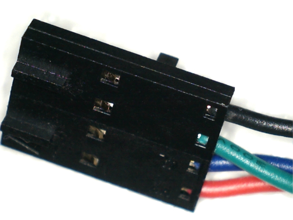

try arduino 1.0.3 and above, doesn't seem you have the files loaded in your arduino ide, when you select repetier.ino/ repetier.pde file. it should open all the files that need to be uploaded.
not sure that you can just upload the config.h file like that.
do have a pic of your pins? i'll take pic of what they should look like for you
make sure this tab isn't bent down, it should be sticking up as shown. if its bent down, take some tweezers and slightly bend it back up.

I also checked my crimp pin inserts, and they look just like that picture. The plastic pin connectors that actually fit into the rambo receptacles are wobbly, but I think that's normal.

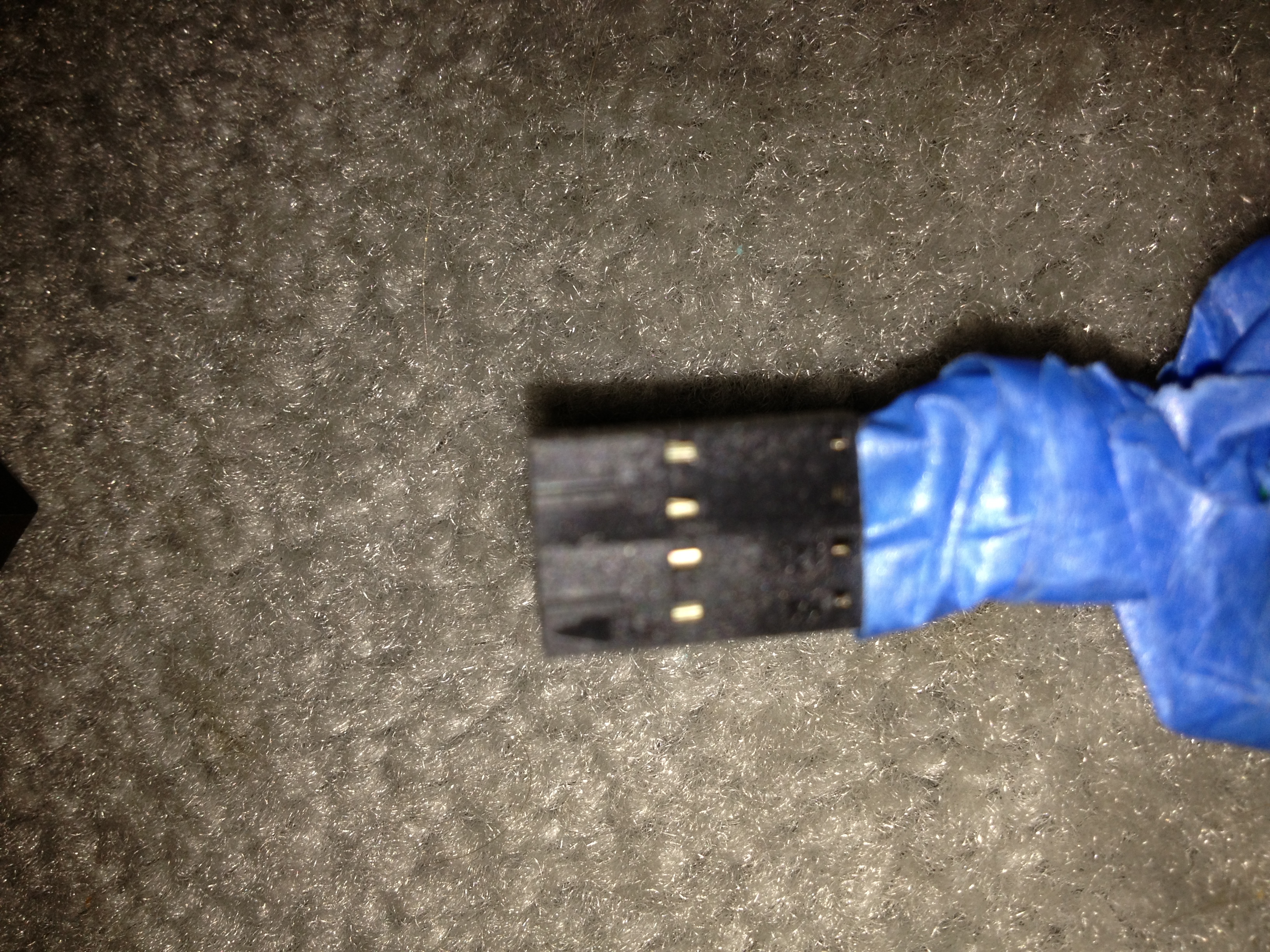

Here are some pictures of the wiring.

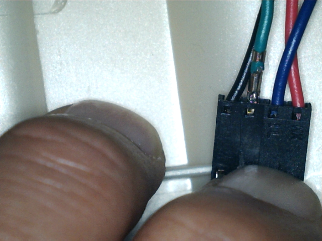

from that second pic i can tell you thats your problem. your pins aren't crimped properly not allowing you to push them all the way in, doesn't even look like the locking tab is in the hole either.
you might want to get a new set of pins and recrimp them with a better tool. it should look like the photo i posted. I believe you may also be shorting some of those pins together, with them not being all the way in, they could come out and short (causing other problems)
also if your using blue tape to splice your wiring, its just a matter of time till something comes apart.
do it right the first time (or in your case the next time) and you might not have some of these issues.
pins are all the way in, locking tab protruding into locking hole
